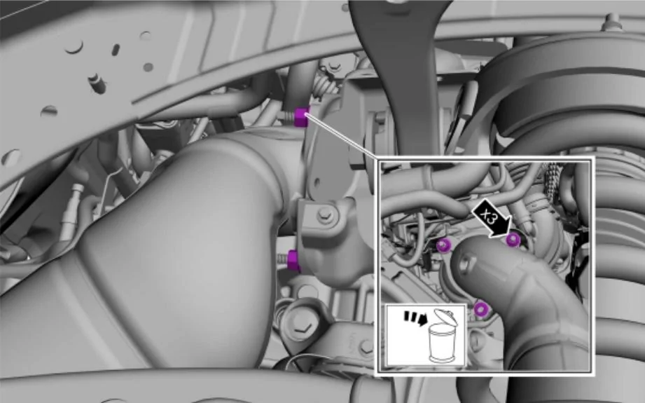

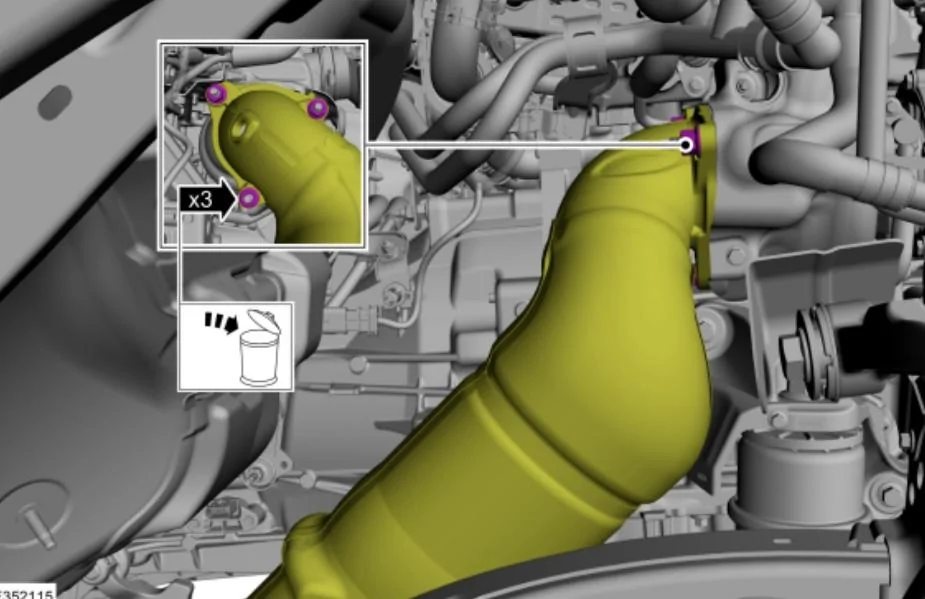

You can - and we can waive the restocking fee - but based on the 3-bolt connection on the Ranger and the 2-bolt on the Bronco I'd be very surprised if she fit.
So I must've got a bad one.. my 2.3 bronco connection is a 3 bolt. Let me try the ranger one for you and see if it fits, dm me and I'll send you my address. I will be the R&D department for you guys. If it fits mine, I'm sure it'll fit any other of us that have the 3 bolt connections on the 2.3.
Ducati1098
10,039
23,389
Midwest
I’ve never had one side by side, but they do look very similar. It’s hard to tell from these pictures, but the one in yellow is the bronco.
The only difference I can see is the ranger one looks a little bigger and doesn’t drop down quite as fast or far as the Bronco one. But this could also just be the way the picture makes it seem.
They do have different part numbers, but it may work anyway.

Persactly! When I compared the OEM parts, it looks like the Bronco has hardware and gasket included. I honestly think that's the difference. I would think ford would use as many as the same parts between the two to keep things easier. @CVF-Jason, send me one!
CVF-Jason
Base Sponsor (Level 1)
Jason
Feb 23, 2023
55
130
South Florida
'23 Bronco Raptor
Shoot me the part number of the downpipe on your 2.3, and we can verify.
It's not as simple as same engine and looks the same. For instance, the 19-21 Ranger has a different downpipe than the 22+ Ranger.
The only difference is it’s been superseded twice. The most current part number (KB3Z-5E212-F) and all previous part numbers will fit all Rangers 19+
