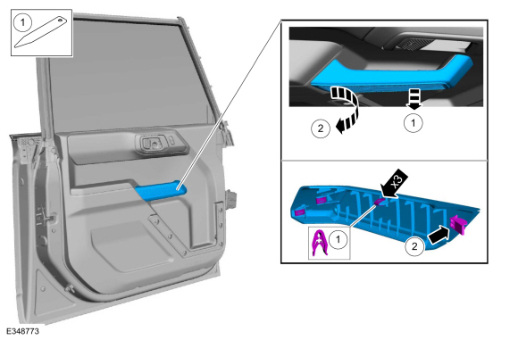

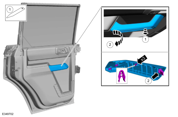

Has anyone taken off a front door panel? Is it difficult? I put my plastic yearly town parking pass in the rubber of the side door so I wouldn’t forget to hang it up. Guess what happened when I opened the door? You can’t make this shit up. Will try to get a replacement but I may have to get it out somehow. Thank you in advance.
Ducati1098
9,990
23,237
Midwest

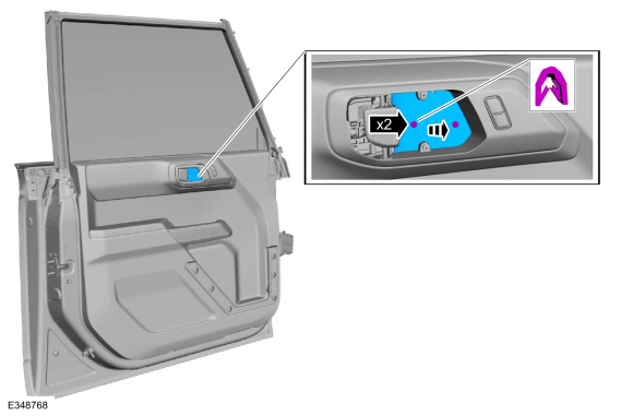

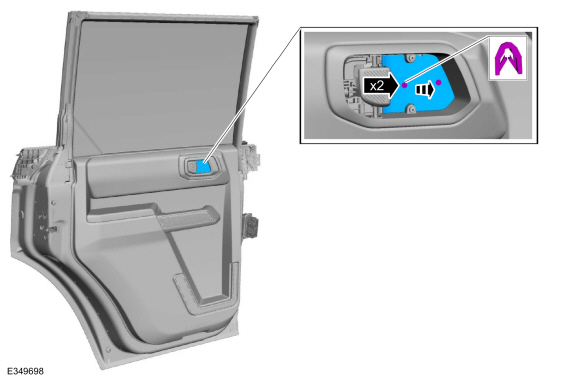

It's pretty easy to remove.
Front Door Trim Panel
Special Tool(s) / General Equipment
Pick Hook
Interior Trim Remover
Removal
NOTE:
Left hand (LH) shown, right hand (RH) similar.
NOTE: 5-door vehicle shown, 3-door vehicle similar.
NOTE: Removal steps in this procedure may contain installation details.

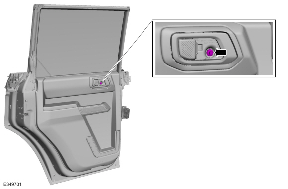

  1. NOTE: Interior front door handle removed for clarity.
    Release the clips and remove the interior front door handle bolt cover.
    Use the General Equipment: Pick Hook
Ford Bronco {thread} {filename}

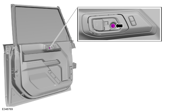

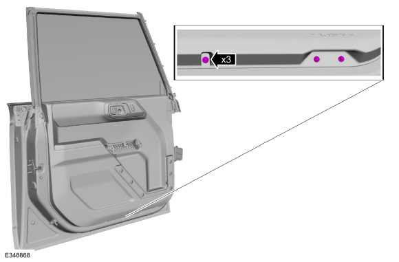

  1. Remove the interior front door handle bolt.
    Torque: 36 lb.in (4.1 Nm)
  1. Remove the front door trim panel bolt cover.
    1. Release the clips.
      Use the General Equipment: Interior Trim Remover
    1. Release the rear tab.

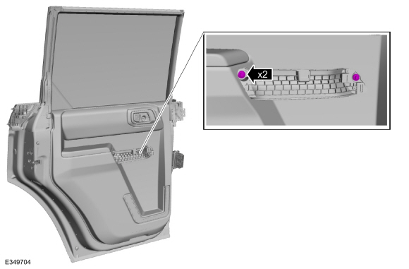

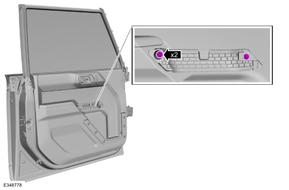

  1. Remove the front door trim panel bolts.

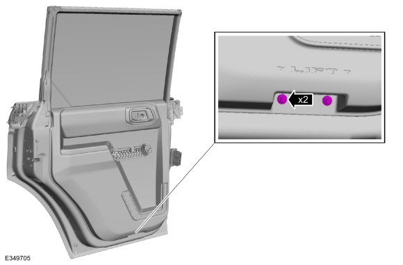

  1. Remove the front door trim panel lower bolts.

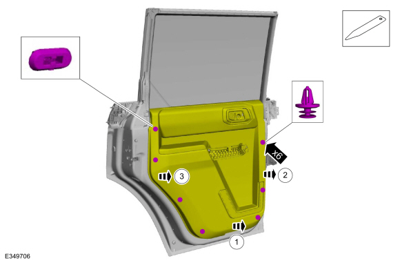

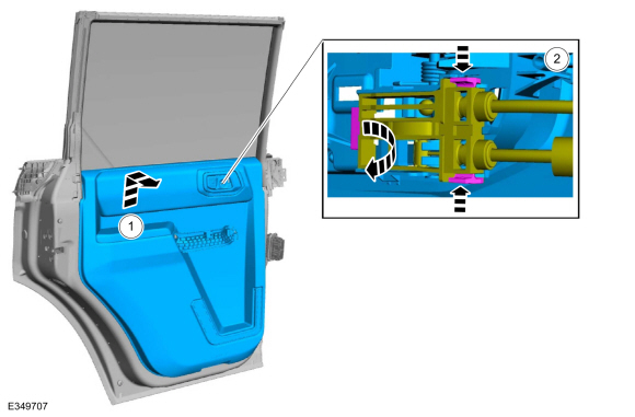

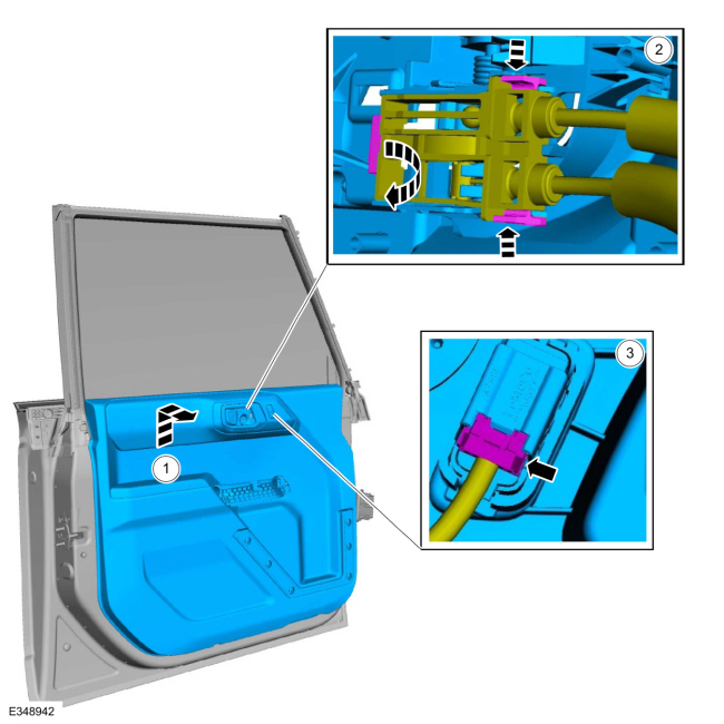

All vehicles
  1. NOTICE: For re-installation, the tabs must be re-engaged to prevent the interior front door handle from becoming non-functional.
    Remove the front door trim panel.
    1. Lift upward and outward on the front door trim panel.
    1. NOTE: Follow the unique instructions or graphic for this step in installation.
      Release the tabs and position the interior front door cable aside.
    1. Disconnect the front door lock control switch electrical connector.

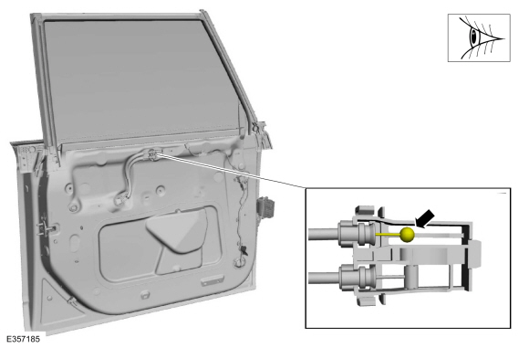

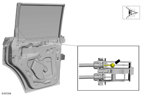

  1. NOTICE: The manual door lock cable must be in the locked position prior to reassembly or the door lock feature may not function correctly after installation.
    Verify that the manual lock cable is placed inward to the locked position.

  2. NOTICE: The manual door lock cable must be in the locked position prior to reassembly or the door lock feature may not function correctly after installation.

  1. NOTE: Interior rear door handle removed for clarity.
    Release the clips and remove the interior rear door handle bolt cover.
  1. Remove the interior rear door handle bolt.

  1. Remove the rear door trim panel bolts.
  1. Remove the rear door trim panel lower bolts.

  1. Release the rear door trim panel clips.
    1. Release the rear door trim panel lower clips.
    1. Release the rear door trim panel RH side clips.
    1. Release the rear door trim panel LH side clips.
    Remove the rear door trim panel.
    1. Lift upward and outward on the rear door trim panel.
      Release the tabs and position the interior rear door cable aside.
