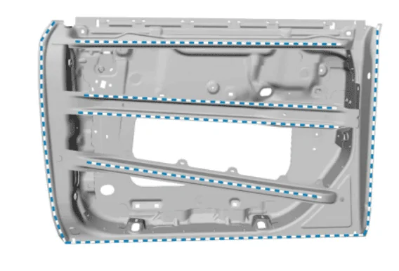

I would have to take a look at a photo of the inside of the door to say for sure, but I think the hinges are attached to a reinforcing frame behind the door skin. If the reinforcing frame bends, it will likely buckle the sheet metal where it is attached to the frame.
makes sense, I'm trying to find a door diagram.

Door skin replacement pic from the WSM. Looks like there could be reinforcement/crash bars in those general locations. Note, the skin is glued to these. We've seen this happen on hoods and is due to the glue and what it's attached to. Fix was to separate the two pieces in that spot and apply another dose of panel glue.
Thank you! This is perfect.
So once the dent would occur, and you’d do the repair you stated, the hood would be straight again and good to go for the future?
