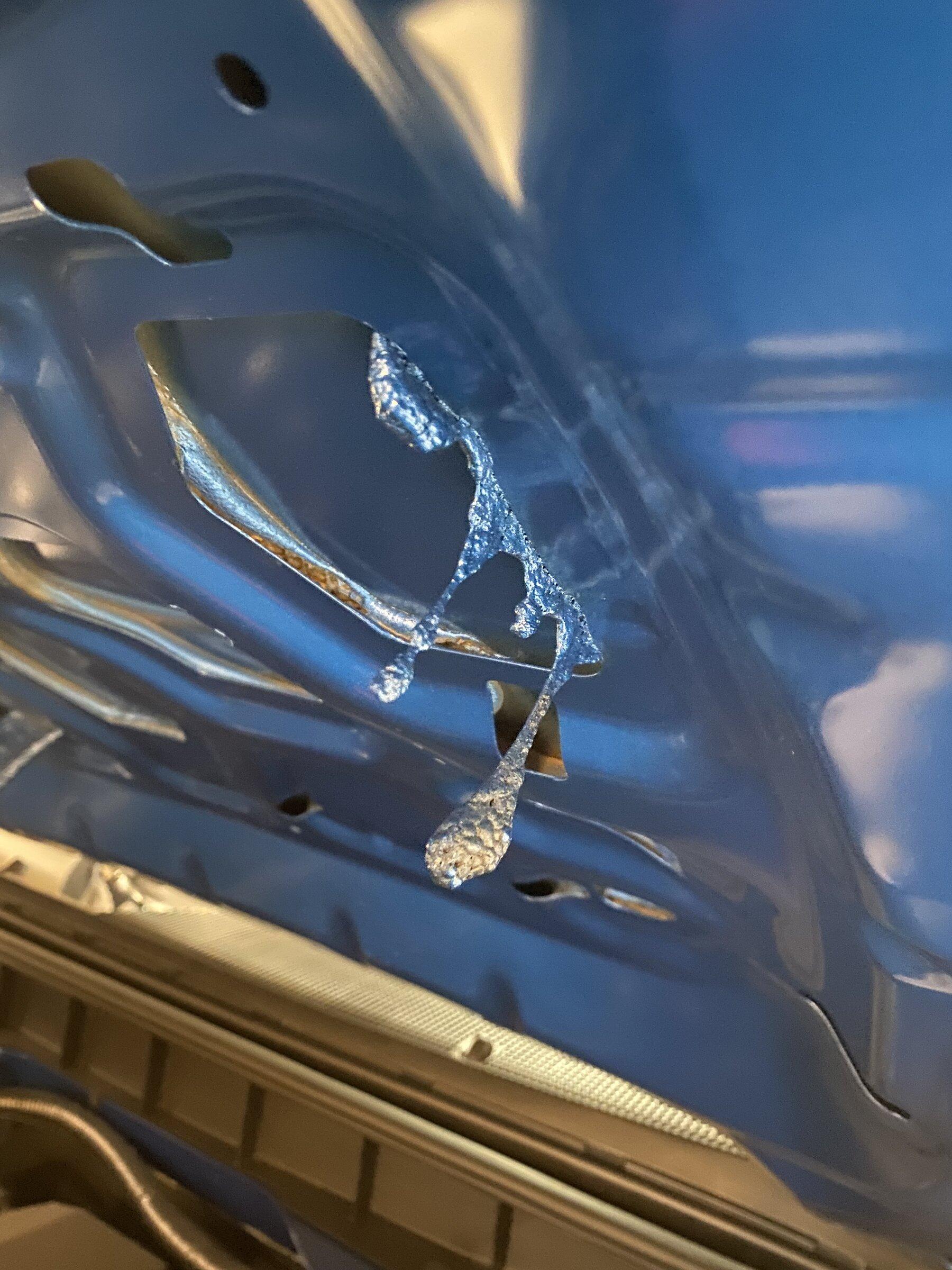

I had a problem with my hood, too! But mine was more a of a bonding issue...too much bonding agent, I guess. The day I took it to the Ford dealer, I had it warming up in the garage and it had this chemical burning smell. Sure enough, another large paint drip had formed! Dealership sent it to the local body shop, where all they did was trim it off....I could have done that myself! Actually, I need to check under the hood to see if Good luck!
Jeez,...looks like rust inside the cavities.
