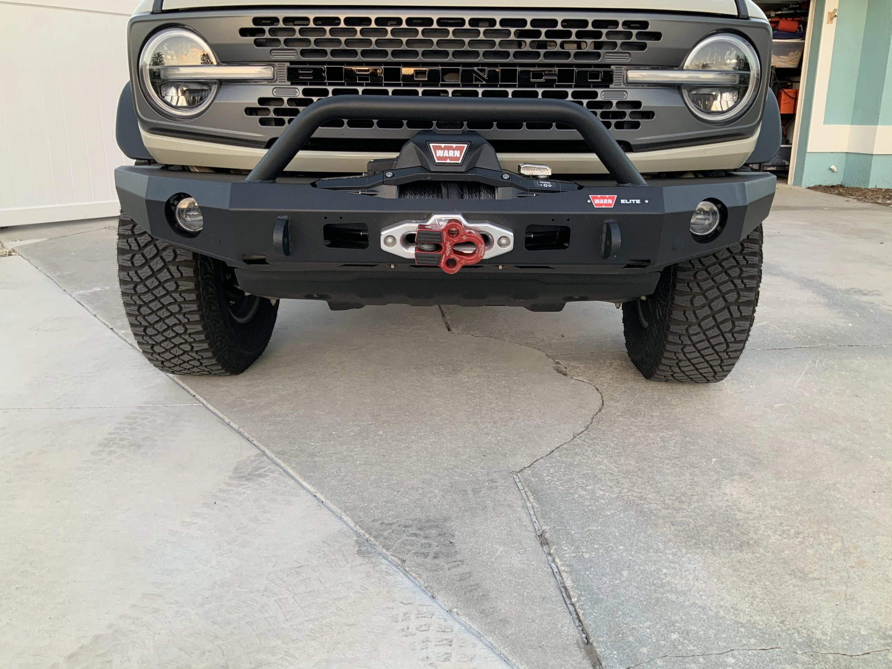

I’ve driven Broncos with and without the OEM winch mount including the Warn winch. I don’t feel a difference. You just need to remember not to pull up to close to anything in front of you.🙈
I Have a Warn elite bumper (which is BiG) with a Warn winch and can’t feel any difference.

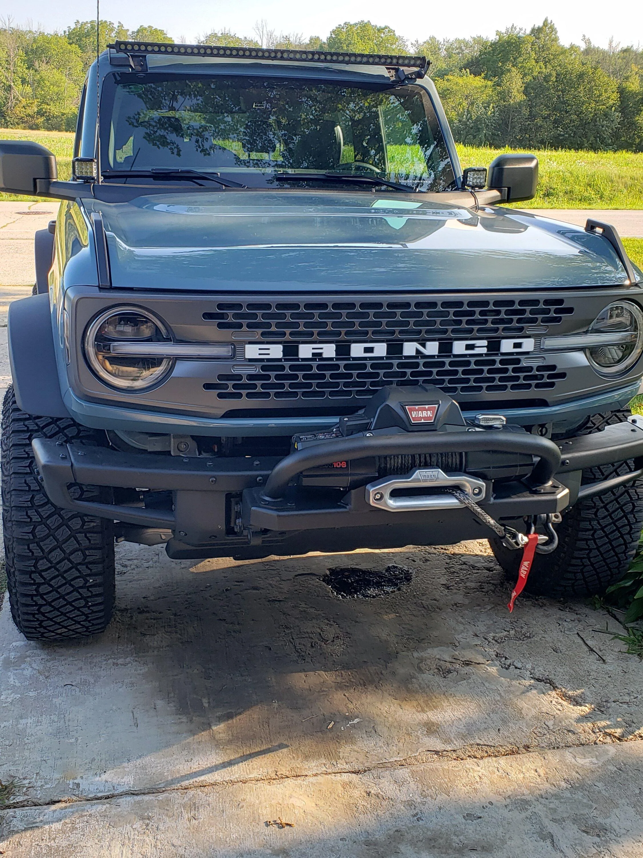

I have the Ford setup on mine...very happy with it. All Broncos have a little factory rake, and the weight of the winch does add to that a little, I added a 1" level to compensate, but it rode fine before and after.

Does that light bar make much noise on the highway?

Ya. Not so bad when top is on, but it whistles. They give you rubber insulators for the fins, and it's better with them in, but still whistles. W/out the insulators it just screams!
