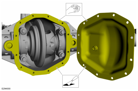

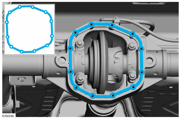

- NOTE: Make sure to note the position of the gasket prior to removal.
NOTE: Make sure the component is seated at correct position.
NOTE: The gasket is to be reused unless damaged.
Remove the gasket.
- NOTE: Use care when cleaning the differential housing and its cover gasket mating surfaces.
Clean the gasket mating surface of the axle and the differential housing cover.Installation
