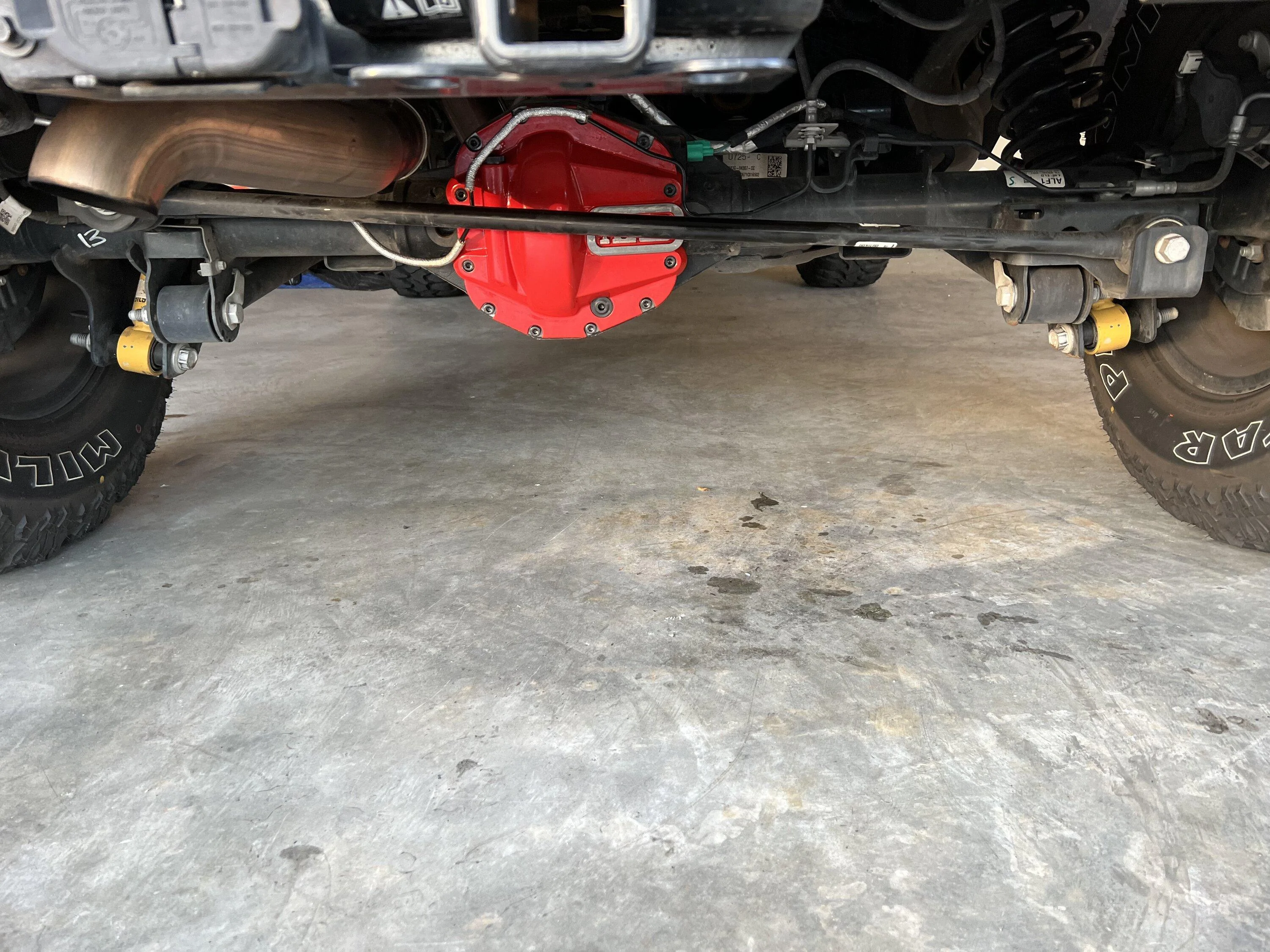

sorry to be a pain in the ass but what did you do with the brake line?
It’s just chilling
Thanks.
hey, no worries! It’s just chilling up there. Wasn’t too worried about it being damaged but I was a little surprised ARB didn’t include a means to secure it.

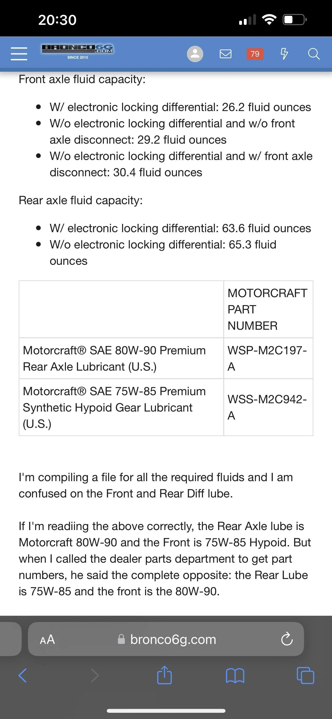

I included a screen shot of what helped me figure out what oil to use.
I have seen the same chart with all the other fluids too. I think I'd preference published material over one guy in a service dept, but maybe not. Also I wonder if there is a huge difference between 75W85 and 80W90? I can't be huge I would think. Now I don't know what difference the Hypoid stuff would make. I am not familiar with what that is and I don't think i've heard of it before.

@Orangeflava - has the loose brake line caused any issues?
Any clearance issues with the track bar? I’m installing an Icon bar at the same time. But, curious how it goes with stock. I

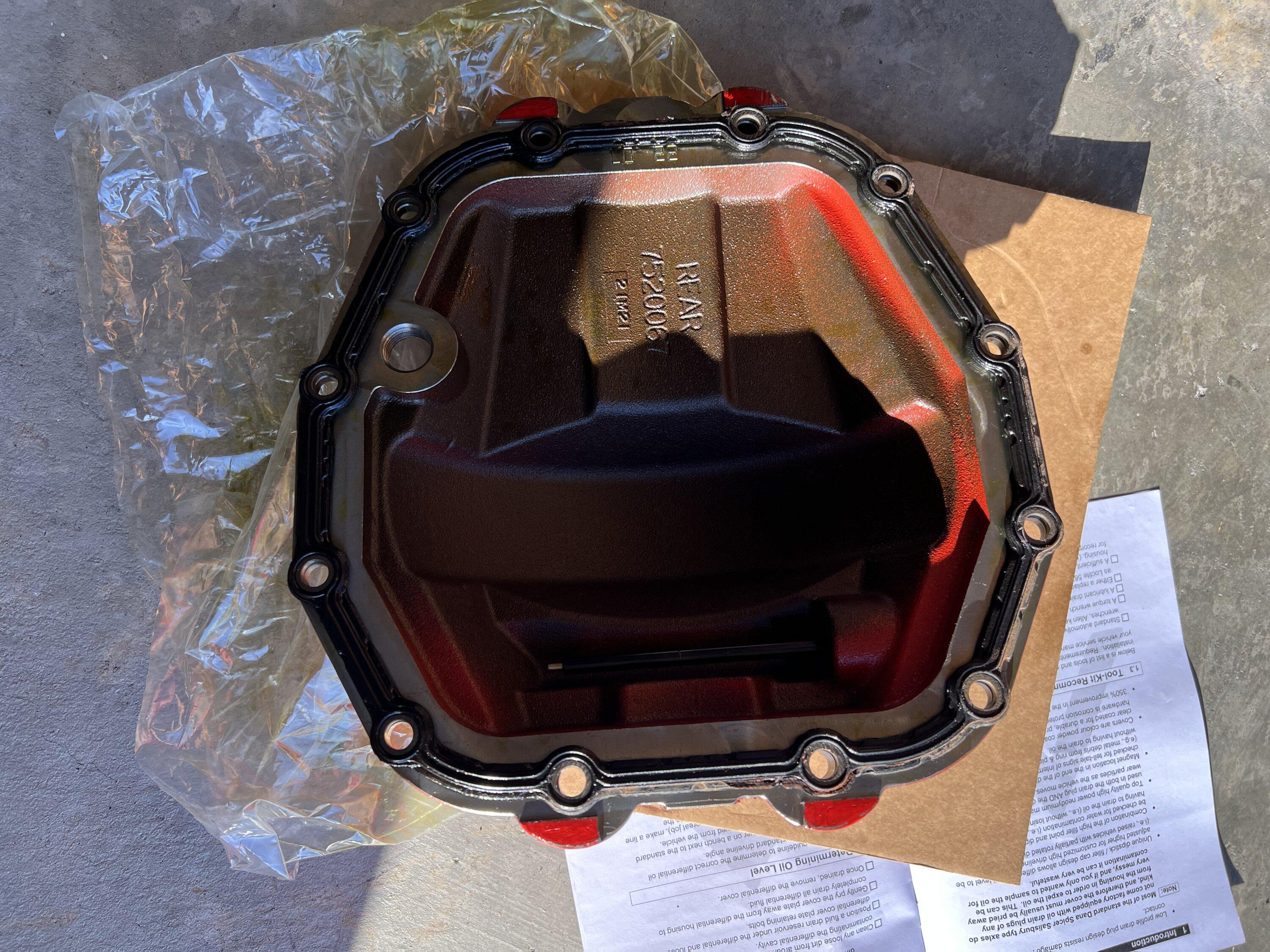

Good info! I did a motor oil/filter change and a front diff change with no issues. Then the rear diff, Dana M220, I had a ARB cover to install. Looked and looked for a replaceable gasket and there were none. I bought good ol' Permatex Gear Oil Gasket Maker and went to work. After buzzing off the 12 bolts I got a small screw driver to pry off the cover. And WOW!!! Ford/Dana had a reusable gasket! This is great, even though the Amsoil 75W-90 only needs changing every 50000K miles, this was less messy and easy for the next change. I drive the Southwestern Dez very often. Heat often no worries now and the next change will be easy! Thanks Ford/Dana and Amsoil!
