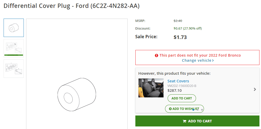

Just a heads up, your system shows both those items as not compatible when I looked them up on your parts website
The parts store (Revolution Parts) pull the info from Motors which is months behind on updates. I've added parts along with pics and descriptions manually for a bunch of items because of this. I did look this up for '21-'22 Bronco in Microcat so just ignore the store, it's just way behind. They told me the complete update takes about a year so near the end of '22, '21 should be mostly loaded. Yea, great :rolleyes:
Ha, figured that was the case. Makes me feel better about the dumpster fire cleverly disguised as logistics software we had at my last job.

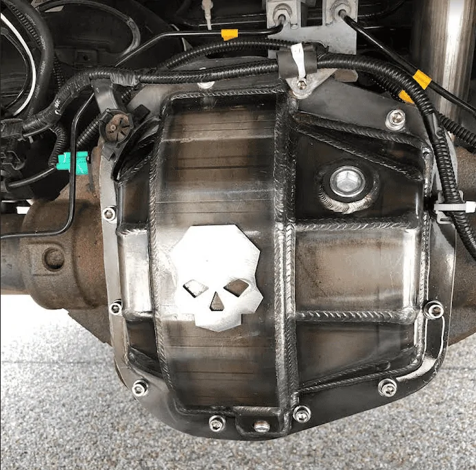

So as I just got my MetalCloak rear diff cover this thread is useful…sorta.
Per @flip it looks like the gasket is reusable and should be fine.
But no general consensus on gear oil to refill the diff? I don’t want to F this up as this is new territory for me. Should I buy a new gasket from auto zone or where ever? Should I use royal purple? What is the best suggestion here.
Redline's 75W85 GL-5 gear oil is good for the rear diff if you're not a fan of the Motorcraft offering
