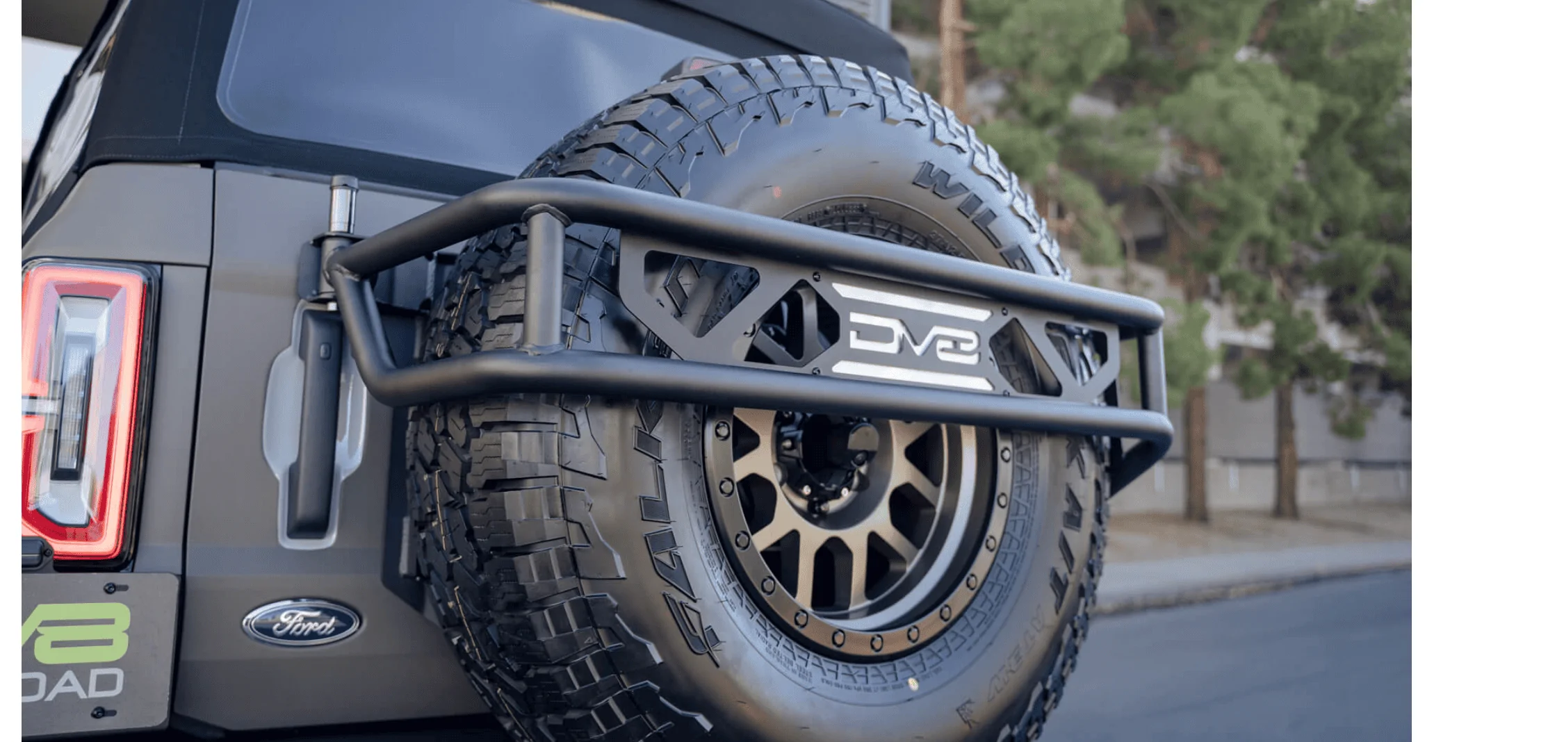

JPye, really, it's whatever is your personal biggest pain vs your biggest reward. Which would you be doing more? Going off roading / backroading/ vacationing type thing? Or biking ? Putting the tire on and off is a royal pain. But for me, even putting a hitch bike rack on and off is a pain. I'd really love a LOW profile OVER the SPARE simple mount for 1 bike that I could LEAVE on all the time... one that didn't look cheap and rickety or cheesy. I've been working on this. LMK if you find something like that. For now, I'm going Spare-less most of the time.
I'd think we could rig up something that looked good off of this?

If the hinges can take the added weight, I think that is a best of class approach! Problem with the hitch is that it is in the way when you want to open the rear door. That added several steps when using my current best option, the Rocky Mount Backstage rack. If you watch the video you will see there are about 4 steps nessasary to move it to a position where you can open the rear door.
SO, I am inclined to agree with you Doug. Something like the above would be great. My problem is that having 100 lbs of bikes on this would be a huge moment arm on the rear mounts, and could potential ripe it off the rear door where it mounts above the handle, and potentially even the hinges after repeated highway motion like the TCH-1 across Saskatchewan. Believe me, my posterior has made me promise to never ride my motorcycle cross-country on that stretch of highway again. The gaps in the concrete can result in a resonance frequency that would most certainly lead to stress failures. Now, it would be interesting to consider something that would transfer some of the load down to the trailer hitch receiver in transit, that would pop off the receiver when the rear gate was activate. Just a thought. I'm thinking a triangular frame that meets at the receiver with a channel that slides into the receiver, locking it in place during transit, and slides out when opening the hatch. Any thoughts?
