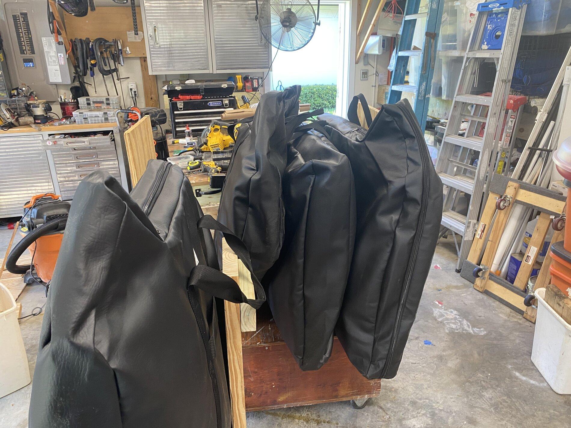

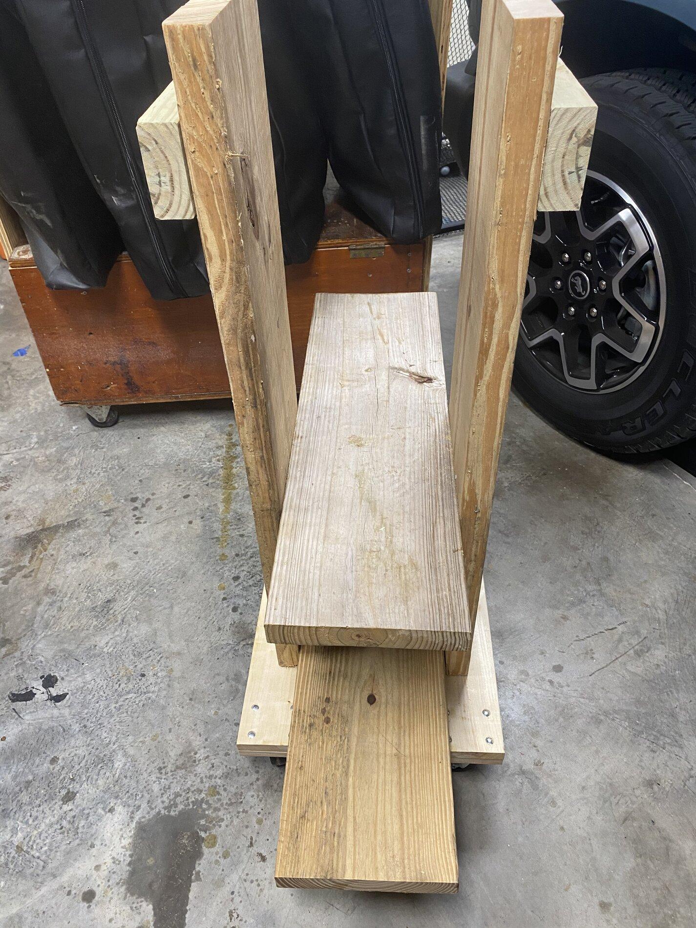

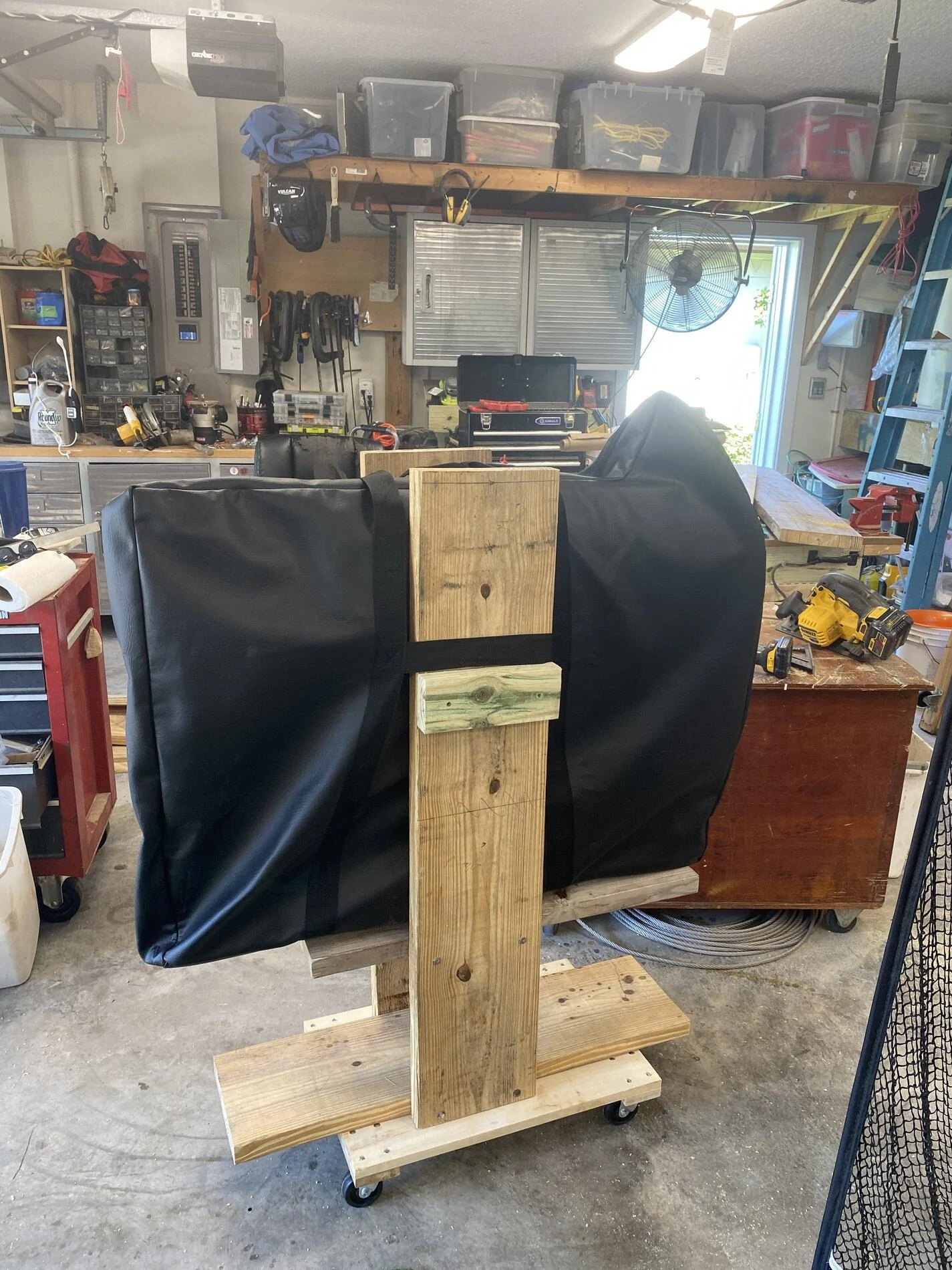

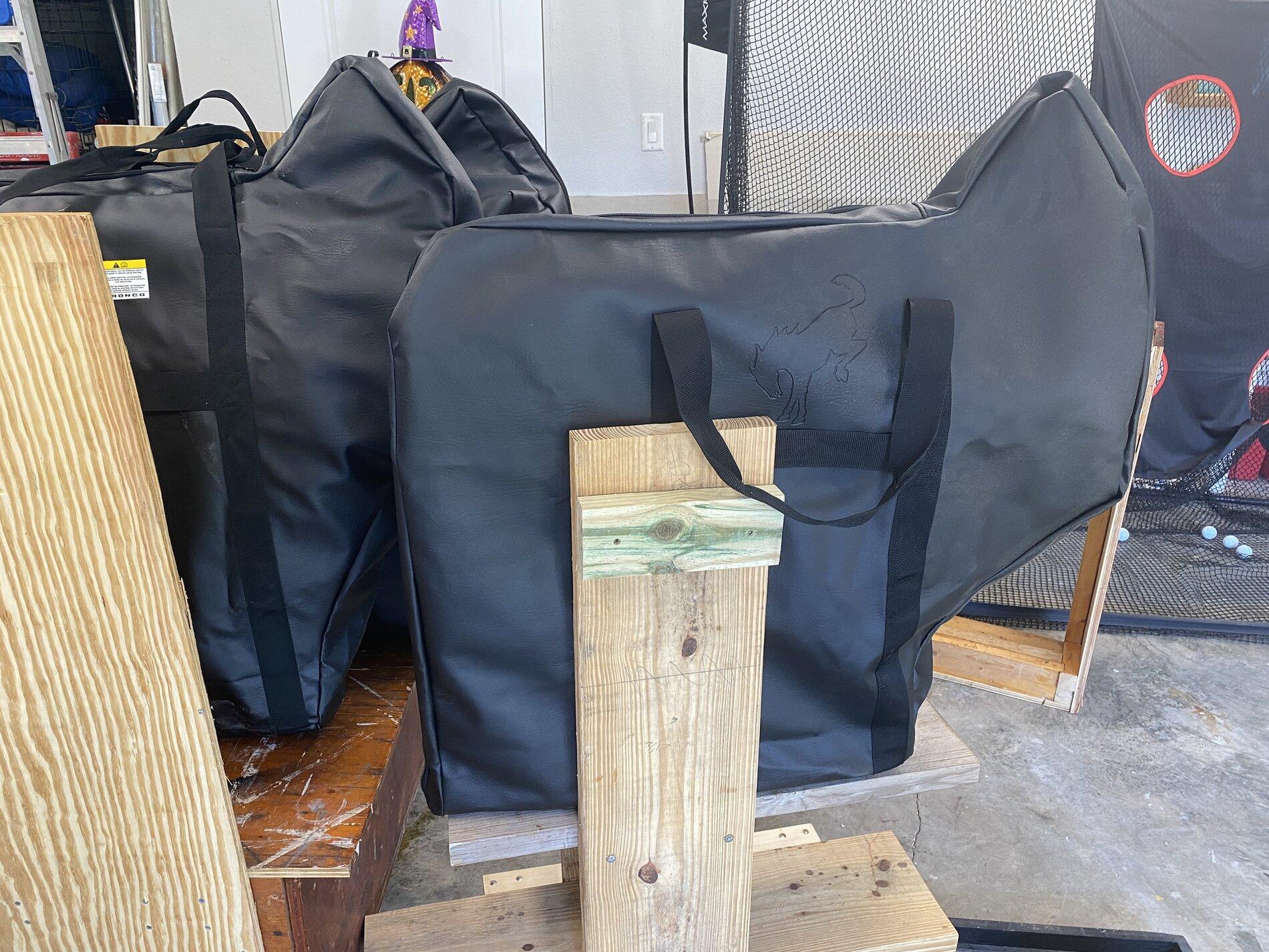

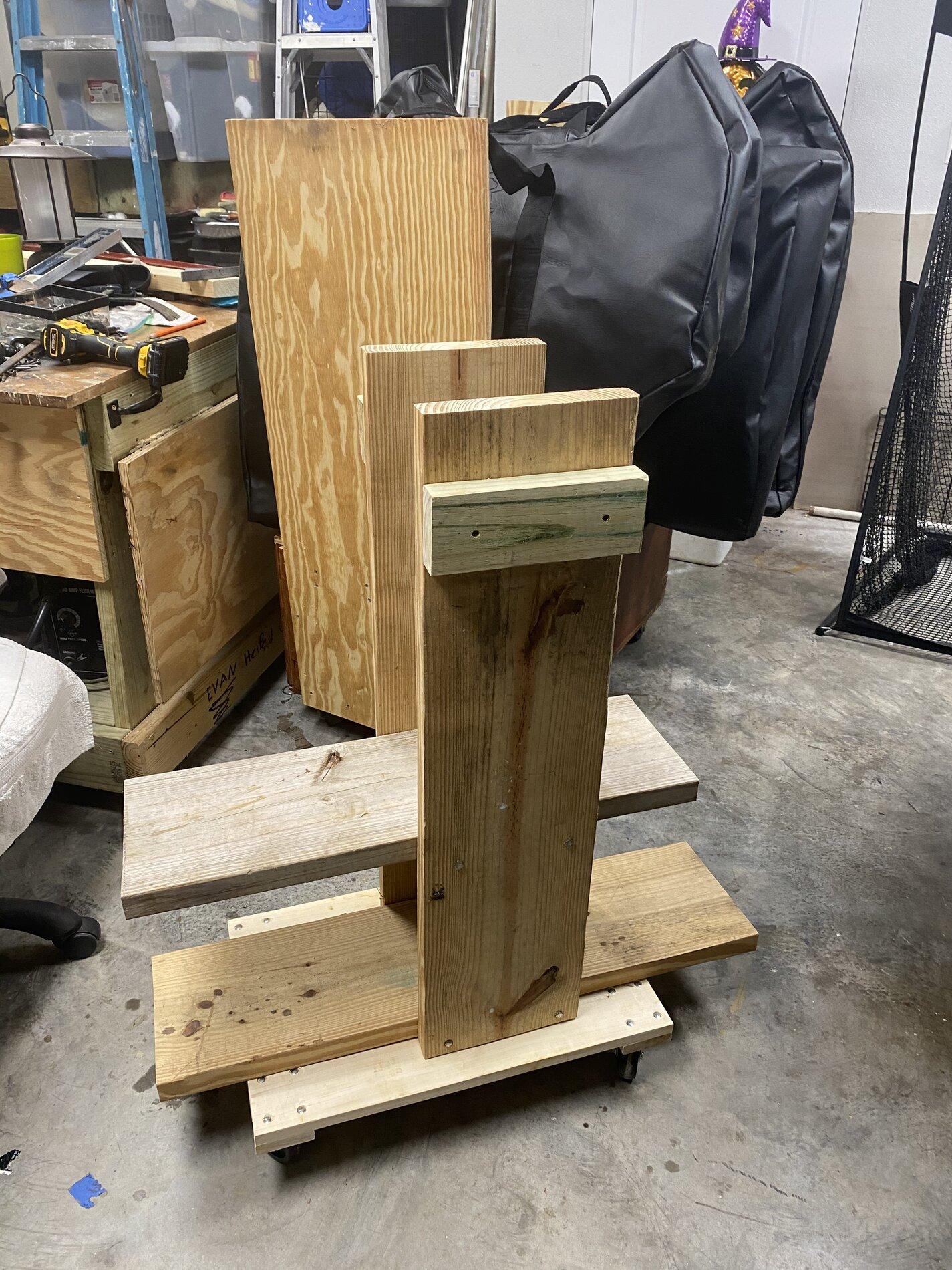

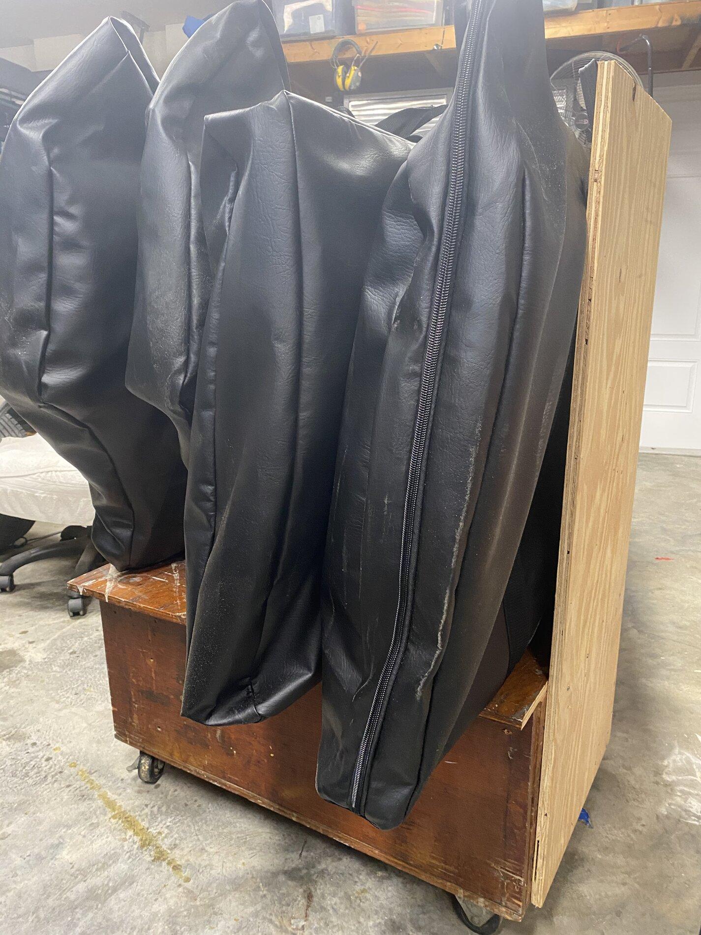

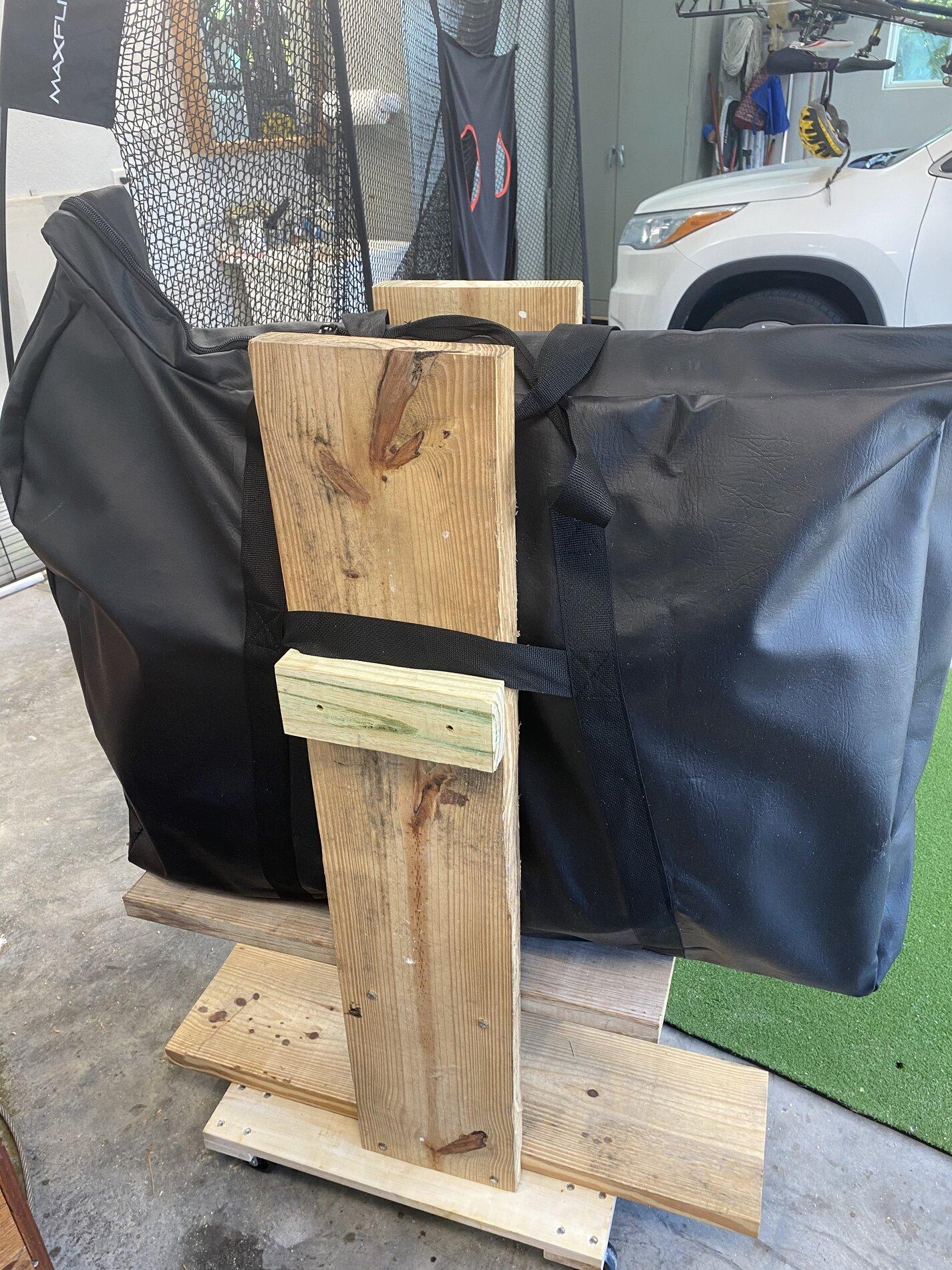

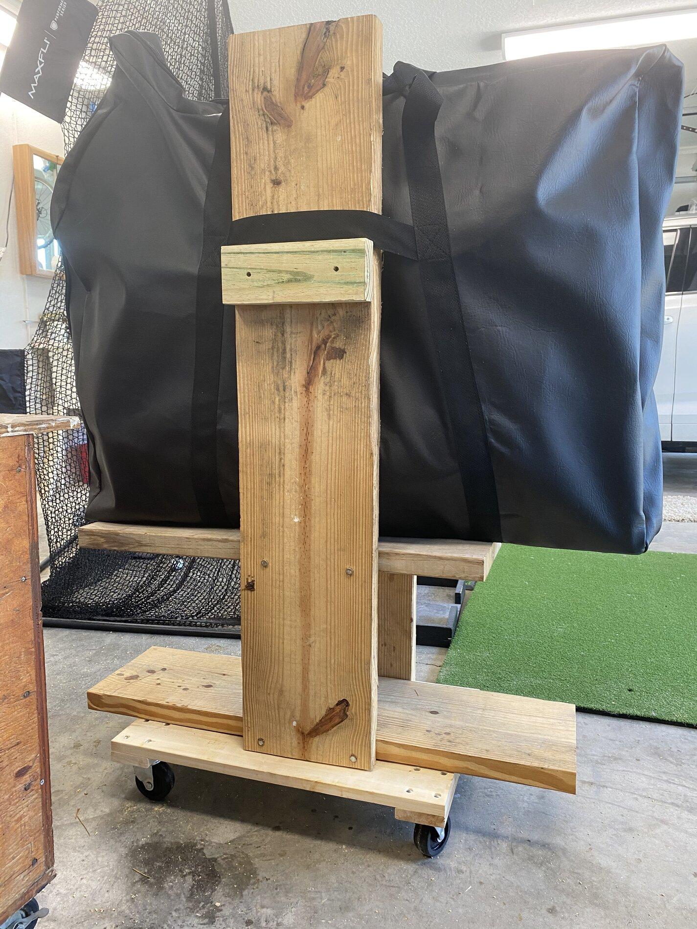

Made a prototype of a door mover for simpler, faster and more secure movement to mount and unmount the doors from the bronco. Place the padded storage casing on the trolly pictured and slide the trolly and padded storage casing onto the door you wish to take off. Unbolt door and lift about a half inch and the door comes off and rests securely in the trolly while you zip up the door storage case. Then I built a prototype storage stand to put the 4 doors onto. It is the same height 19.5” as trolly to gently slide the from the trolly to the storage stand. No dings, no dents, no scratches. And I was board last weekend. More details to come.
