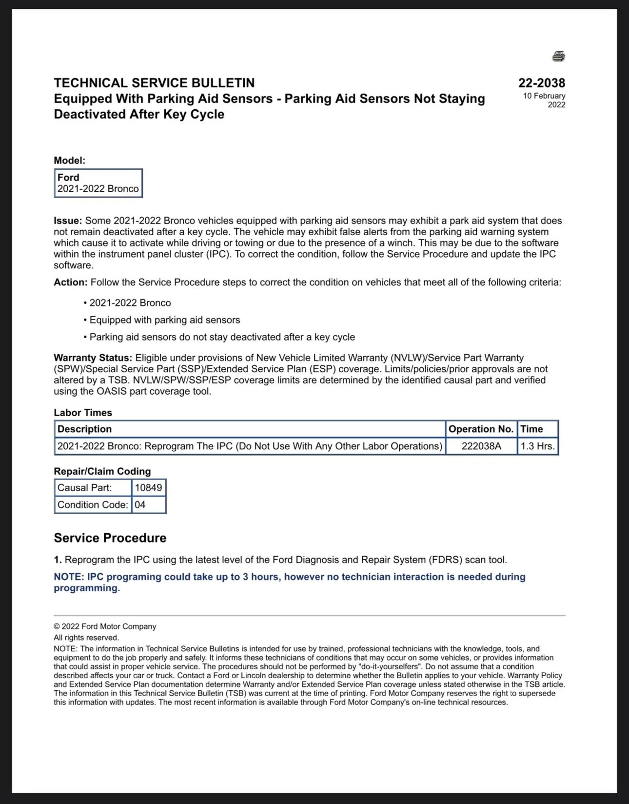

Has anyone figured out how to have the parking sensors be disabled or maintain status across starts? When I have my rear skid plate on the hitch it makes my parking sensors squawk when reversing. Would like for the button to maintain current selection even after a new start.

found the settings but this is just a temporary change. After restart of the vehicle the settings are put back. No idea why it is even an option when you have a button you can quickly push.
Ducati1098
10,061
23,434
Midwest
They are supposed to stay off. You need to go to a dealership and tell them it won’t stay deactivated. This is a known issue. Here is the TSB. They just need to do an update

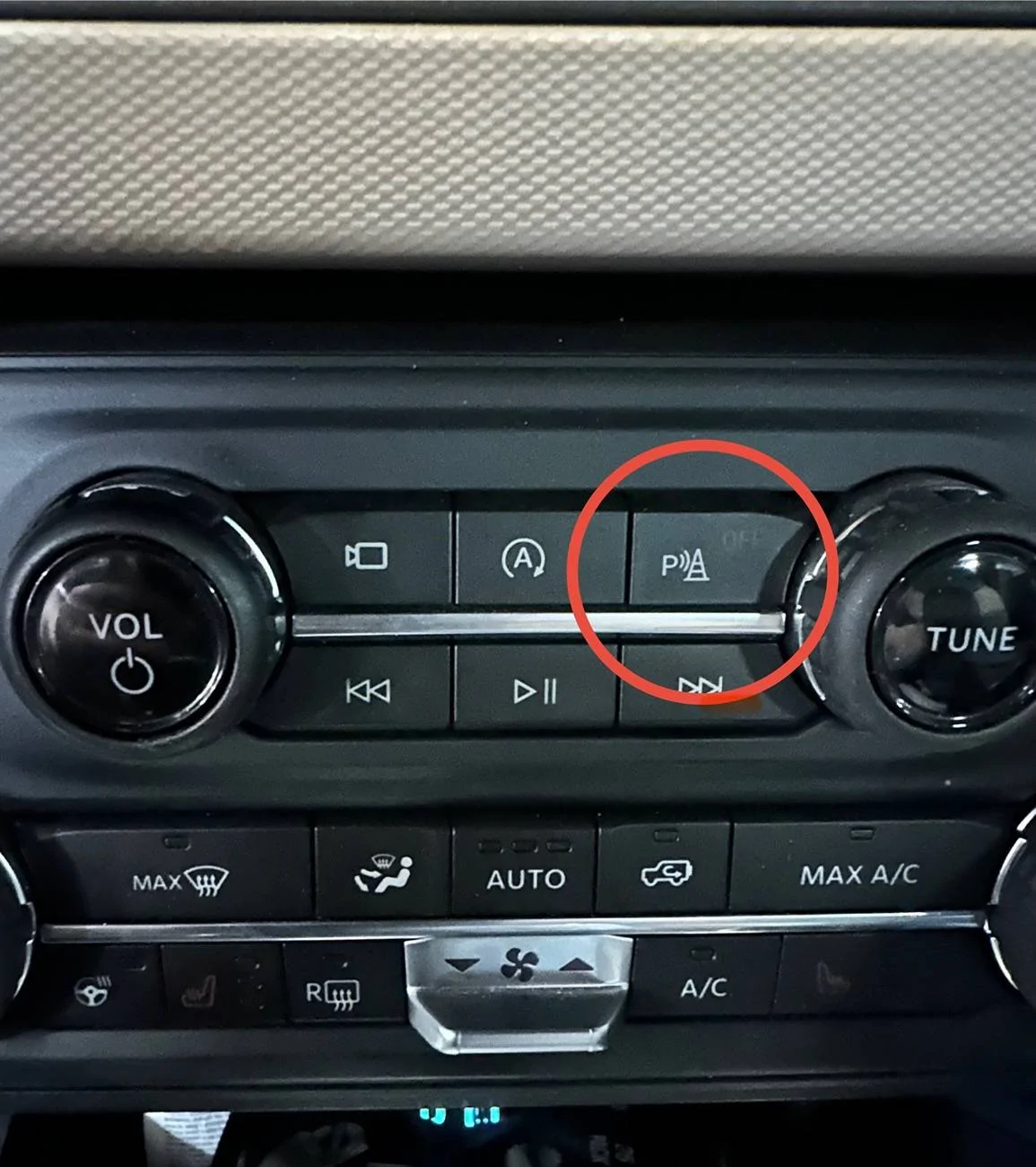

Great read. My garage is so small they scream at everything the whole-time backing in. A temporary pop up "silence" button on the screen display would have been a nice feature.
Ducati1098
10,061
23,434
Midwest
There’s a button to temporarily disable it right under the screen
Ford Bronco Disable parking sensors by default? IMG_6246
skyhunter
Apr 24, 2024
159
136
MA
2024 2DR Bronco
I must have given up before reaching that part of the downloadable online owner's manual. Dang huge file gave me a headache. I may be turning into an old curmudgeon, but I miss print media.
