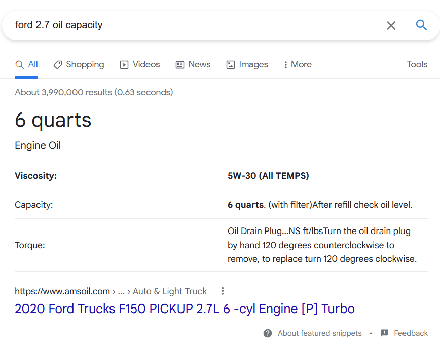

I'm sure you have discovered a hidden feature of the 2.7 that has until now been unknown. Ford engineers documented the capacity at 6 quarts. No car salesmen turned service advisor or wrench jockey will know more that the Engineers at Ford who documented it, for multiple vehicles across Ford's line up. (Yes, as a fellow engineer, I've seen plenty of engineers latch on to an issue and not let it go. Perhaps you work somewhere like Aerojet Rocketdyne in the Thousand Oaks area :unsure: )
Ford 2.7 oil capacity

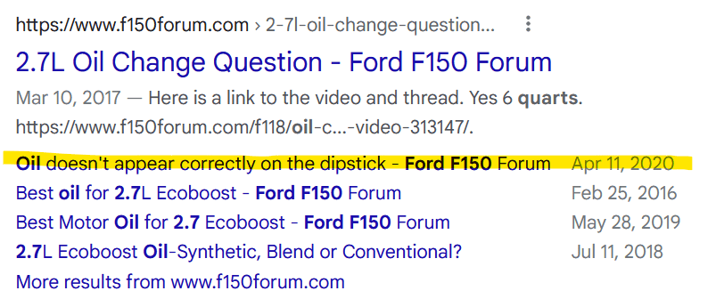

Oil doesn’t appear correctly on the dipstick

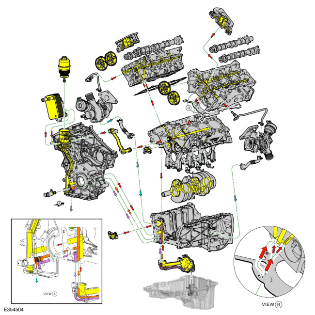

System Operation
Oil Flow
Ford Bronco Dipstick Pic? 1636630948768
ItemDescription
YellowHigh pressure oil
OrangeConstant high pressure feedback (55 psi)
PurpleLow pressure (25 psi) control
BlueOil return low pressure
Lubrication System
Continuous Variable Displacement Oil Pump
The variable displacement oil pump is designed to have the ability to change its running displacement upon command. Working together with a pressure regulation proportional solenoid valve, it can vary its displacement to produce the required oil pressure without wasting energy through bypassed oil flow or excessively high oil pressure. Therefore, its power consumption is reduced for a better fuel economy, comparing to a fixed displacement oil pump.
The oil pressure in the control chamber is balanced by the force from the pump spring in a running pump. When a given duty cycle control signal is sent to the solenoid valve, it will command a given oil pressure. If the actual oil pressure is higher than the commanded oil pressure, the solenoid valve will supply more oil to the control chamber, produce more pressure in the chamber, push the spring and the eccentric ring down, and reduce its running displacement and the oil pressure till the pressure is at the commanded level. Or vice versa, if the actual oil pressure is lower than the commanded oil pressure, the solenoid valve will supply less oil to the control chamber or even vent the chamber, produce less pressure in the chamber, bring the spring and the eccentric ring up, and increase its running displacement and the oil pressure till the pressure is at the commanded level.
The required oil pressure, i.e. the commanded oil pressure, depends on the operation conditions of the engine. Therefore, the engine runs with oil pressure at its required level without waste in such a system in order to minimize its parasitic energy loss

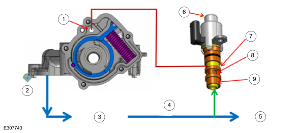

ItemDescription
1Pump control chamber
2Pump-Out
3Oil filter and cooler adapter flow resistance
4Oil gallery
5Engine oil flow resistance
6Solenoid valve
7A port - connect to pump control chamber
8T port - tank/vent port, vent to crankcase
9P port - control pressure, connect to main oil gallery

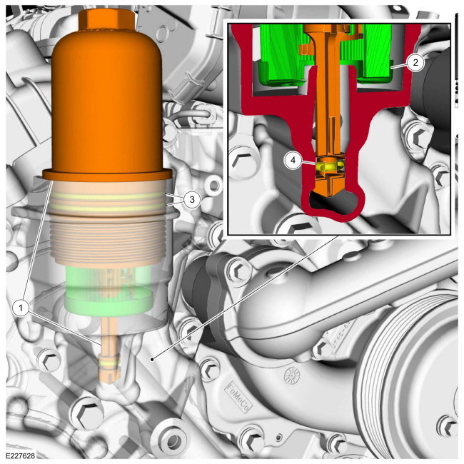

Engine Oil Filter and Housing
ItemDescription
1Oil filter housing assembly (includes oil filter reservoir and stem)
2Oil filter
3Oil filter housing-to-engine front cover seals (requires 2, included with service filter)
4Oil filter housing stem-to-oil reservoir drain port seal (included with service filter)
During oil filter removal and installation:
  • The oil filter housing and stem must be inspected for damage including cracks or separation of the stem from the housing. If damaged, a new oil filter housing assembly must be installed.
  • The 2 oil filter housing-to-engine front cover seals are included with the service filter and must be replaced to prevent oil leakage.
  • The oil filter housing stem-to-oil reservoir drain port seal is included with the service filter and must be replaced. If this seal or filter housing stem is damaged or missing, the oil will flow through the reservoir drain port and a loss of engine oil pressure will occur.

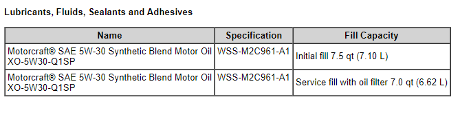

If the WSM is correct the initial fill was 7.5qt. 1/2qt hanging around the top end, passages, turbo, etc would make sense. The problem is those that have put 7 back in and being way over the top mark. 6qt puts it in the correct range but conflicts with the "oil consumption" diagnostics in the manual and factory fill level as shown in my pic.

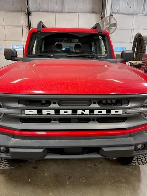

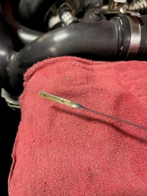

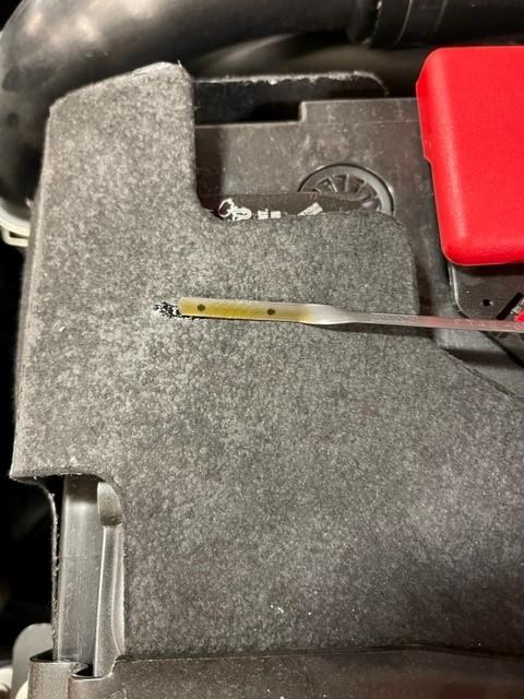

Here's our FCTP, 20 miles.
Sitting inside since last night, checked 3 different times. Same general area as mine which is right below the twist.
One would assume if the dots are correct, this is abt 1.5qt over (top dot 1qt over, bottom 1qt under).

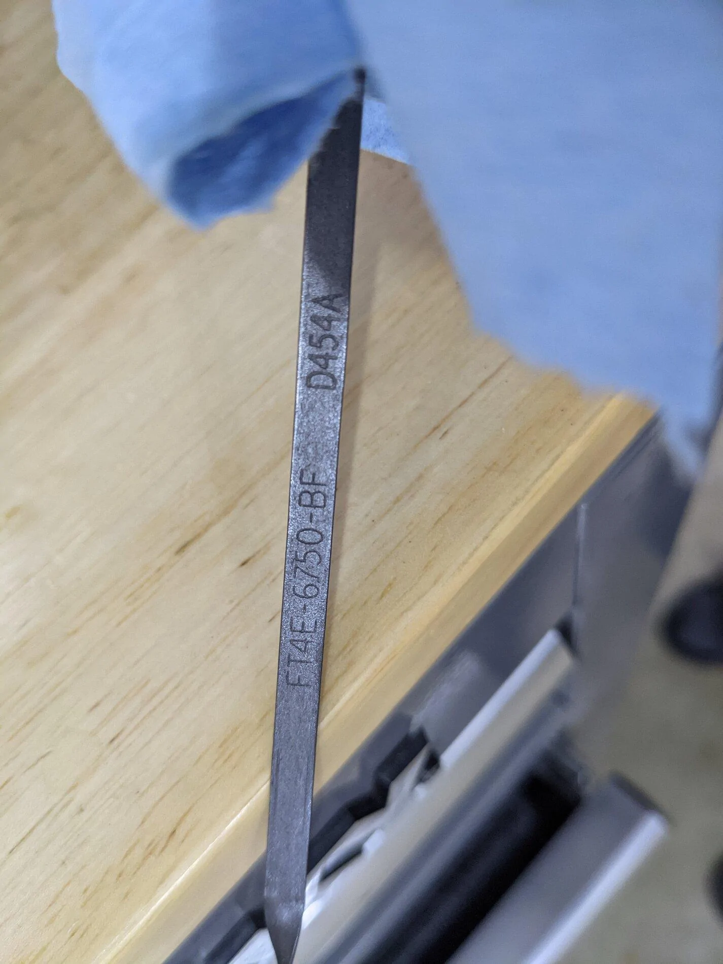

I just changed my oil tonight in my 2.7. I can't say how much oil came out because my catch pan overflowed and SO much oil spilled into my garage floor... lesson learned there for sure.
Before the oil change, checking multiple times, oil level was OVER Max, into the twist area of the stick(seems common here).
Followed instructions for draining oil, other than spilling a ton of it, so stupid...and filled it with 6 quarts of oil. Let it sit for a few, started it and ran it for a few. Let it sit for a while and checked multiple times, and oil level is at the minimum oil level hole.
I will check again in the morning, but it looks like it's going to take 7 quarts to get it to the full mark.
Edit: I added a picture of my dipstick...part number that is.

Just had to rescan this thread. So nobody else has posted their dipstick part number.
If yours truly take 7 quart to get to the full line (but not over), this will set the standard to possibly solving this.
Once you've added your additional quart can you take a pic of the level hash on the stick.
