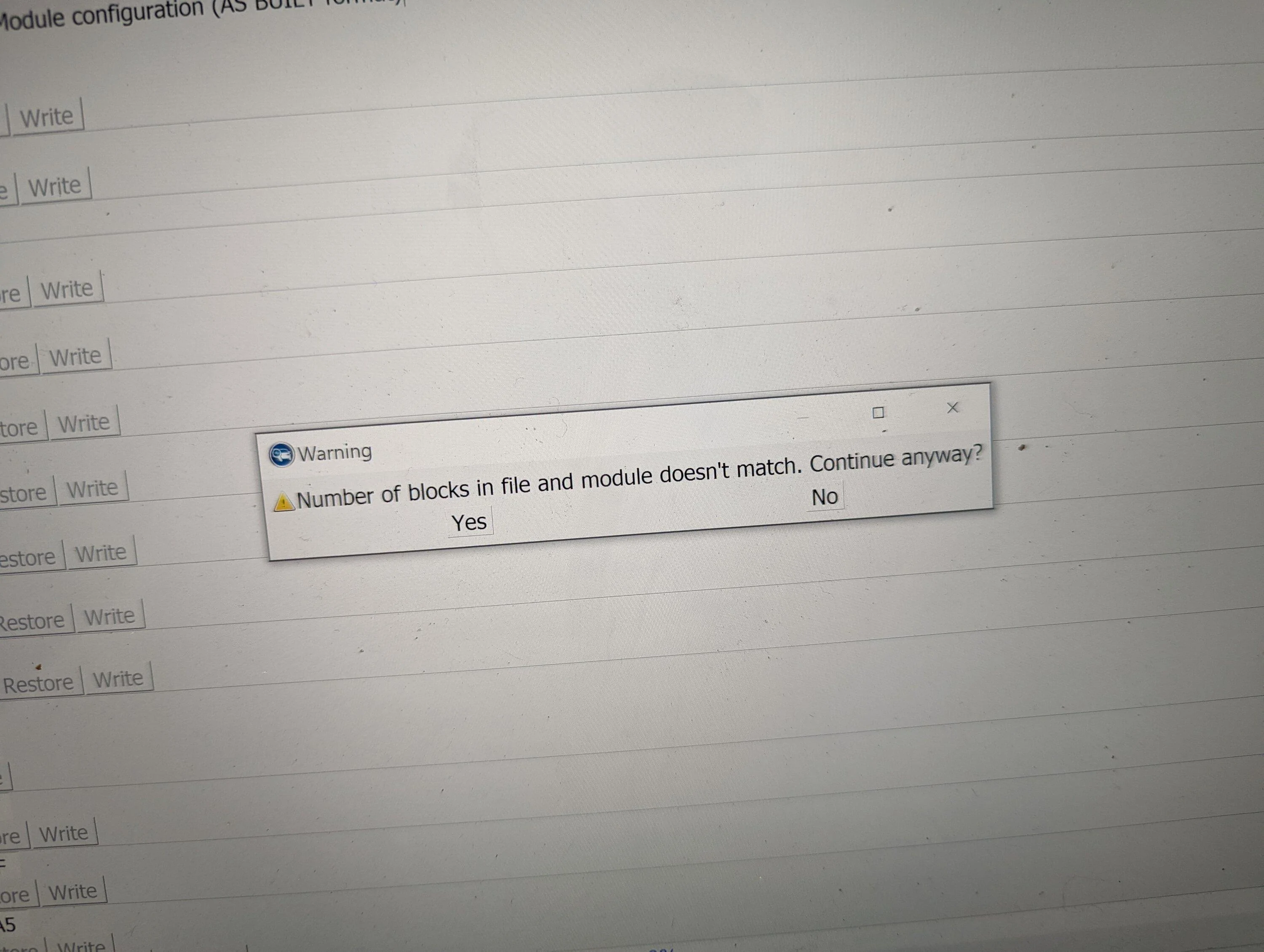

I disabled the double honk and added sport mode with forscan. It was fine for a few days then today in the morning I get a msg from Ford pass app that remote features disabled bc of low battery. I go to start car and it won't let me. I get park brake fault and service advance trac warnings and the engine won't turn. I used a jump starter and it was just fine. Voltage read 12.9. it's been running fine except now the windows won't roll down as you close or open door on driver side only. No warnings. I figured it was forscan and I loaded defaults but it gave "number of blocks in file doesn't match. Do you want to continue?"
I pressed continue and reset everything but I'm still getting issue with door window not rolling down.
Was it forscan? Or electrical issues? Gonna go to dealer tmrw, hopefully I didn't fuck up the cars computer with forscan.

I think when battery dies, you have to recalibrate the windows.

I wouldn't jump to conclusions too quick. Sounds like the battery. Check your connections, give it a good charge, reset your windows. I believe you roll them up and down 3 or 5 times. Or hold the button in up/down position. I disconnected my battery a couple times and some windows rolled halfway down on their own after you rolled them up. Just needed recalibration.

I think I should still go to dealer to have it inspected. It's weird that the battery should die after only 800 miles.
I got a random "Charge system fault" message, but I had truck on and not running.

can't remember and i'm about to sleep so not going to search through all the threads... but check if people had warranty issues due to using forscan. depending on your dealership i'd imagine they may or may not charge you for this fix.
You were right. The battery failed the load test. Guess it was sitting too long waiting for mic top.
Got a new battery from dealer and they reset my windows.
