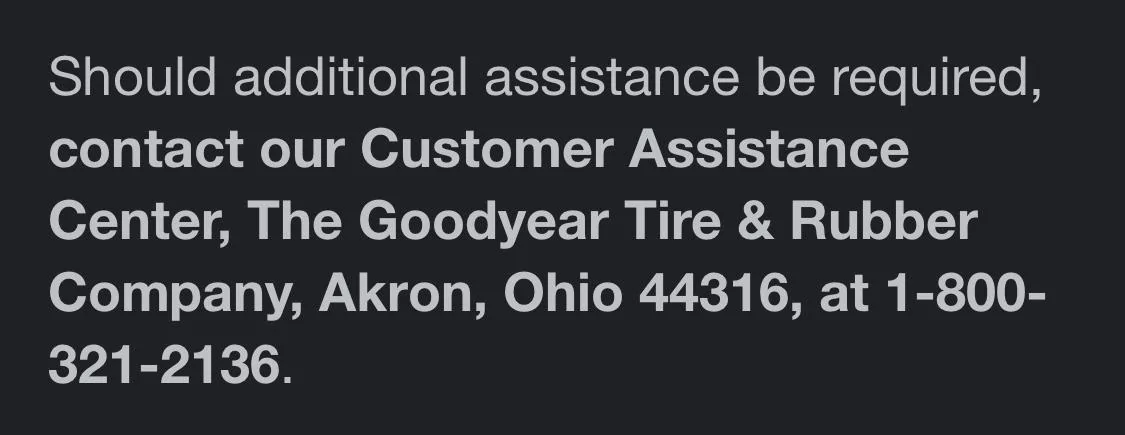

So if it’s defective, then Goodyear should replace it, right?
Yes! If they do theirs like we do ours. Goodyear should replace any defective tires. I believe have to call Goodyear though. Dealer may be able to help. Not sure. Usually got to go through the OEM manufacturer!
