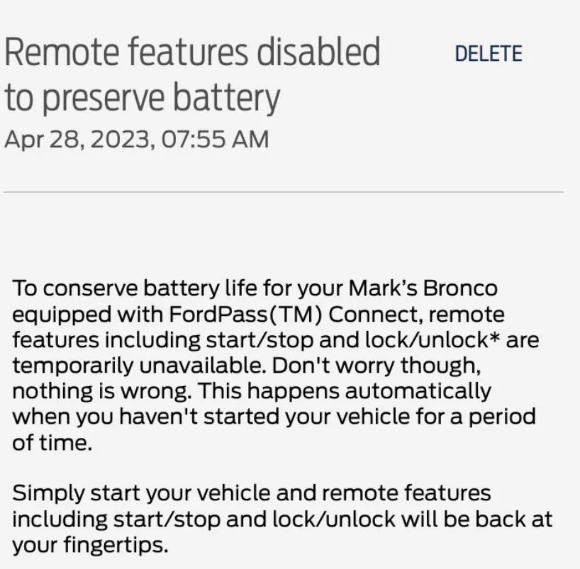

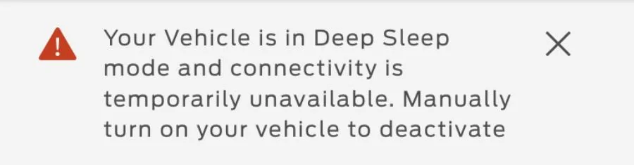

So I have been out of town and today FordPass sent me a message that my Bronco is in deep sleep mode to preserve the battery. Is this based on a time interval or related to battery charge? If it’s the latter I plan to use a trickle charger before my next extended absence.

I got the same message on Ford Pass as well, I parked the Bronco in the garage for the winter and went to Arizona for a few months. I put it on a trickle charger before I left but got the same message. It started right up when I got back home. I'm guessing the trigger for it to go into that mode is long periods of inactivity rather than battery state.

The message appears on your Ford Pass around two weeks of inactivity. As explained earlier, your vehicle modules will draw a small amount voltage. Plus your vehicle and remotes are always sending signals back and forth to each other.

It’s a lot less than two weeks, I park mine for six days at a time when I go to work. Every time around day 4-5 it goes into deep sleep. Living in the NE it sucks coming home from a trip and not being able to remote start it on the bus from the airport.
