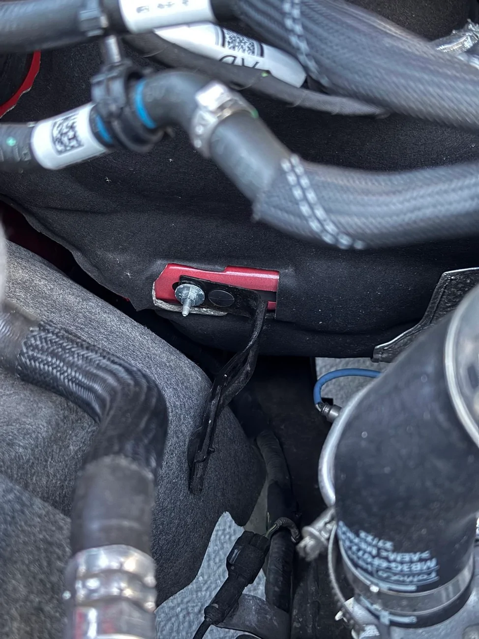

Ford Bronco Dash Rattle 2022 Bronco 1784598512676-lo
Bringing some old threads to light in case I can help someone. I was chasing a passenger side dash rattle for months. Ended up being this "L" bracket on the passenger side inside the engine bay. It was loose.
