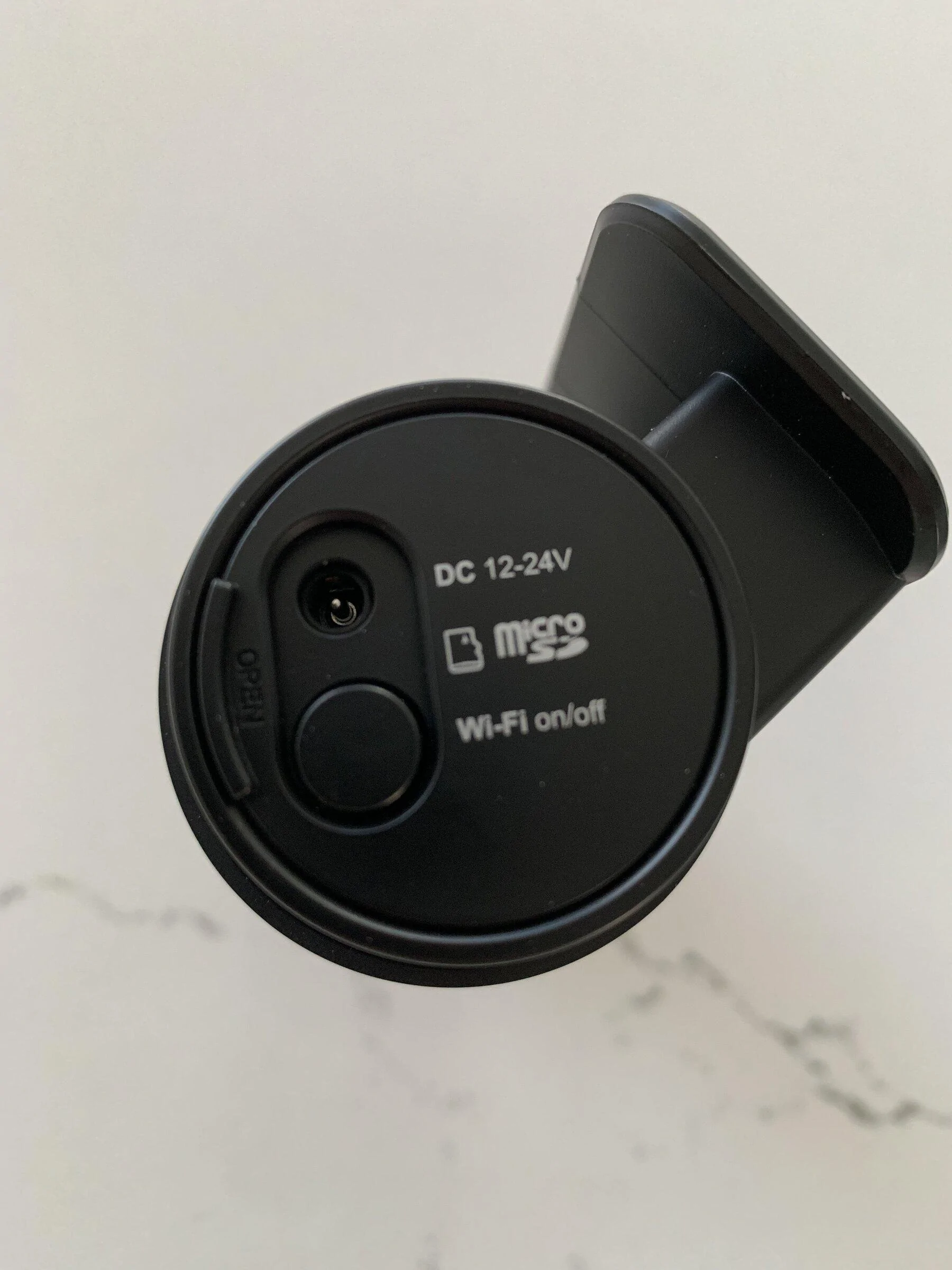

Anyone aware of a ”DC 12-24V” to “USB-C” cord that would power a dash camera? I feel like this would be ideal, since I have the power port on the dash. I’d prefer to mount my camera on the dash anyways, in case I need to replace my windshield… one less thing to re-do.
Thanks!

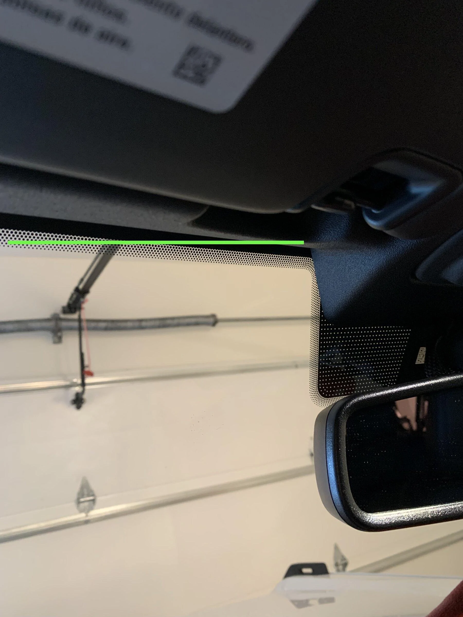

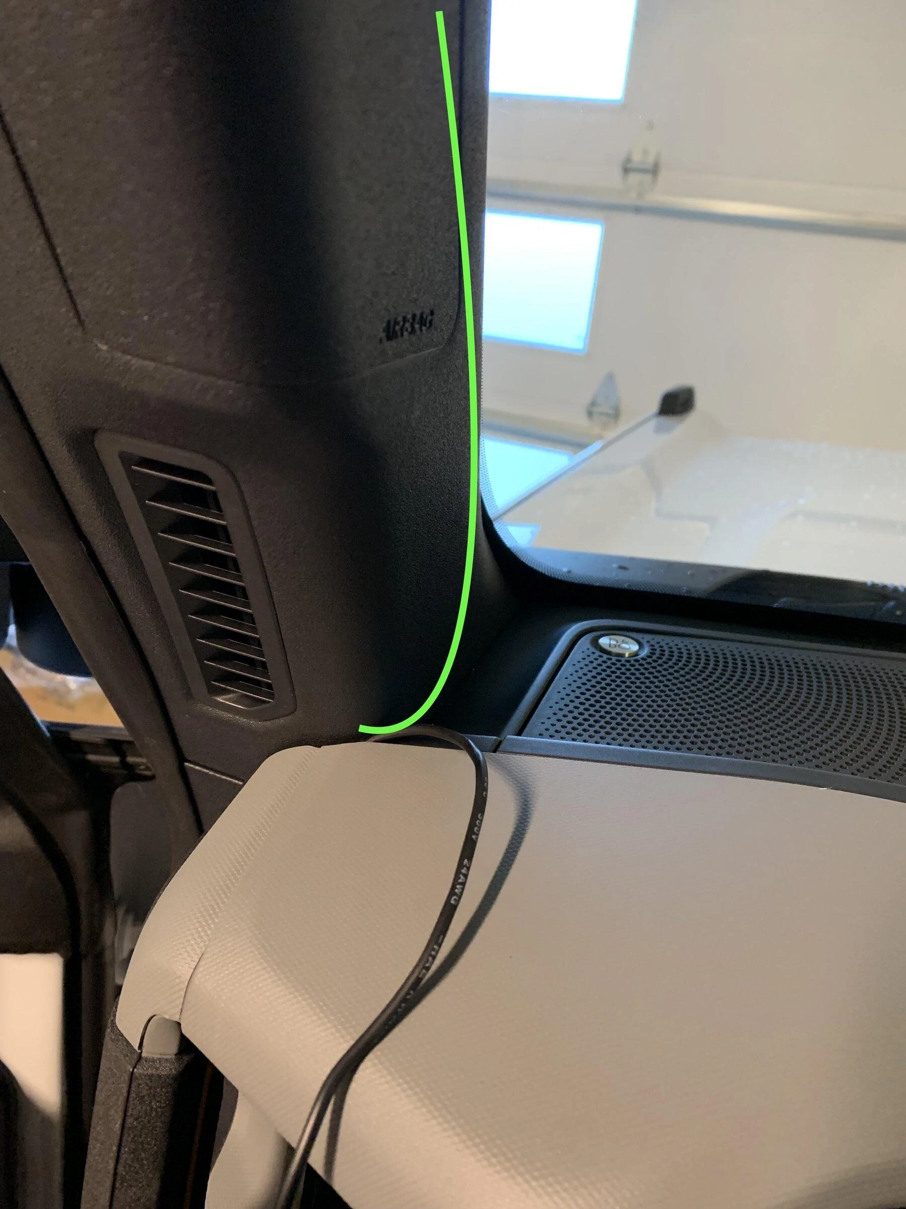

Hey folks,
I'm having some issues, and I know many of you have installed dash cams already.
I've wired everything but seem to be stuck concealing the wires along the top of the windshield, as well as down the A pillar. I also don't want to snap or break anything, hence asking for help haha.
I don't need ideas on other paths to take; I'm already committed to this one lol. I just need help on how to remove the A pillar trim, as well as if I need to remove the headliner slightly, how I do that. In the past, I could just tuck the wire up there very easily; not the same on the Bronco it seems.
Thanks!
