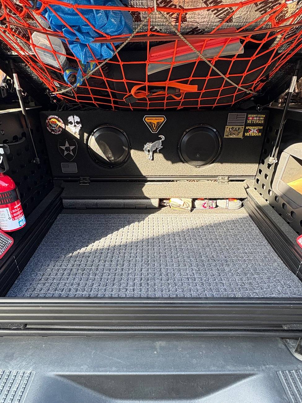

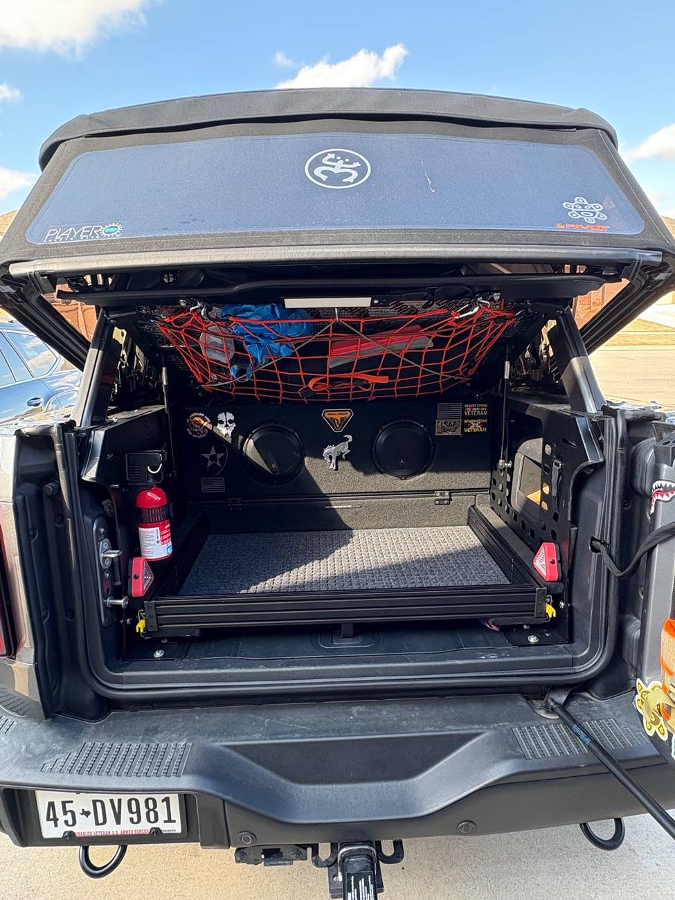

I made a slide out using 1030 aluminum extrusion from T nutz. Still working with the final product as the extrusion can be adjusted. Drawer slides and brackets sourced from Amazon. Saved me some money as compared to comercial items. Sturdy and practical. Making drawers with it should be easy as you can add connections to a frame.
This looks great! My goal is to build a modular system that I can put in when camping and then removed when I need the storage space.
Man this is really great. Without a doubt the nicest looking solution I’ve seen.
Awesome looking Slide-Out! The ultimate complement is duplication. Can you share your parts list and retail sources. Great job.
