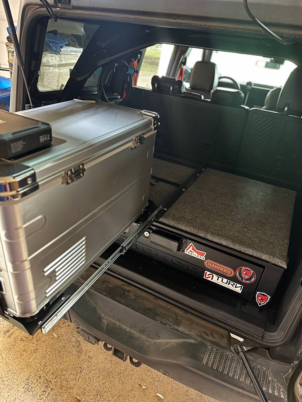

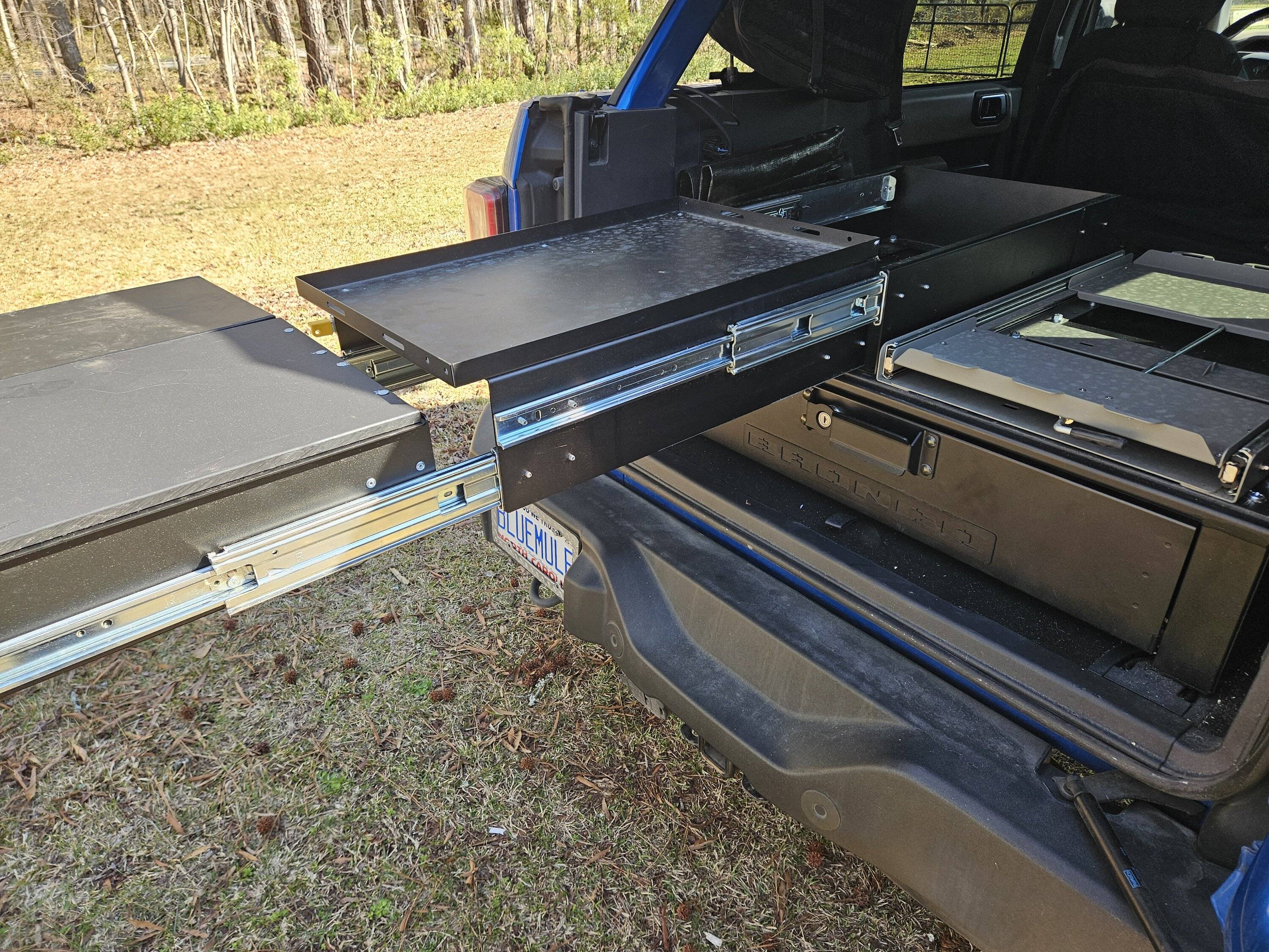

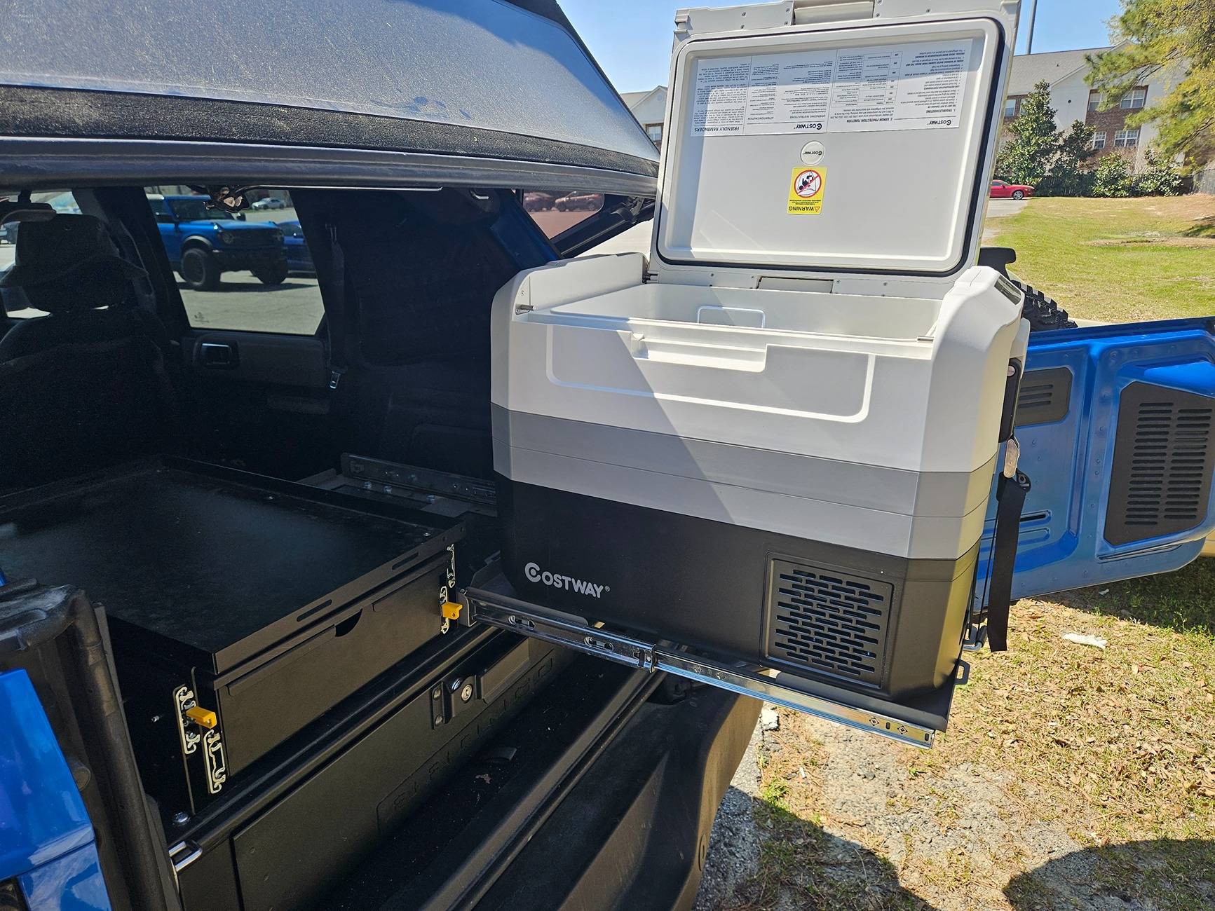

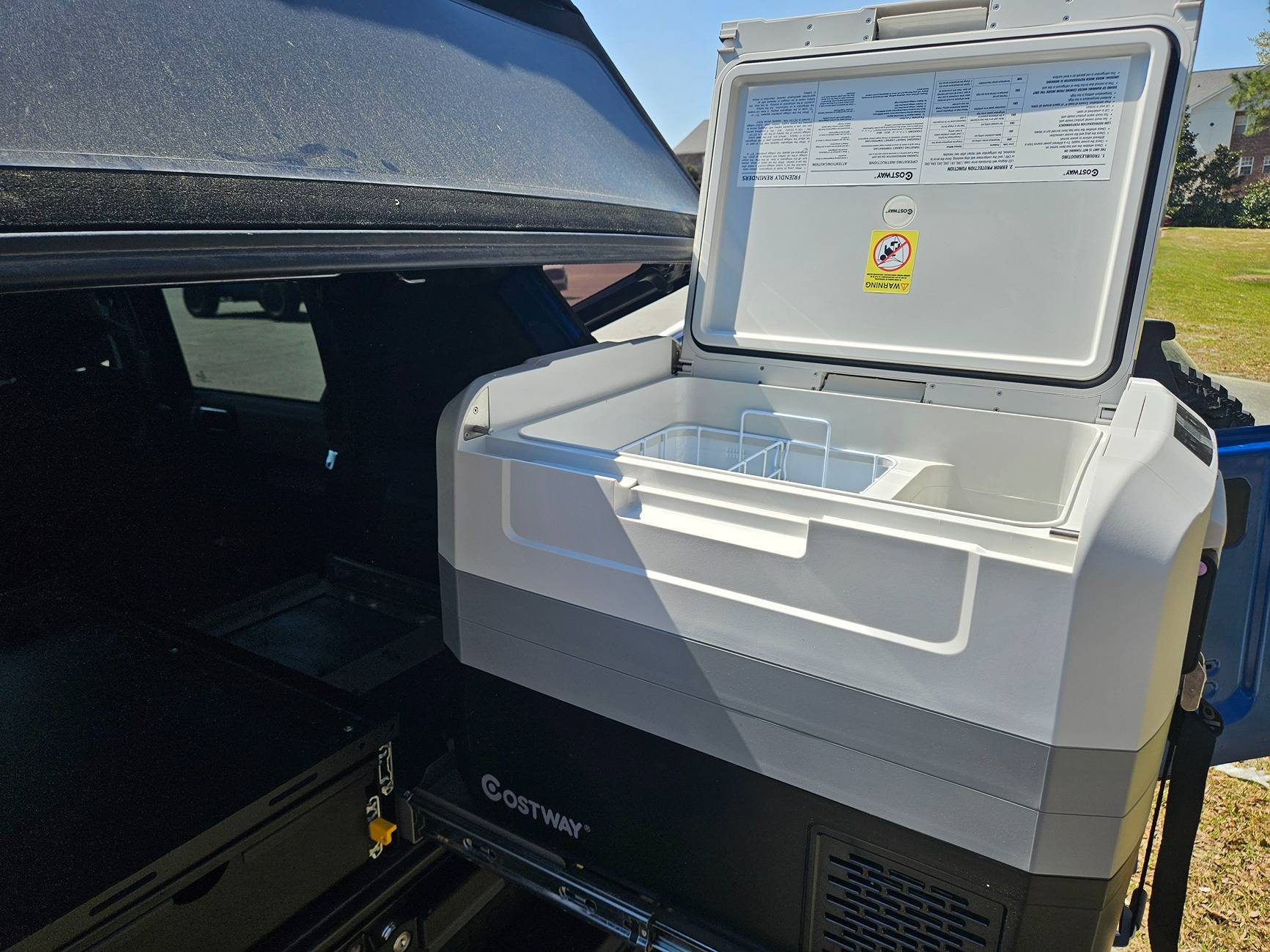

Fridge came in last night. Tight fit but it opens. At least if push up on the top a little bit.

What system do you have above the Tuffy box? I think I like this instead of the plywood I used.
I added 3/4 plywood sprayed with bedliner. the fridge slide is one from setpower and the camp kitchen is from moyyride.

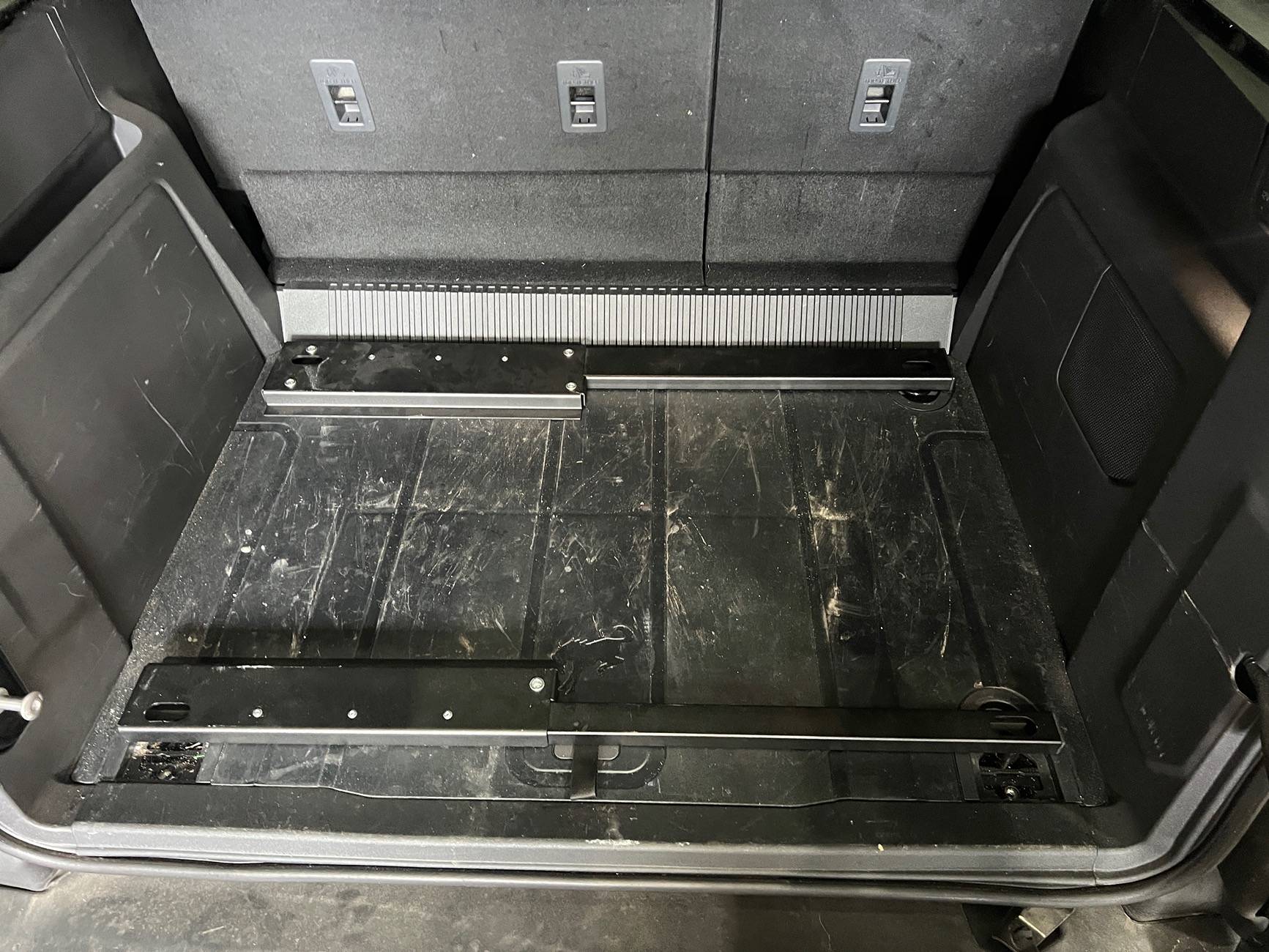

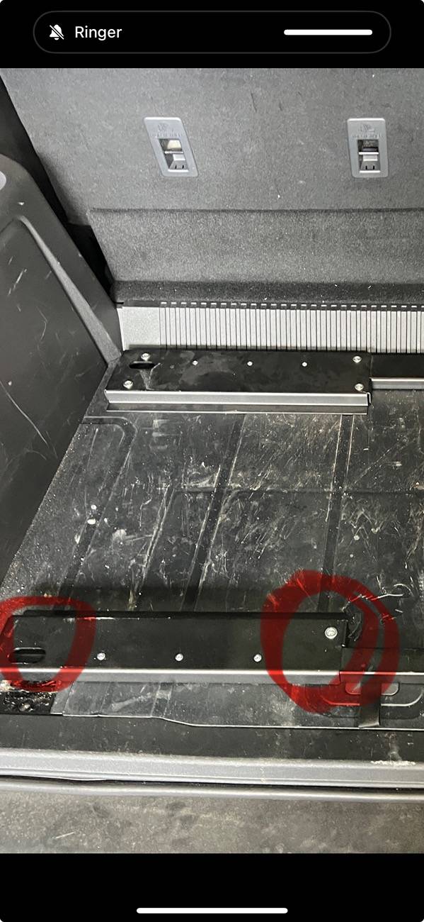

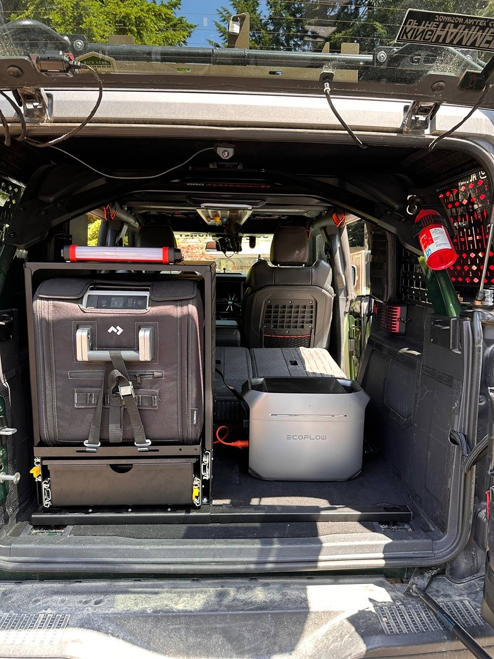

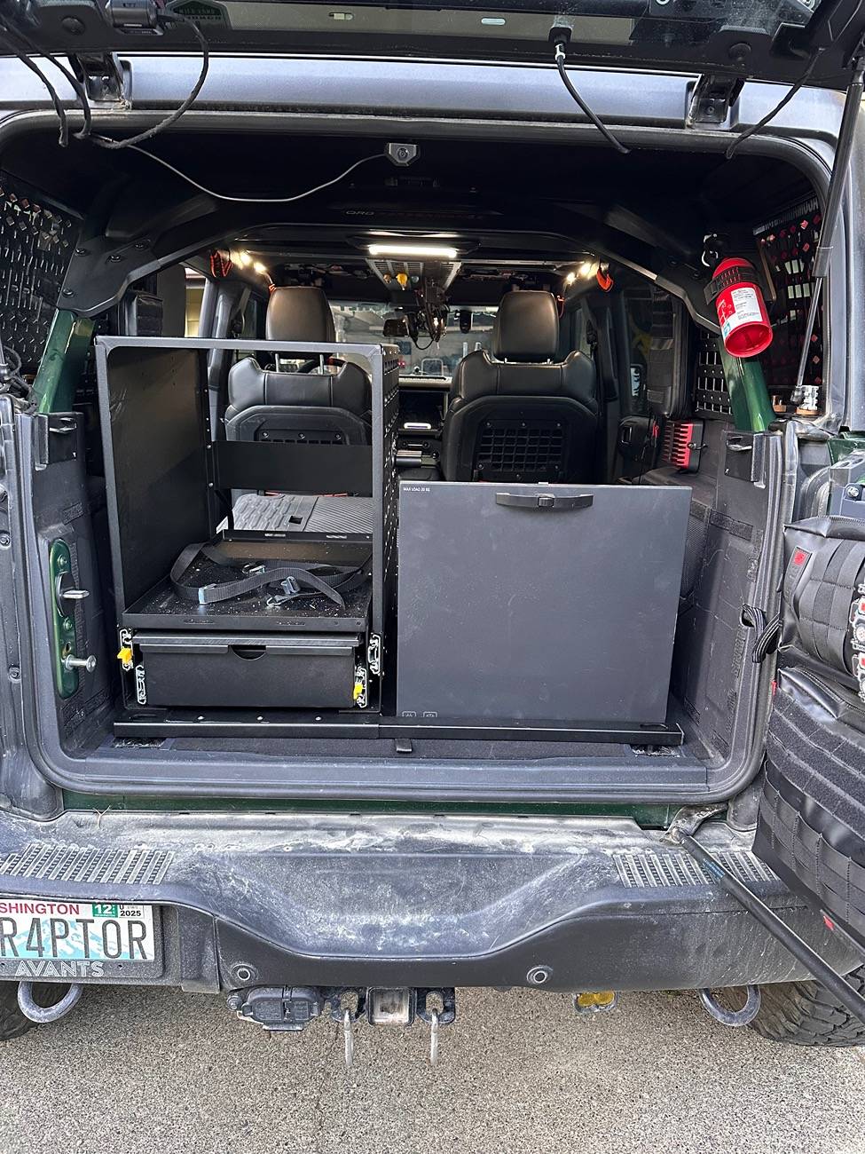

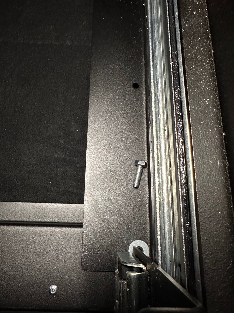

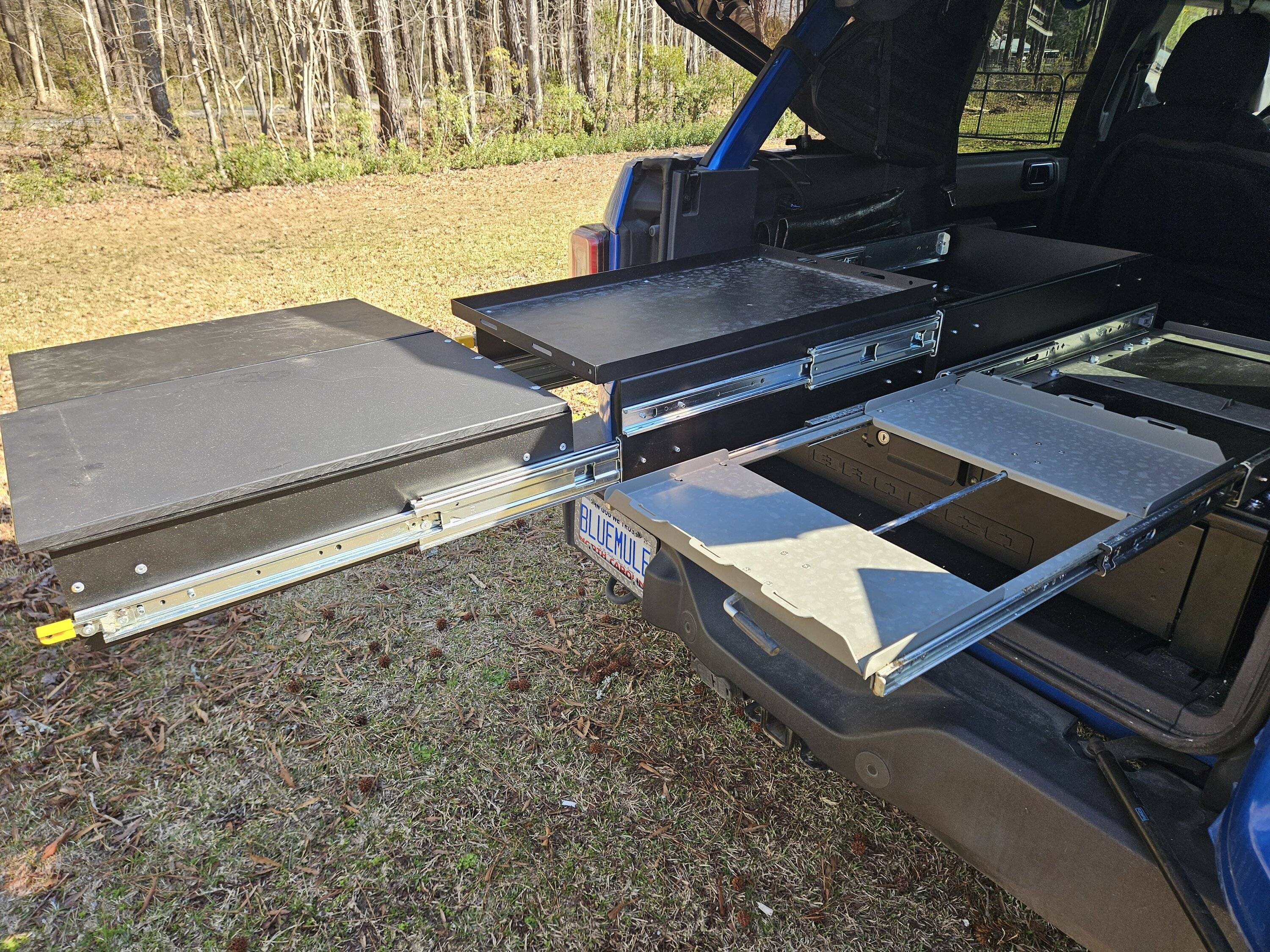

I am installing the camp kitchen as well and struggling with the forward bolt holes. How did you get access to those to complete the install? I have tried unsuccessfully from above.
my installation looks a bit different because I am using an unreleased, pre-production version of their no-drill kit for Bronco. The no-drill kit doesn’t really change anything as i think the problem is how do you get a tool in place with the fridge slider as fully extended as possible, as it does not seem to be possible to remove the slider itself (unlike conventional drawer slides these lockout ones don’t appear to have the capability to be separated; and the slides themselves seem to be riveted to the enclosure, so you can’t remove the slide and drawer slides together, either).
Ford Bronco Fridge slide and cargo drawer installed IMG_7755
Ford Bronco Fridge slide and cargo drawer installed IMG_7754
Ford Bronco Fridge slide and cargo drawer installed IMG_7753
Ford Bronco Fridge slide and cargo drawer installed IMG_7750
This last photo shows a dry fit of the camp kitchen enclosure in the no drill kit. I am building my own storage on the right using drawers from my teardrop camper and a frame built from Richlite. The American Adventure Lab tray above is actually for a 2-door with the AAL seat delete that I purchased used before realizing that it’s larger than a 2dr tray, smaller than a 4dr tray and there’s no way to make it fit in a 4dr (or a Braptor with a cross brace). However it’s a perfect fit for this application and will be hardmounted to the top of the enclosure (vs normally where it’s mounted to the internal C pillars in the bronco).

My slide unit was just a universal mount that was for a jeep off of FB. I mounted my plywood to the Ford cargo drawer and the slide to the plywood. If need be I can quickly remove plywood and all.

Thank you for the reply. I eventually managed to get it installed today but it was a pain. The issue is that the through-holes in the bottom of the kitchen are identical in size to the nutserts in the no-drill kit, so you have to have the kitchen perfectly lined up to ensure the bolts don’t cross thread. The simple solution would be to make the holes in the bottom of the kitchen a bit larger to allow for some play but they haven’t done that, at least with the unit I have. But it’s in, and it’s definitely substantial.
