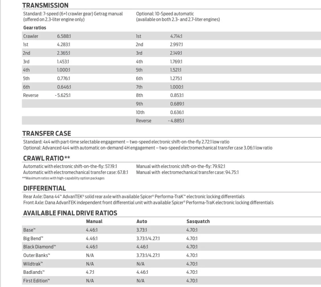

He uses the final drive ratio for Sasquatch for the calculation. What is final drive ratio for the non squatch.
you can get the 4.7 rear and manual ONLY on the badlands package. Same thing as sasqutch but with 0.5” less lift and 33” tires.

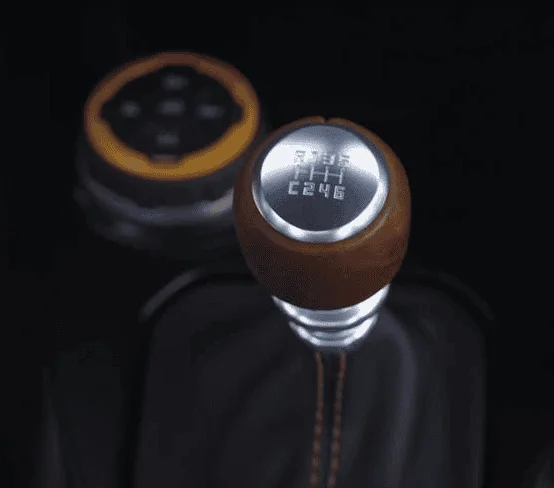

What I cannot find anywhere is if the crawler gear is locked out until you put the vehicle into 4Lo?

I remember seeing somewhere that Ford said you would not even need to disengage the clutch to start the truck while in crawler gear. Just crank over and you're off, pretty awesome!
