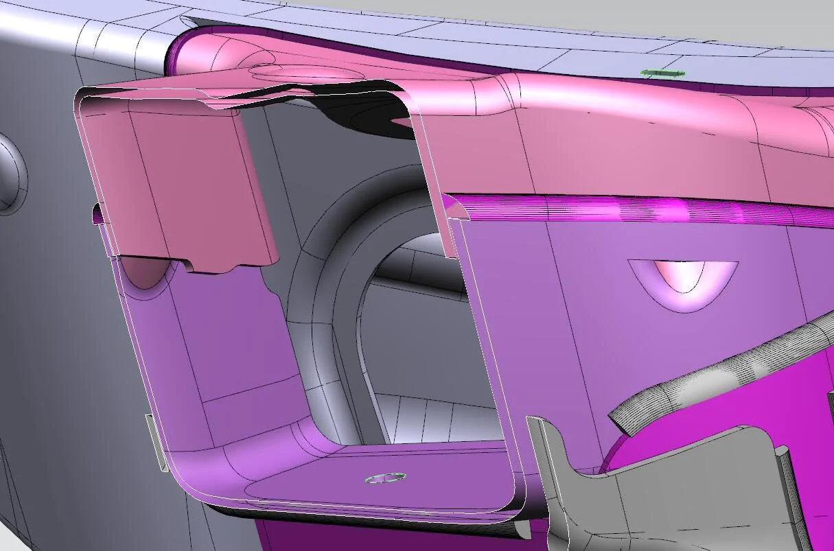

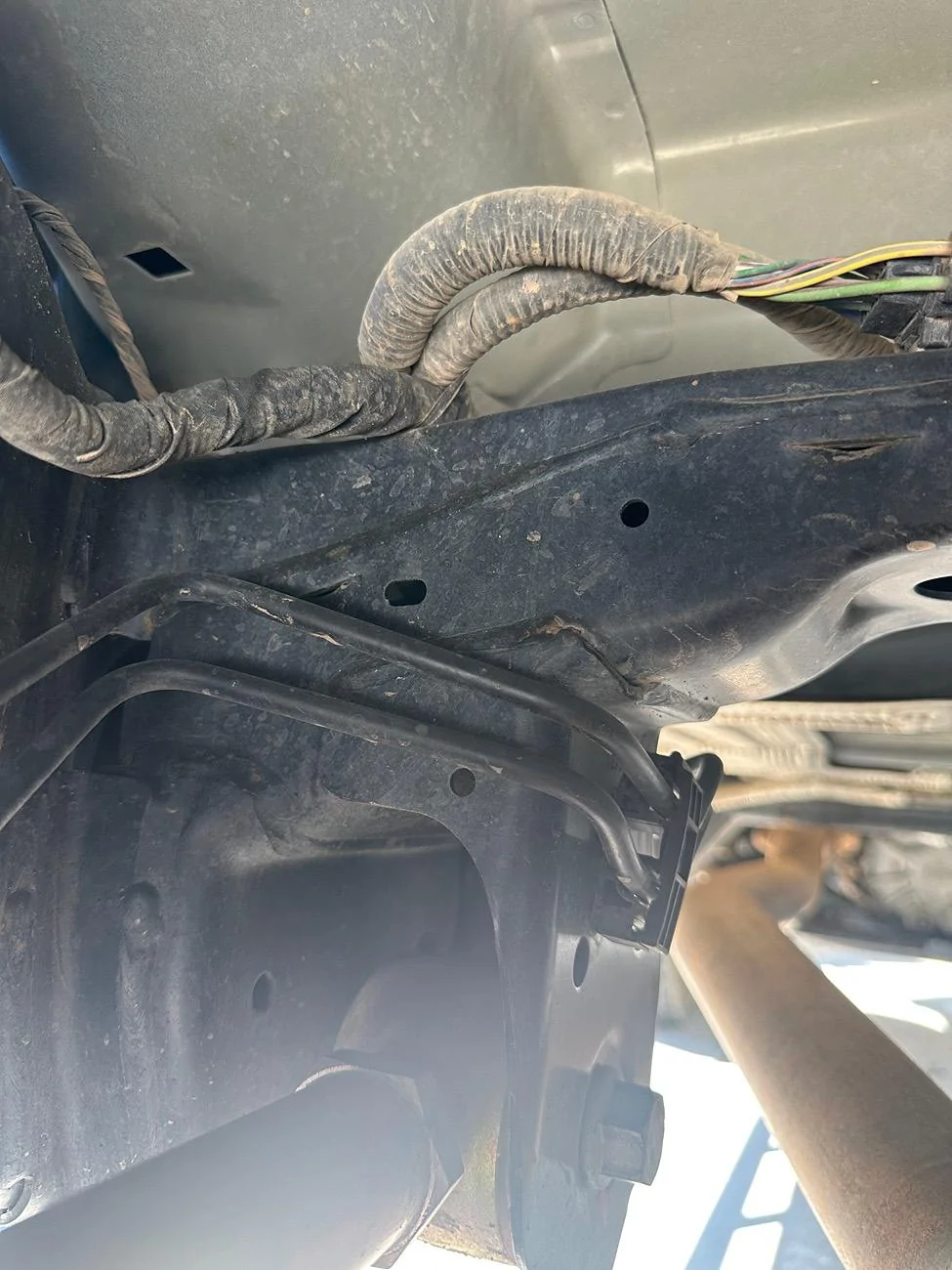

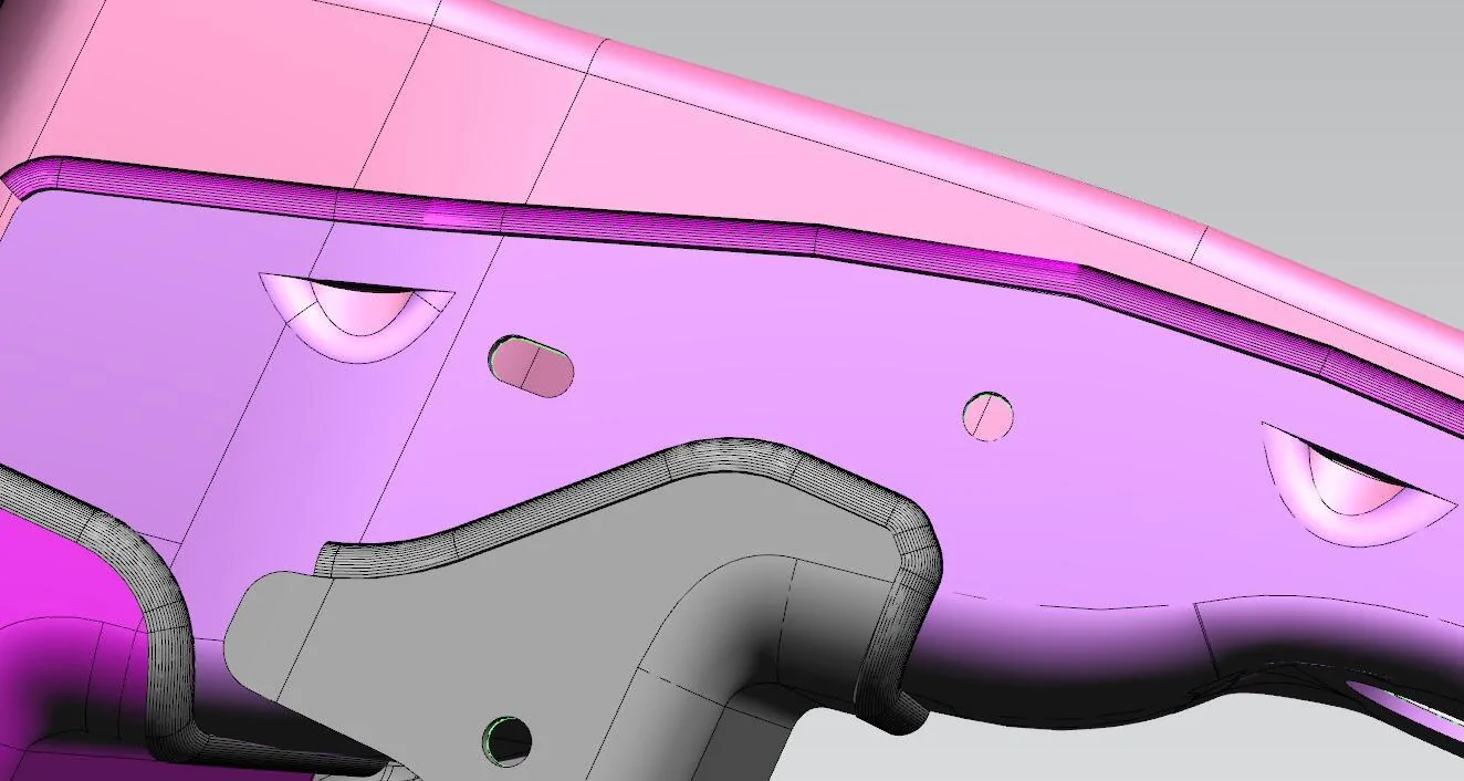

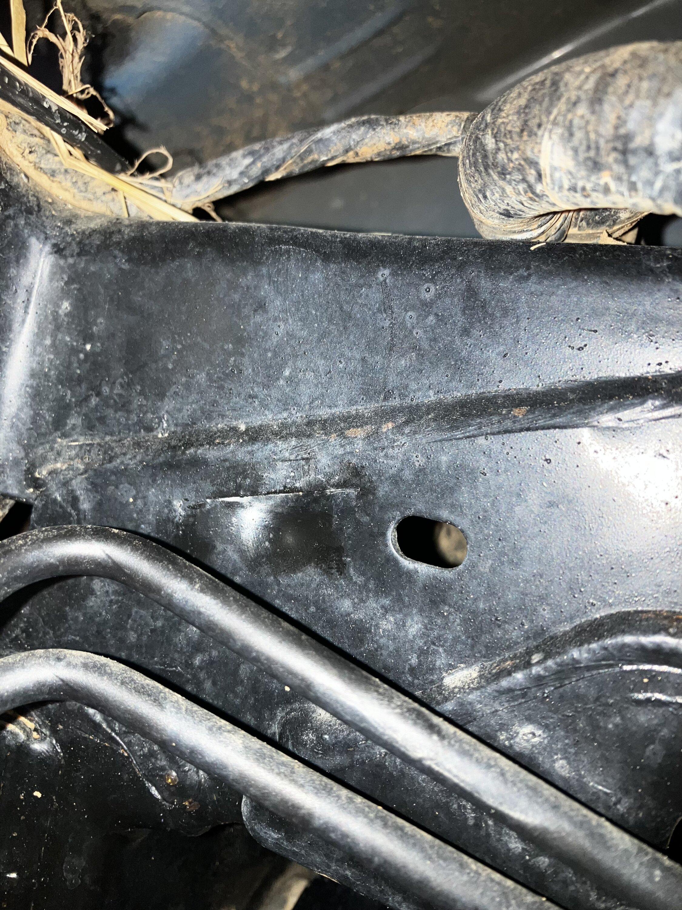

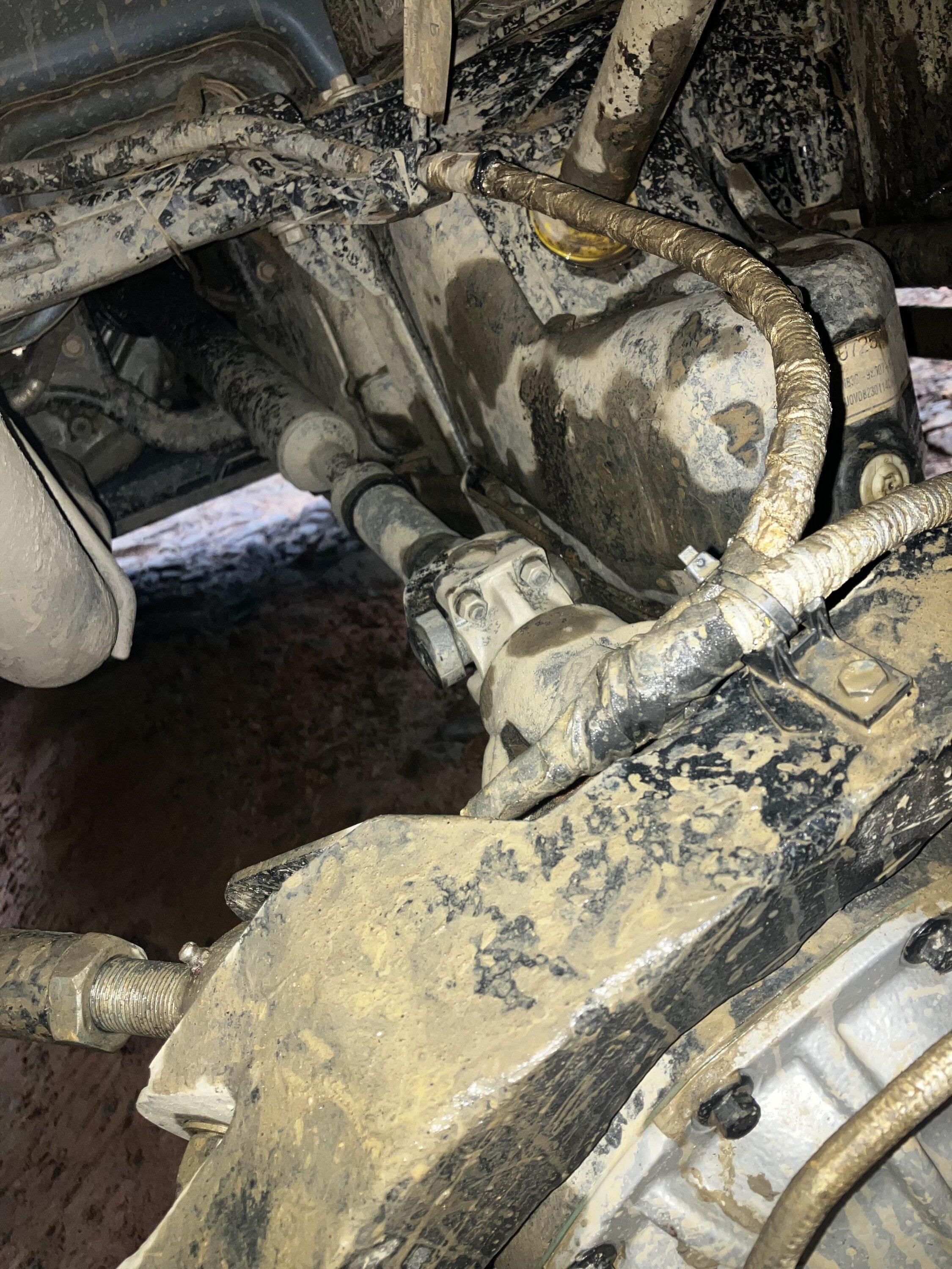

So I’ve been looking at the second picture trying to find the crack you mentioned but I can’t see one. Are you talking about that frame divot with the split looking area? Because if so, we all have that. Here is mine for reference.
I was looking at the pics and wondering the same thing. The pushed in "split" is a lance, that is where the 2 halves of the crossmember fit together. One half sits on the lance from the other half, this helps sets a consistent width for the crossmember when it sits in the tool while being welded.

Same, I've looked at both pics and can't see a crack in weld or bent mount...

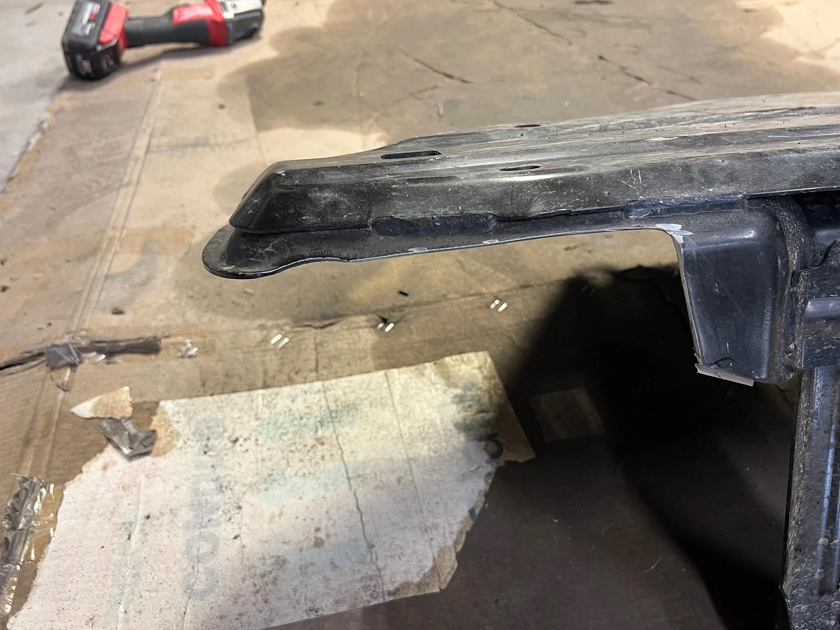

Thanks! I think there is definitely a difference between 2 and 4 door where it rubs. My diff skid actually rubbed the back corner of the gas tank skid (aftermarket) . I’ve got a fair amount of that, maybe a good 1.5” I can remove from that back corner. Adding that I did run the 4 link with no rear swaybar for a bit, including a wheeling trip. now I have an Antirock. im hopeful that i can eliminate the issue for my 4 door setup with all of that.
