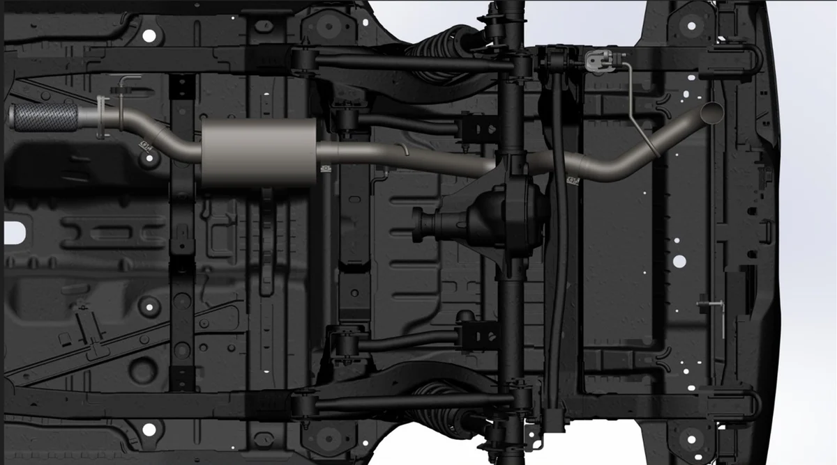

Where the Stock muffler used to sit (underneath trunk storage area) is now empty, the corsa is pretty much straight back from the cat, over the axel, and ends sitting close to the back bumper.
I know a lot of ppl that got the DV8 (or equivalent) bigger trunk storage area had issue with heat but that will not be an issue here.
Where the front mount muffler sit right now is next driveshaft but has ample empty space around it. I do not think heat build up will be a problem.

Here’s an image from Corsa website that gives a prettt good idea of the undercarriage layout

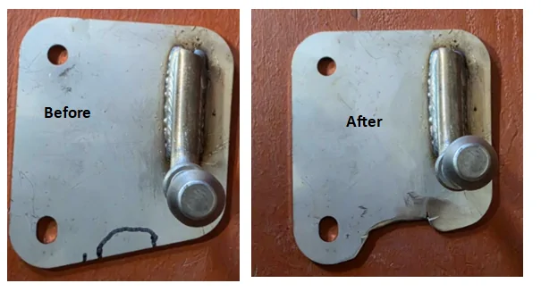

Got the Corsa insalled last night. Wasn't too hard at all however I have Metal Tech RRR Rock Sliders and there is a bolt that goes through the frame that interfered slightly with the Corsa bracket that bolts to the frame. Had to modify it with a grinder a little bit (shown below). My only concerns with this exhaust is that it does seem pretty close to the bolt head that attaches the rear upper control arm and also the driveline but only time will tell if that will be a problem. I'm also going to add more heat shield to the underside of the floorboard. Half of the floorboard above the muffler is protected with a factory heat shield, I'm simply going to extend the protection. Not sure if it's that necessary, but I cannot see how it could hurt. As for sound, I like it. You can actually hear what the engine is doing but when you get to cruising speed, it's quiet like stock until you ask for more revs.
