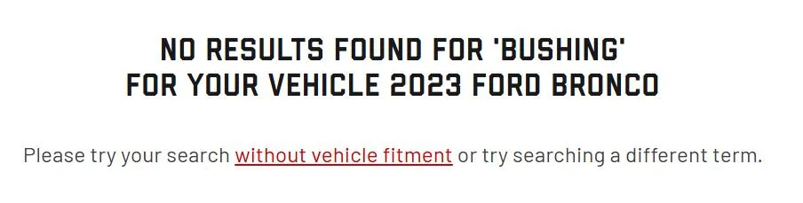

I have 2023 big bend with out Sasquatch package, I believe I don’t have front-axle disconnect.
I’m planning to install Ford Bronco Rack & Pinion Bushing Kit by Rough Country and there tie rod also.
Do you think it will fit my vehicle
No idea. Doesn't seem to be listed on Rough Country's website.

I think they remove it from their website because maybe BroncBuster Suit them because it’s a an exact copy of the BroncBuster Which is 350$.
Rough Country didn’t do the R&D they just copied it and sell it for 50 $
You can find elsewhere for example :
https://www.everythingbroncoafterma...RVSd1_j56xAMirJltaZ0V57LxPCUDlxKN_52oL4Q3iFbT
You'll probably have to contact Rough Country.
It likely would work fine honestly. But I personally wouldn't trust compatibility listings on reseller websites—they are often incorrect.
