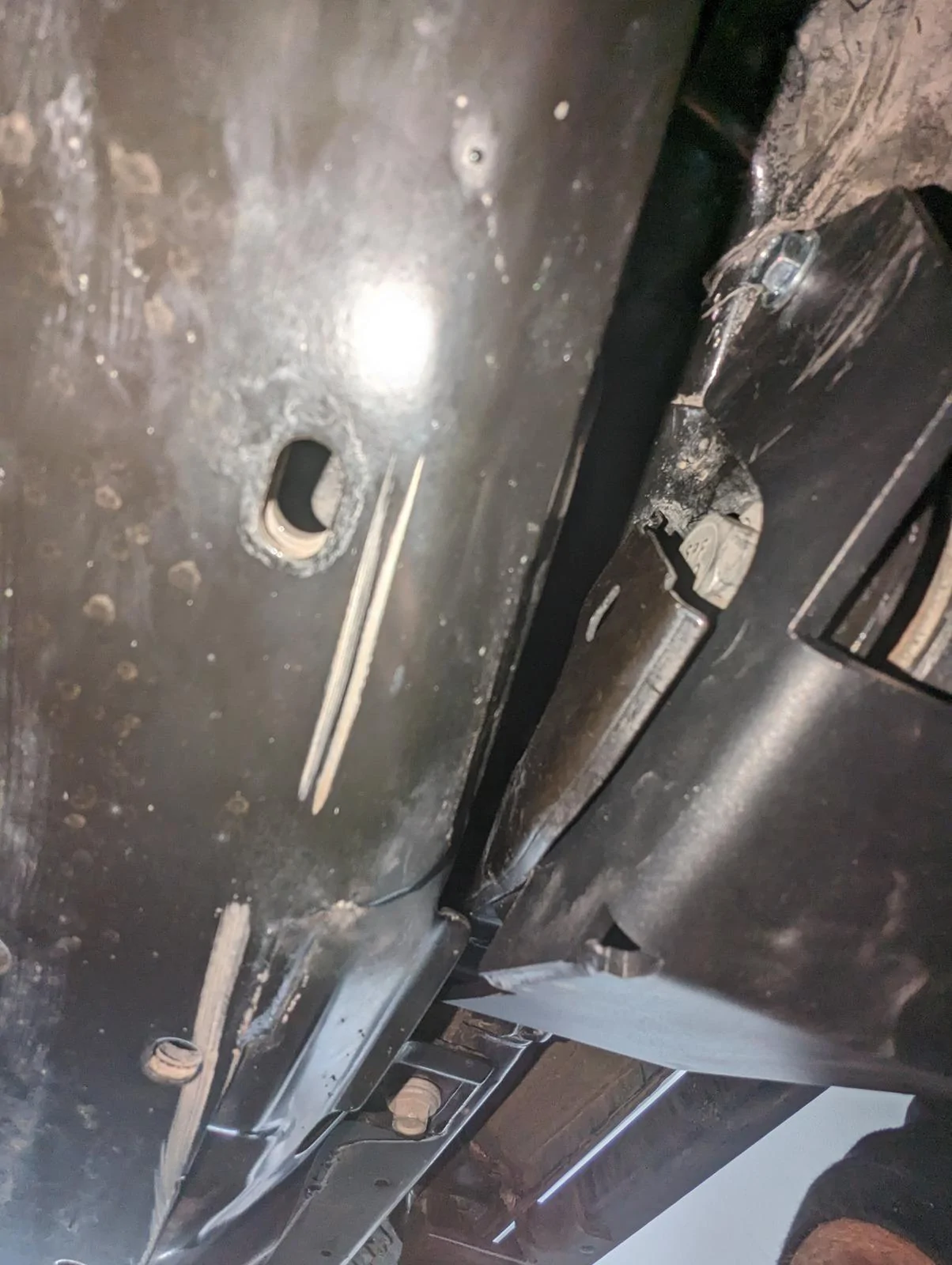

Thank you IAG. Email sent with pictures.
update. IAG responded via email with a solution that didnā€™t involve any cutting. Loosen one tiny bolt and got me enough room to muscle in the skid plate. Appreciate the customer service.

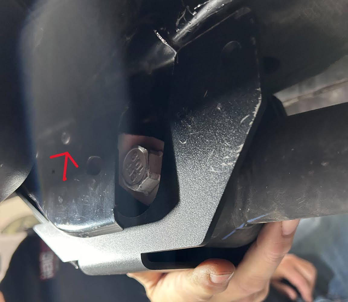

Super tight fit in there. You will need a T25 bit and a small combo wrench to get in there. You donā€™t have to take it off just get like 1/8 inch space to wiggle in the skid. It wonā€™t fit at first so you will have to jam it in and wiggle it around and it will go in. I wasnā€™t able to tighten it down to the recommended torque of 11.8 ft lbs since torque wrench wonā€™t fit, so hand tightened it and jammed in some electrical tape to try to keep it secure. Iag support said itā€™s not a big deal that small bolt since there is another bolt further in and with the Iag hardware you will be fine. iAG did find the attached tool and said this could help if I really need to hand tighten it then try this: https://www.walmart.com/ip/Steelman...8?wmlspartner=wlpa&selectedSellerId=101002145

It took me hours to get the passenger side skid installed and it still doesn't sit right. I've been emailing back and forth with IAG support to try and figure out a solution. It looks like at this point I may end up dropping the fuel tank enough to gain access to that plate and removing it entirely.

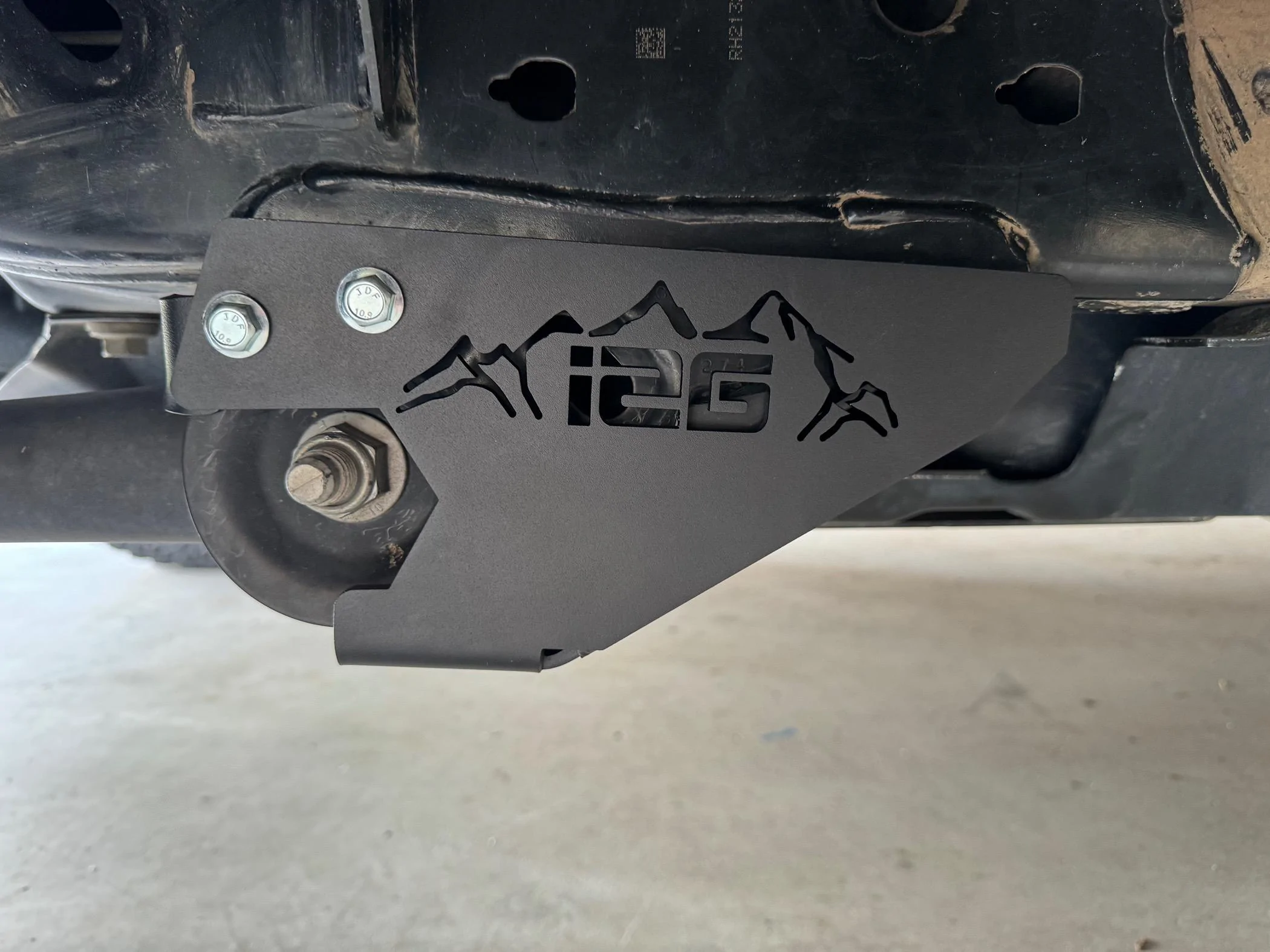

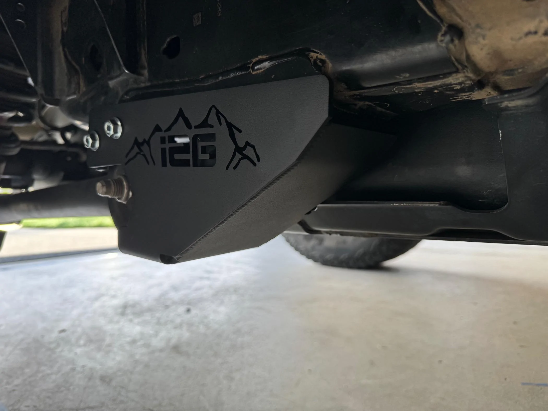

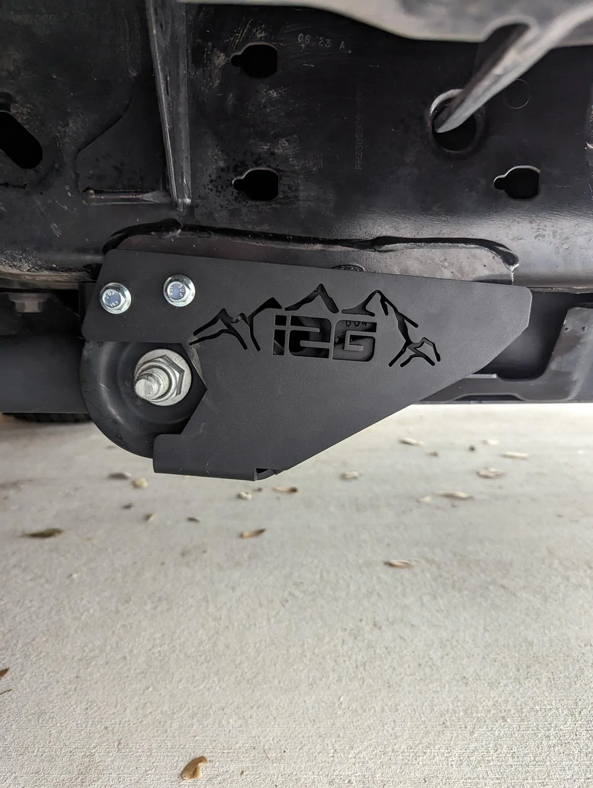

Finally was able to get everything installed. The passenger side was difficult but after the help from the forum and IAG customer support I figured it out. Once the skid plate was in position I used a jack to get it positioned right. Then I tightened all the bolts. I used a slim line T25 torx wrench. To get to the small hidden screw.

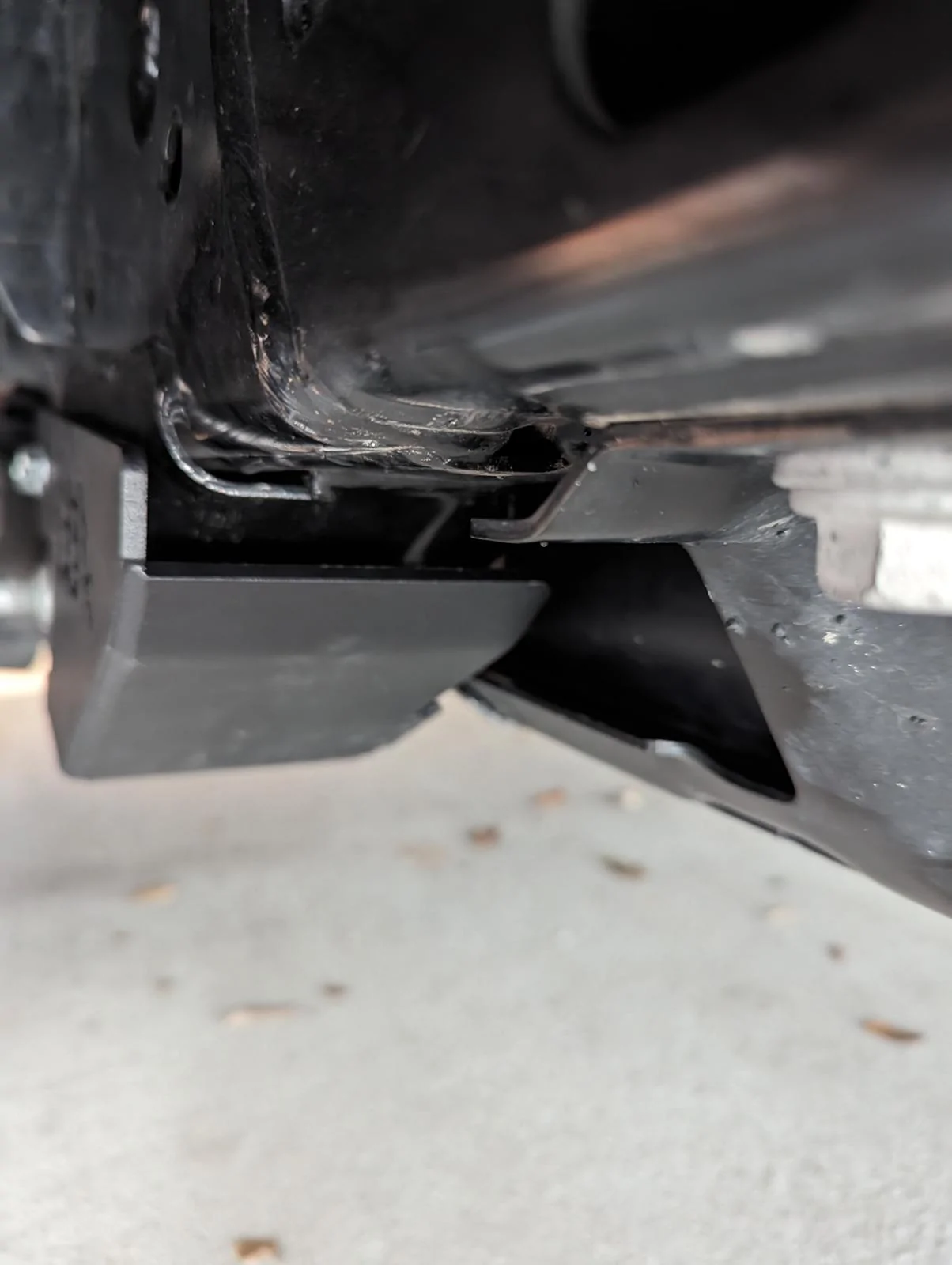

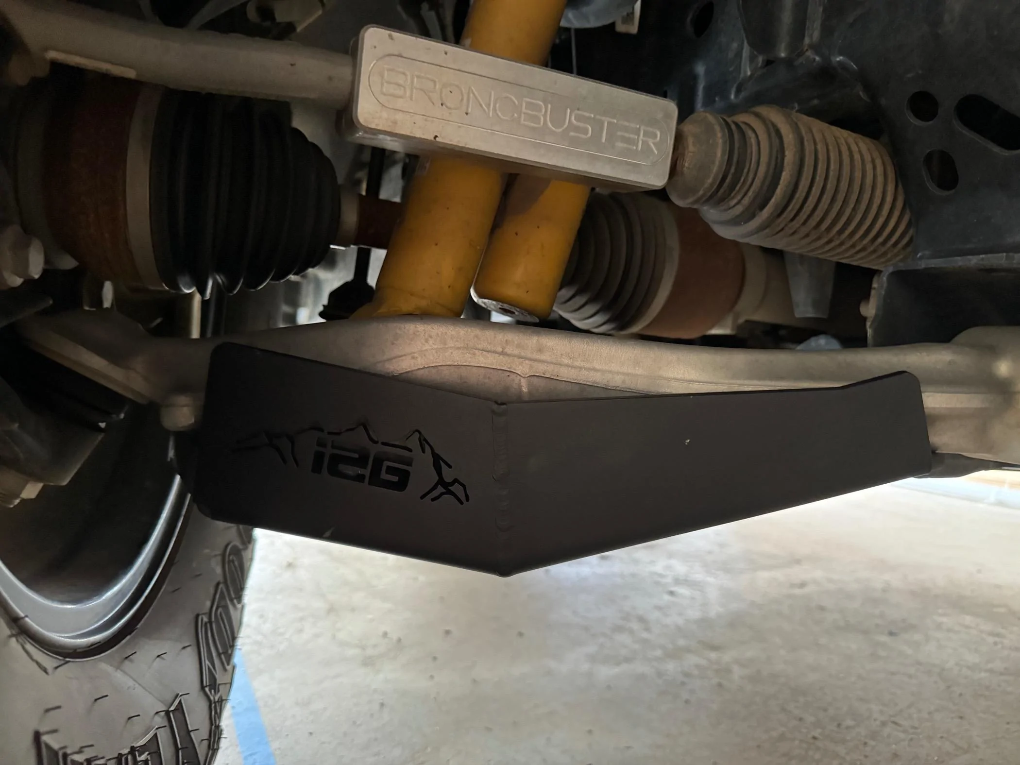

After some man handling I got the LCA skids installed. The install is not as easy as the video leads you to believe. Just glad I was able to get them on.
