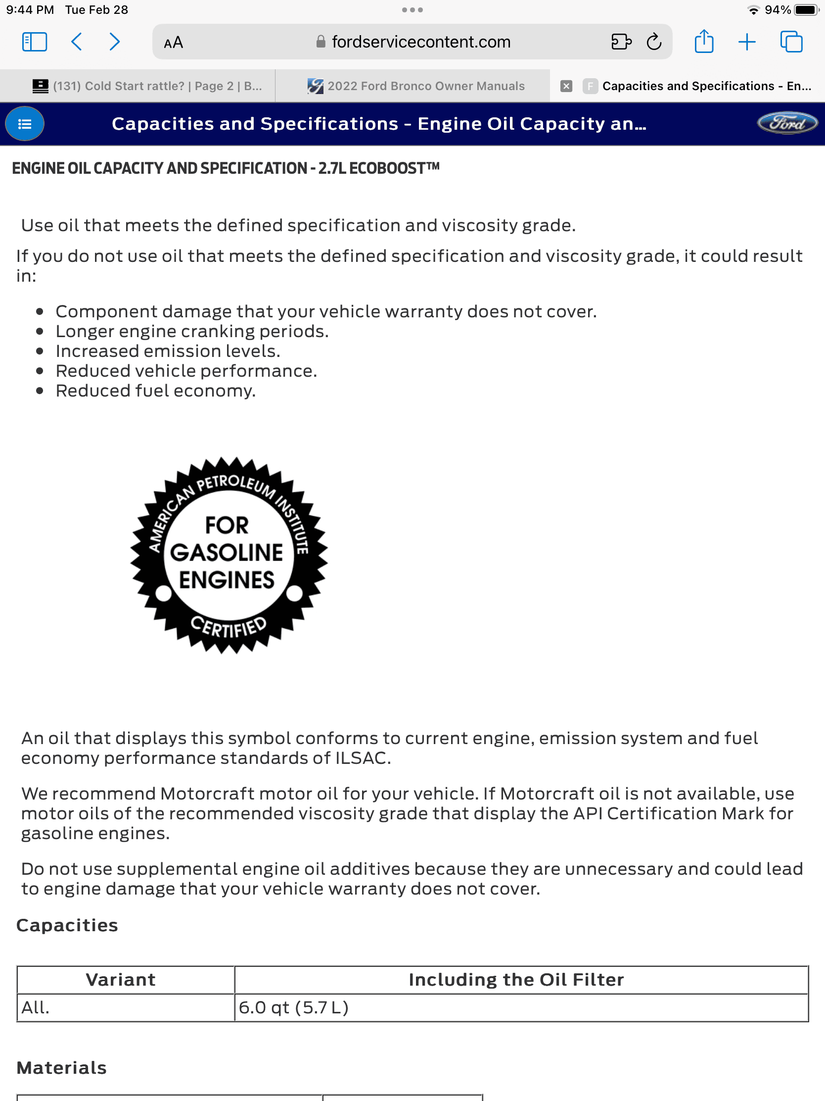

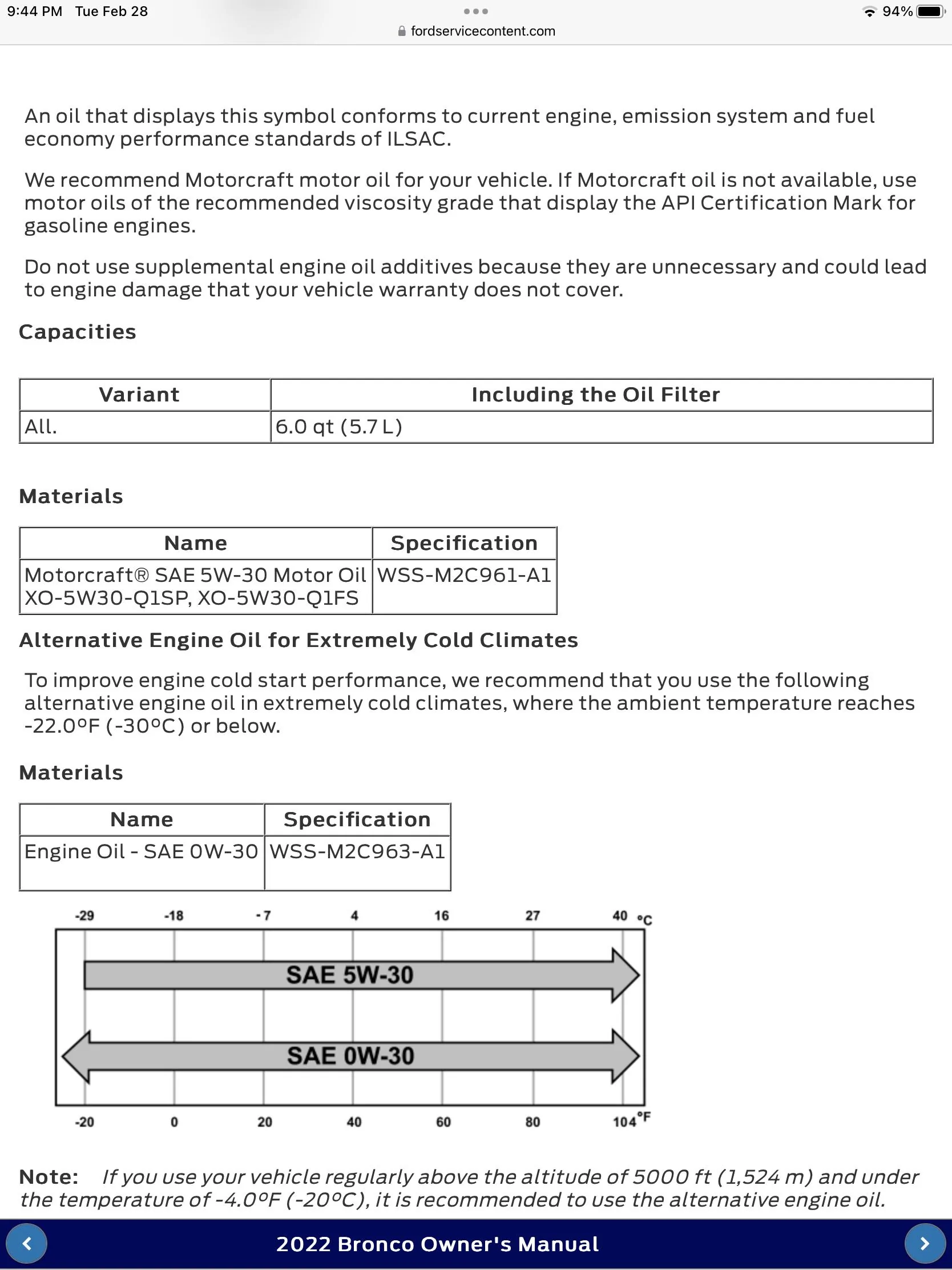

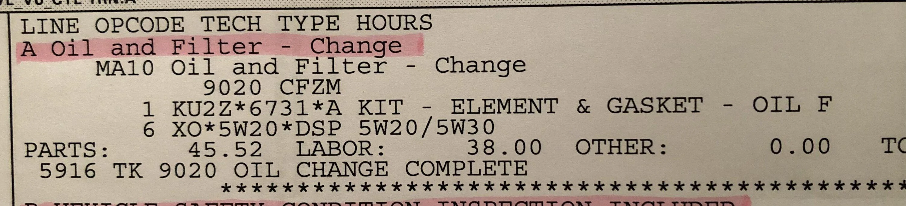

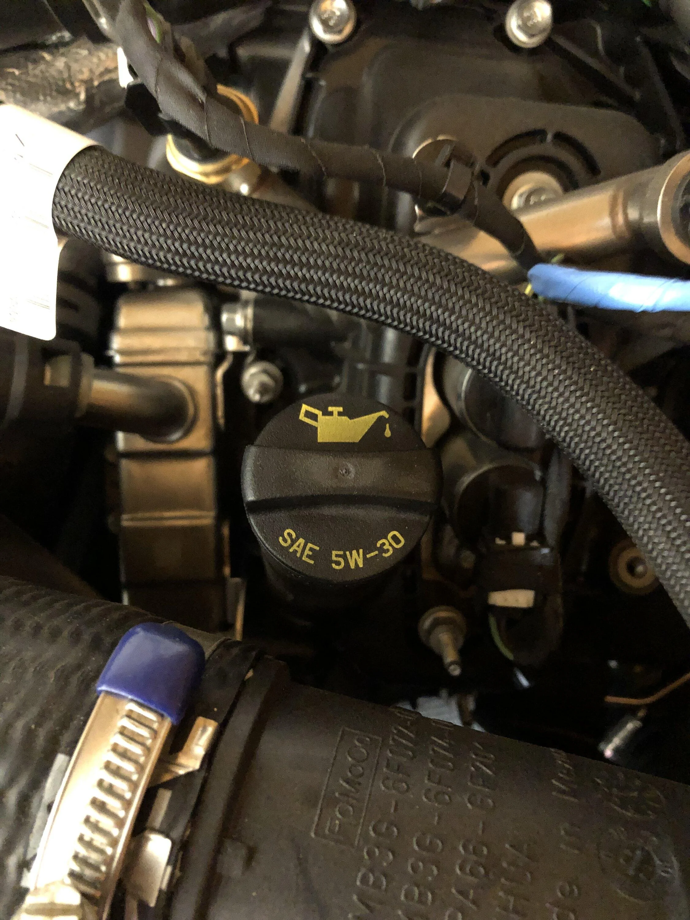

My Ford dealer did my Bronco's first oil & filter change at 5,916 miles on January 7, 2023. The first time I heard the rattle was a week or two later, and it scared the crap out of me. I didn't hear the rattle again until last week. My Bronco now rattles every time I start it after it's been sitting a few hours.
I have an appointment next week with my dealer. I don't plan to drive my Bronco again until I take it in.
Could this problem somehow have started with my first oil & filter change?

It has nothing to do with the oil change.
