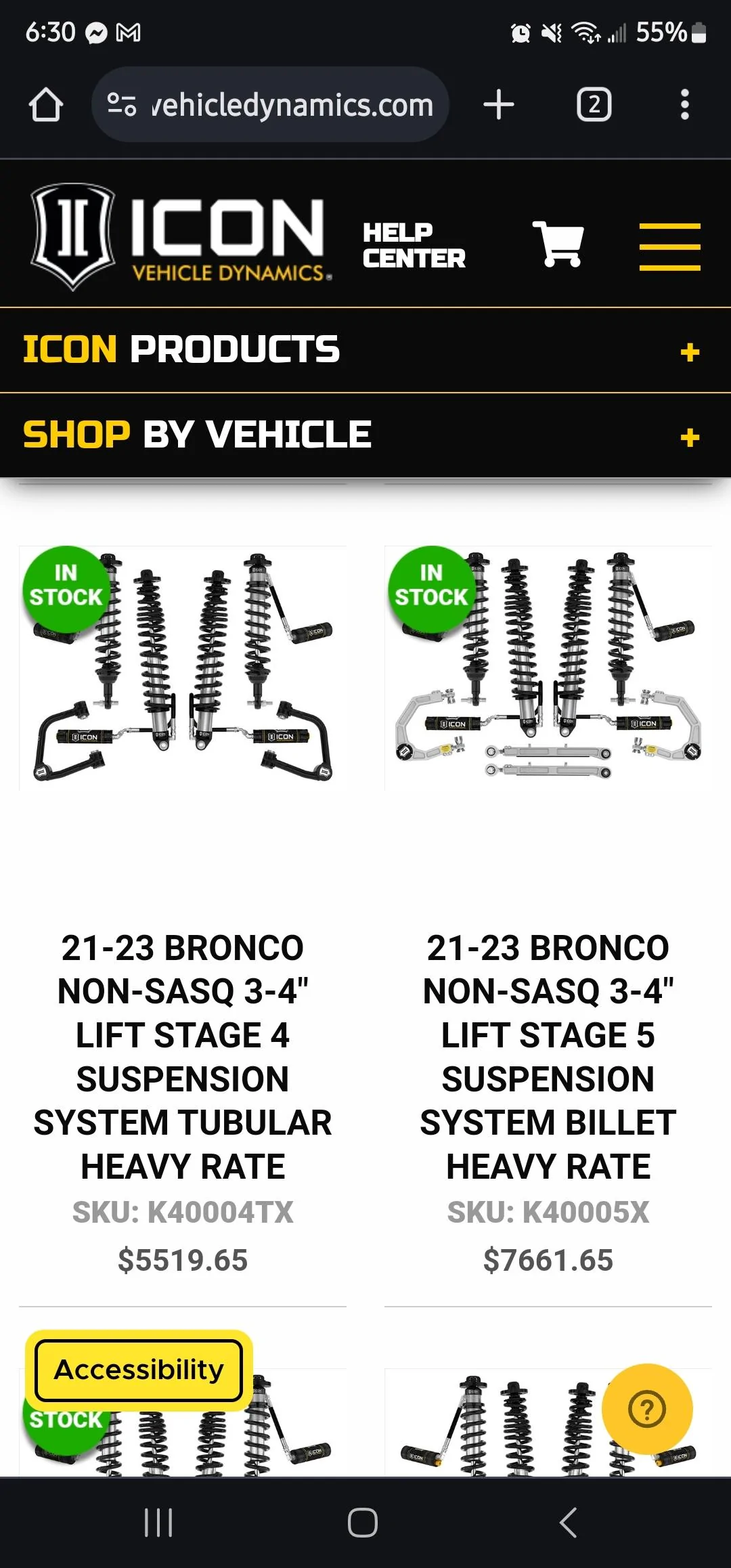

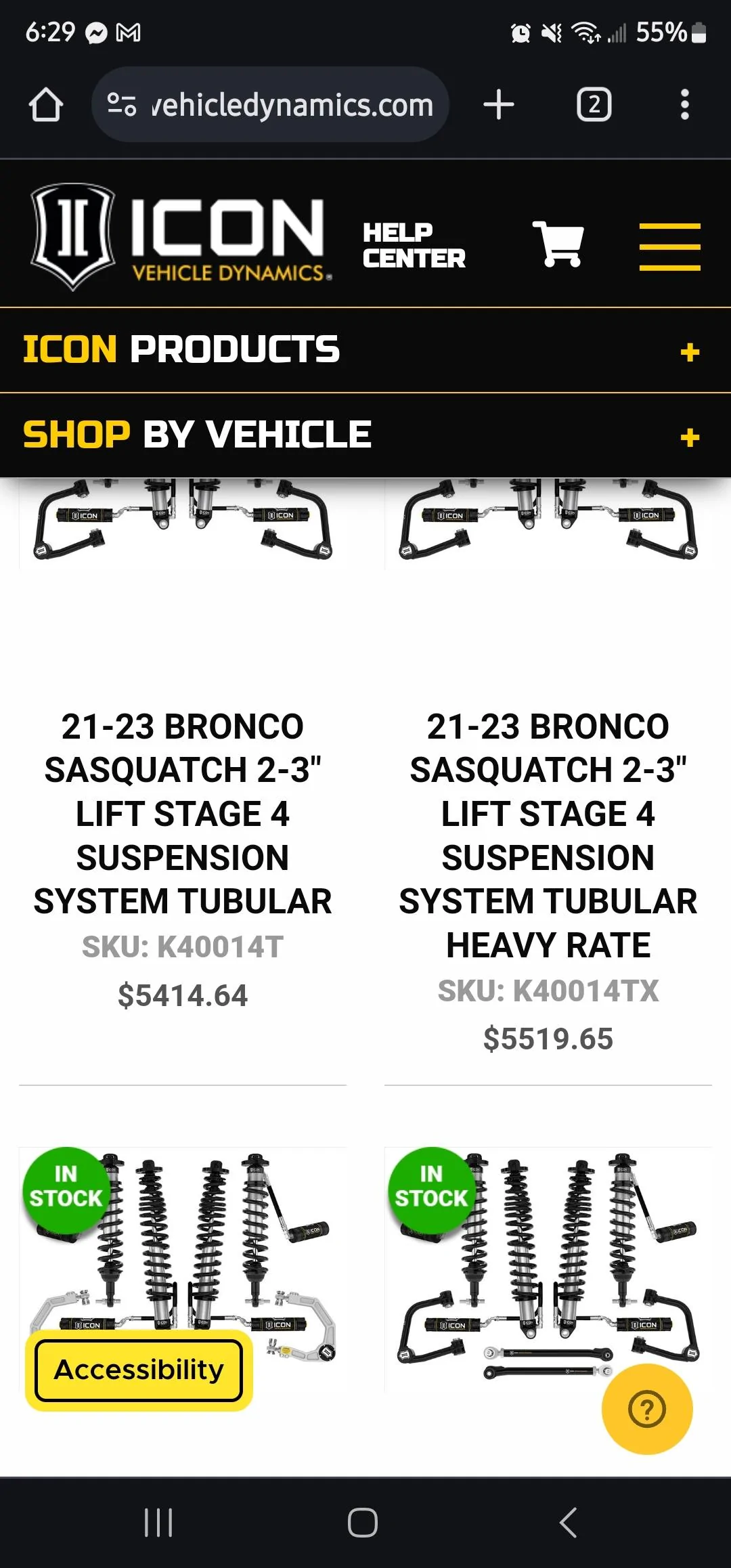

The coil overs I ordered have the same SKU for non-SAS or SAS equipped bronco just with different lift heights. I was just trying to figure what to expect for lift since I didn't want to go shorter on the lift side of things.

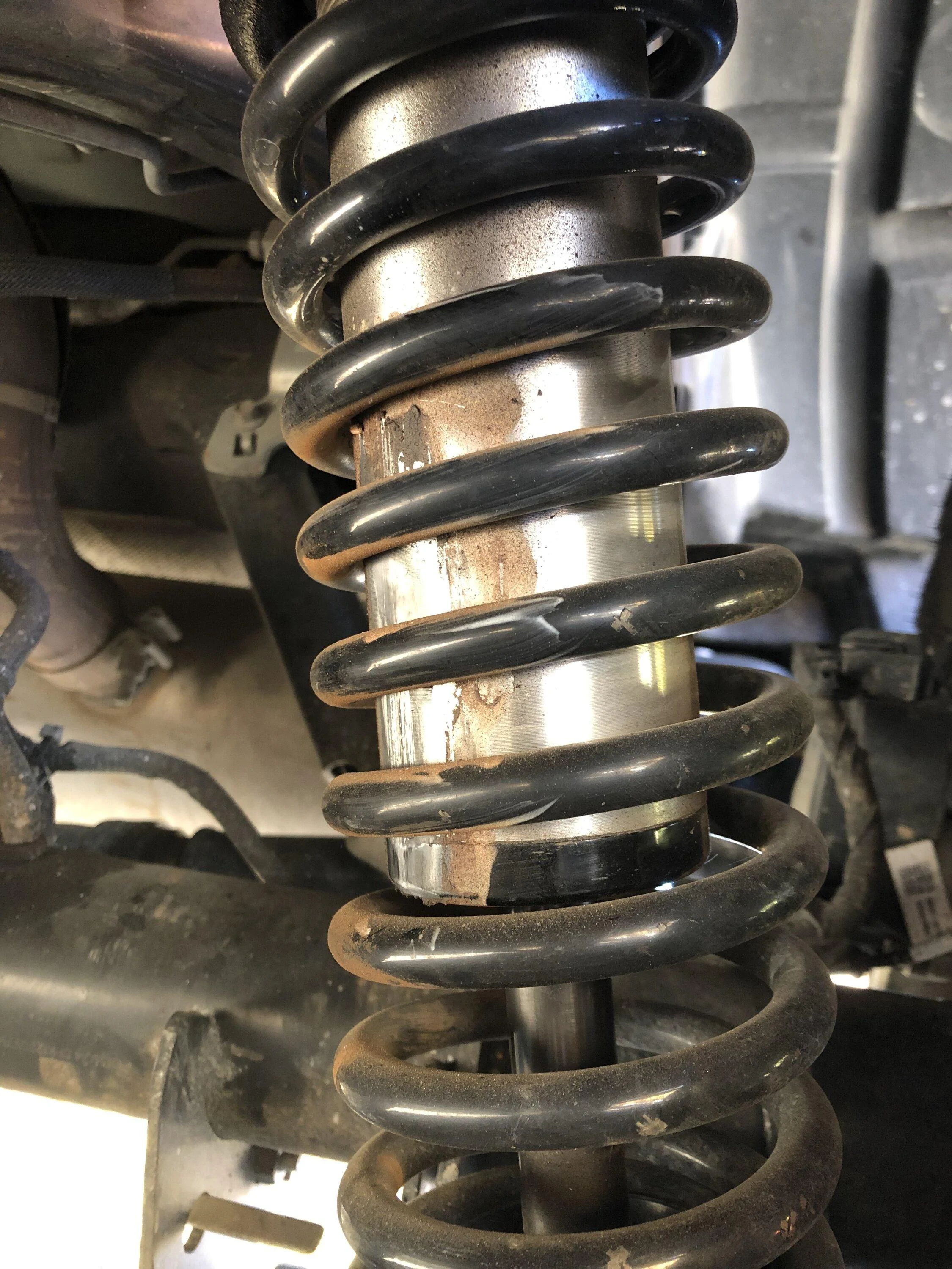

Brought the Bronco home from the shop today and could immediately tell the ICON coil overs were a little more firm than the dirt logic coil overs, which I did not mind. It was not harsh at all. The ICON setup really soaked up the bumps on the paved streets and the little potholes in the road.
I also noticed that noise from the passenger side was gone, that "clunk" sound like something is loose. FabTech insisted that it was not the coil over and sent some parts to replace but any fix seemed to last a day or two and the "clunk" was back. I also noticed the spring on the passenger side had a lot more play than the drivers side, you could bang on it with the palm of your hand and it would sound like metal on metal. It was very loose in my opinion but the shop manager assured me that was just the nature of coil overs. I had asked that FabTech send a new coil over but that did not seem to be an option for FabTech.
The tech who works on my bronco and my Jeeps over the past 13 years thought the axle on the passenger side had play in it causing the noise, he seemed to think it was banging on the diff tube.
I took it to Ford 3 times and they assured me it was normal, I di look at one they had on the lot and it was the same as mine so I knew that was not the issue.
