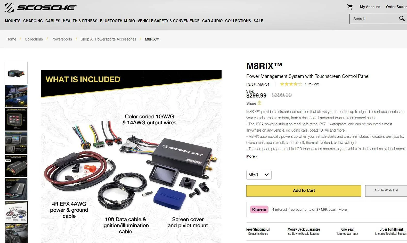

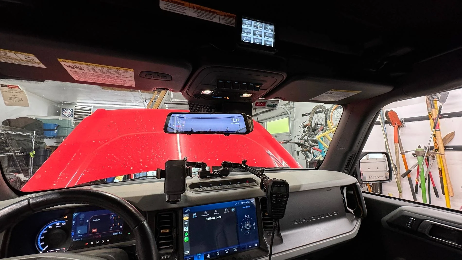

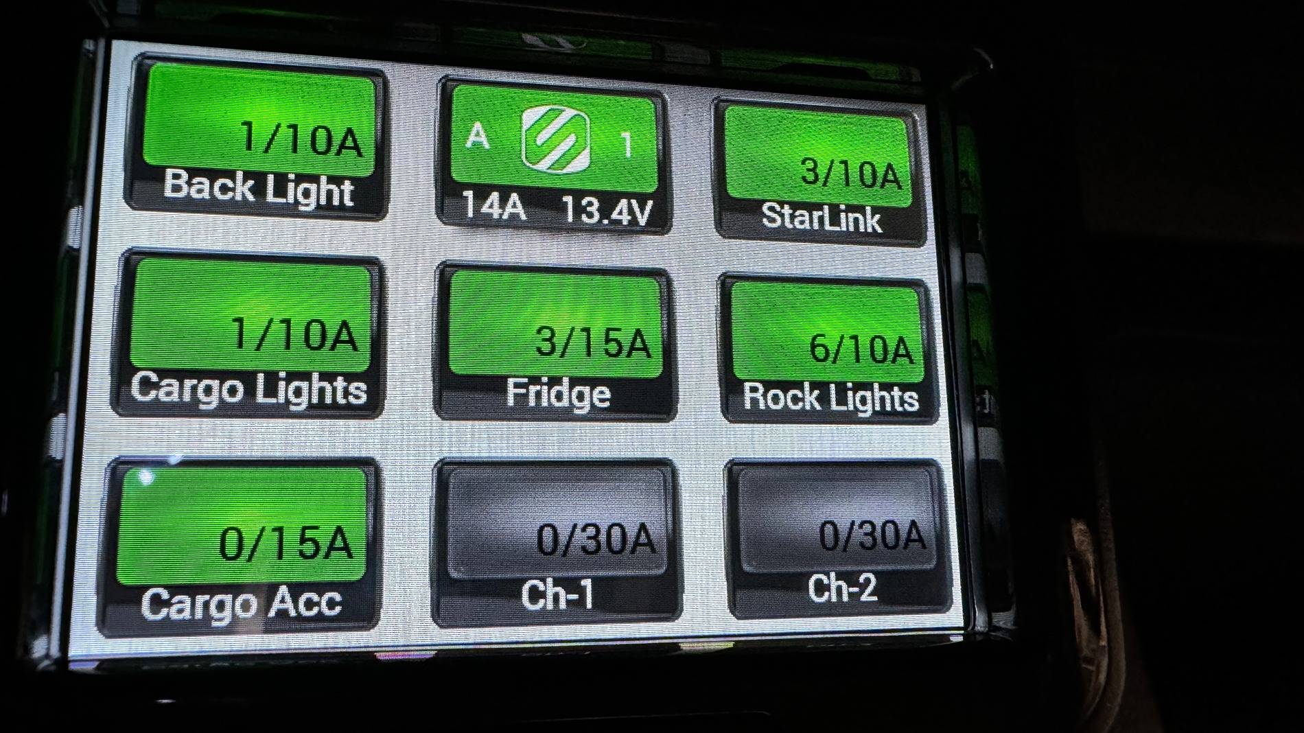

I added a Scosche M8RIX and it cleaned up a ton of wires, discontinued and for sale for $300. I got two (only installed one) so I can add the 2nd screen in the rear and control all 16 circuits from the linked screens. However, they no longer sell the link wire so I had to change plans. Once I find a link wire I'll be able to complete my project, but it's working so well I'm taking a break from it. I originally bought the 2 screen AuxBeam, but it lacked programmability and amp readings of the M8RIX. For example, I programmed if the Fridge is on and after the Bronco is turned off, the fridge will stay on for 8 hours. Same with Starlink, I keep it on 30mins after key is off.
