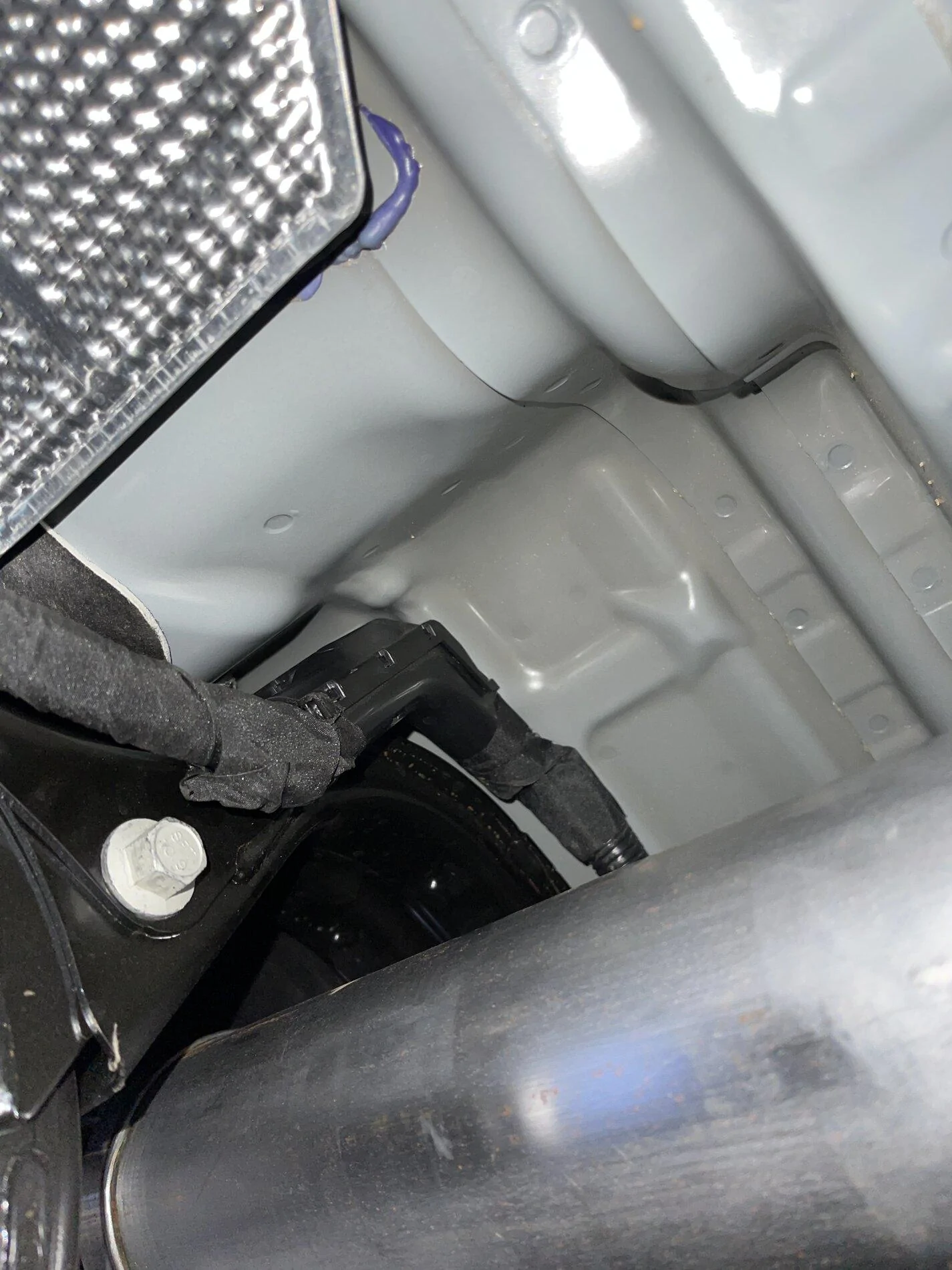

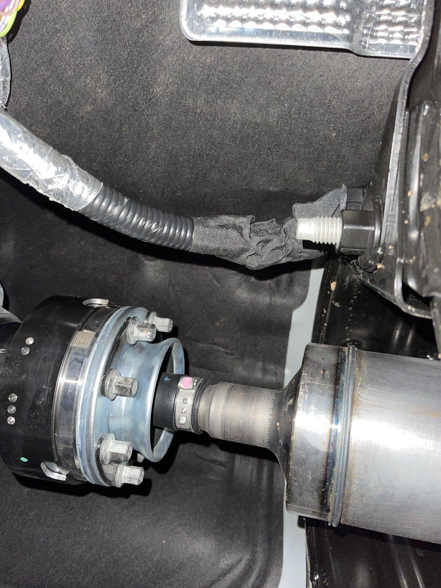

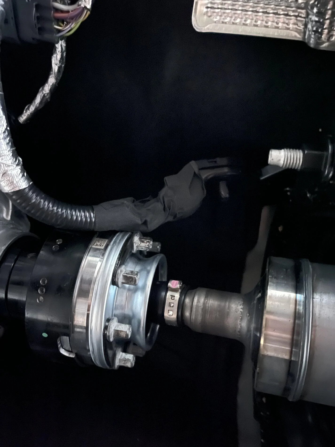

Took mine out for a little fun today and after looking underneath I noticed that one of the wire packs was rubbing the driveshaft. Upon further inspection I saw that the bracket that holds it to the driveshaft loop wasn’t even clipped in and was just sandwiched in there. Three clips. Two in a row going front to back and then one that runs vertically
