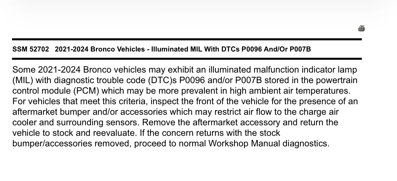

Hi, Any body having p007B 2025 BRONCO 2.7L Just turned 2600 miles. Dealer said no warrantee do to the winch and bumper. That 1000's have been sold. ADD BUMPER.
Thank you for any input. Andy

While this SSM hasn’t yet been updated for 25-26, it’s still valid and your dealership is correct. Aftermarket parts partially restricting airflow to the intercooler shouldn’t be a warrantable repair.
It may not happen on every vehicle with an aftermarket bumper, but it has happened to many.

What they claim doesn’t really help you very much.
You really only have a few options here. You’re either going to have to remove the aftermarket parts, return the vehicle to stock and prove that it isn’t caused by them.. switch to a different aftermarket bumper that doesn’t block the airflow as much.. or continue to deal with the trouble codes when they set.

Or get a high mount intercooler. That’s an option that would probably work also.

Installing the Ford winch kit, if you can, might be an option.
