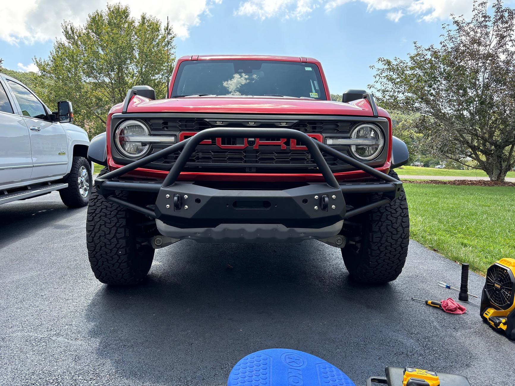

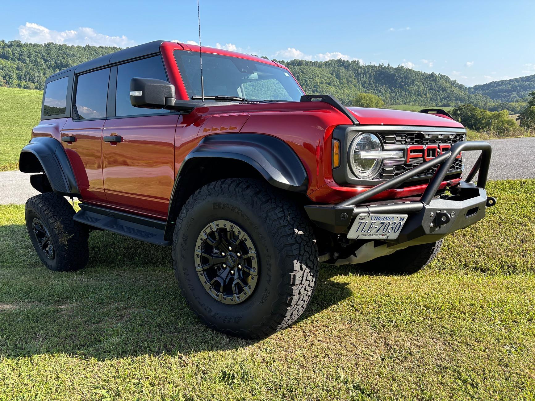

Just installed a CBI bumper over the weekend. I have yet to put a winch in it (later this week). It looks well made, good welds and a good design. I think it’s got good lines and doesn’t hinder approach angle much more than the stock bumper.
the two piece design makes for an easy install, bu you will need some frame re-enforcement brackets. The winch plate is a little thinner than I would have expected.

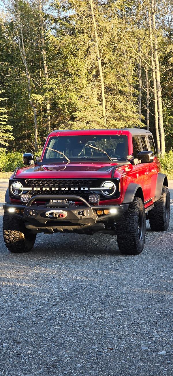

Looking a little late on my reply here but I've had one for a year and a half. One of the better looking winch bumpers IMO. No real issues. Had to grind out some of the winch opening to fit the Badland Apex 12k. And the fairlead is kind of a PITA to install since it's hard to get your fingers behind it. The powder coat has held up good to one Alaskan winter which is more than I can say for a lot of things these days (the Badland fairlead finish is shot)
The ACC doesn't work nearly as well after the relocate but that's Fords fault.

Thankfully I don't have acc. You just sold me on one. That is the only picture I can find with stock skids and this bumper

‘what lights did you use in the wings?

Morimotos. 2 pair of 4Bangers and a pair of 2Bangers
I had 3 pairs of 4Bangers in the OEM bumper but the opening in the CBI is a bit too small for that.
