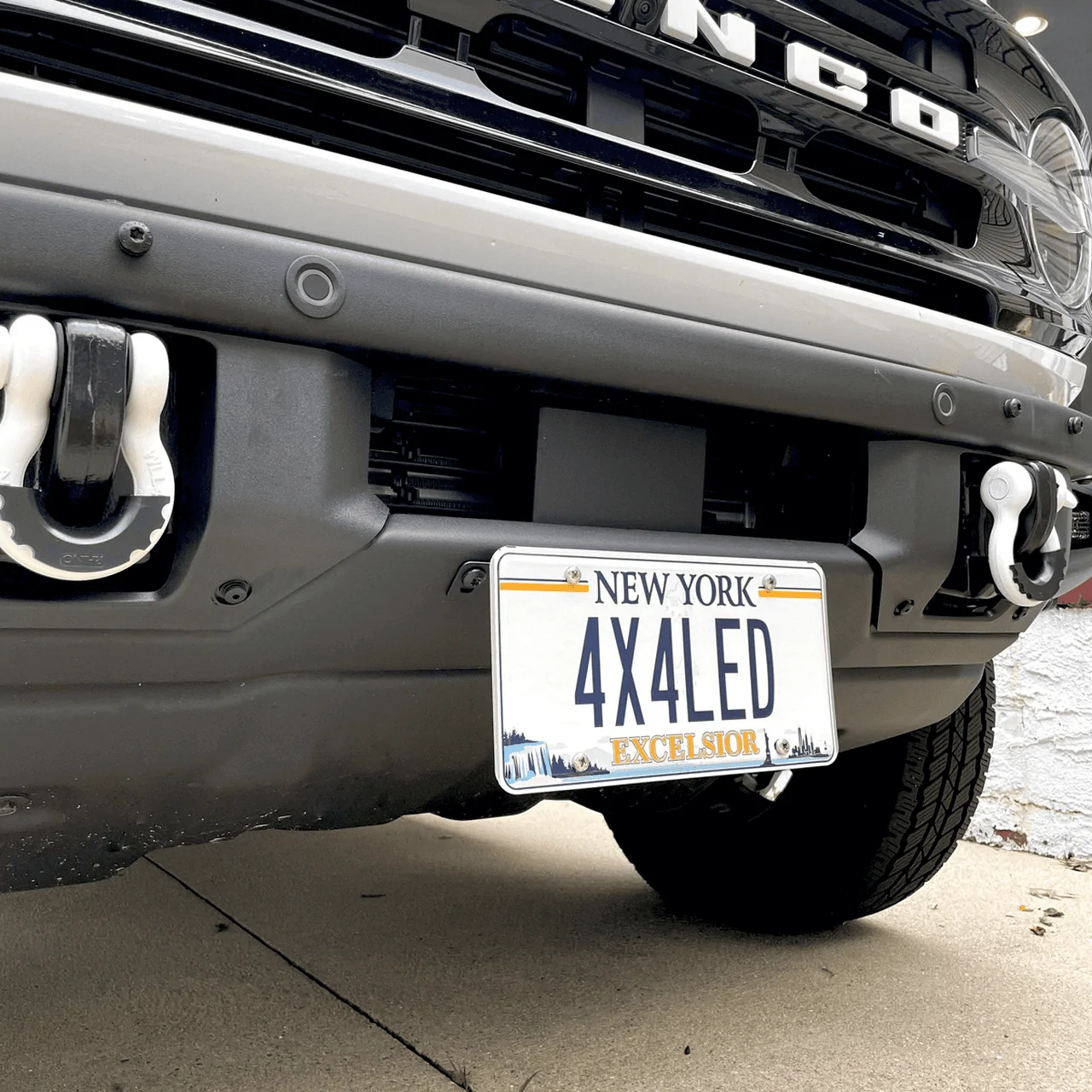

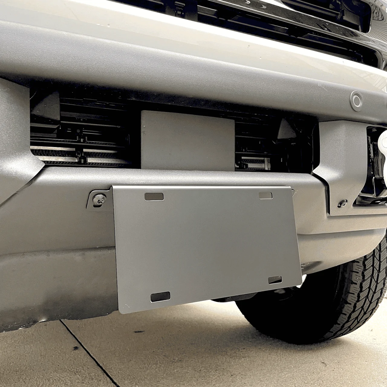

We've got you covered. Our bracket is made in the USA out of aluminum, powder coated and has a lifetime warranty. It requires no extension bits to install either. It's designed to use 2 of the factory mounting bolts on your truck and with your license plate installed, the mount is hidden so you don't see it sticking out. If you ever decide to go off-roading and want to remove it, you can do so easily as well
With the capable you just need to drill 2 holes to mount it (similar to what Ford does for your rear license plate bracket). Some folks use a nut on the back, others just use a self-tapping screw.
Use coupon code BRONCO6G and save 10%

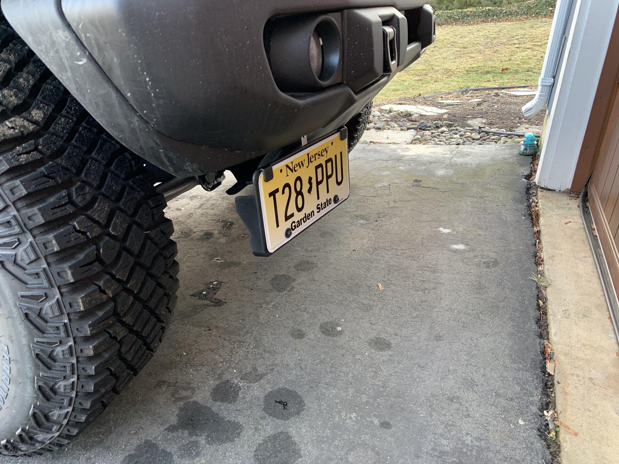

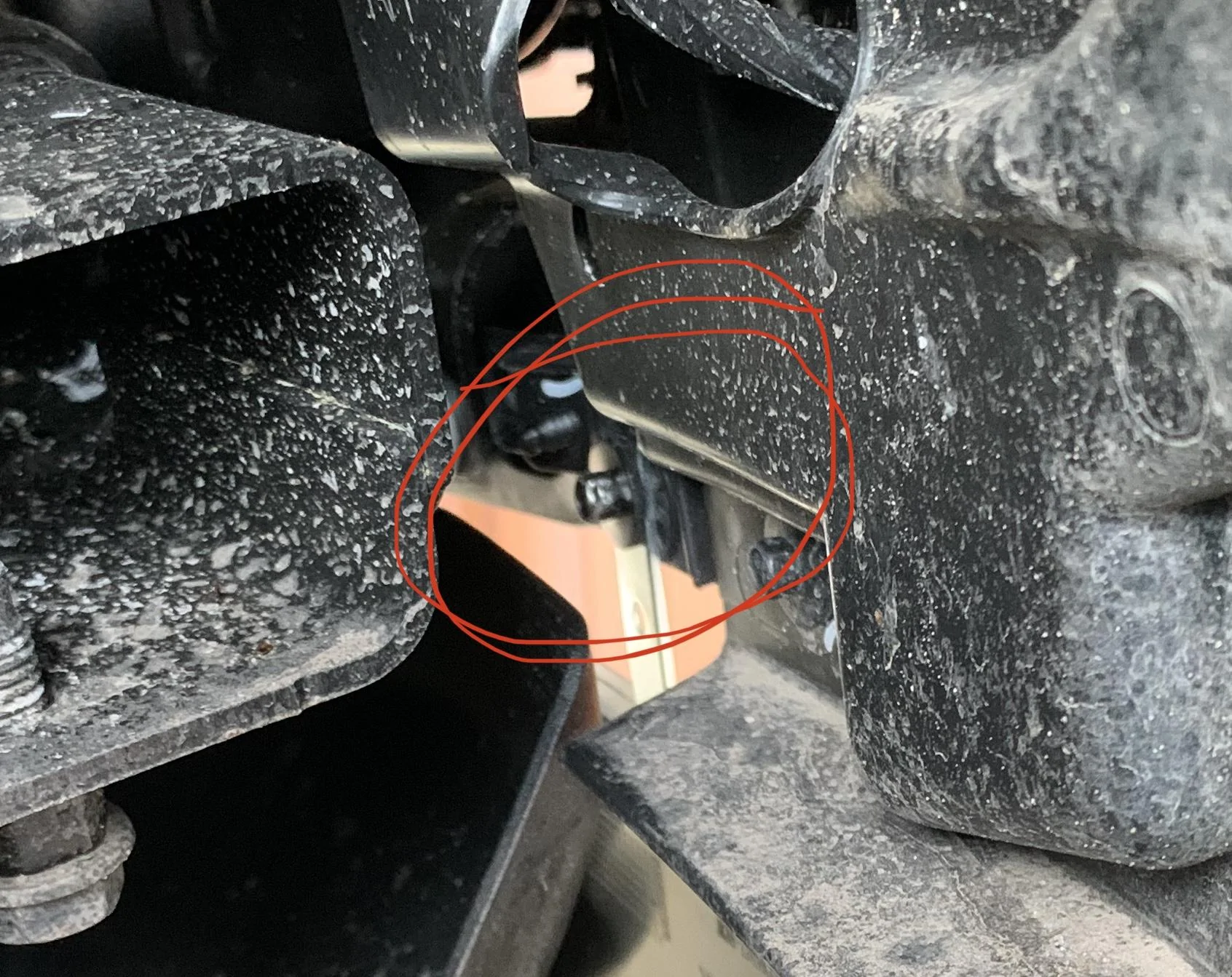

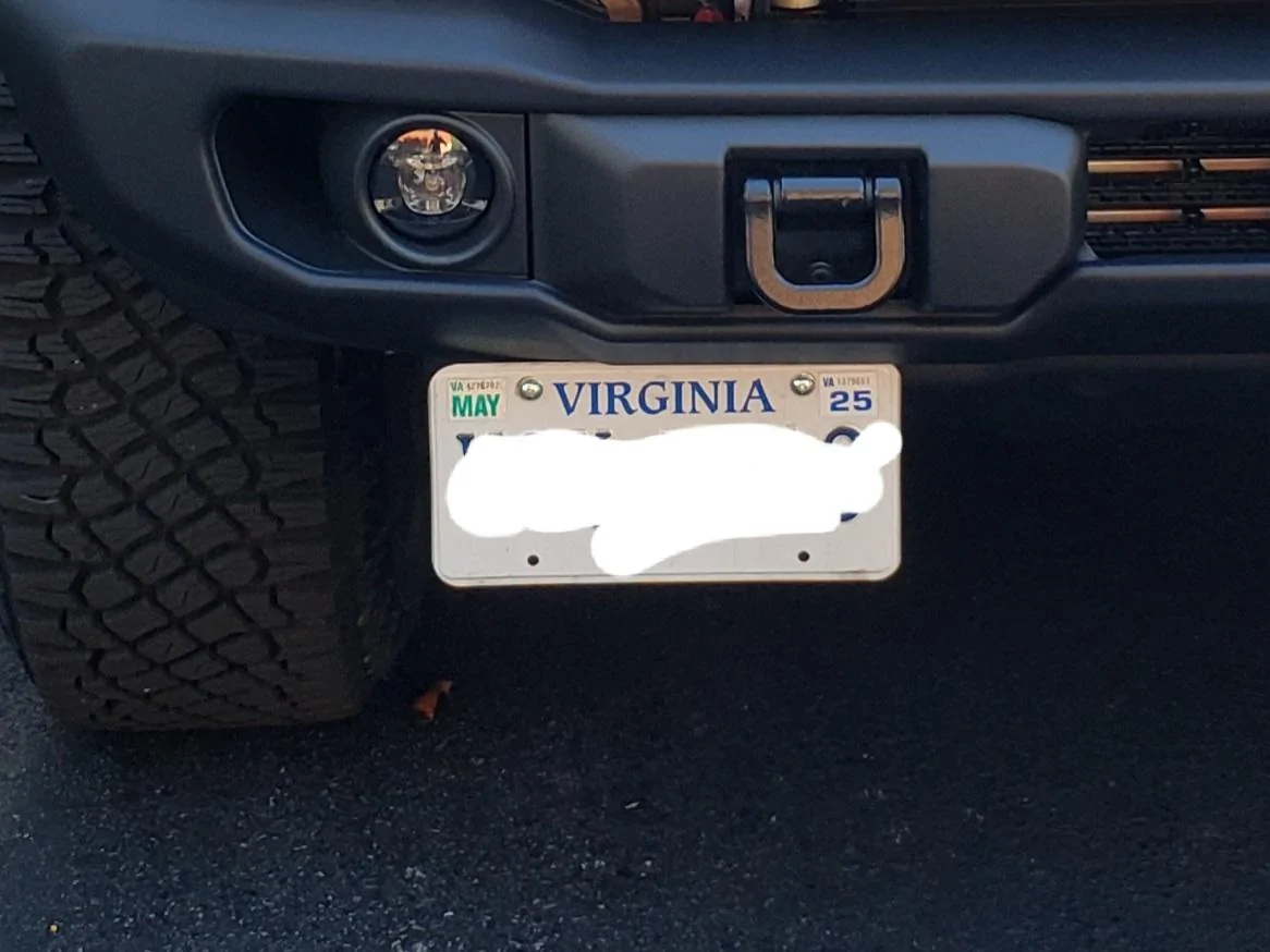

I took @Downinthehazletwoods idea a step further. Found this bracket on the Amazon for just over $6. Comes with hardware to attach the plate, but I added some lock washers.
https://www.amazon.com/dp/B0113Y0UC4
Used the larger bolt (1/2" head) just a bit towards the center of the vehicle.

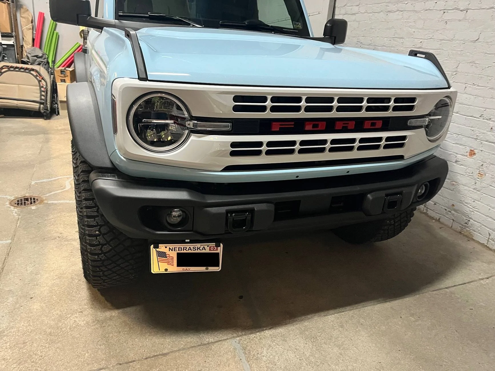

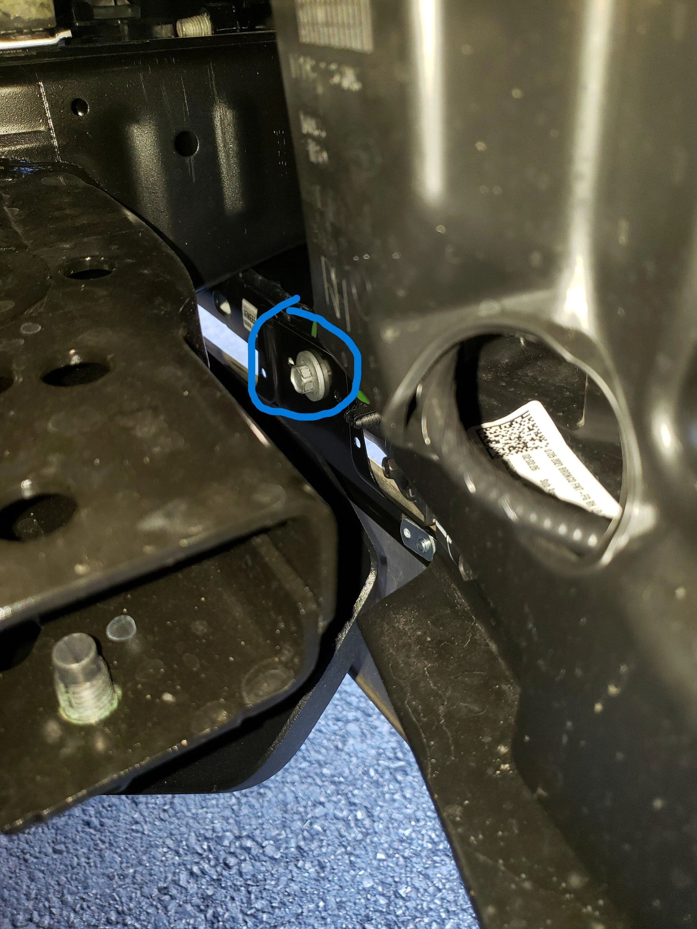

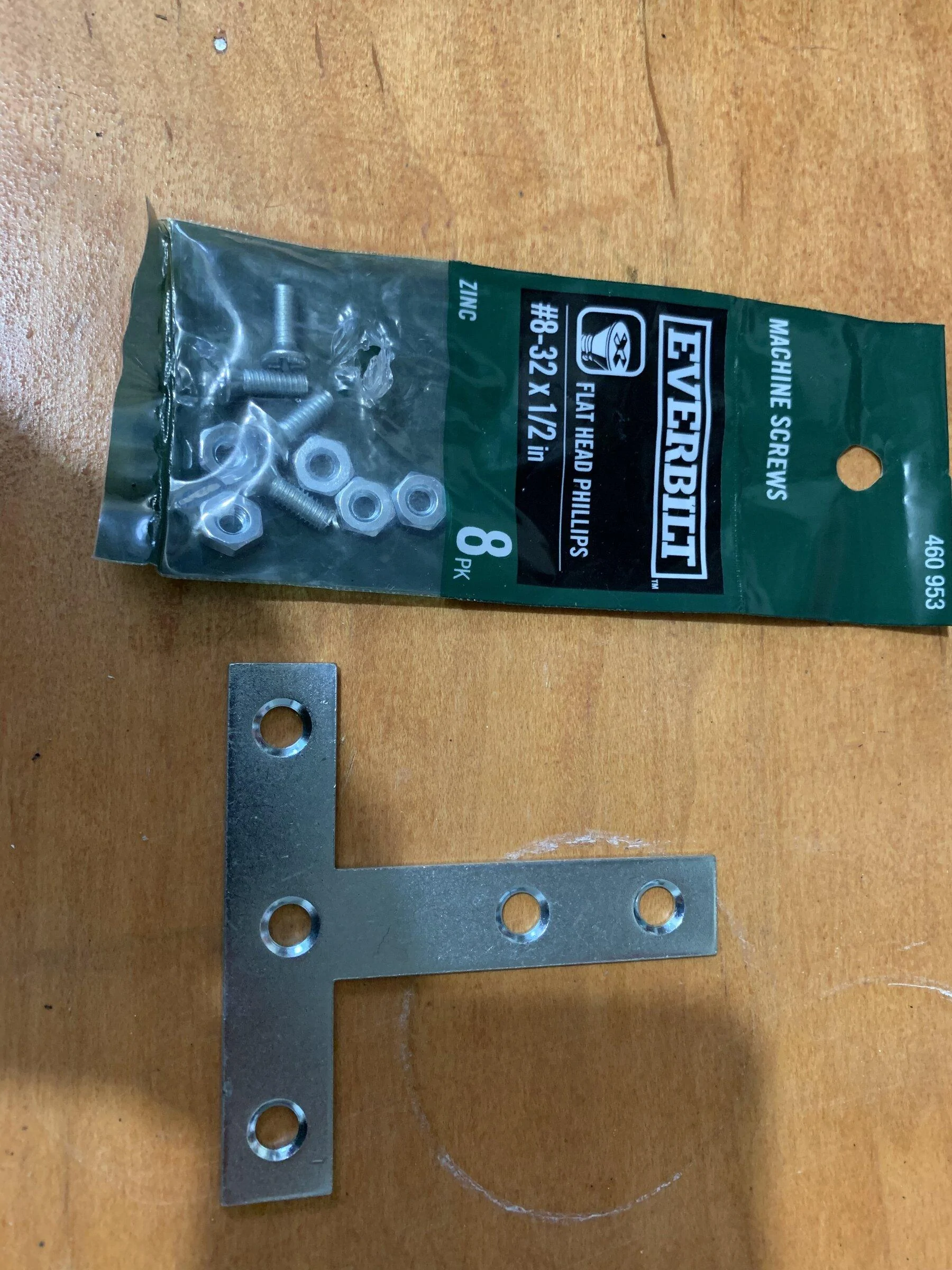

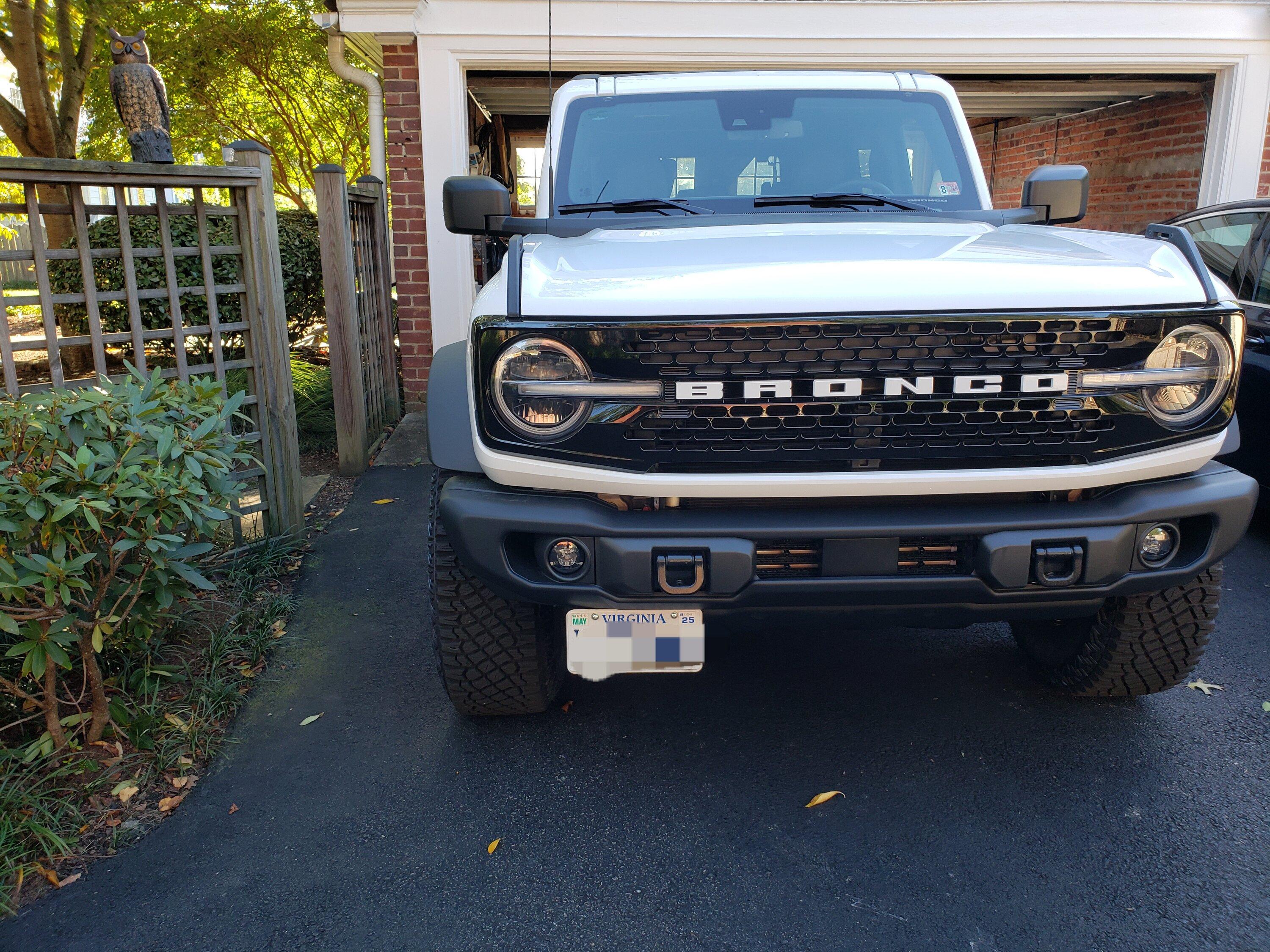

Here’s my $5 Home Depot solution. There’s a bolt behind the bumper that I put a little bracket on, then just screwed it into the stock dealer plate holder.
Thanks for the idea - just finished installing the same on my truck - it turned out great and only a few dollars.
