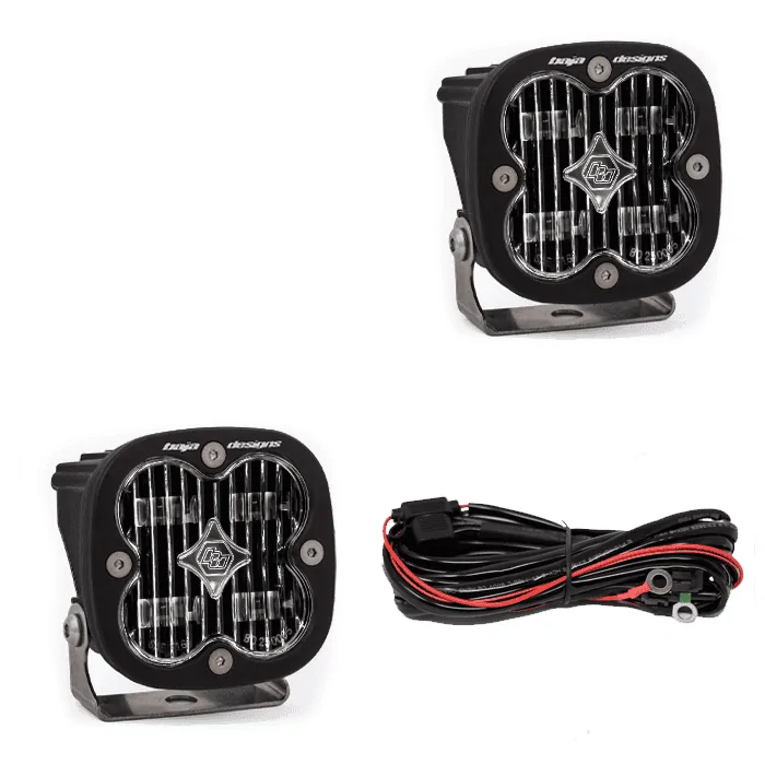

Either flood or combo will work to throw a good fog pattern for the S2s, however, either the @Baja Designs Squadron SAE or the @Diode Dynamics SS3 SAE would probably be your best bet for a dedicated street-legal fog.

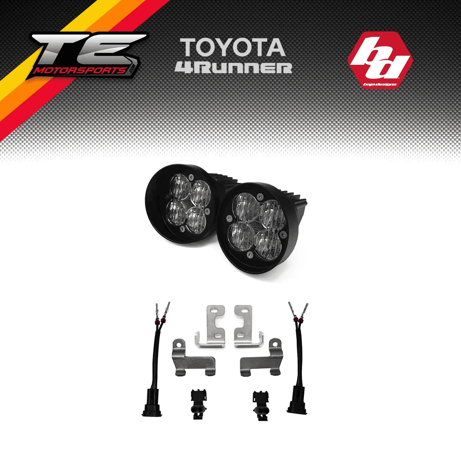

This is the basis of my original post, seeing if there have been brackets and bezels made for the capable bumper and a 4-LED pod. Here is what the Squadron SAE-R (round bezel, with a cupped edge vs the flat oval pictured above) looks like on a Toyota 4-Runner kit.

Here's the LED pod full line-up for both vendors:
https://www.bajadesigns.com/Products/led-auxilary-lights.asp
https://www.diodedynamics.com/off-road-auxiliary-led/led-pods.html
Here is a comparison video that shows you many of the current market offerings for high-quality 4-LED pods and their throw patterns, though it is a bit outdated, being shot in 2020.
Here is a similar video on 2-LED pods like the S2.
I use both, they both are stellar quality. I do prefer the Deutsch Tech plug of the Diode Dynamics products over the Weatherpac-style of the Baja Designs, but that's nitpicking to a whole different level.

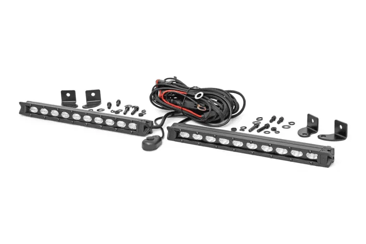

Has anyone looked into the Rough Country slimline series LED light bars? They are very compact. I'm wondering if there would be a way to put them on the top of the bumper under the grill? This is something that I'm considering for my Bronco. I guess the only question is whether there is enough surface area on the bumper to mount those brackets......

I think the BD S8's are roughly the same height. I was hoping 1 of those would work.
https://www.bajadesigns.com/products/s8-straight-led-light-bar/
Looks like 1.6" high

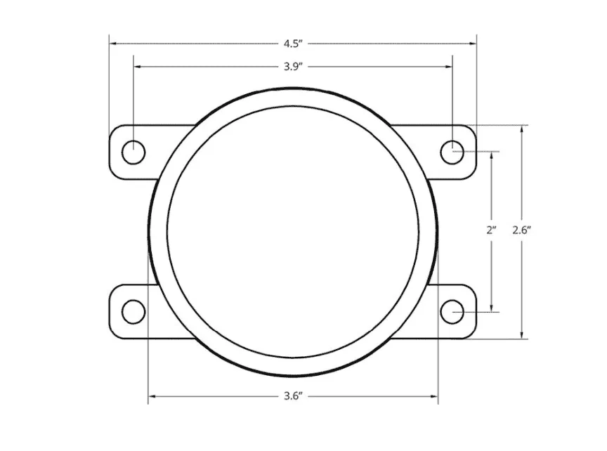

So, tried to get a kind of accurate measurement of the OEM fog light in the capable bumper...
As best I can tell, the diameter is 3.3".........
So....the DD (SS3 light) kit that @4x4TruckLEDs.com sells to replace the standard bumper light has a height and width of 3.3"....same as the opening on the capable.
This new ELITE series fog light that they are selling shows a diameter of 3.6"......so.... .3" larger....so, now I'm torn on trying that if it's gonna be too big, but I like that it is ROUND like the OEM light.
Anyone else measured the opening in the capable? I did this without taking the bumper off, just from the front.
