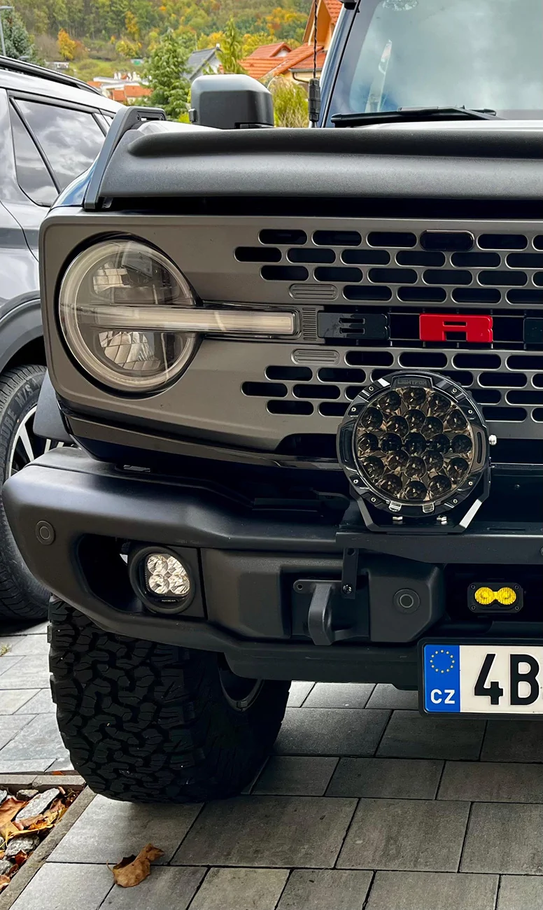

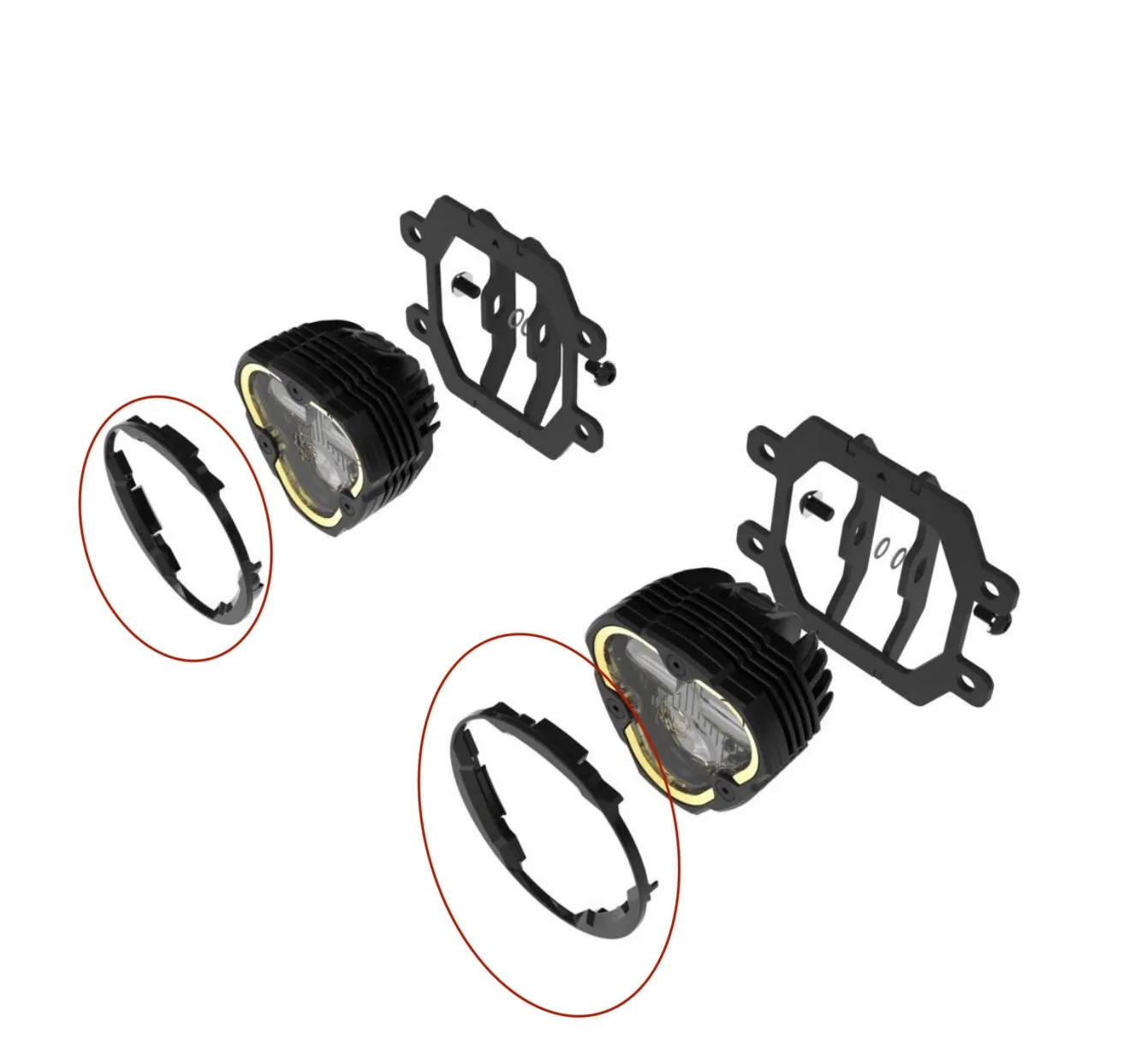

Hi Everyone, as I mentioned earlier, I have a mount that is, among other things, compatible with Subaru (Ford Bronco is not listed), and the bolt spacing fits perfectly, so I believe it will be fine – have a nice day
Ford Bronco Capable Bumper Foglight mount Capable bumper Fog Lights brecket

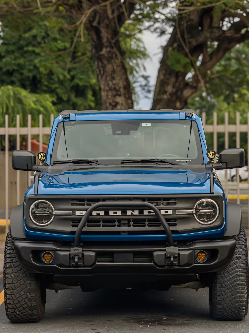

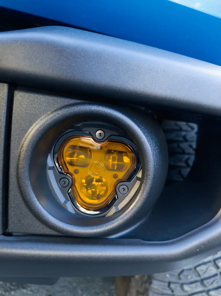

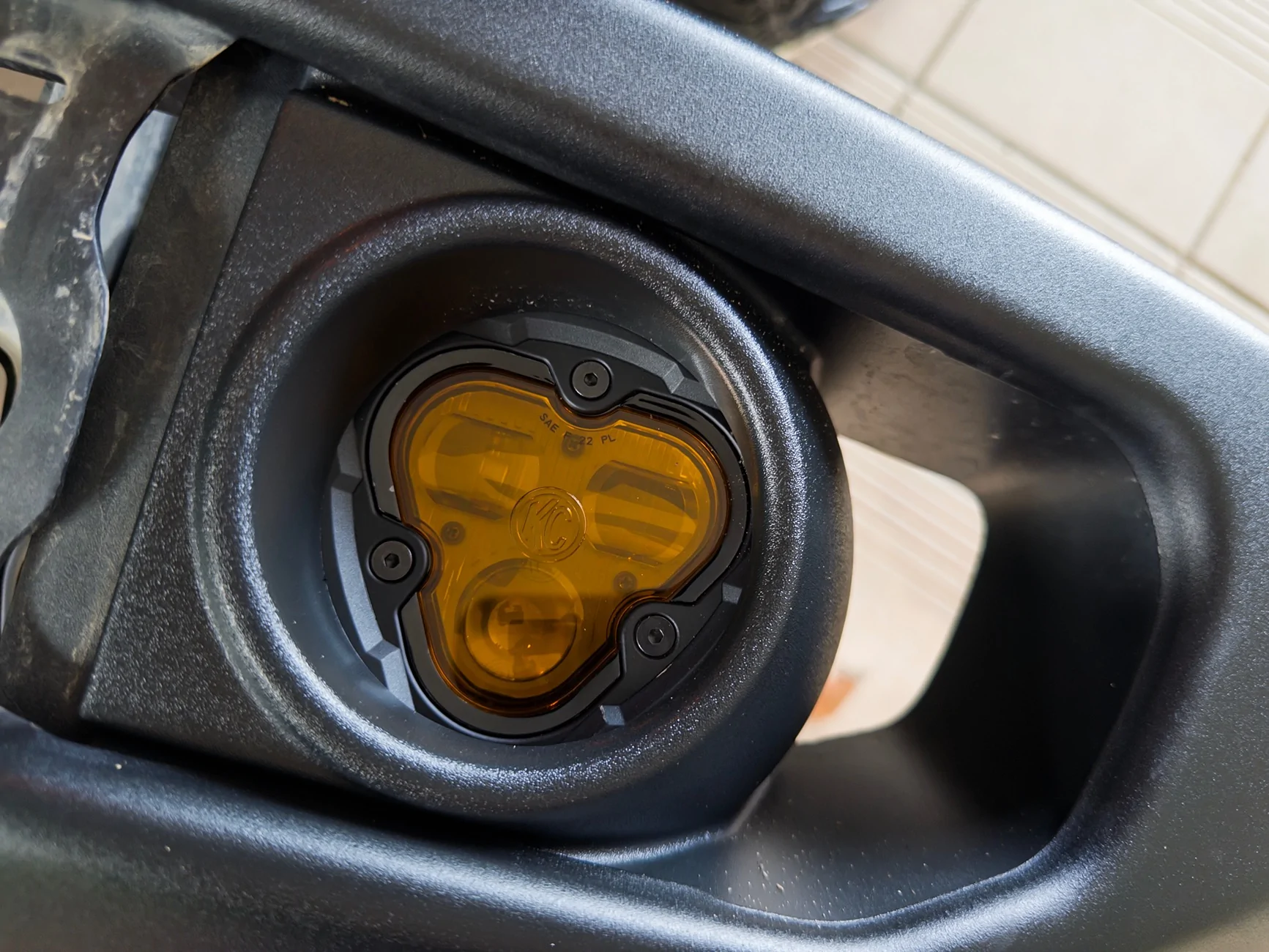

They Work, but with some caveats.
Ford Bronco Capable Bumper Foglight mount 1763378954902-cn
Right now the lights are aligned too low and there is no room for alignment, so illumination is not good. I’m planning on removing the bumper again and remove the circular plastic shroud so I can gain a few mm of alignment and try to point them a little higher.
Another options would be installing a few washers between the bumper housing and the lights bracket to retract them and make room for minor adjustments.
I have the IAG Bullbar, and the bullbar has to be removed before removing the bumper so I'll deal with that in a few weeks.
Ford Bronco Capable Bumper Foglight mount IMG_6628
As you can see they fit flush to the Bumper:
Ford Bronco Capable Bumper Foglight mount IDG_20251116_101650_612
Ford Bronco Capable Bumper Foglight mount 1763385467461-co

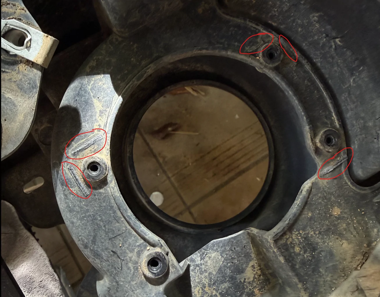

The only modification I did was breaking some guides the bumper has for the OEM Foglights, there are 5 that needs to be broken but they break very easily.
Ford Bronco Capable Bumper Foglight mount 1763385128328-pt
I'm planning to post a full writeup one I fix the Alignment issue. I'll tag you if you are interested.

Update:
Yesterday I removed the Bumper and installed a few washers between the Bumper Housing and the Fog lights bracket. This pushed the lights back a little so the lights had space to push them up or down for alignment. I didn't had 25 feet's of flat surface to align them as recommended but with some math I figured the beam drop for 5 feet's and align them accordingly.
This fixed my issue and now the lights are functional.
Image are not a great indicator here but they looks cool as hell. This is regular headlight (short beam) + Fogs
Ford Bronco Capable Bumper Foglight mount 1763994438447-ys
I had to do some errands at night and no one flashed me for my lights being too high or whatever.
I still want to check my beam height at 25 feet's eventually to make sure they are properly aligned.
