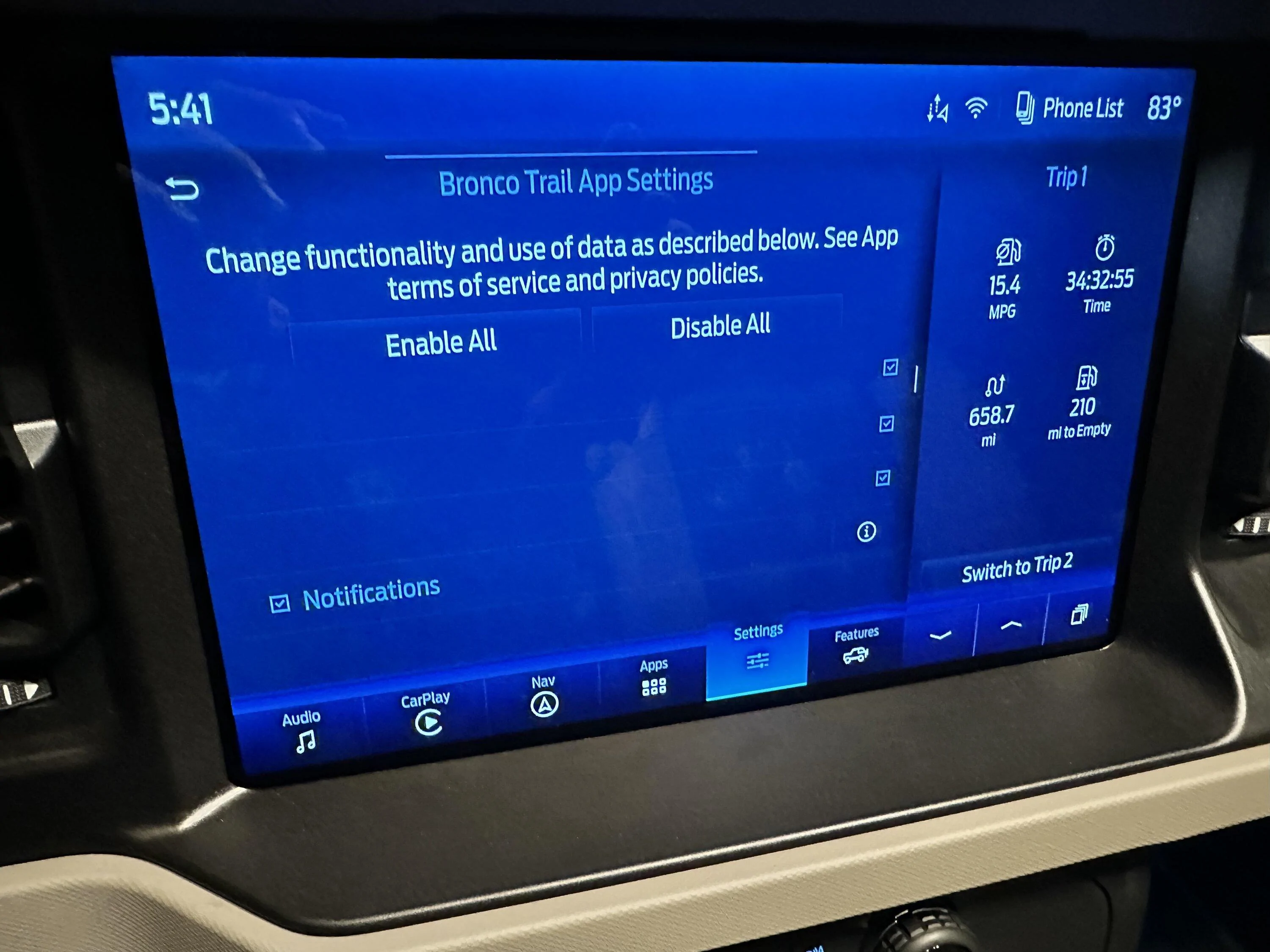

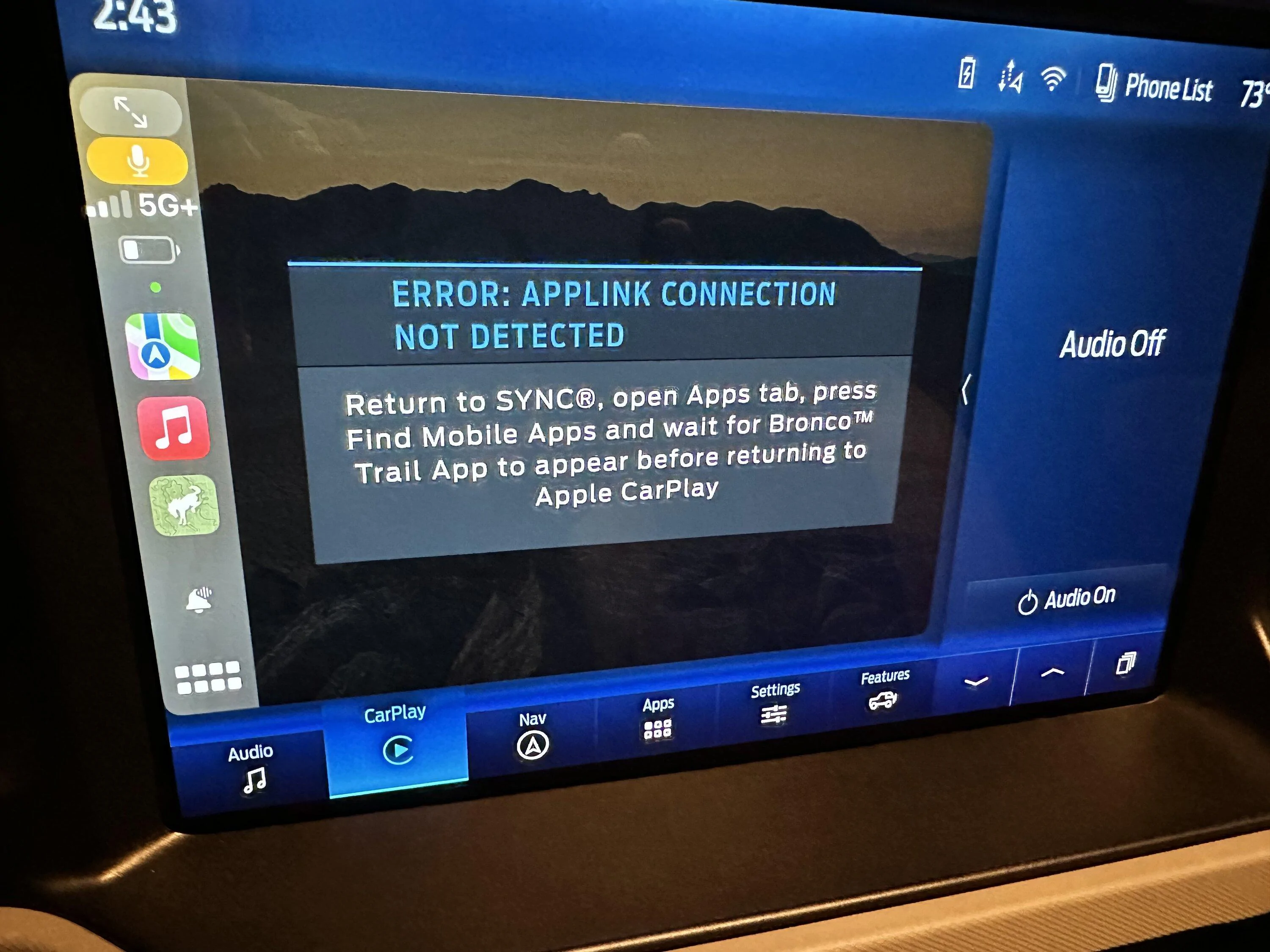

I cannot get the trail app to work. I’ve searched here, and it seems that I’m not alone, but I have not found a resolution. I reached out to Ford, and got a reply with troubleshooting steps. They did not fix the issue and I have not heard back from them. I have tried uninstalling and reinstalling both the trail app and Ford pass. The app worked for me when it first came out.
Ford Bronco Can’t get trail app to work. IMG_1805
This is the error message I get.
Below is the screen to enable/disable connectivity. It does not display correctly
Ford Bronco Can’t get trail app to work. IMG_1808

I get an error trying to use the app on my iphone. Support said it was because I have a Raptor. Maybe it was the excuse of the day. I haven't tried it via sync.

I haven't seen that second screen before. Odd.

I've found I rarely get that AppLink error if I'm using wired CarPlay. But it's not consistent. Sometimes the app will launch just fine via wireless CarPlay, but some of the controls will be disabled.

I get the OP's first error message occasionally when I'm out and shutdown and startup the Bronco occasionally. Sometimes force quitting the app on the phone will work. Once I got it to work by making it quit on Sync (on Sync go to Apps -> Bronco Trail App and like the only option there was something like "Quit the App Link"). Sometimes stopping and restarting the Bronco will work. Sometimes just letting it sit there a minute will work. Sometimes nothing works and it sucks.
When I went to Off-Roadeo a couple of weekends ago, I couldn't get it to work at all with the provided Bronco (same error you are having), but it worked just fine in my own Bronco when I got back to that. That said, I didn't exactly have a lot of time to fiddle with it in what amounts to a rental car, so I ended up using a free OnX account to keep an eye on the trail while we were out.
The second error message - the app needs a ton of permissions on your phone. You have to be on the phone to do it - it wants all your location/photos/camera/etc. I did see that once when I had deleted the app (I choked it trying to download too many offline maps at once) and re-installed it. On an iPhone you can go to Settings -> Bronco Trail App (down near the bottom) and turn on all the permissions.
I also will occasionally get the "You need to sign in" error out in the middle of nowhere when the phone gets 1 bar of service randomly then drops, and won't let me back in.
