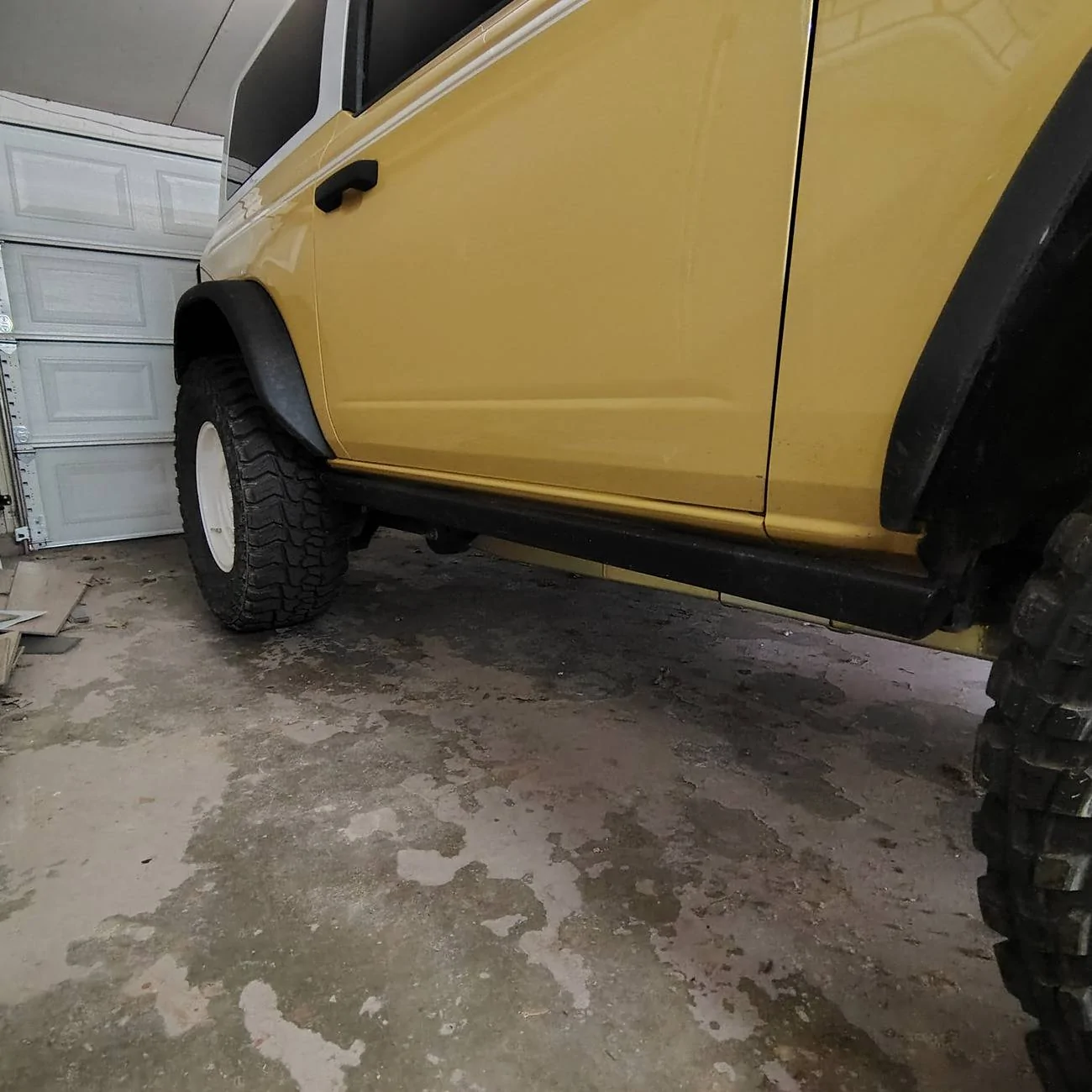

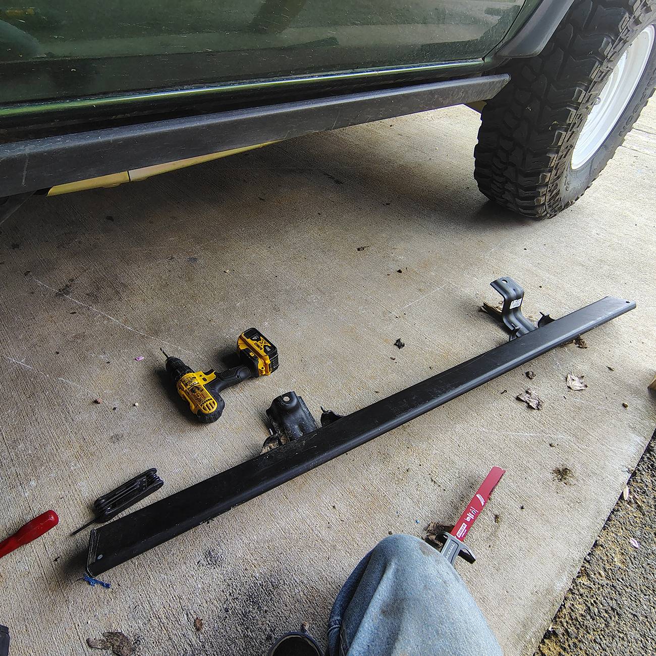

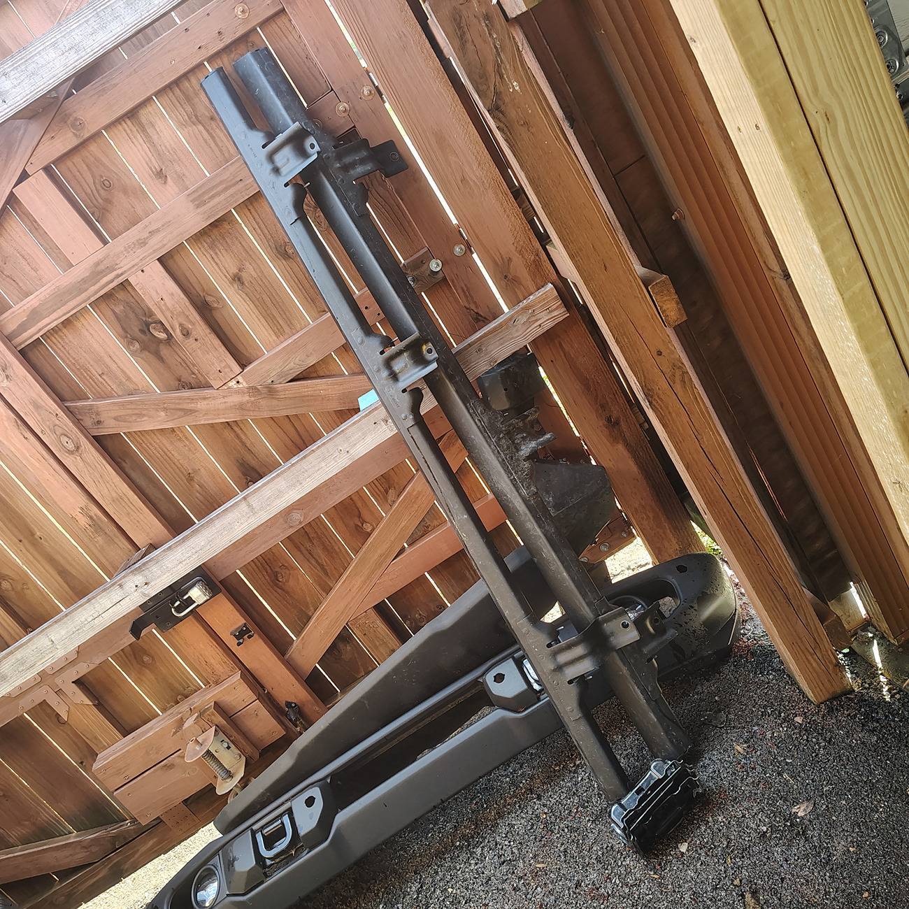

Took me over a month to find a stock set of rock rails and the only ones I could find close by, were for a 4 door..., but at least they had the mounting brackets, for $100, plus about a 2 hour round trip.

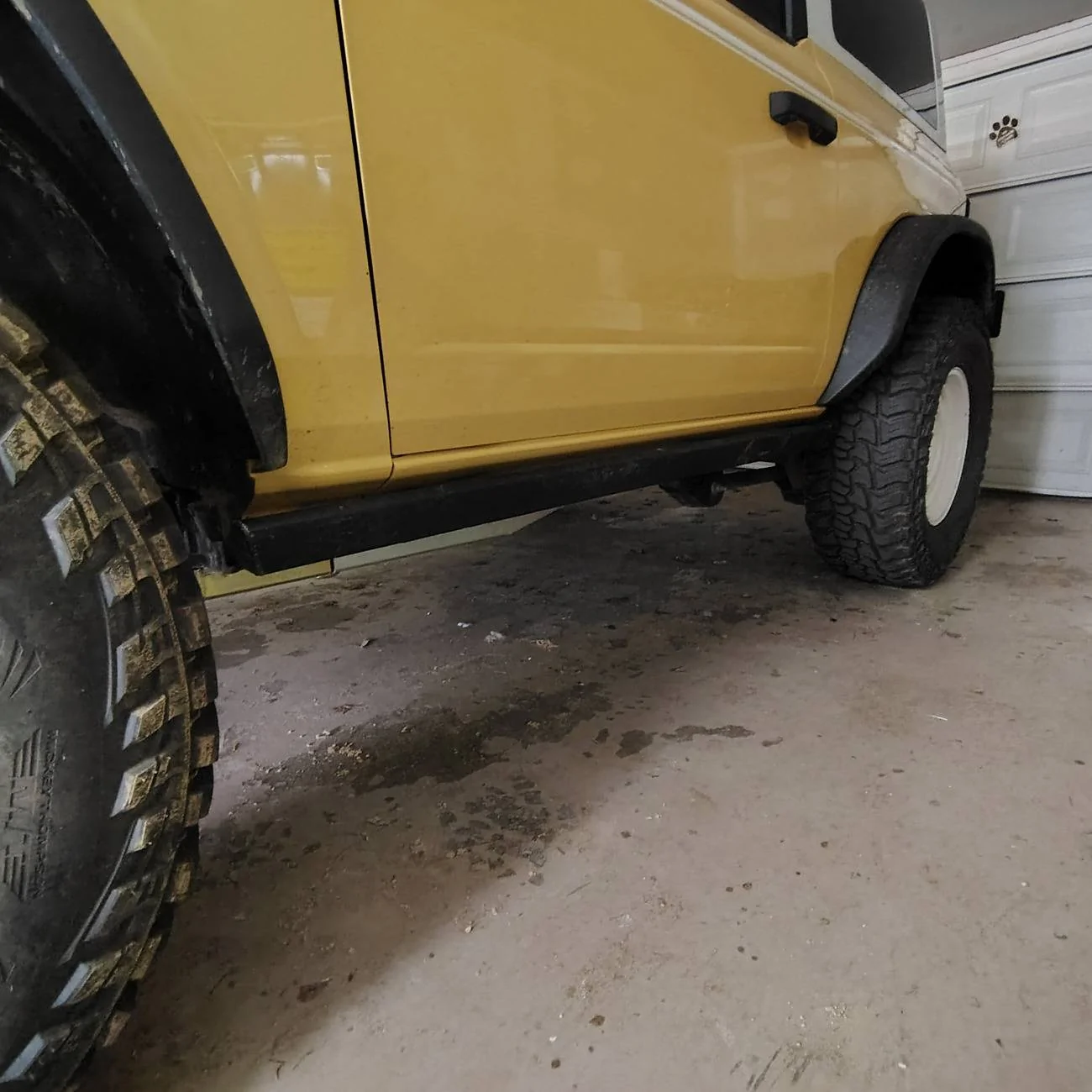

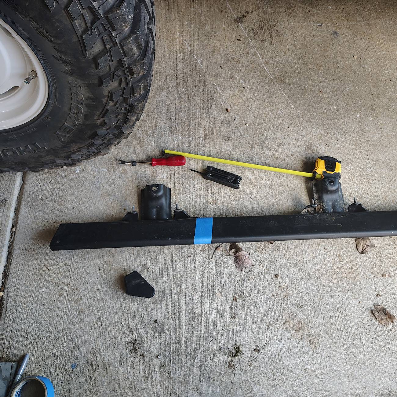

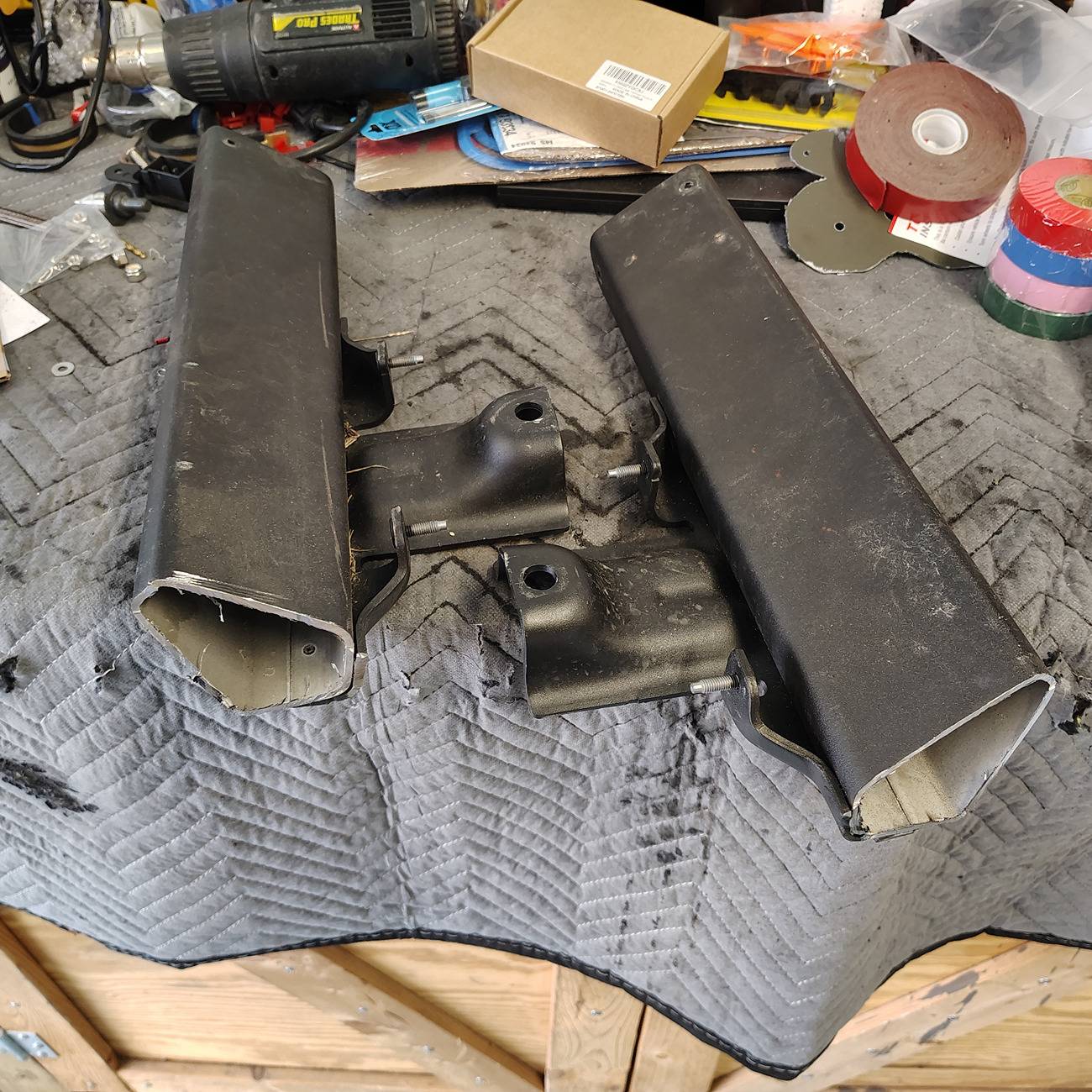

When she got home from work that afternoon, I started modifying the rails to fit the 2 door.
I believe I cut off 15.5" of the rear part of the rails?

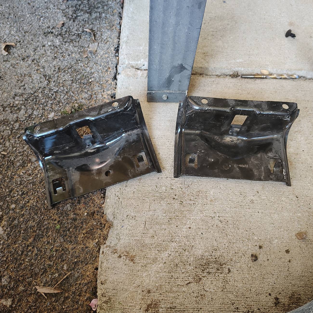

And these are the 2 mounts you'll use for the 2 door. These would be the middle mounts for the 4 door.
I ordered her some IAG steps, since she's 5'3" :D I will post pics of them, once I install them.

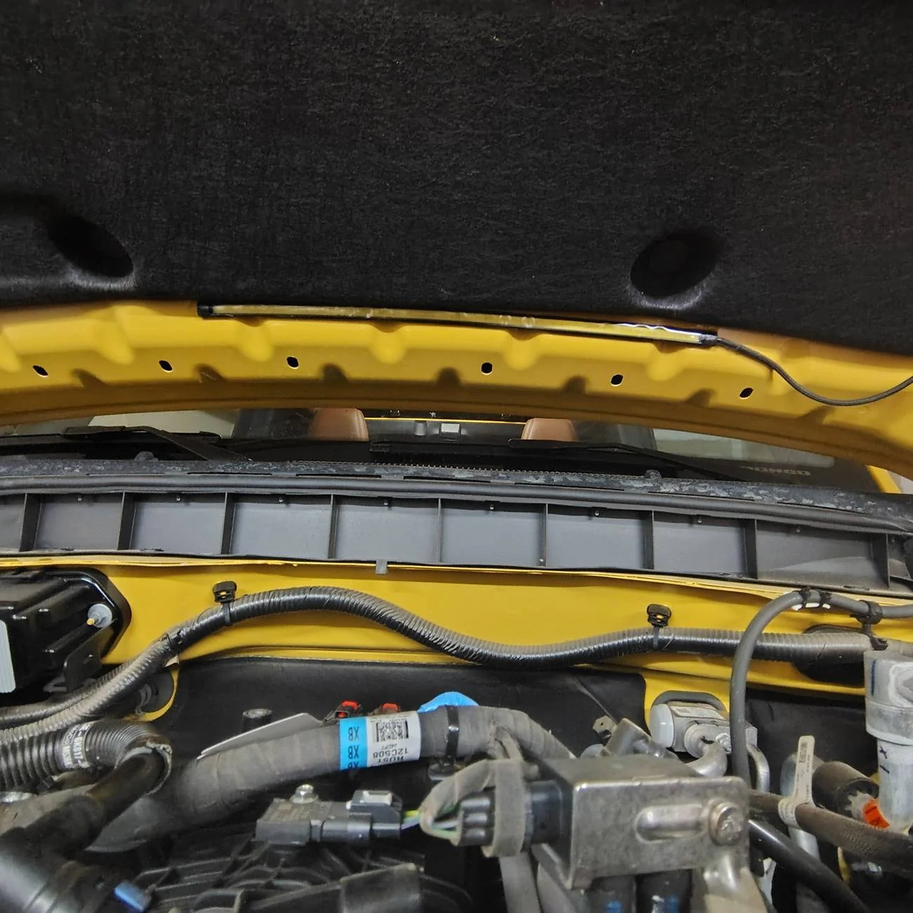

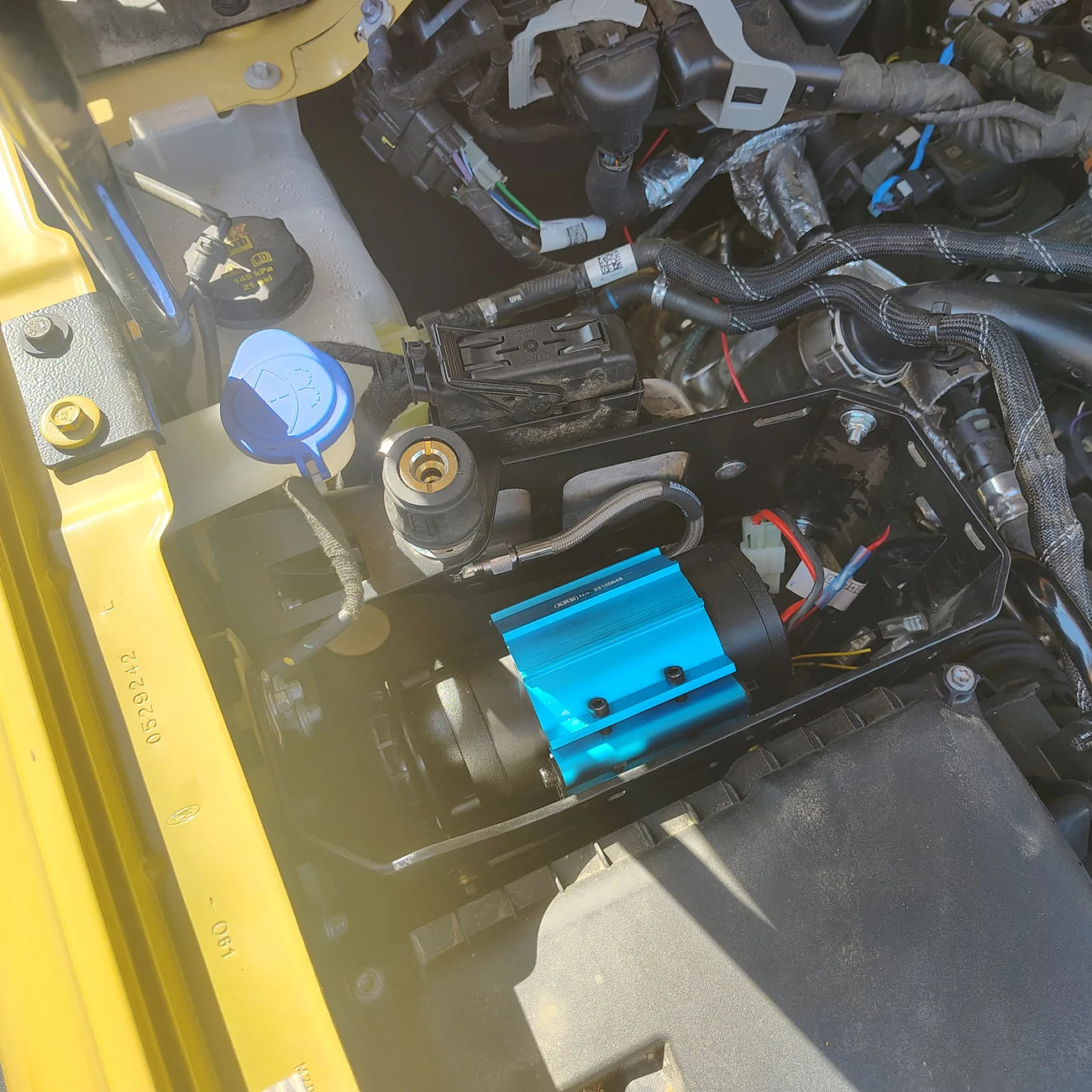

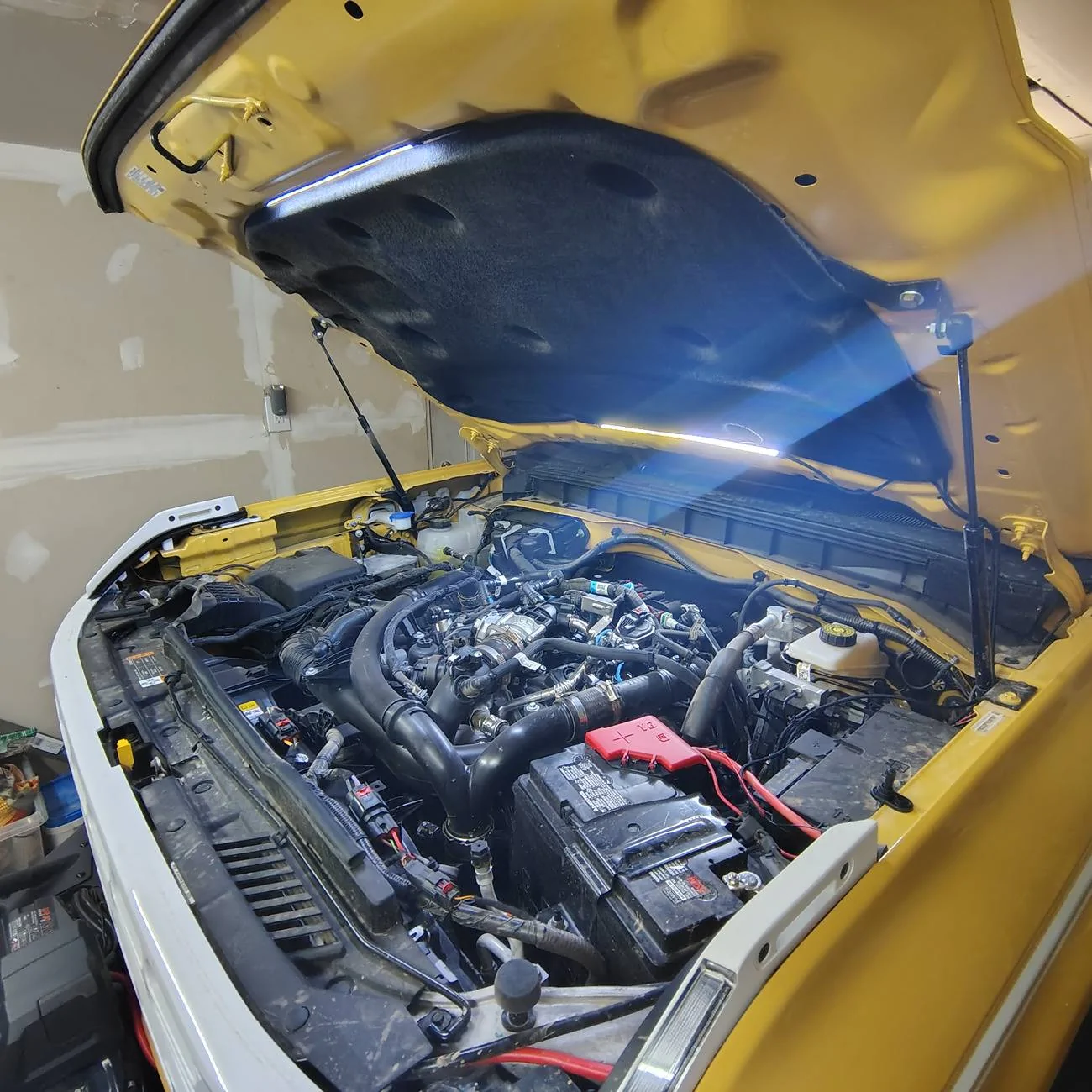

Was too exhausted to post these pics last night, but I also installed the LED Under-hood lights in the wife's Bronco!
Ford Bronco Butterscotch, 2dr HEL, Wife's Build IMG_20250420_181940447_HDR
Ford Bronco Butterscotch, 2dr HEL, Wife's Build IMG_20250420_181946545_HDR
Ford Bronco Butterscotch, 2dr HEL, Wife's Build IMG_20250420_182123174_HDR

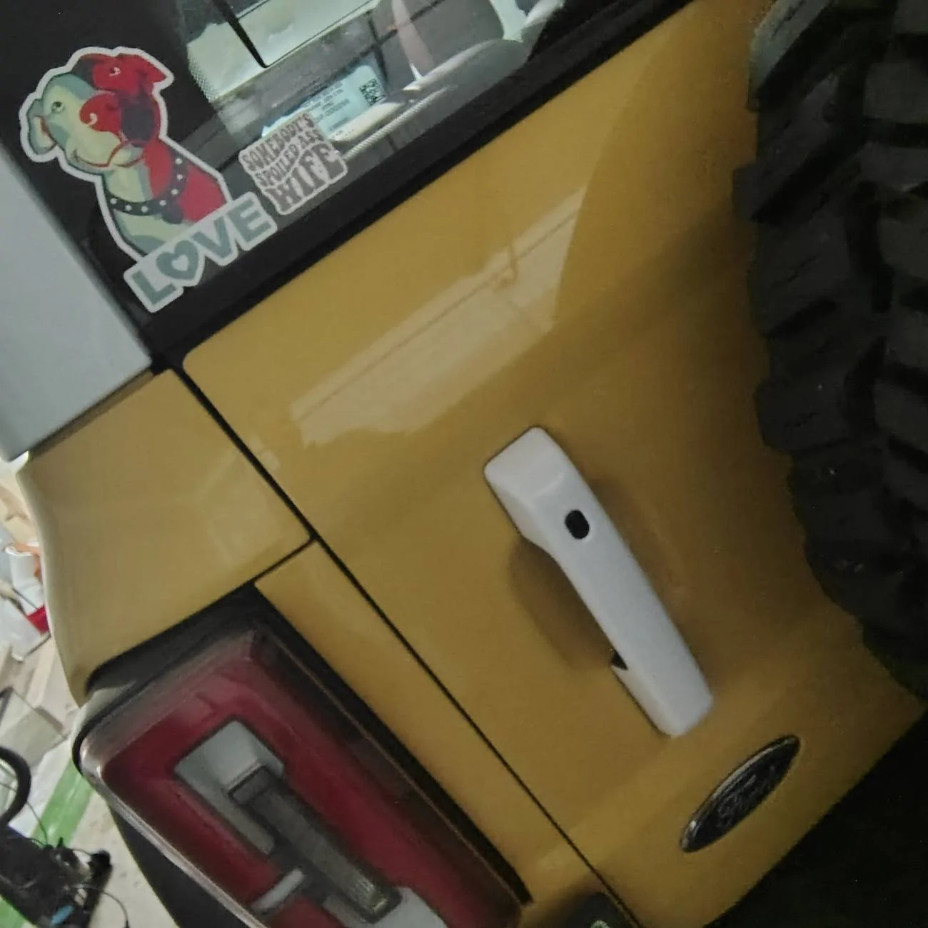

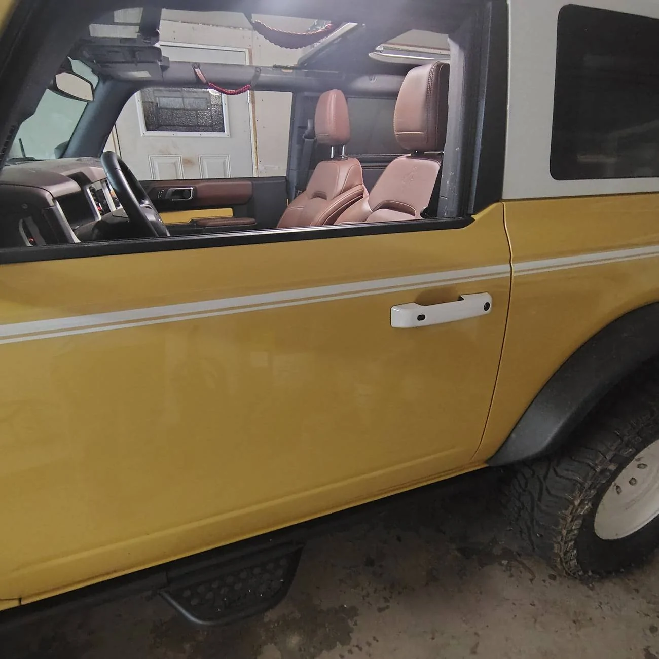

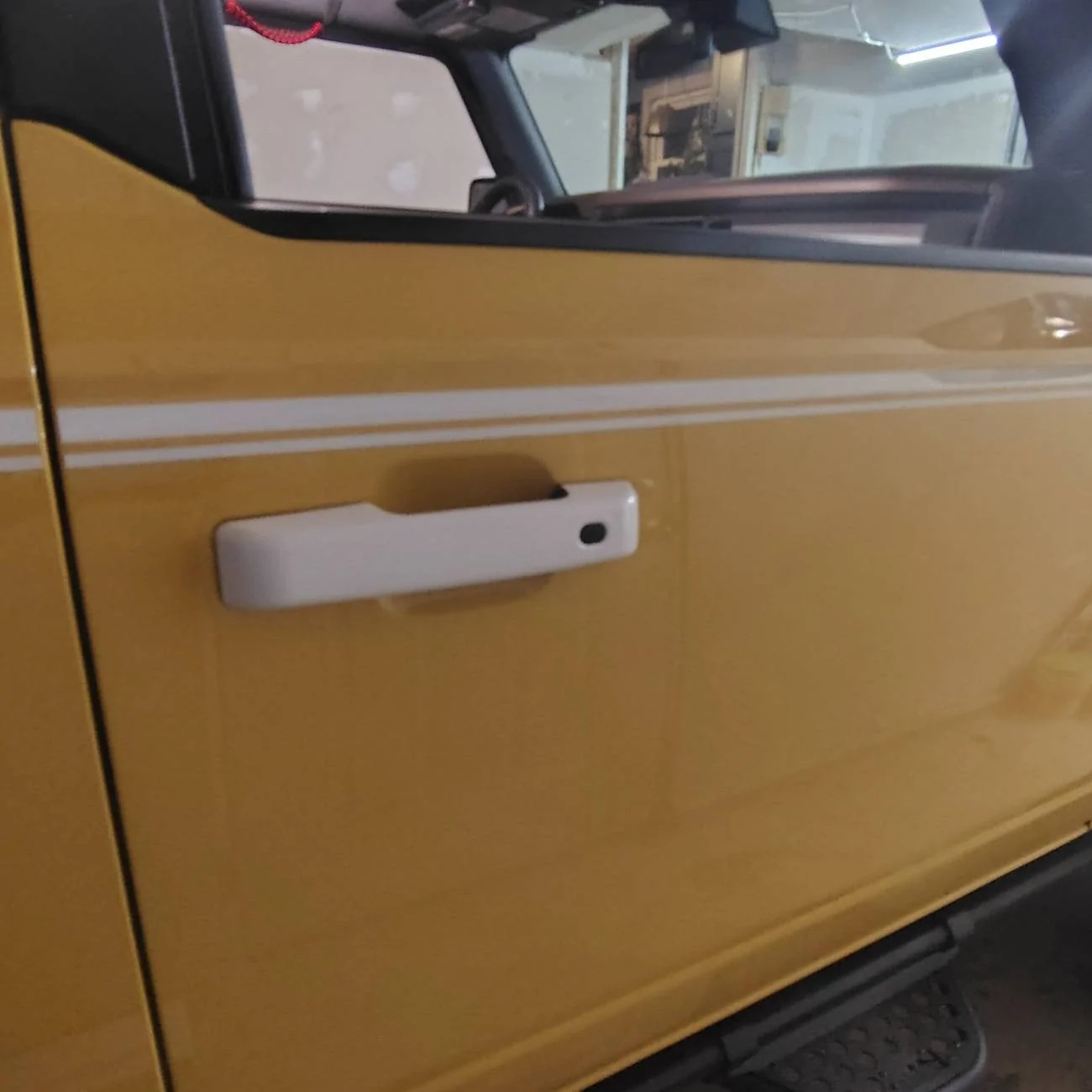

She ordered some Gloss White Door Handle Covers last year and we misplaced them until finding them last night! I installed them for her.
Ford Bronco Butterscotch, 2dr HEL, Wife's Build IMG_20250420_195632215_HDR
Ford Bronco Butterscotch, 2dr HEL, Wife's Build IMG_20250420_195701791_HDR
Ford Bronco Butterscotch, 2dr HEL, Wife's Build IMG_20250420_195651412_HDR

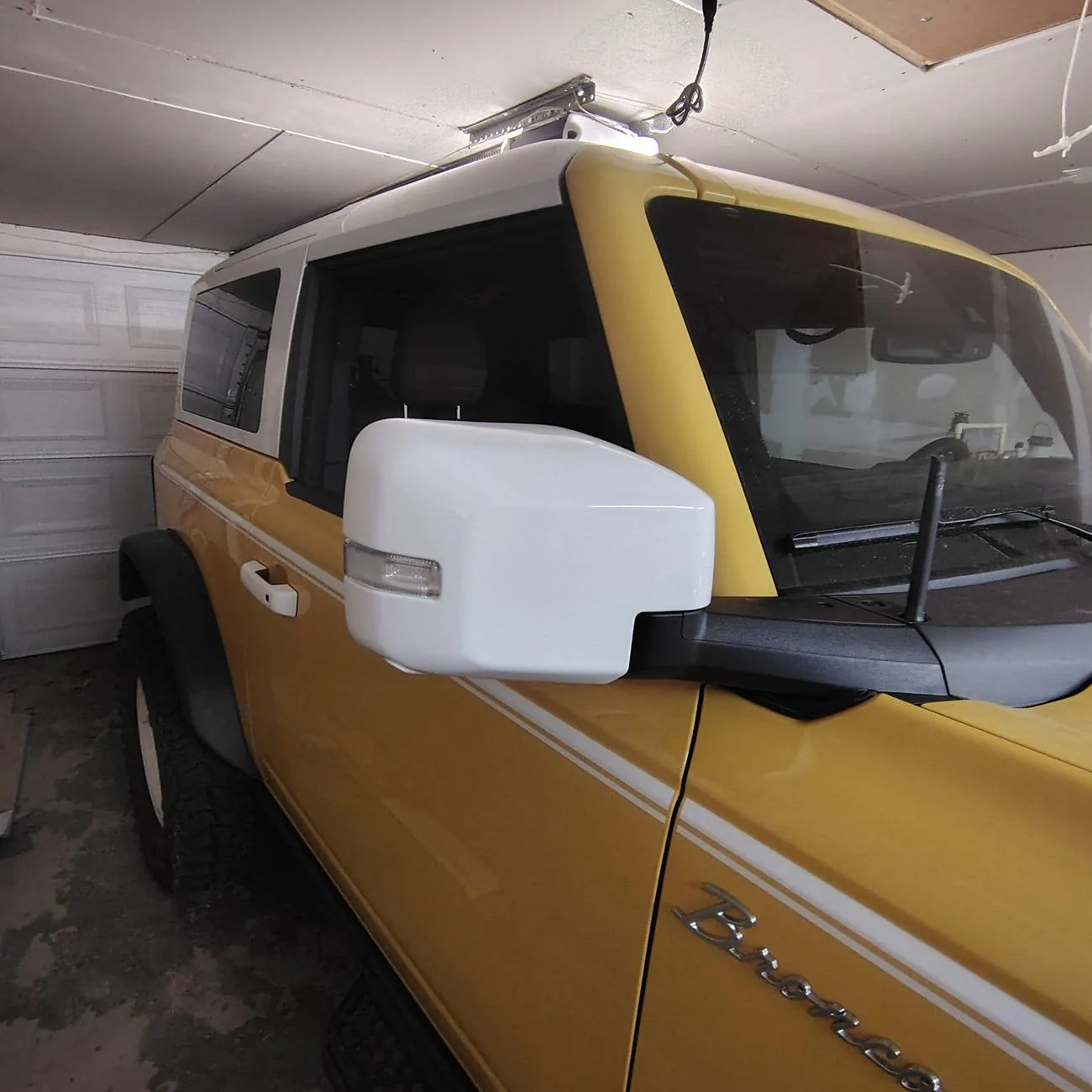

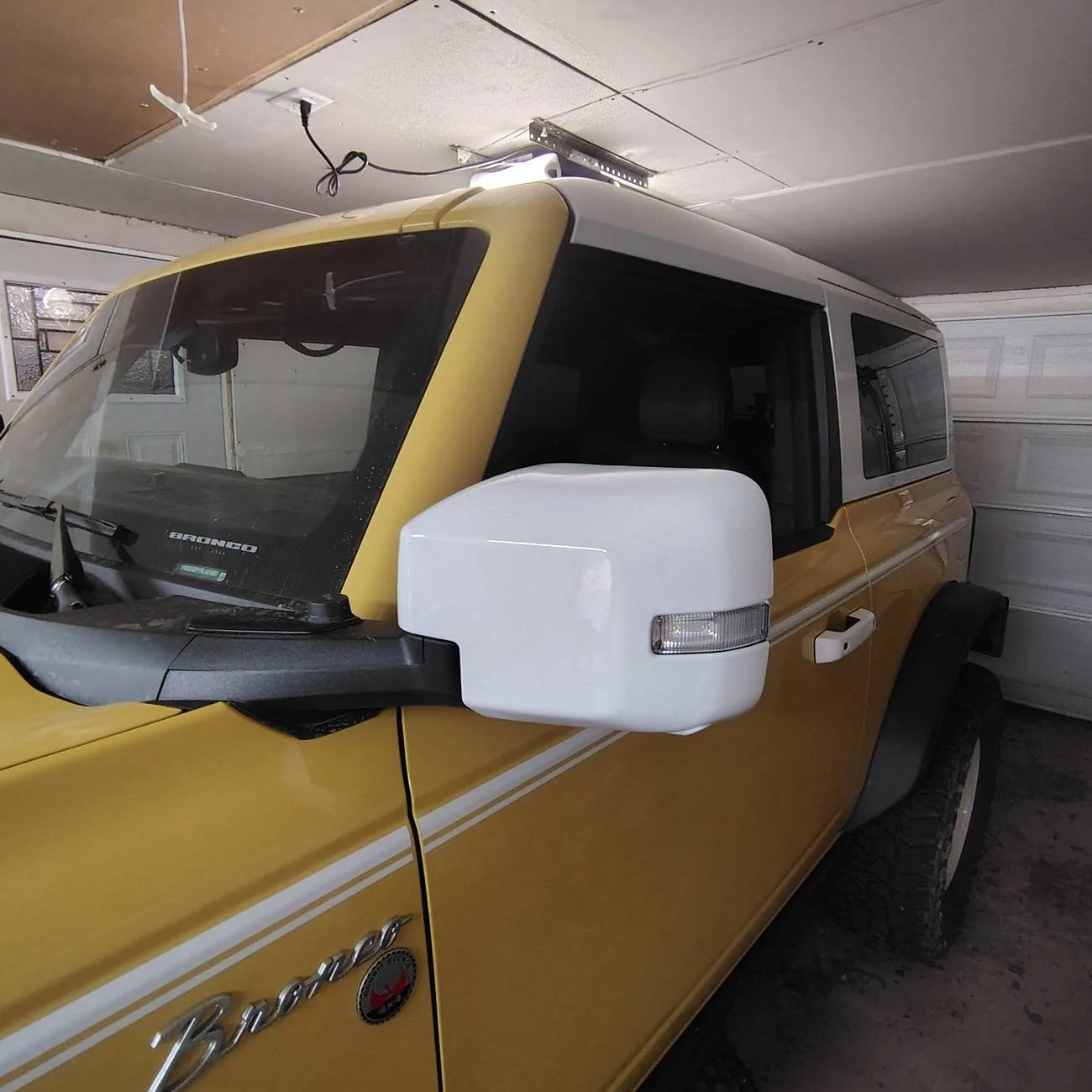

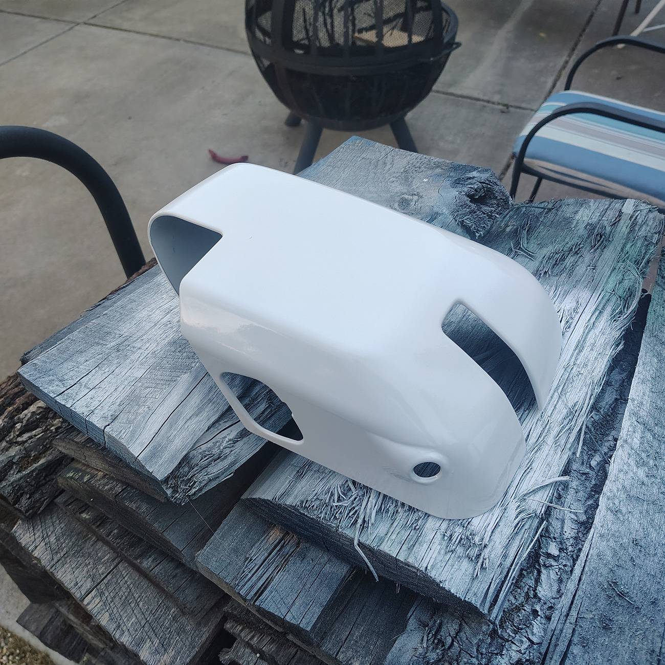

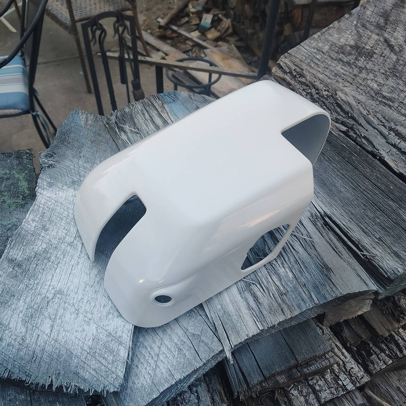

I also repainted her mirror covers, that we bought almost a year ago! I painted them last year and had some bad runs. I meant to sand out the runs and repaint them in August, but forgot about it, LOL! I found them while cleaning up my garage yesterday, LOL!
Ford Bronco Butterscotch, 2dr HEL, Wife's Build IMG_20250420_192610483_HDR
Ford Bronco Butterscotch, 2dr HEL, Wife's Build IMG_20250420_192613859_HDR
I shot them with just plain ole Gloss White for plastics, then used some Ford Gloss clear coat. They came out better this time! I installed them today, after work. I personally don't care for them, but she likes them and it's her Bronco!

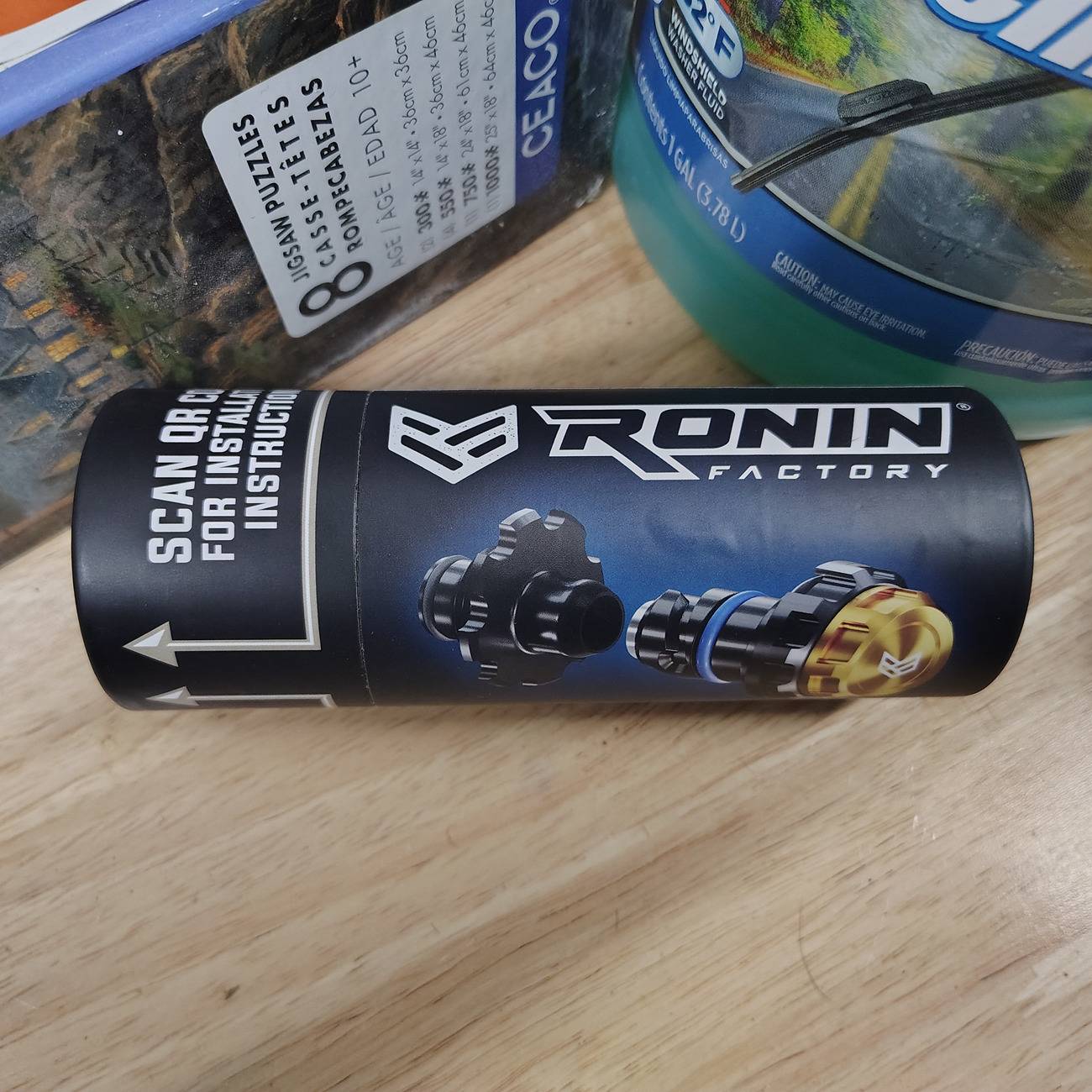

Changed the wife's oil last night and installed, the Ronin Factory, easy oil change plug!

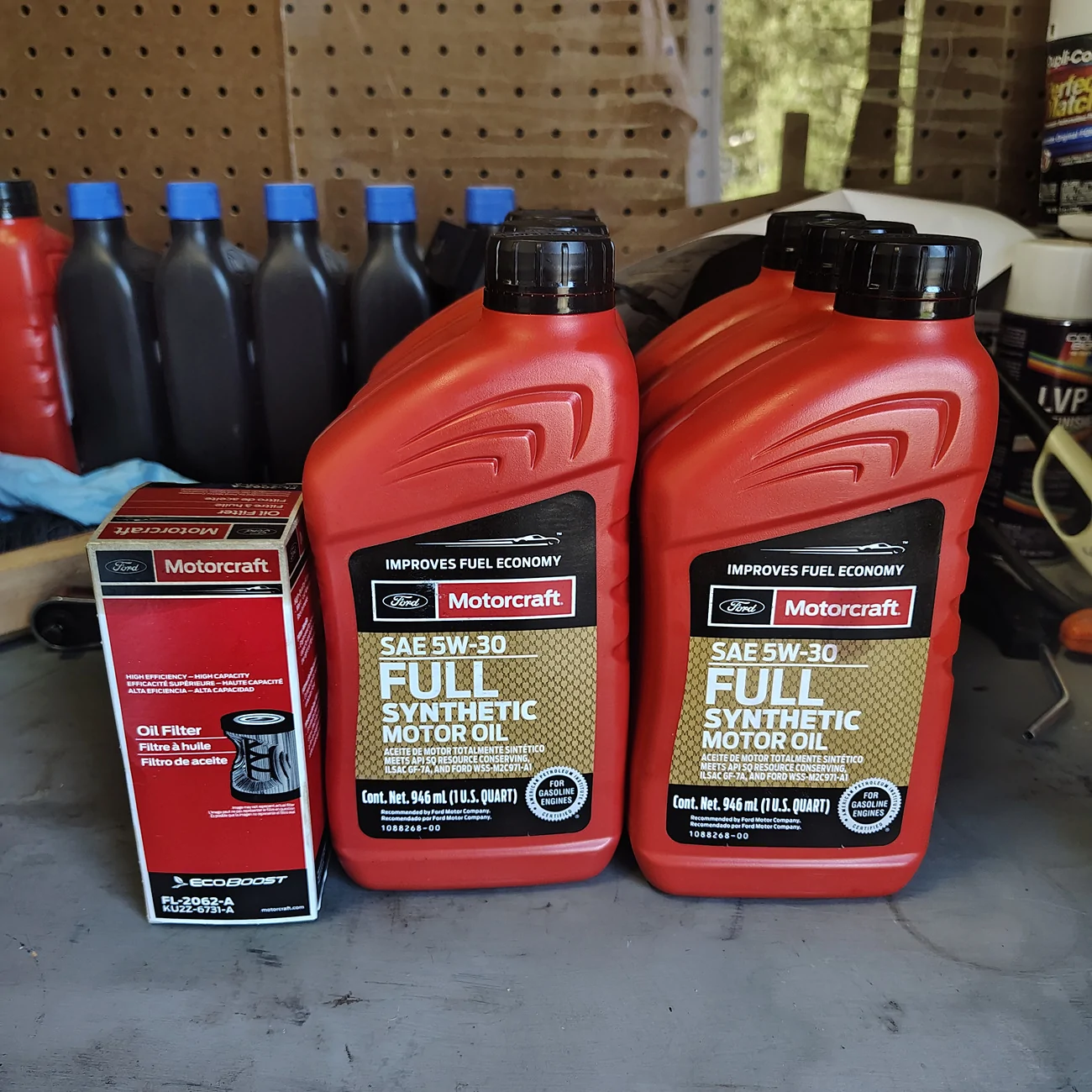

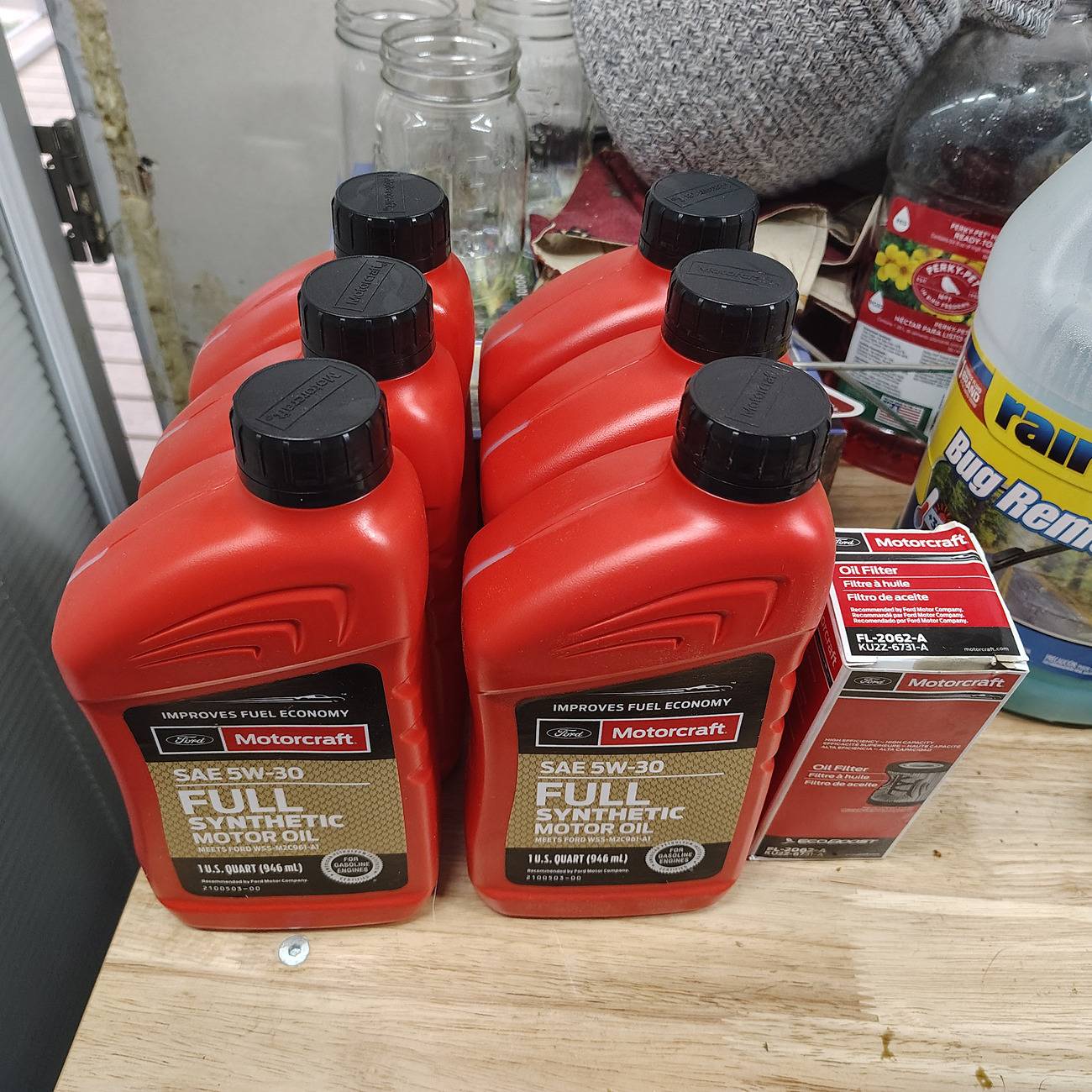

Since I believe in using good oil, (your opinion is not needed here), I only use Motorcraft oil in my Ford vehicles! Used 6qts of Full Synthetic 5w30 and a new Motorcraft paper filter/o-rings. Next oil change, hers will get a Baxter adapter, like mine has!
Ford Bronco Butterscotch, 2dr HEL, Wife's Build Laura 1st oil change @ 2436 miles

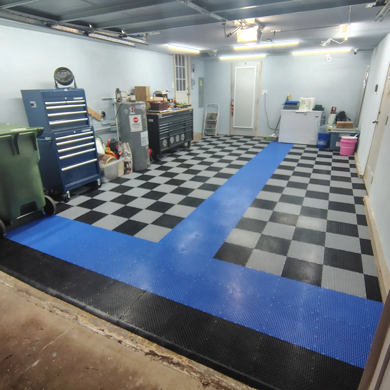

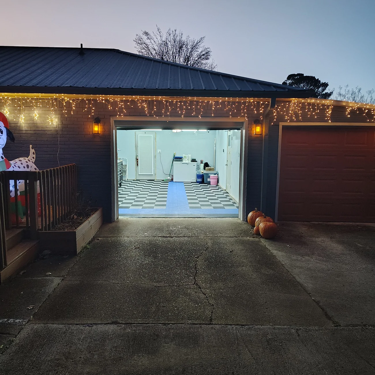

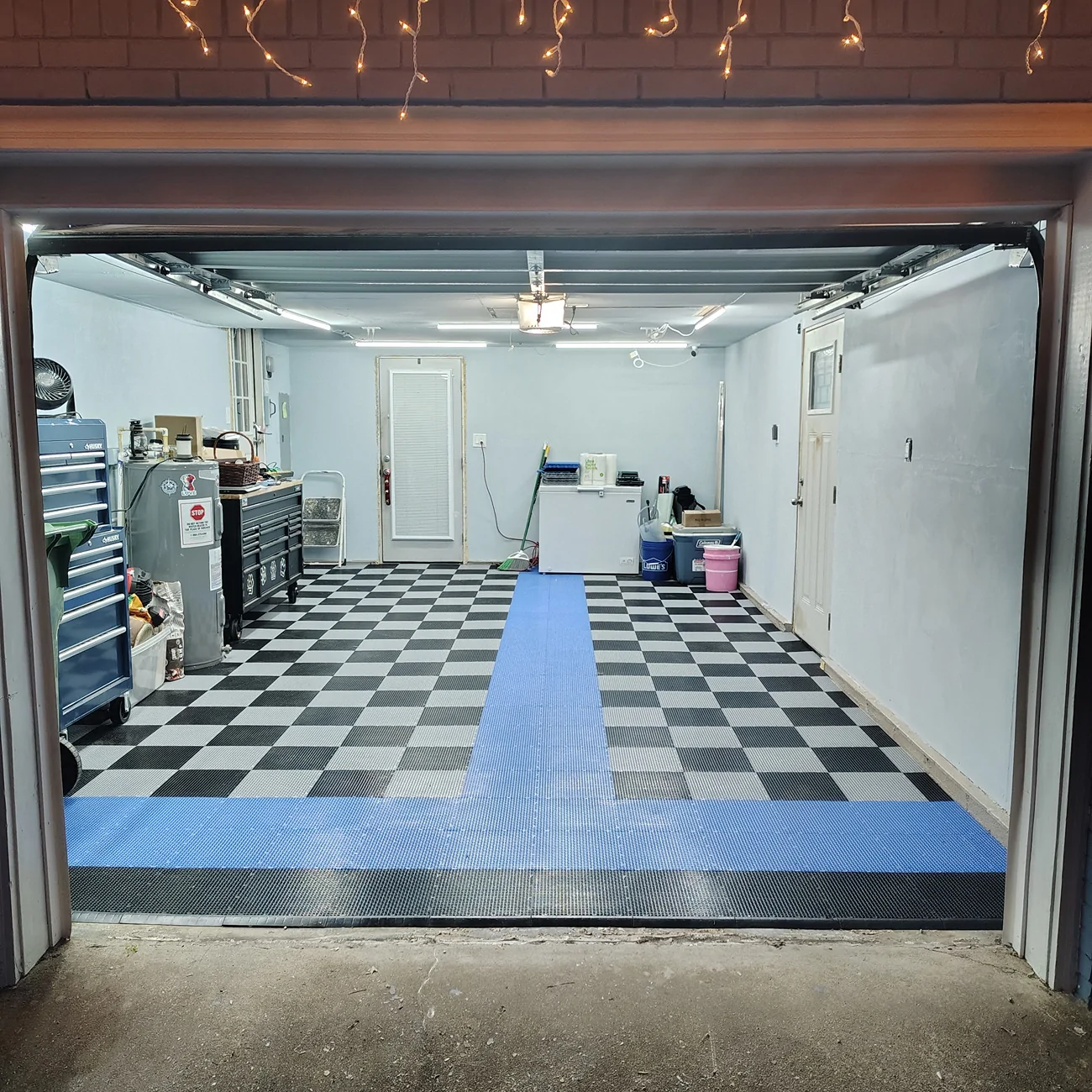

Not really an update on her Bronco, but it's where her Bronco sleeps at night ;)

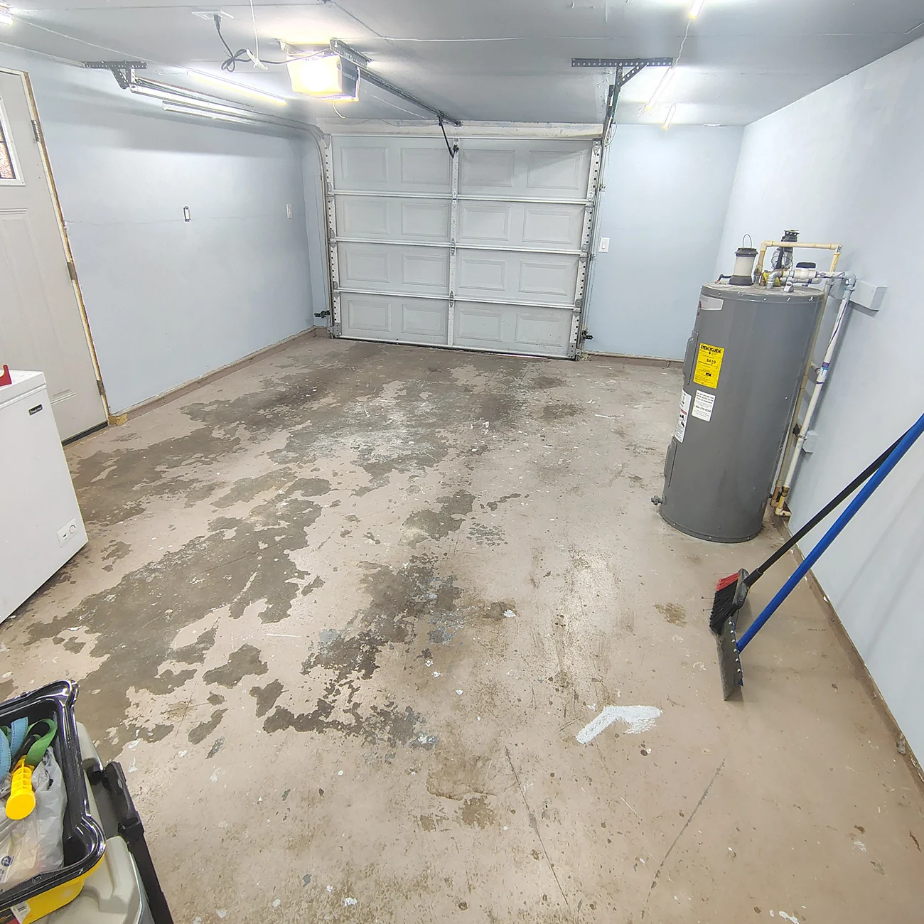

We've lived in this house for almost 10 years and never updated the attached garage floor until today.
I did remove the old, nasty sheetrock walls in December of 2019 and added much nicer, thicker sheetrock and added good rolled insulation. In the Summer of 2022, I removed the crappy sheetrock on the ceiling and did the same as the walls; new sheetrock and insulation, as well as a HD attic ladder.
The only thing my wife was supposed to do, for this project, was to finish the sheetrock and paint everything, while I did everything else....
Well, here it is, almost the end of 2025 and I finally got her to paint her garage late November and finished it up yesterday actually!

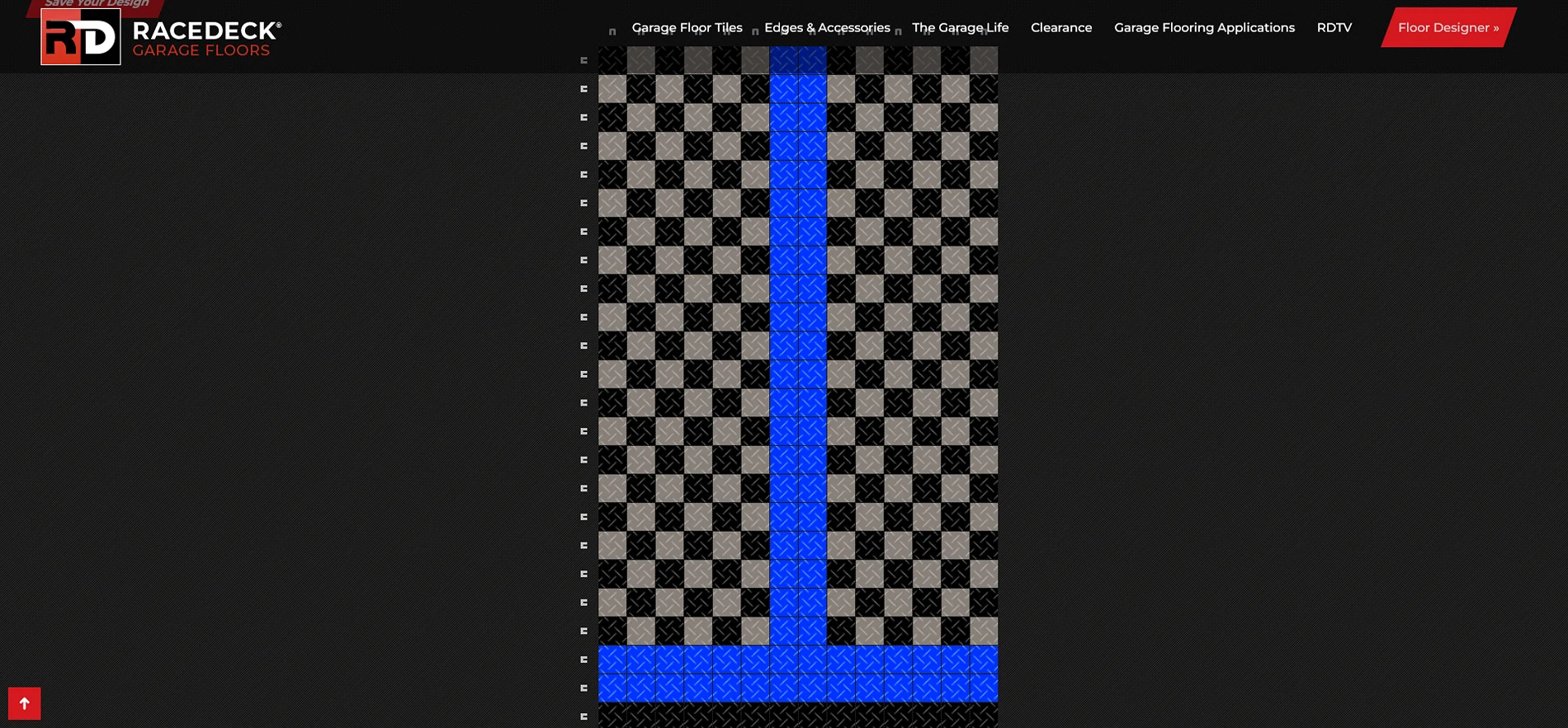

Around Thanksgiving, we talked about what we were going to do to the floors? We thought about what I did to my detached garage 6 years ago, it would've been about $250, but unsure how we would get the dogs out or stay off the floors for 3-4 days... We looked at Race Deck Garage Floors. They had a Black Friday sale going on, but only on certain tiles/colors. I asked the wife what she liked and we made this online:
Ford Bronco Butterscotch, 2dr HEL, Wife's Build Screenshot 2025-12-21 at 17-15-17 RaceDeck Garage Floors
So, we ordered the tiles on November 29th for $886.08 shipped! That was for:
GarageFlow - Gray - 128pcs
GarageFlow - Black - 138pcs
GarageFlow - Bright Blue - 72pcs
RaceDeck Edges - Black - 14pcs
UPS lost a box, a few days after they shipped... It took damn near 2 weeks to get the replacement box for the one they lost and that replacement box finally arrived this past Friday...

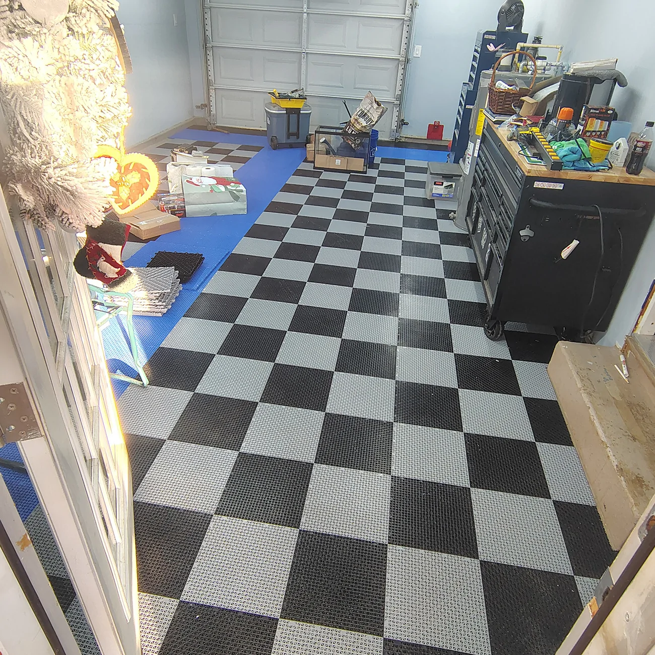

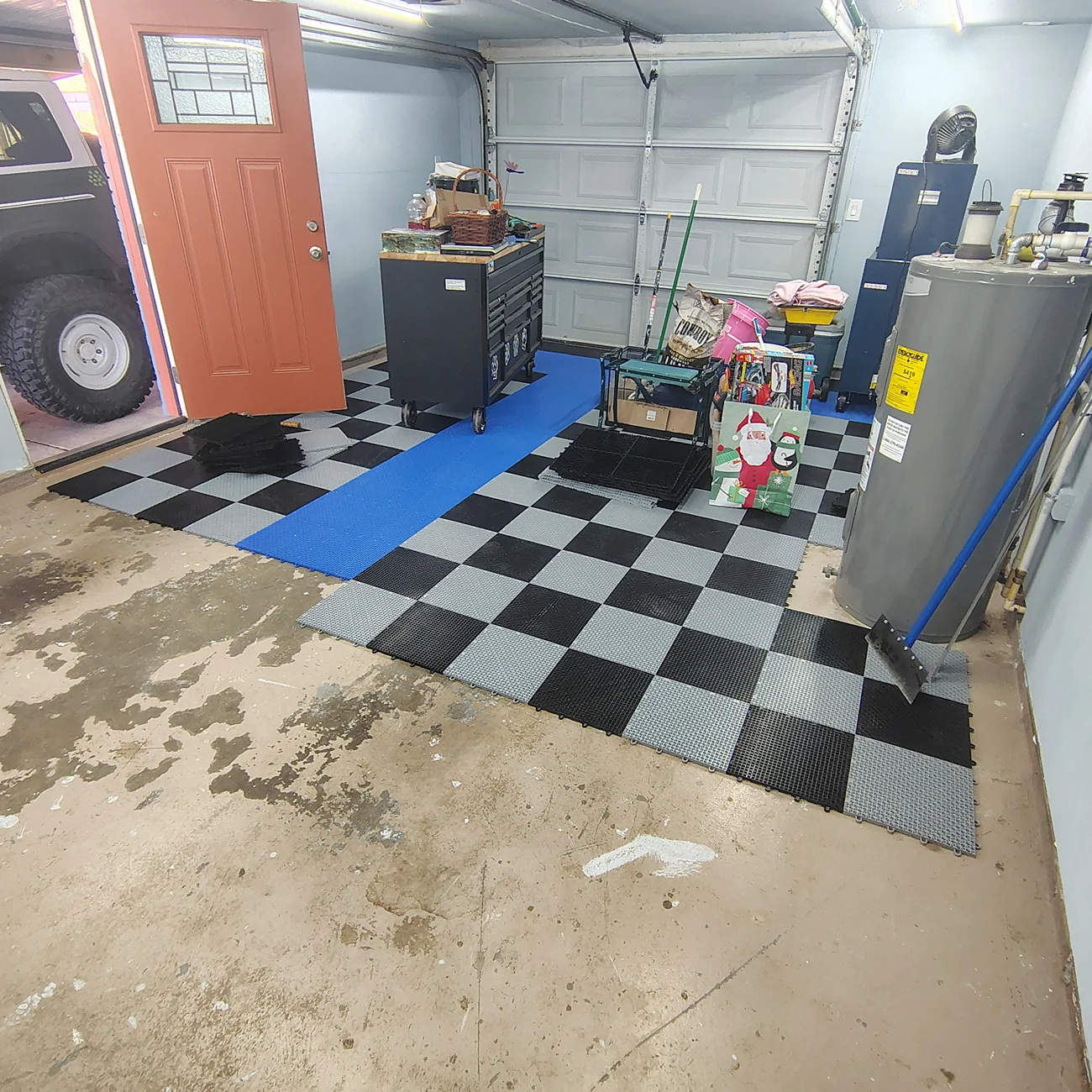

So, the wife finished painted yesterday and early this morning, I started cleaning up the mess and installing the tiles!
Ford Bronco Butterscotch, 2dr HEL, Wife's Build IMG_20251221_094220321_HDR
Ford Bronco Butterscotch, 2dr HEL, Wife's Build IMG_20251221_121754142_HDR
Ford Bronco Butterscotch, 2dr HEL, Wife's Build IMG_20251221_153817970_HDR
We had to offset the double blue center tiles over some, to be inline with the center of the garage door. I know it looks off, but it's actually lined up correctly :)
Ford Bronco Butterscotch, 2dr HEL, Wife's Build IMG_20251221_165957089_HDR
Ford Bronco Butterscotch, 2dr HEL, Wife's Build IMG_20251221_170010644_HDR
See :)
Ford Bronco Butterscotch, 2dr HEL, Wife's Build IMG_20251221_170259246_HDR

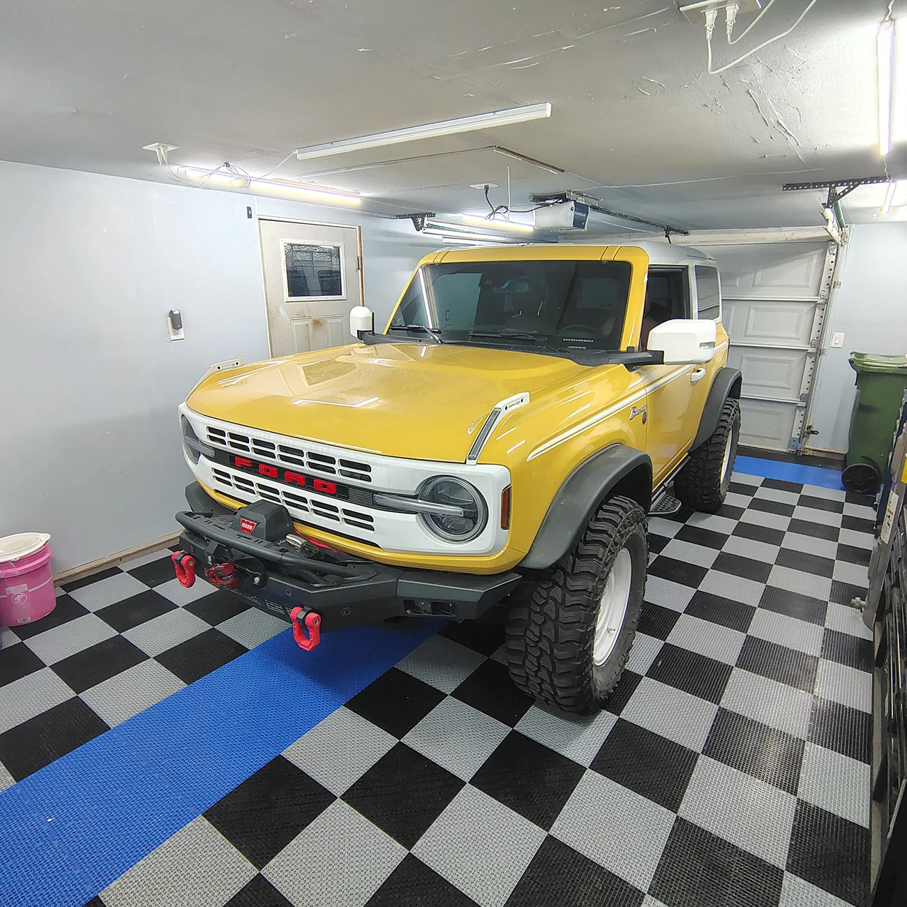

With the tiles installed and the walls/ceiling finally painted, the garage looks larger to me? Yes, there's a texture in the paint, it's some new technique she found that she wanted to try? Next update in here will be the addition of several storage shelves, painting the walk-in doors and insulating the garage door!
Ford Bronco Butterscotch, 2dr HEL, Wife's Build IMG_20251221_173226773_HDR

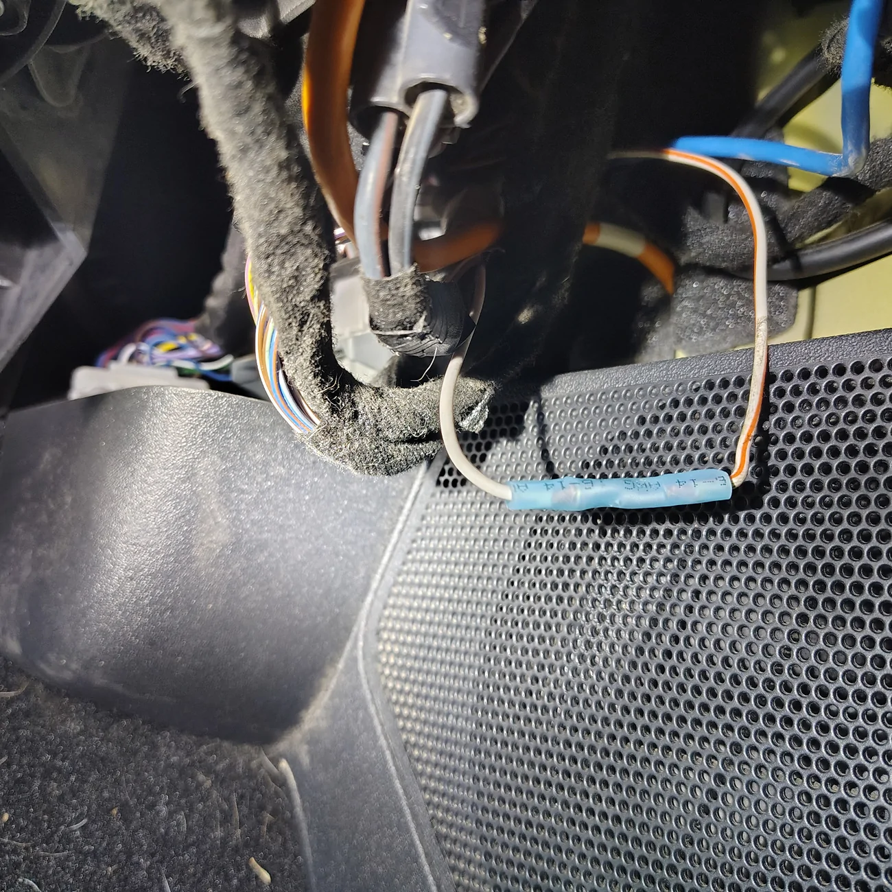

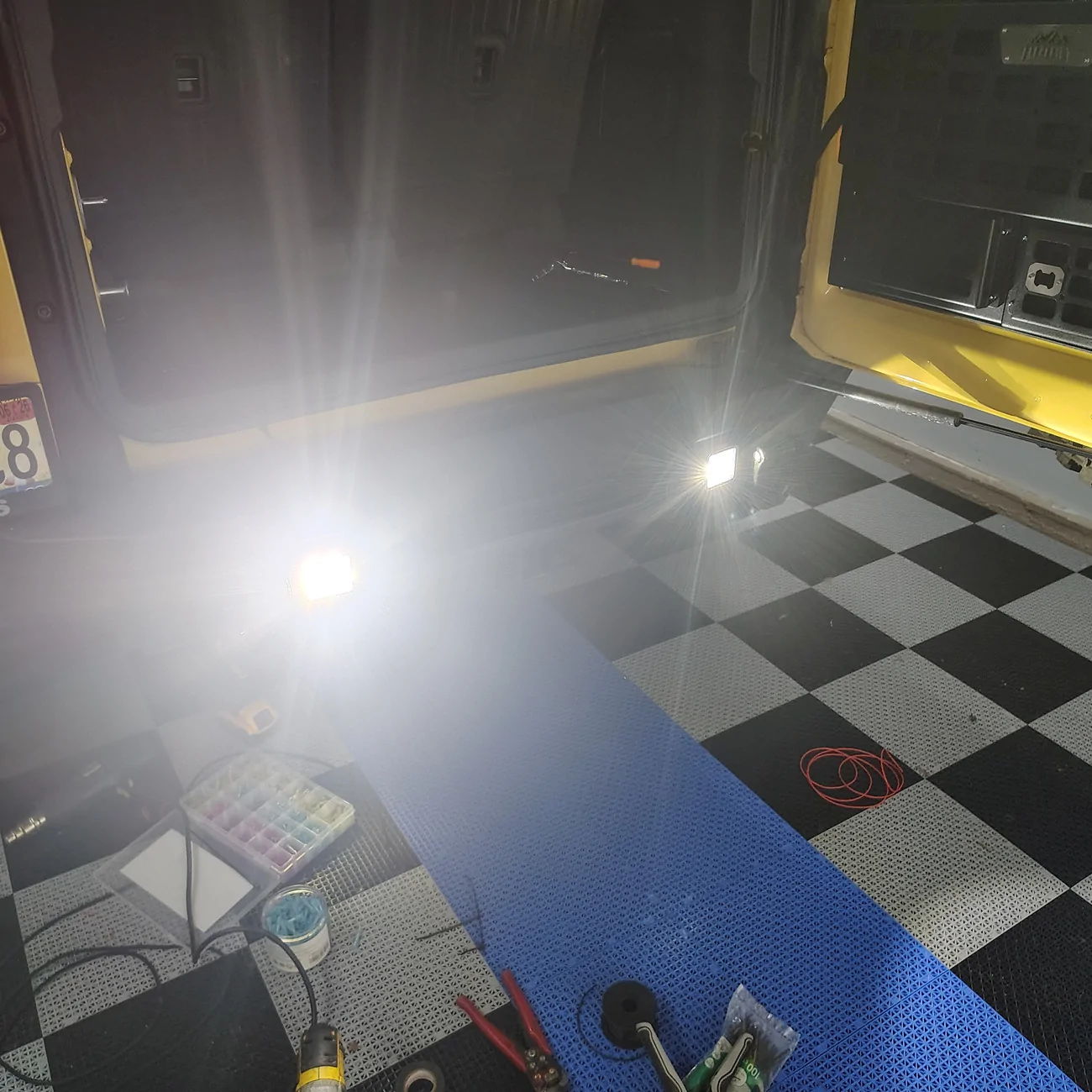

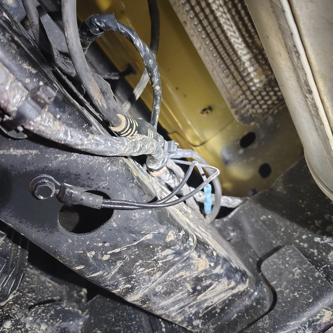

Well, almost 2 years later, I finally wired up my wife's bumper lights to the up-fitters AUX switches! It took a lot longer than I thought it should, but getting to the right "rear" quarter panel Orange/White wire was a total PITA! I did it last at least, drilled holes in the rear and added grommets and wire wrap stuff. So we'll start with what I did last, LOL!
This is the connection I made behind the glove-box door.
Ford Bronco Butterscotch, 2dr HEL, Wife's Build IMG_20260110_155106078_HDR

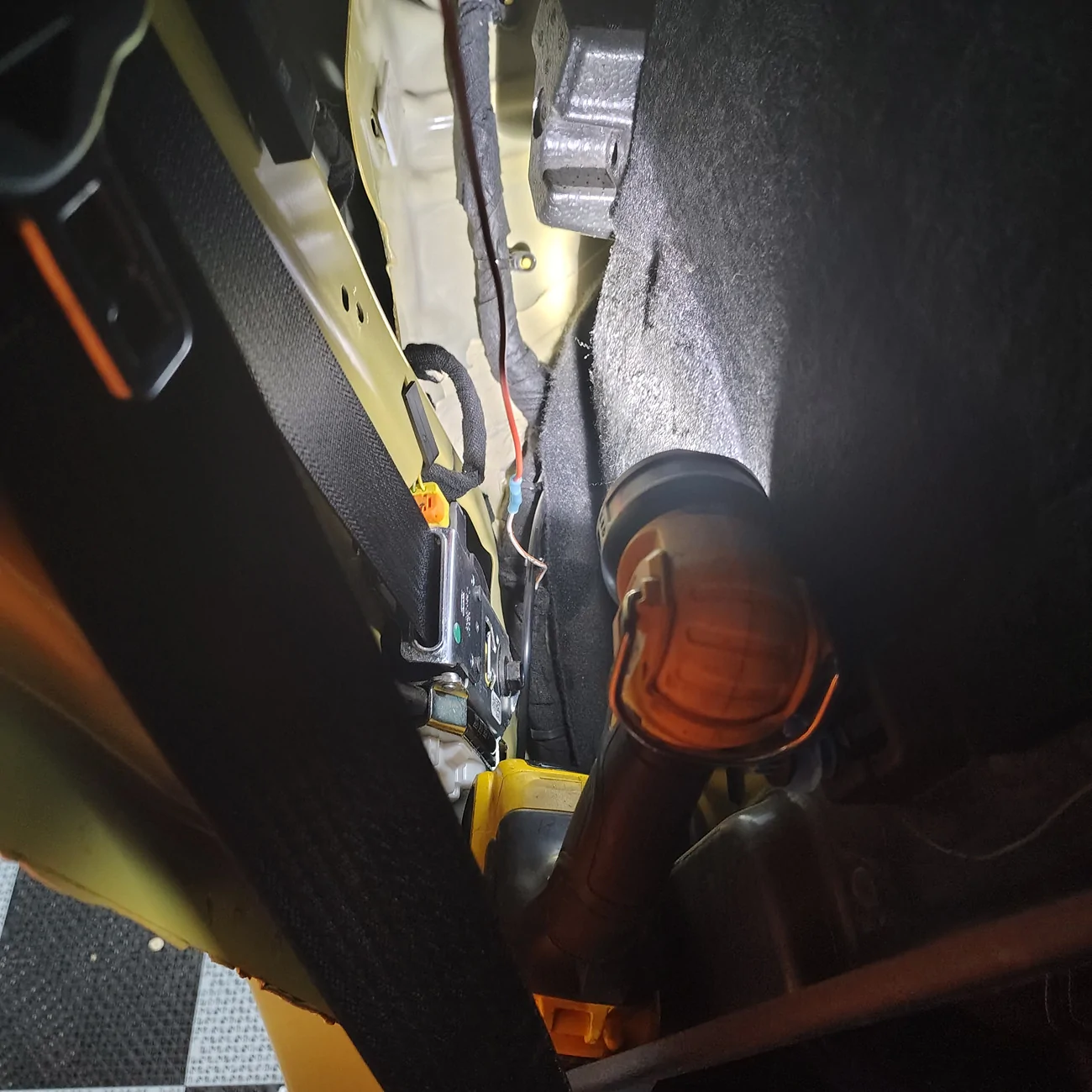

Here's the other end of that wire in the right "rear" panel.... My ass, it's nowhere near the rear of the Bronco, it's right behind the front seat....
Ford Bronco Butterscotch, 2dr HEL, Wife's Build IMG_20260110_135642469_HDR
I routed the new Orange/White wire through wire loom and across the rear of the Bronco.
Ford Bronco Butterscotch, 2dr HEL, Wife's Build IMG_20260110_144532903_HDR

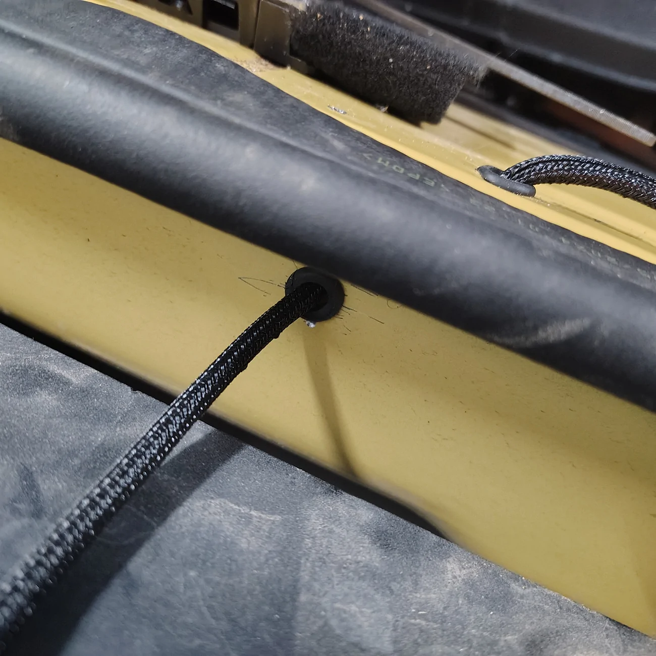

I drilled two 7/16th's holes and used two 3/8th's grommets, to get the wire on the opposite side of the muffler tip!
Ford Bronco Butterscotch, 2dr HEL, Wife's Build IMG_20260110_144538507_HDR
I wired her bumper lights up, made a clean ground connection and sprayed undercoating to protect it.
Ford Bronco Butterscotch, 2dr HEL, Wife's Build IMG_20260110_154944661_HDR

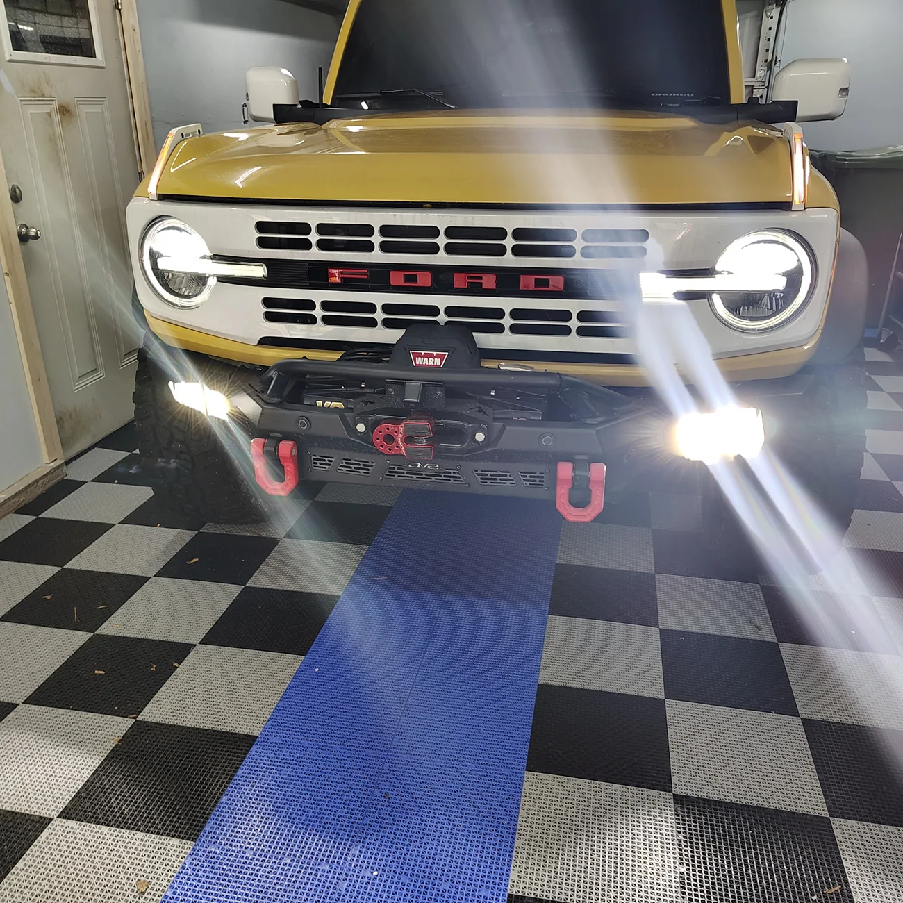

End result! These things are bright AF!
Ford Bronco Butterscotch, 2dr HEL, Wife's Build IMG_20260110_153851505_HDR

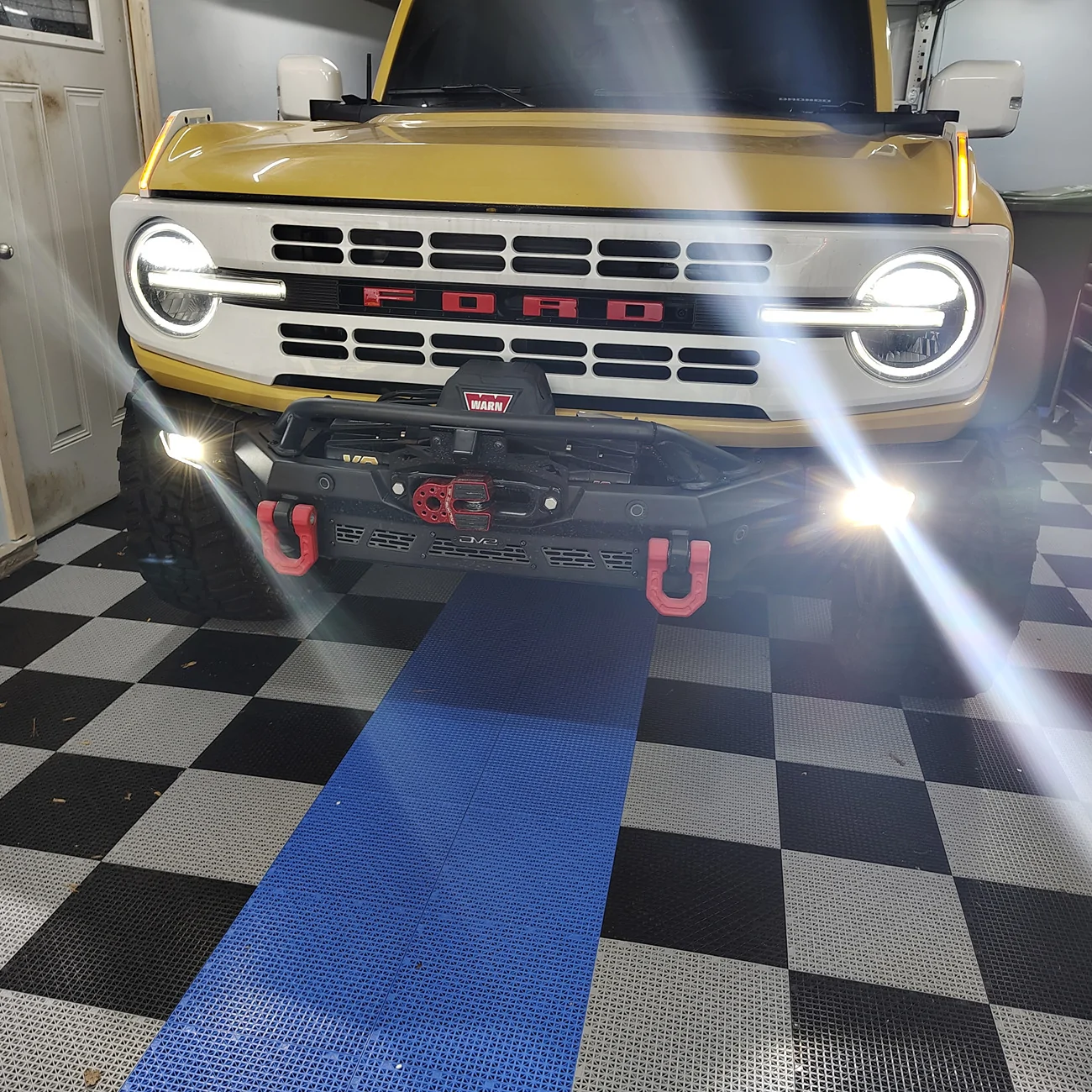

Before the rear lights, I wired up her extra pair of front bumper lights, (that have been installed since I installed her bumper, LOL)!
Ford Bronco Butterscotch, 2dr HEL, Wife's Build IMG_20260110_162656790_HDR
Here's all 4 front bumper lights on. The other 2 are tied to the OEM fog light button.
Ford Bronco Butterscotch, 2dr HEL, Wife's Build IMG_20260110_162713238_HDR

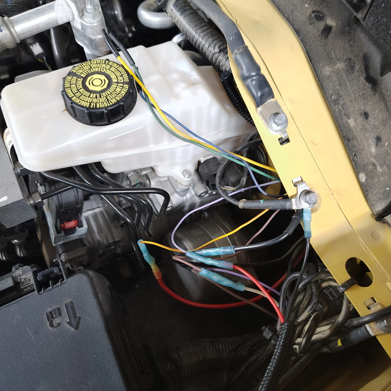

Here's the connections at the AUX switch wires under the hood. The 3 left (laying on the brake fluid reservoir) will be the rest of her lights and OBA switch.
Ford Bronco Butterscotch, 2dr HEL, Wife's Build IMG_20260110_162821166_HDR

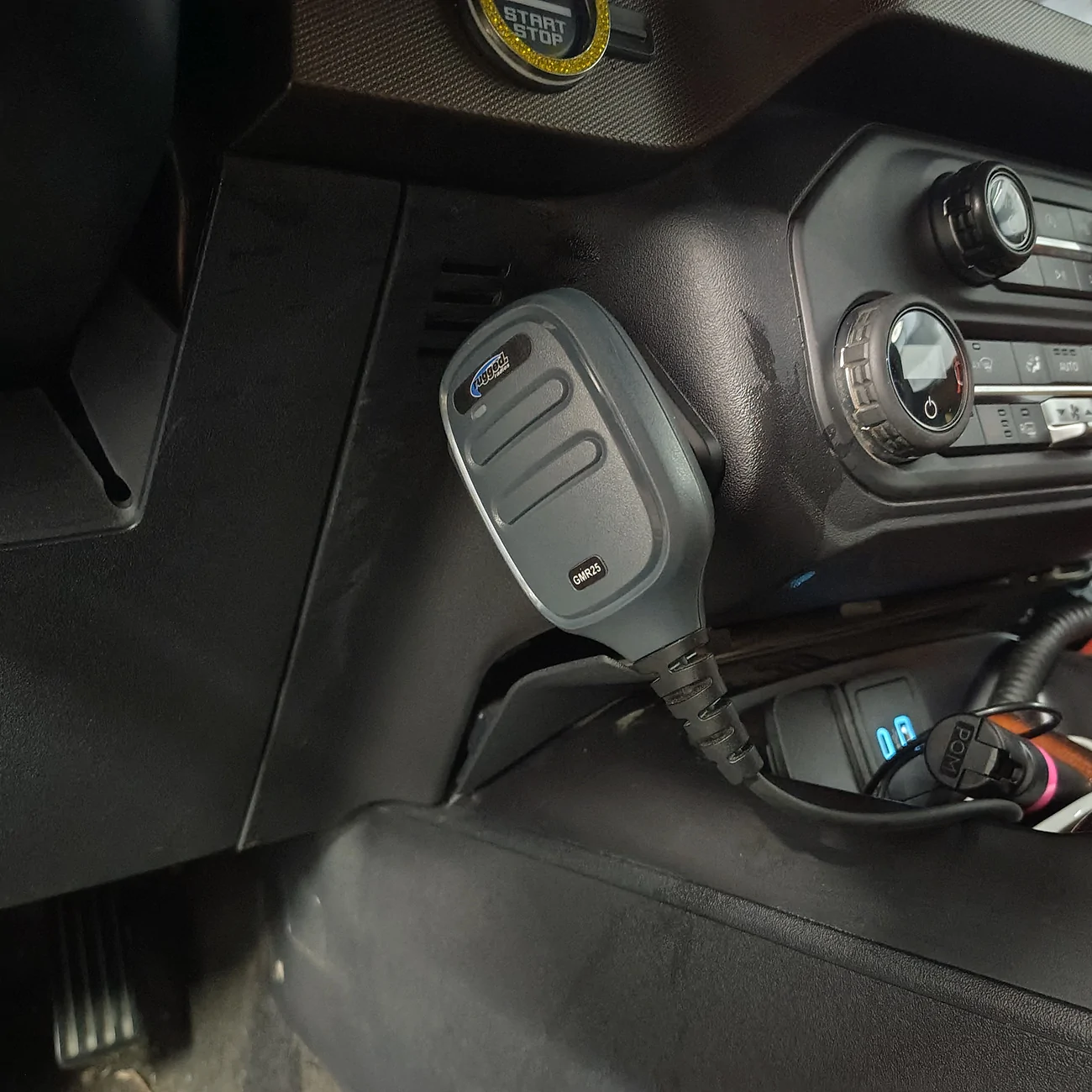

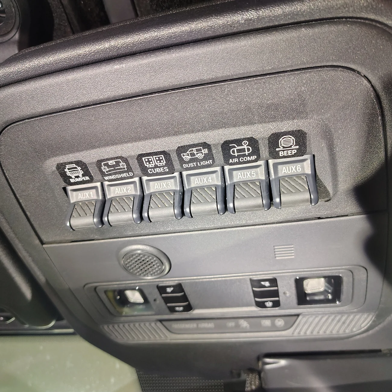

I also installed her GMRS radio to a switch, as she had trouble reaching it. Moved the mic magnet to the drivers side, for the same reason. She's 5'3" I have to figure out why that trim piece isn't attached properly?
Ford Bronco Butterscotch, 2dr HEL, Wife's Build IMG_20260110_162618964_HDR
I bought these very nice switch stickers almost 2 years ago and asked her to pick out what she wanted for each AUX switch :)
Ford Bronco Butterscotch, 2dr HEL, Wife's Build IMG_20260110_161750336_HDR

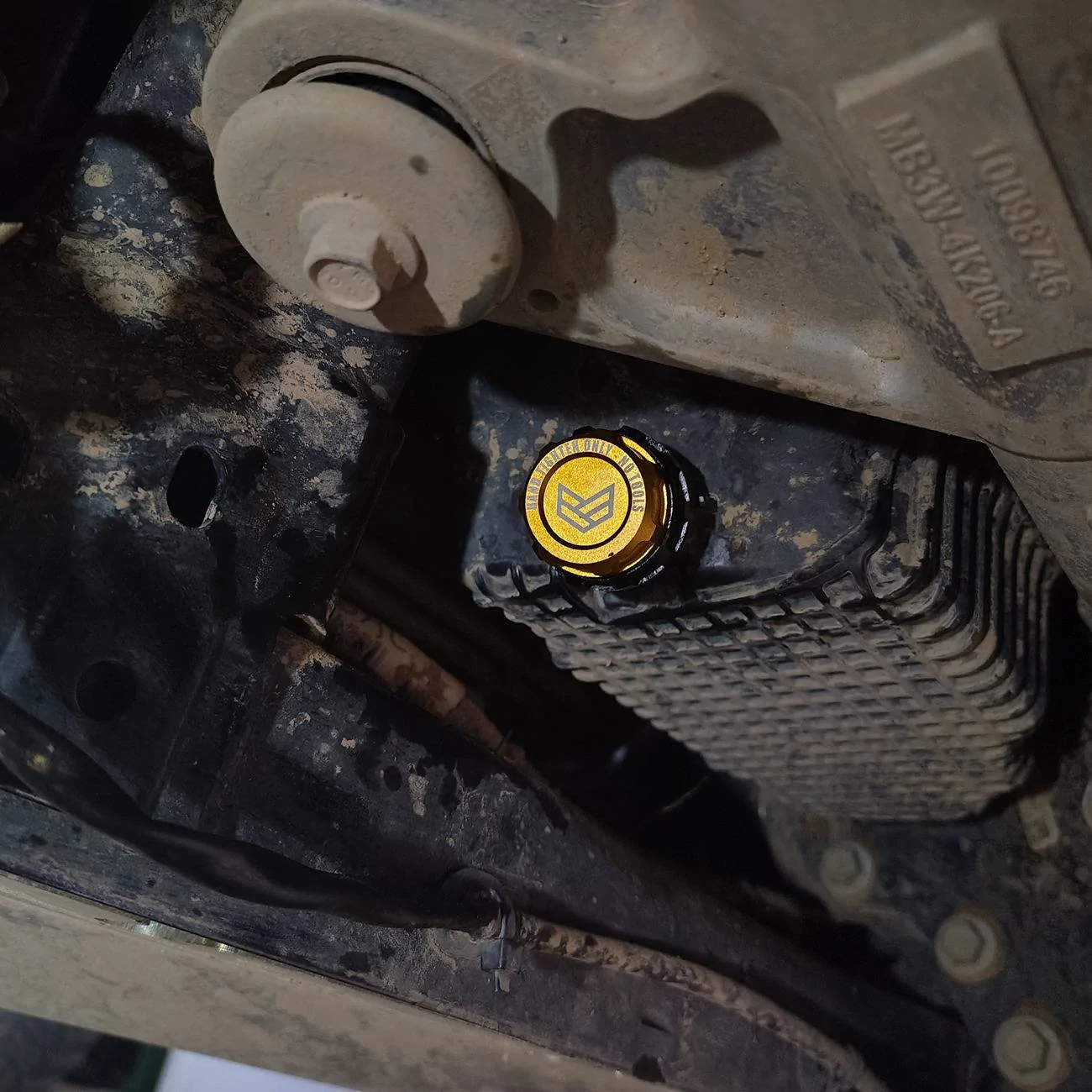

Changed the oil in the wives Bronco yesterday. The Ronin oil plug thingy, didn't work like it was supposed too, but I've contacted them about it?
Ford Bronco Butterscotch, 2dr HEL, Wife's Build Laura's 2nd Oil Change at 4108.2 miles

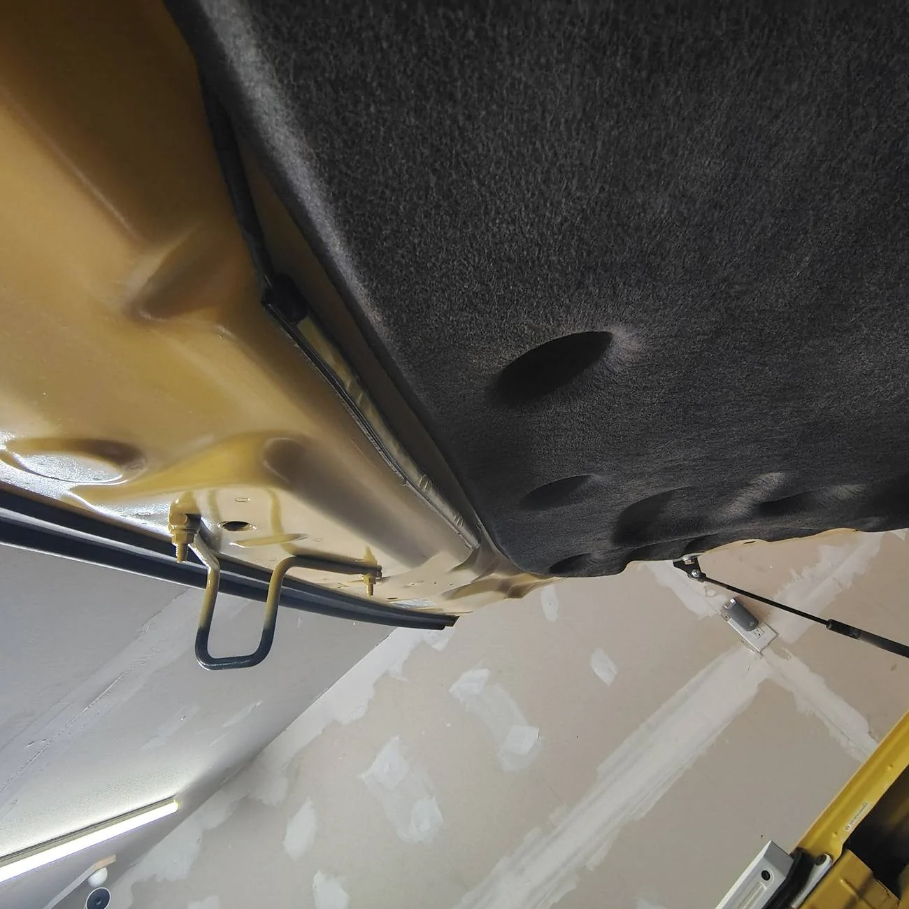

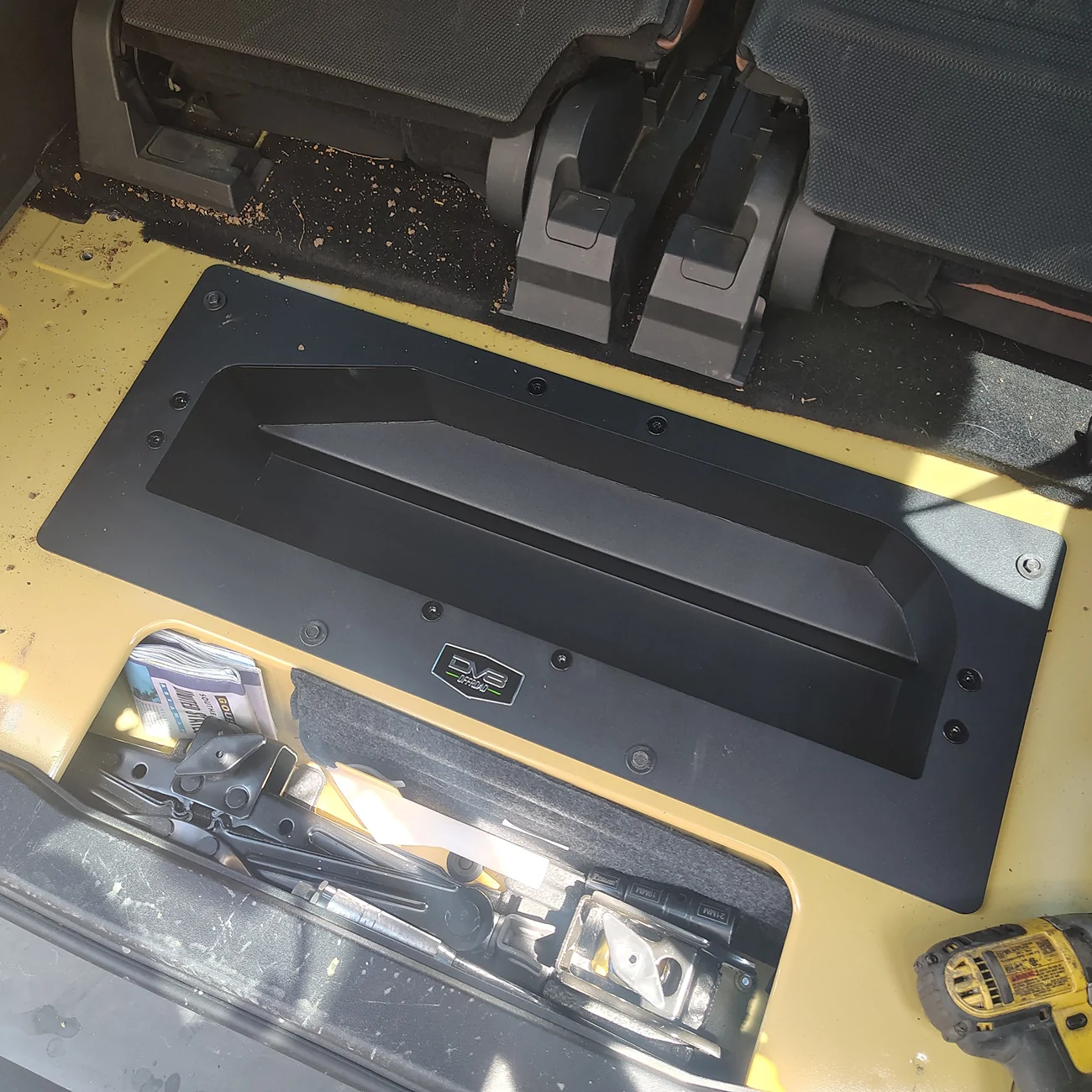

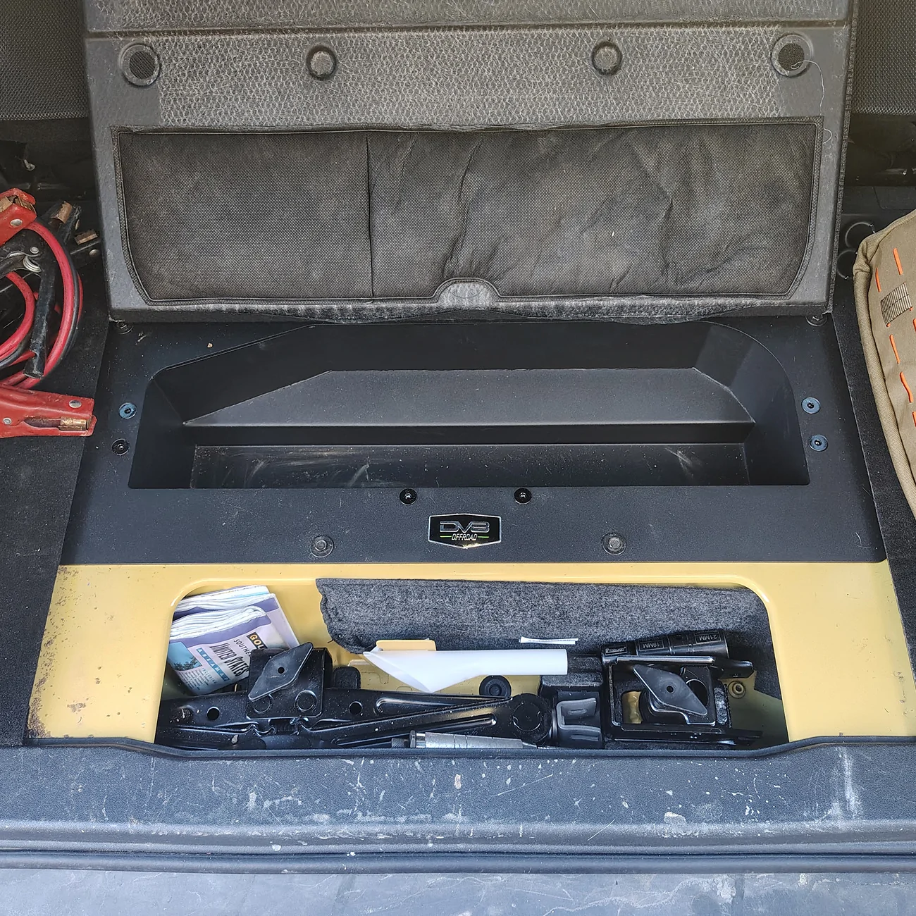

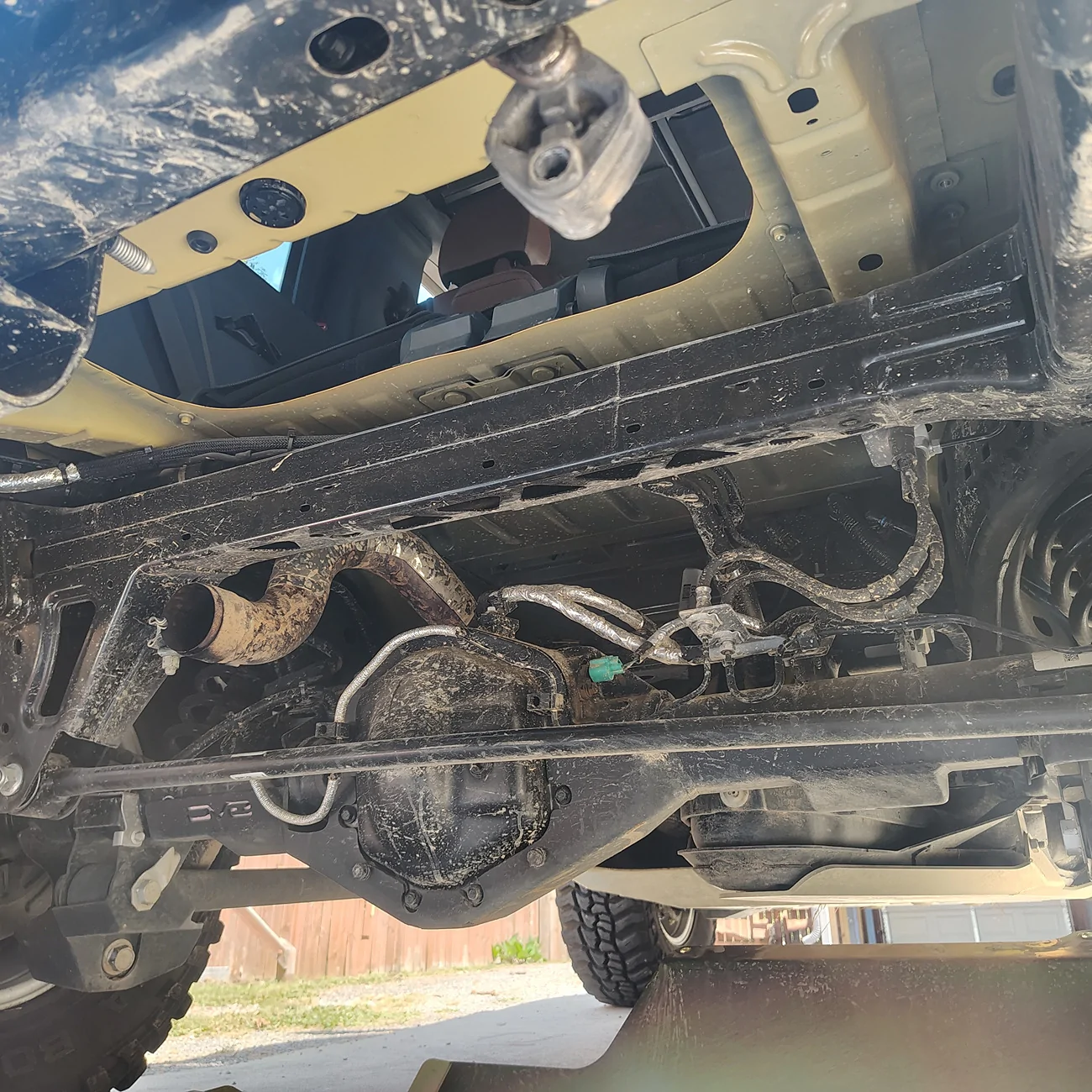

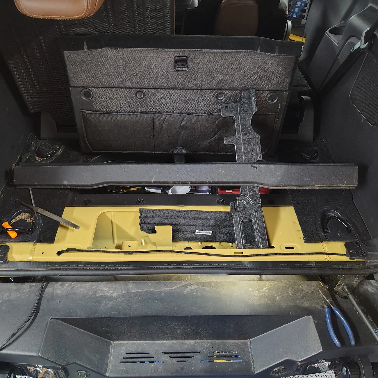

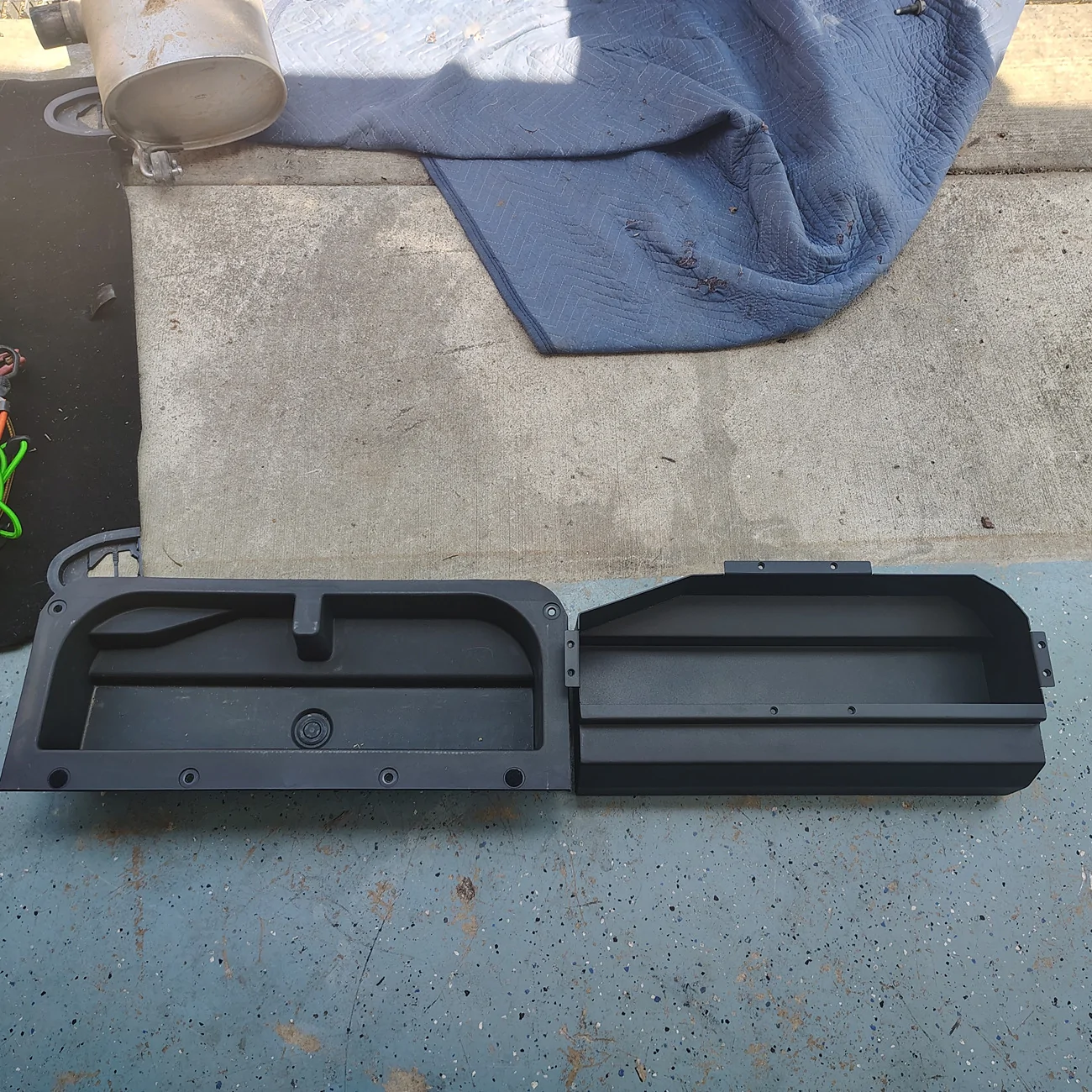

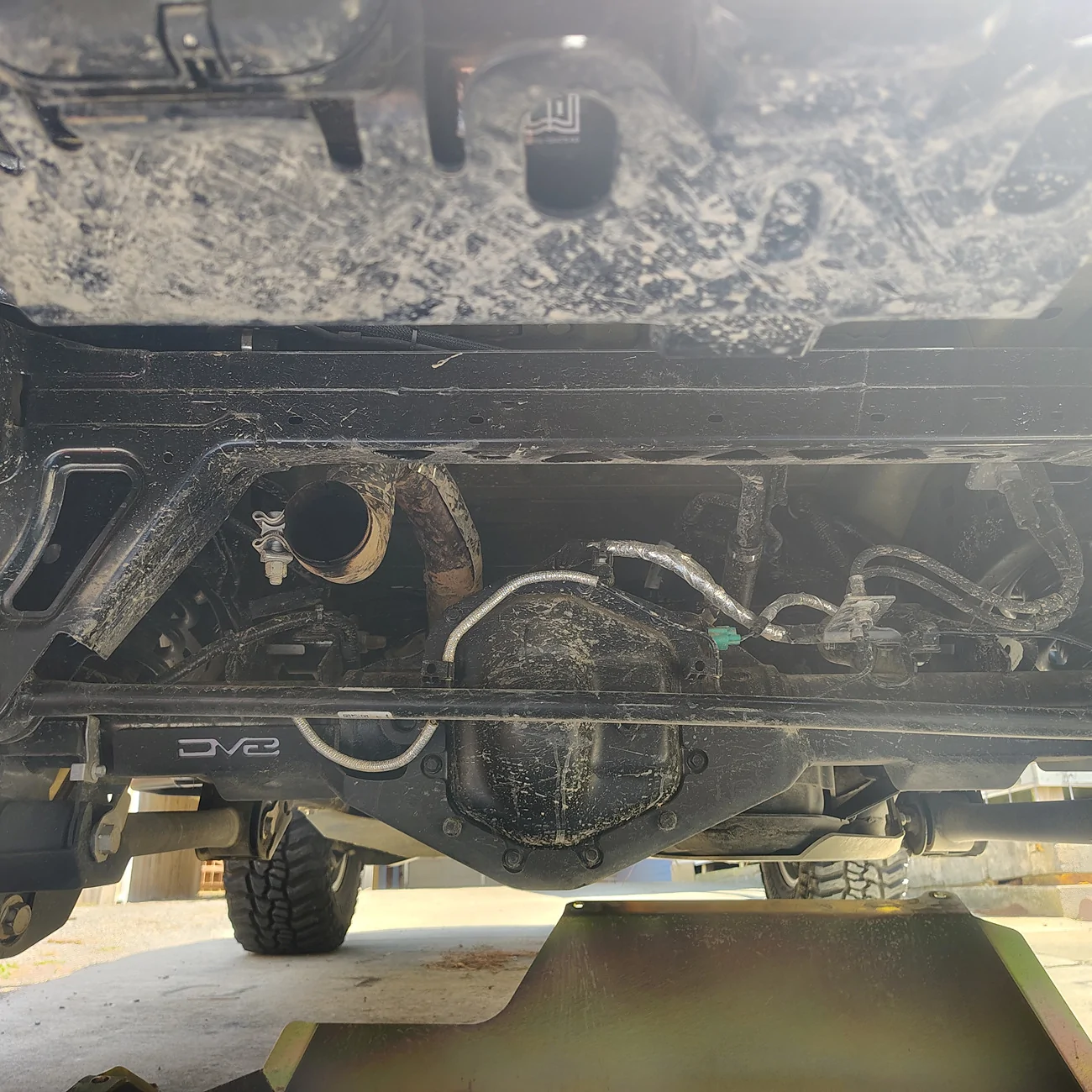

Removed the Muffler Skid Plate, Muffler and OEM Rear Storage Box.
Ford Bronco Butterscotch, 2dr HEL, Wife's Build IMG_20260411_132816087_HDR
Ford Bronco Butterscotch, 2dr HEL, Wife's Build IMG_20260411_132800937_HDR
So I could "finally" install the new DV8 Larger Rear Storage Box. Here's a comparison of the 2. They say theirs is 54% larger than OEM?
Ford Bronco Butterscotch, 2dr HEL, Wife's Build IMG_20260411_132752090_HDR
DV8 Box installed and the rest of the essentials underneath were reinstalled. Now, I've got to make her a tool bag! Screw that $400 Bronco Tool Kit!
Ford Bronco Butterscotch, 2dr HEL, Wife's Build IMG_20260411_133620526_HDR

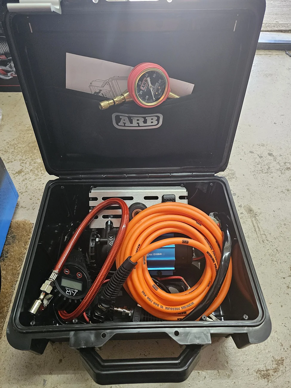

Lastly, I wanted to move her Portable ARB Single Air Compressor from in that massive box to under the hood.
Ford Bronco Butterscotch, 2dr HEL, Wife's Build 20240711_170557
I used my old ARB Twin Air Compressor under hood mount that I had in my Bronco, modified it slightly for her Single Compressor, ran the switch red wire to her Upfitter #5 switch, lopped off the battery clamps and installed some ring connectors and connected the +/- to the battery and everything works great and frees up more space in the rear of her Bronco!
Ford Bronco Butterscotch, 2dr HEL, Wife's Build IMG_20260411_160921932_HDR

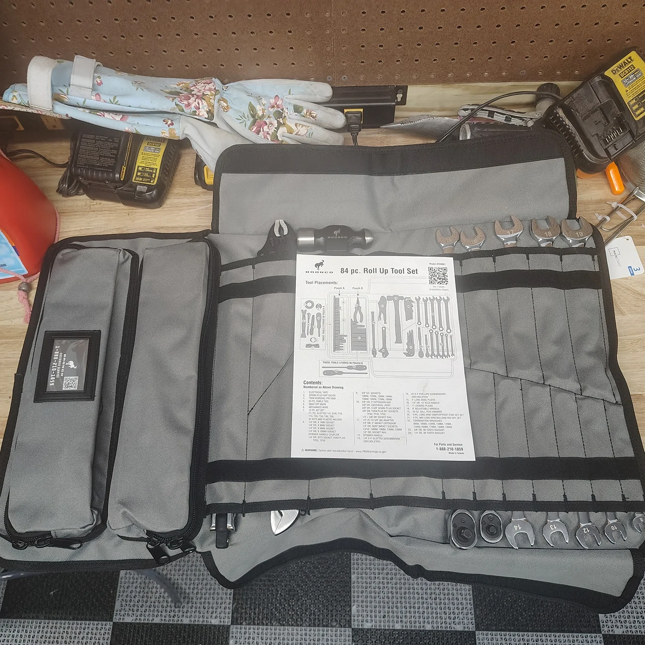

I have plenty of tools in my Bronco, but I was looking for some decent ones for my wife, in case she needs it them one day? I was pricing some Hart and China Freight stuff and buy the time I got everything I thought I'd need for her Bronco, it was going to cost more than the Bronco tool roll, so I ordered it last week for $305 shipped to the dealer and picked it up yesterday.
Ford Bronco Butterscotch, 2dr HEL, Wife's Build IMG_20260423_152634480_HDR
Haven't even removed the tools yet, LOL! I will this weekend. I still need to see if I can get a bag for her OBA stuff?

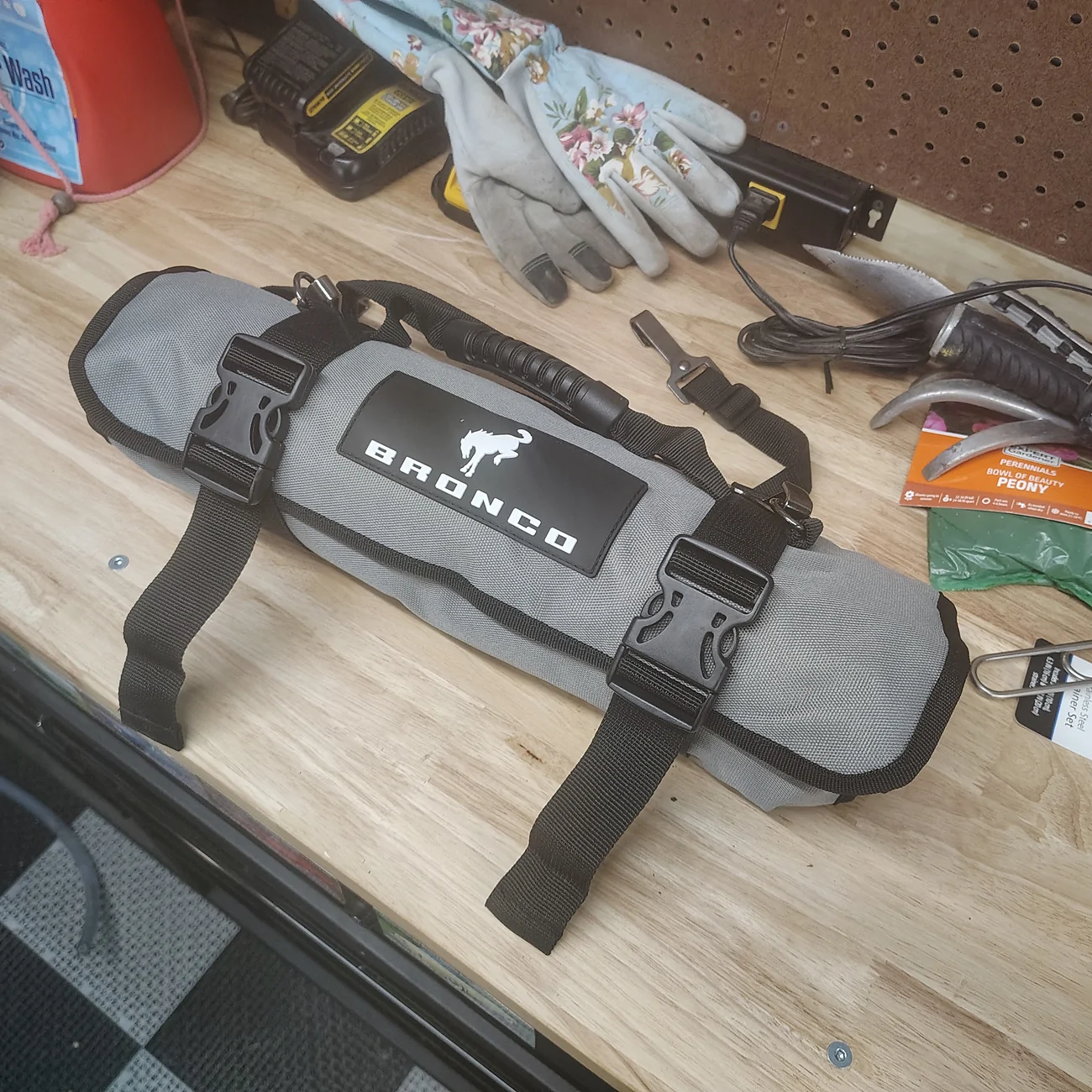

Got the wives tool roll taken care of this morning! It actually fits inside the DV8 rear storage box, as well as some other things!
Ford Bronco Butterscotch, 2dr HEL, Wife's Build IMG_20260426_081132454_HDR
Ford Bronco Butterscotch, 2dr HEL, Wife's Build IMG_20260426_081217804_HDR
Ford Bronco Butterscotch, 2dr HEL, Wife's Build IMG_20260426_081313051_HDR
But, she doesn't have room for her OBA stuff, FA kit, Tire Plug stuff or a future tow strap... So, I have decided to make a rear cargo box/platform, like mine, but a little smaller, as she wants to keep her back seats :) I should be able to start on it this weekend? I'll post pics when it's finished!
