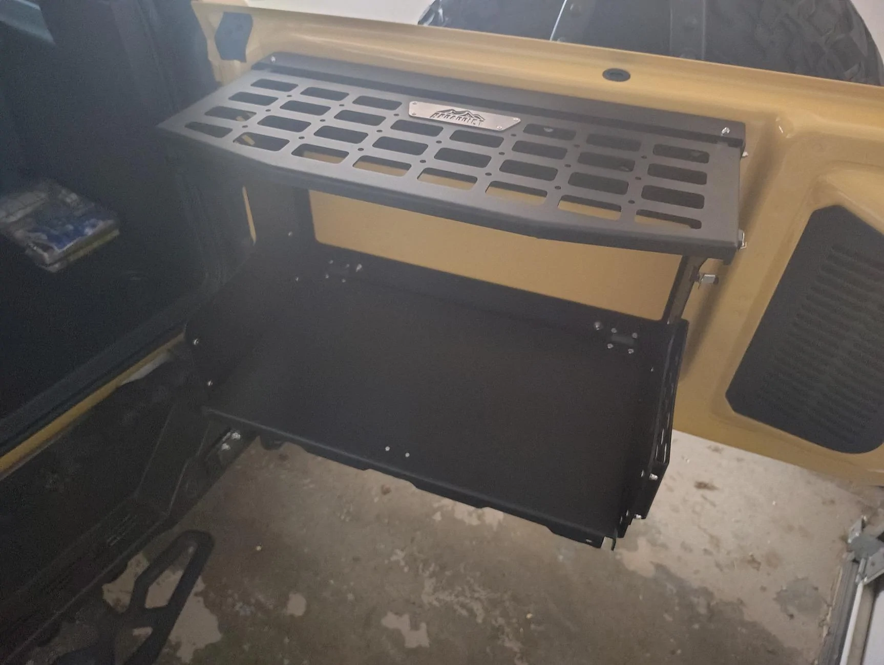

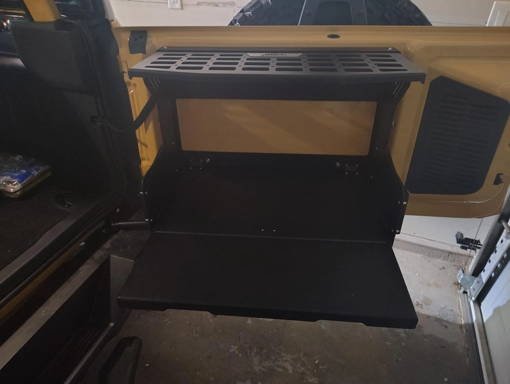

Wife wanted a Tailgate Table and I wanted her to have a really nice one, so I ordered and installed this one in hers:
Ford Bronco Butterscotch, 2dr HEL, Wife's Build IMG_20240730_181419157_HDR
Ford Bronco Butterscotch, 2dr HEL, Wife's Build IMG_20240730_181647766_HDR
Ford Bronco Butterscotch, 2dr HEL, Wife's Build IMG_20240730_181411558_HDR
Ford Bronco Butterscotch, 2dr HEL, Wife's Build IMG_20240730_181509705_HDR

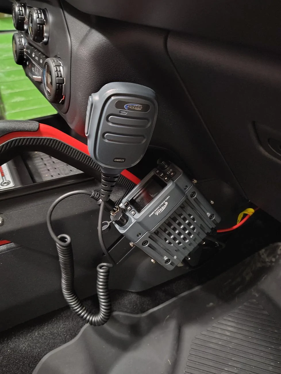

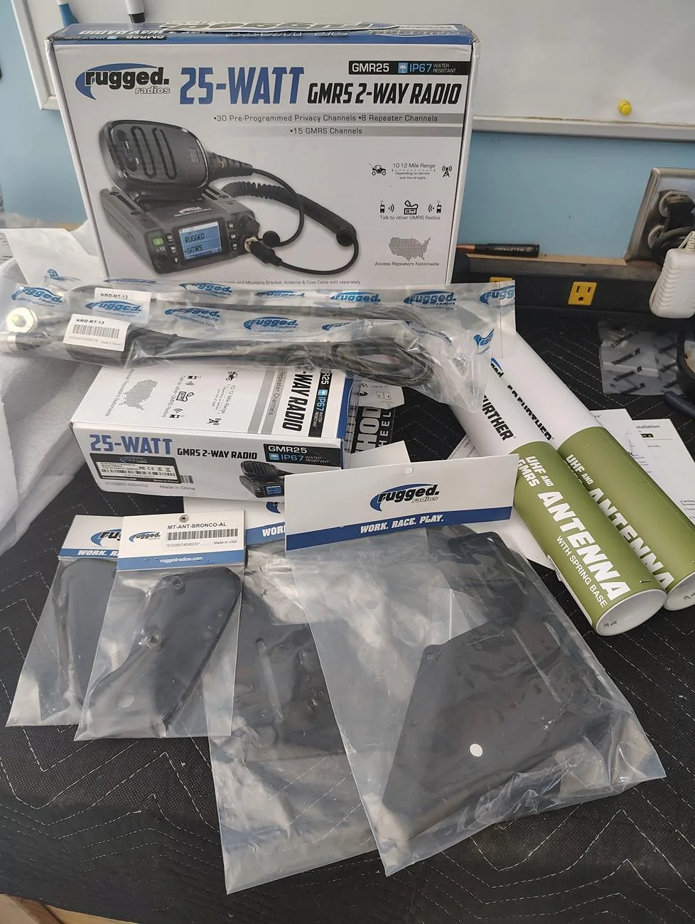

We needed to communicate with each other, when offroading, so I bought 2 of these kits! I wanted the 45-watt, but they only had one in stock, so I settled for these, which worked amazingly last weekend!
Ford Bronco Butterscotch, 2dr HEL, Wife's Build IMG_20240801_162447290_HDR
Ford Bronco Butterscotch, 2dr HEL, Wife's Build IMG_20240810_220842022_HDR
Ford Bronco Butterscotch, 2dr HEL, Wife's Build IMG_20240810_220942769_HDR

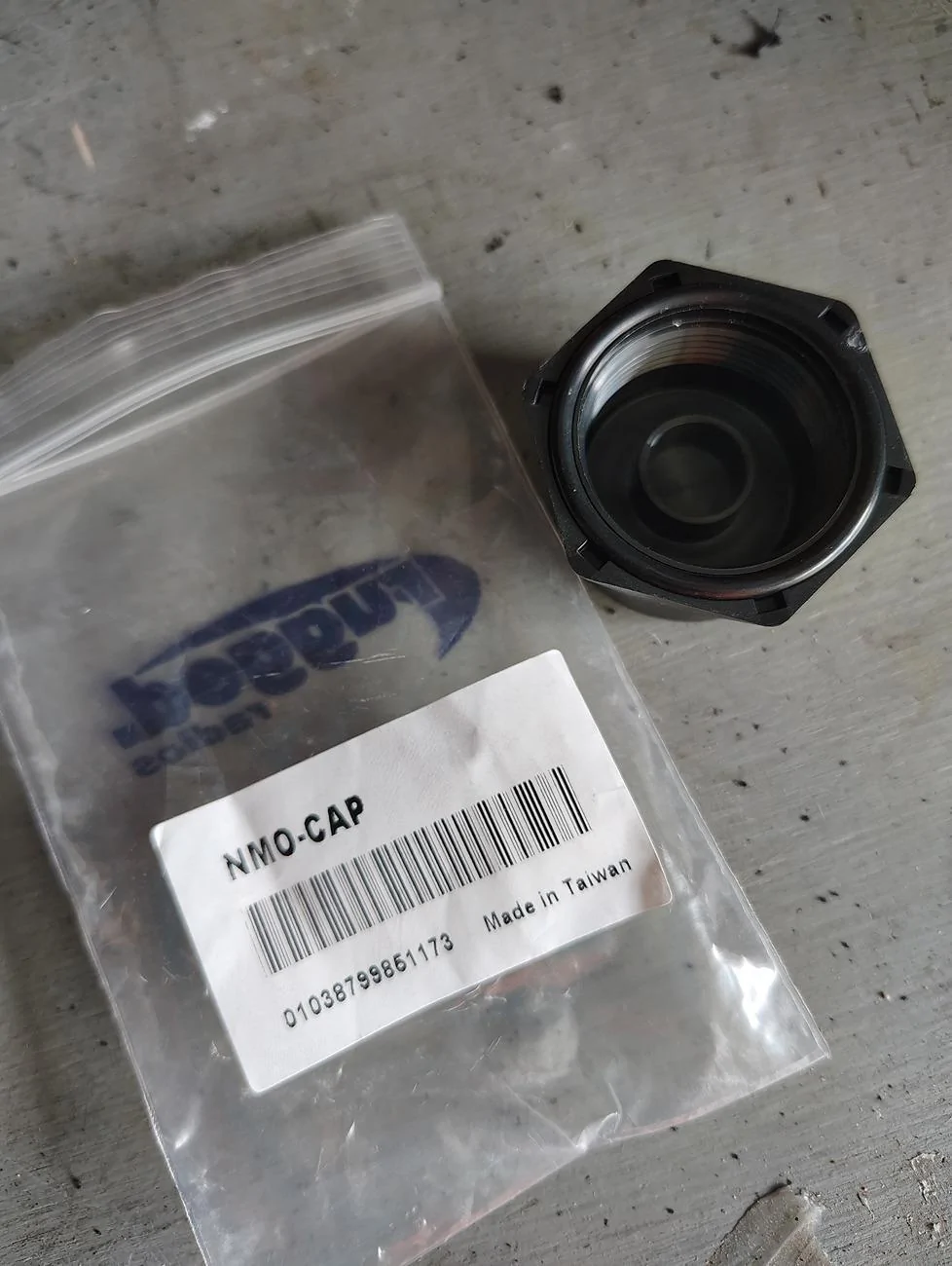

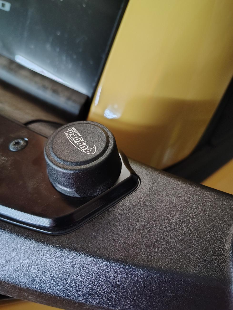

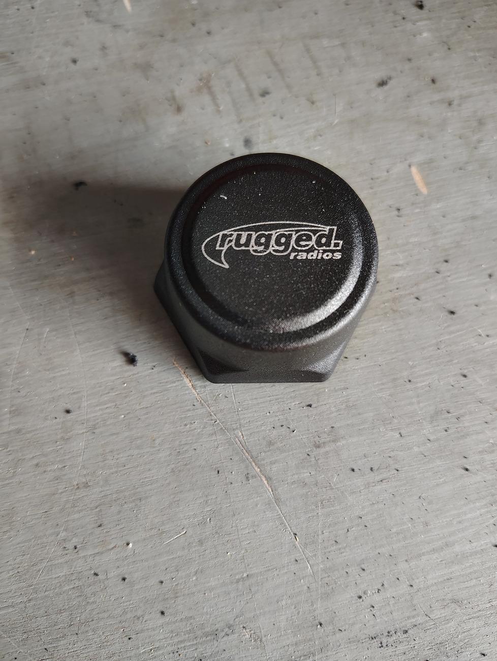

I ordered a pair of Rugged's Antenna Dust Cap Covers, but they didn't fit, so I modified them to fit, LOL!
Ford Bronco Butterscotch, 2dr HEL, Wife's Build IMG_20240818_090020216_HDR
Ford Bronco Butterscotch, 2dr HEL, Wife's Build IMG_20240818_090030229_HDR
Ford Bronco Butterscotch, 2dr HEL, Wife's Build IMG_20240818_090556562_HDR

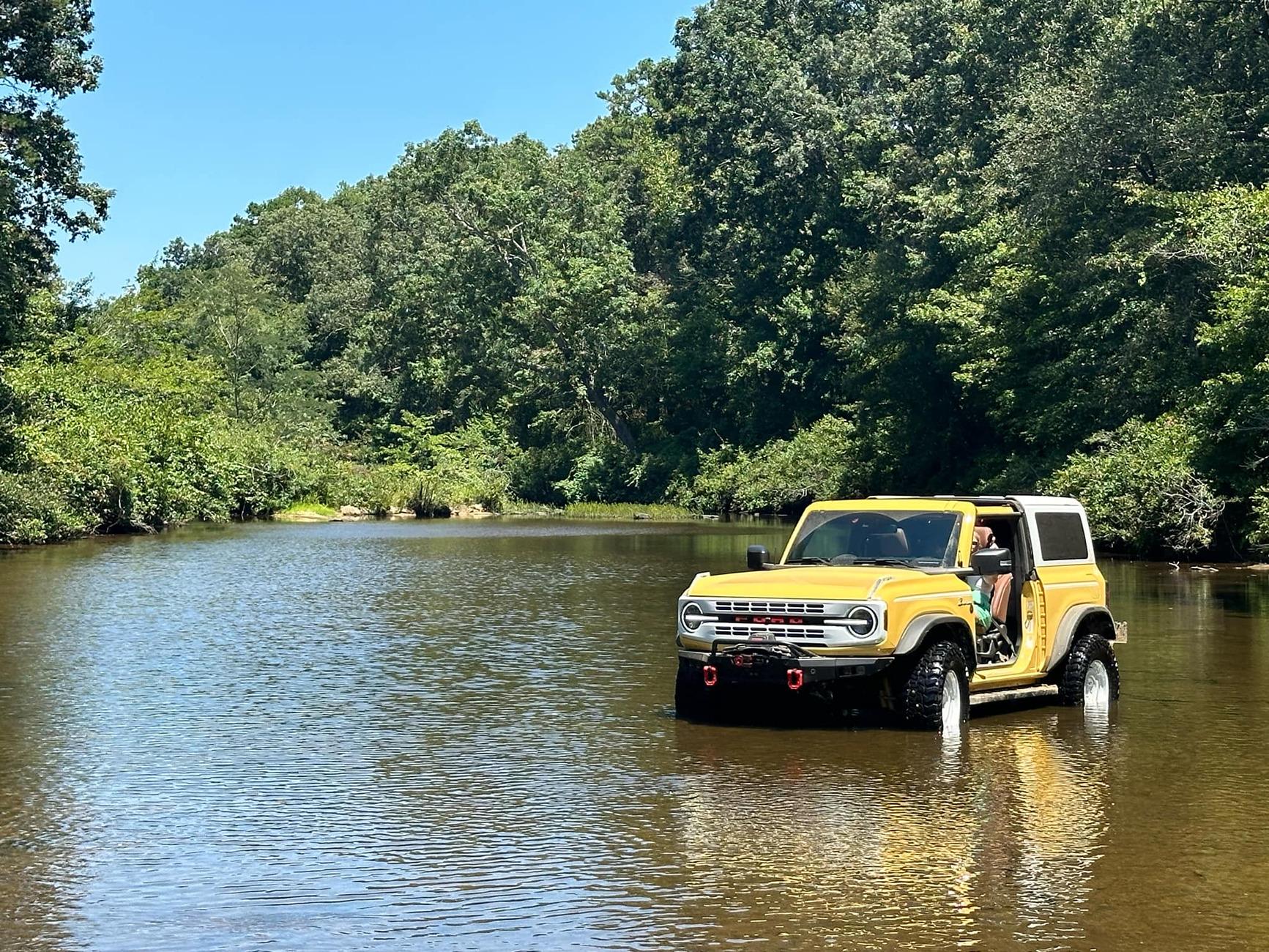

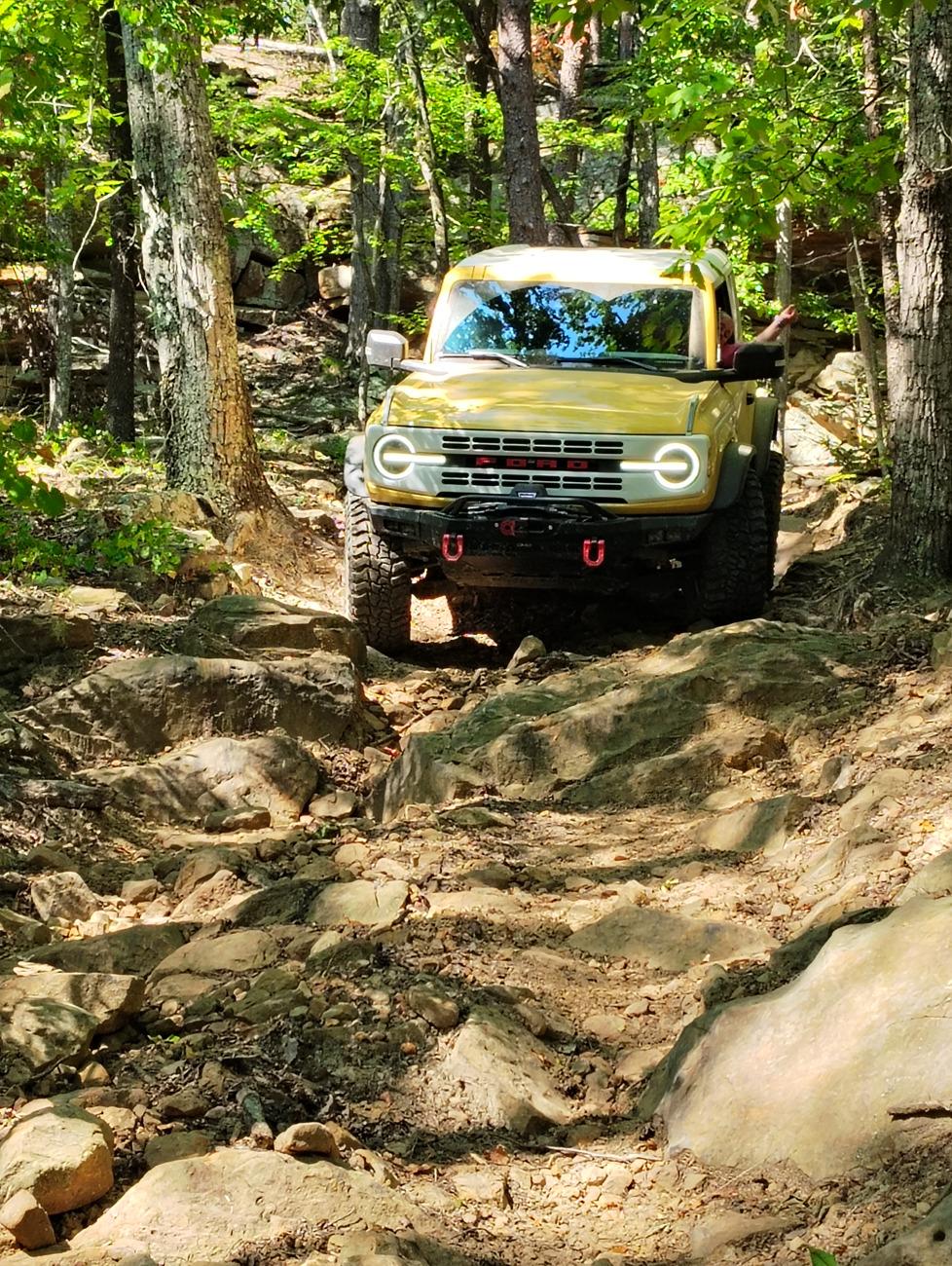

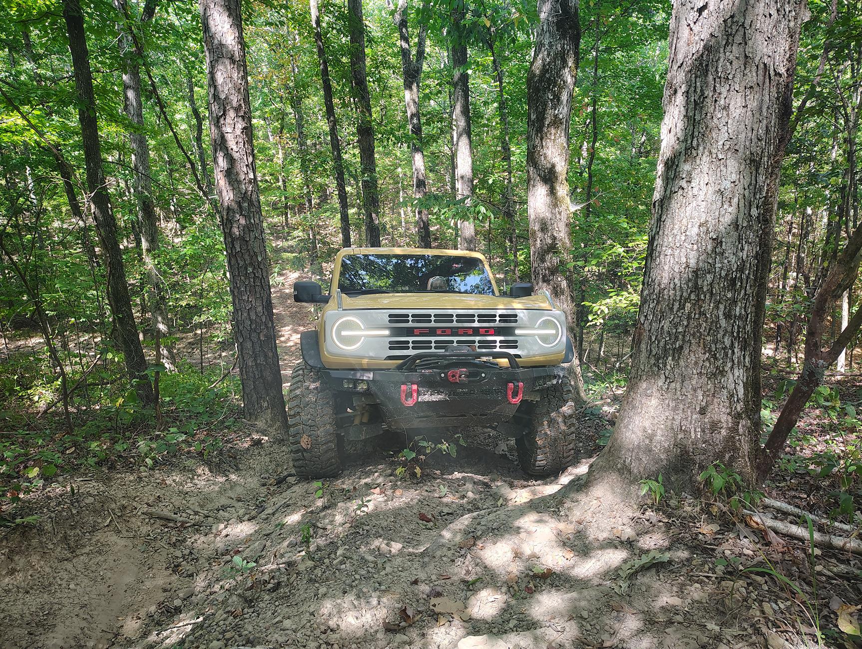

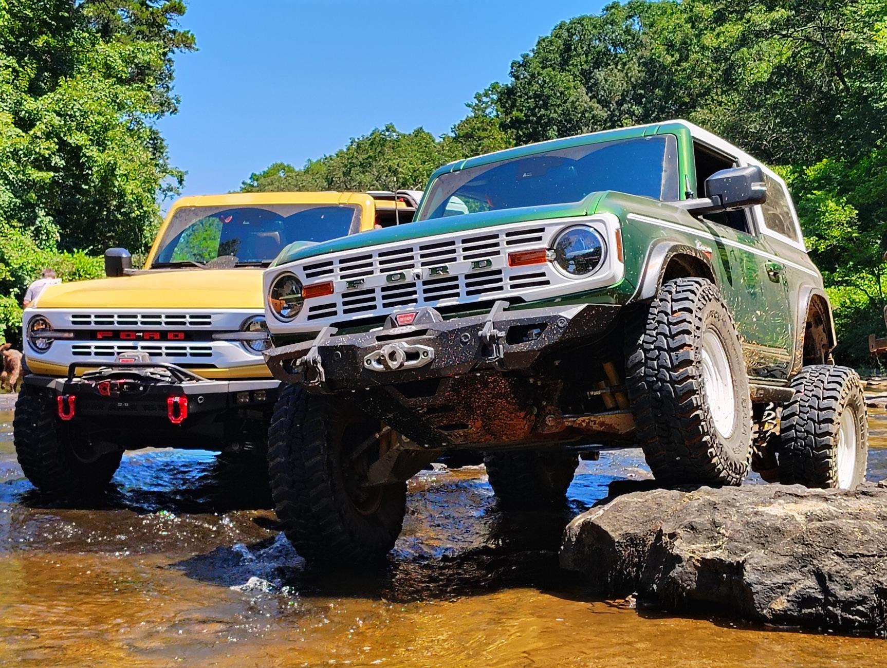

We finally were able to go offroading last Sunday!
Ford Bronco Butterscotch, 2dr HEL, Wife's Build sagb1lo
Ford Bronco Butterscotch, 2dr HEL, Wife's Build qhCUWVOM
Ford Bronco Butterscotch, 2dr HEL, Wife's Build IMG_20240811_115812807_HDR
Ford Bronco Butterscotch, 2dr HEL, Wife's Build IMG_20240811_142246181_HDR
Ford Bronco Butterscotch, 2dr HEL, Wife's Build IMG_20240811_142015116_HDR

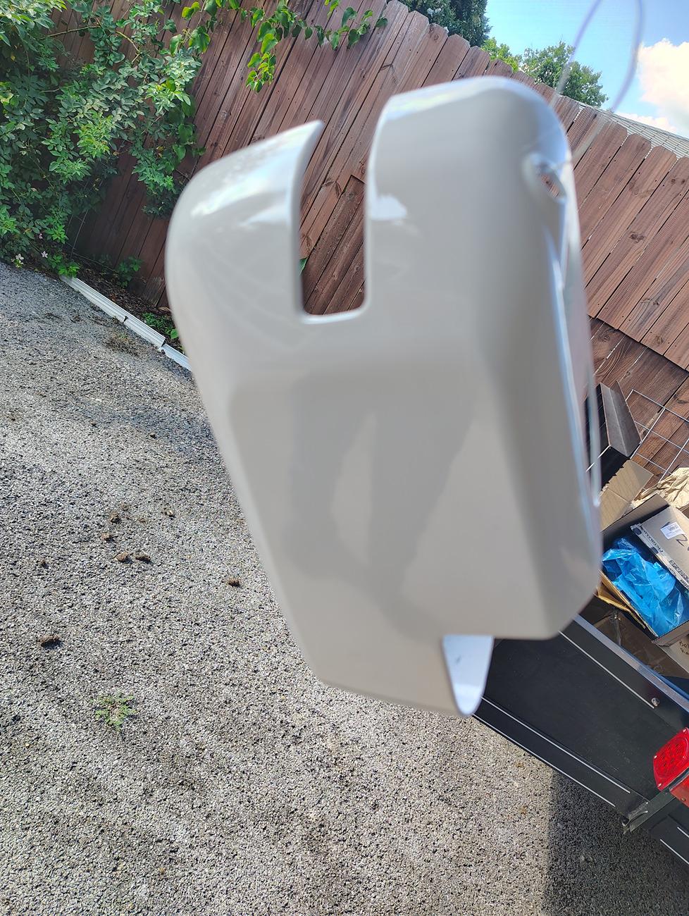

I also finally painted the Mirror Covers I ordered months ago, April/May, (I think?), Gloss White to go on her Bronco. Going to let them dry and see if they need anymore coats, then I'll install them on her Bronco, along with the White Door Handle Covers I found for her!
Ford Bronco Butterscotch, 2dr HEL, Wife's Build IMG_20240821_164908127_HDR

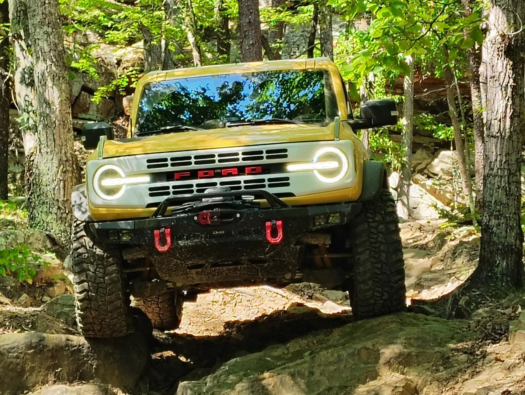

We went off-roading a week before and my wife decided she wanted the Undercloak on her Butterscotch! She did quite well on her 2nd off-roading trip, with just her and I this time!

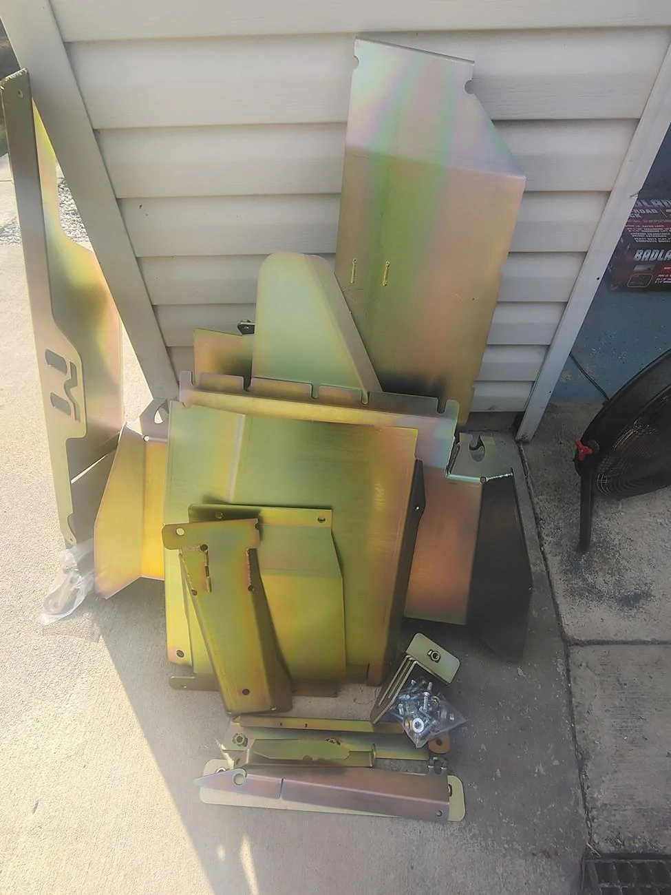

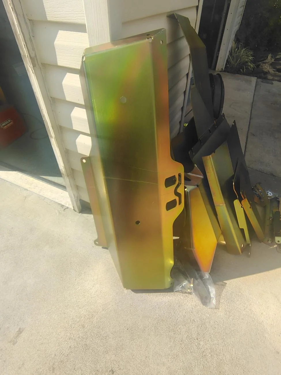

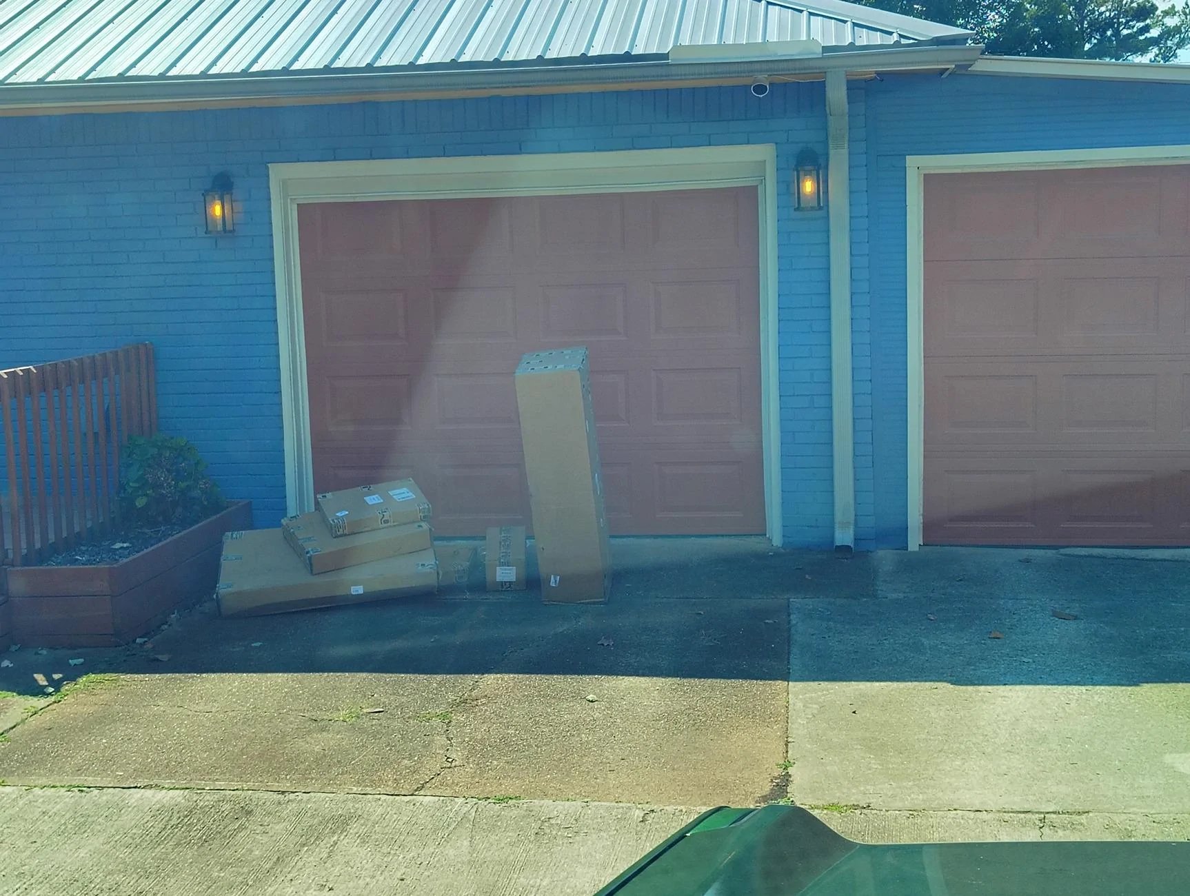

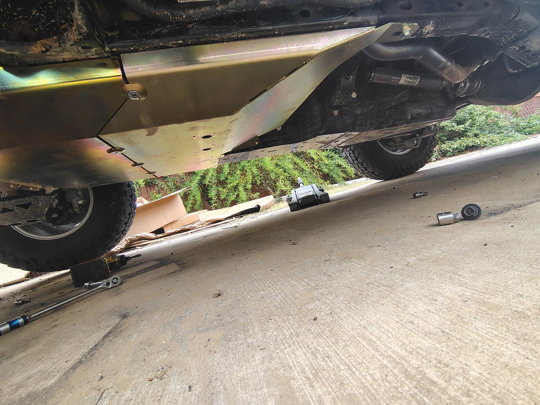

So I ordered those from Metalcloak and they showed up last week, before the 3 day weekend! Jackass new FedEx guy, just threw them down in front of my wife's garage door.... Our old driver used to stack them up beside our fence...., I miss that guy.
Ford Bronco Butterscotch, 2dr HEL, Wife's Build IMG_20240830_145718824_HDR

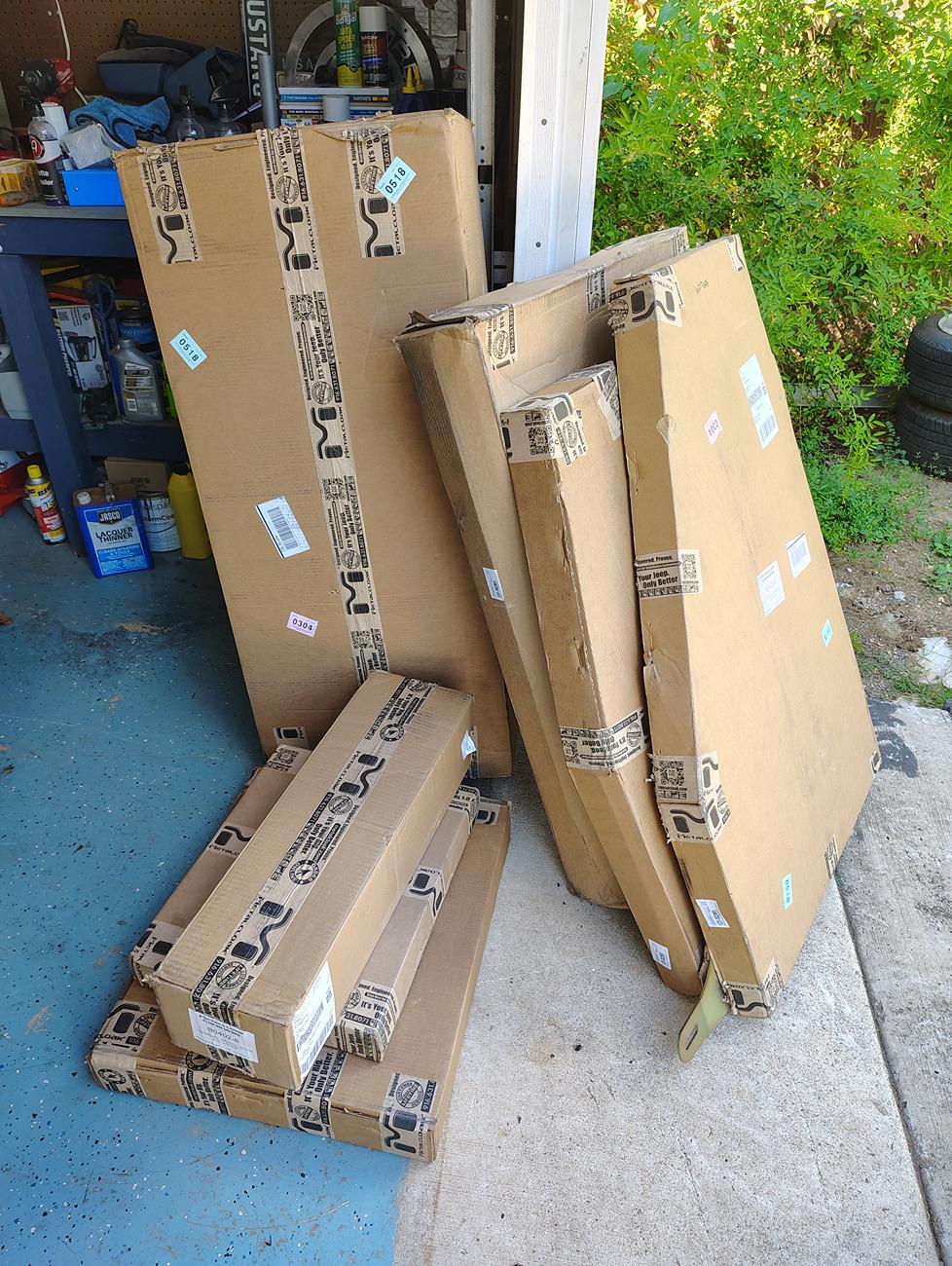

Luckily, I beat her home and moved them to the rear garage!
Ford Bronco Butterscotch, 2dr HEL, Wife's Build IMG_20240830_150449174_HDR
I unboxed everything and when she got home from work, I started throwing them on immediately and not too far into it, they also forgot the same damn fuel tank mount bracket, that they forgot on mine!
Ford Bronco Butterscotch, 2dr HEL, Wife's Build IMG_20240830_155101832_HDR
Ford Bronco Butterscotch, 2dr HEL, Wife's Build IMG_20240830_155116008_HDR
Ford Bronco Butterscotch, 2dr HEL, Wife's Build IMG_20240830_180157725_HDR
Ford Bronco Butterscotch, 2dr HEL, Wife's Build IMG_20240830_180203170_HDR

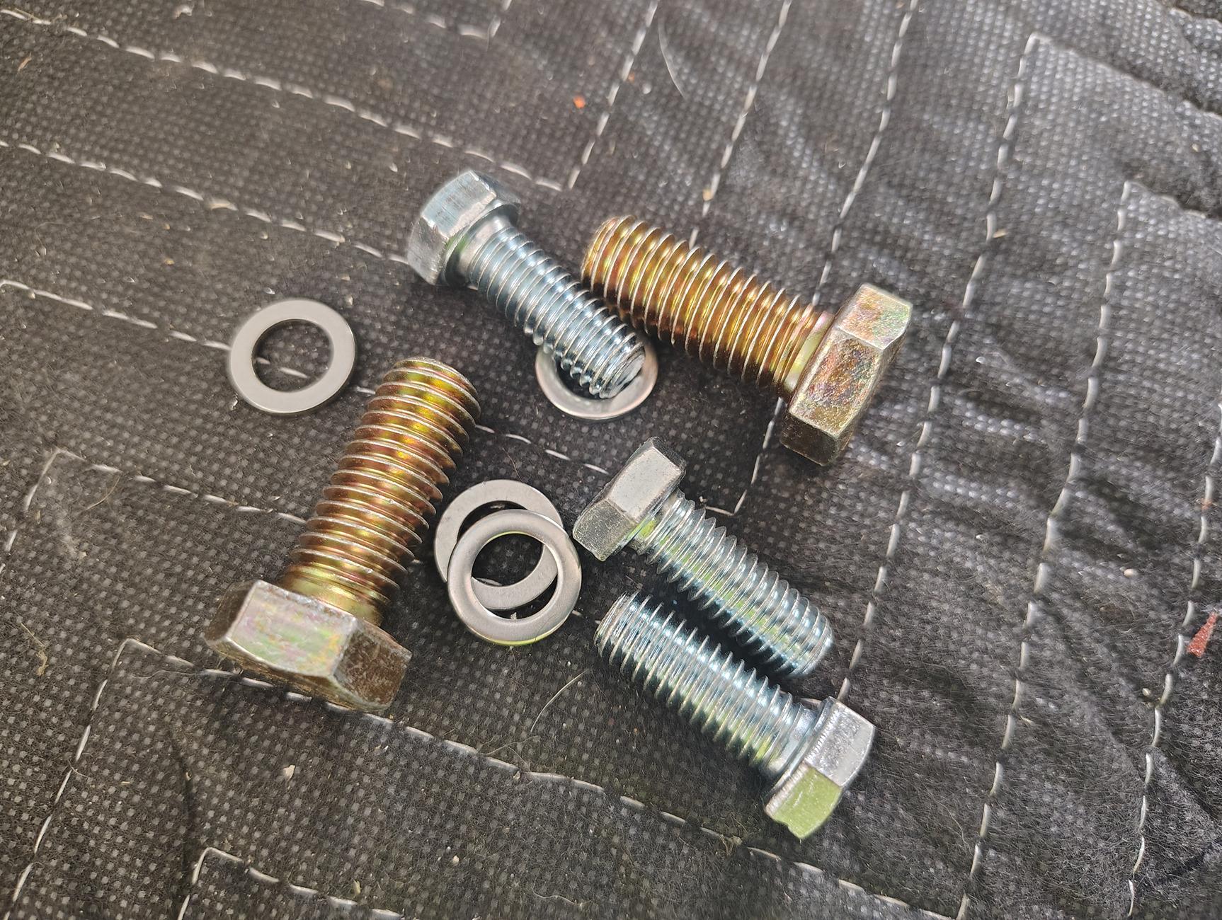

I had a lot tougher time installing hers, than mine took.... One skid plate slid off the floor jack and almost broke my nose... Blood went everywhere, but luckily, it wasn't broken! It just hurt so bad the rest of the weekend :(

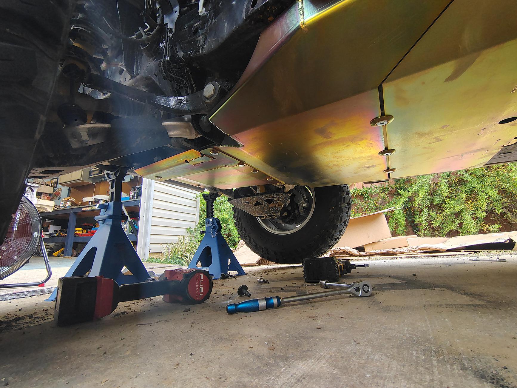

We were planning on riding today, but I felt awful at work yesterday and slept for almost 13 hours last night. When I woke up this morning, it was almost 9am and I felt so much better. I played Star Wars Outlaws for a little bit, then I decided to start working on my wife's Bronco!

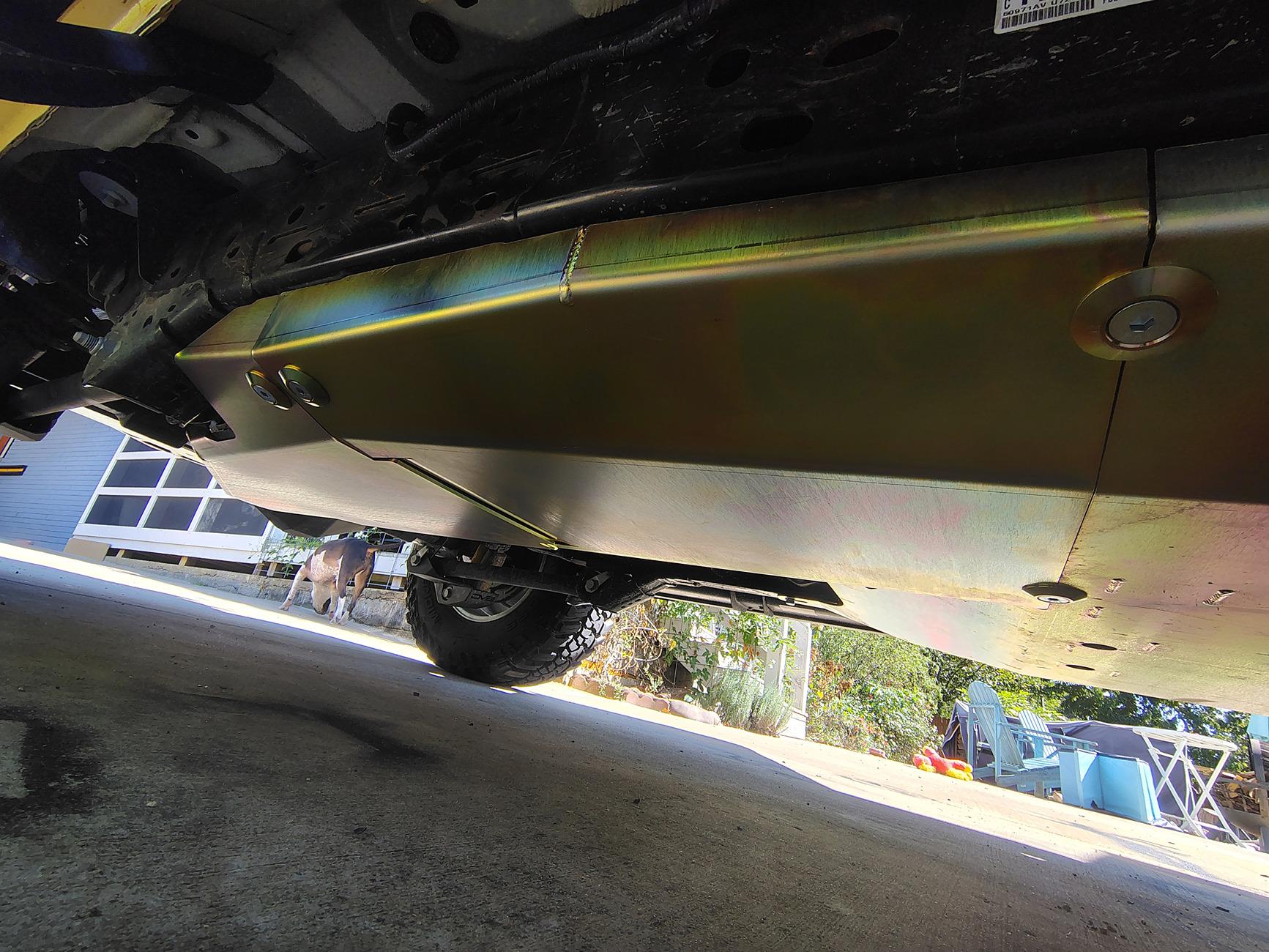

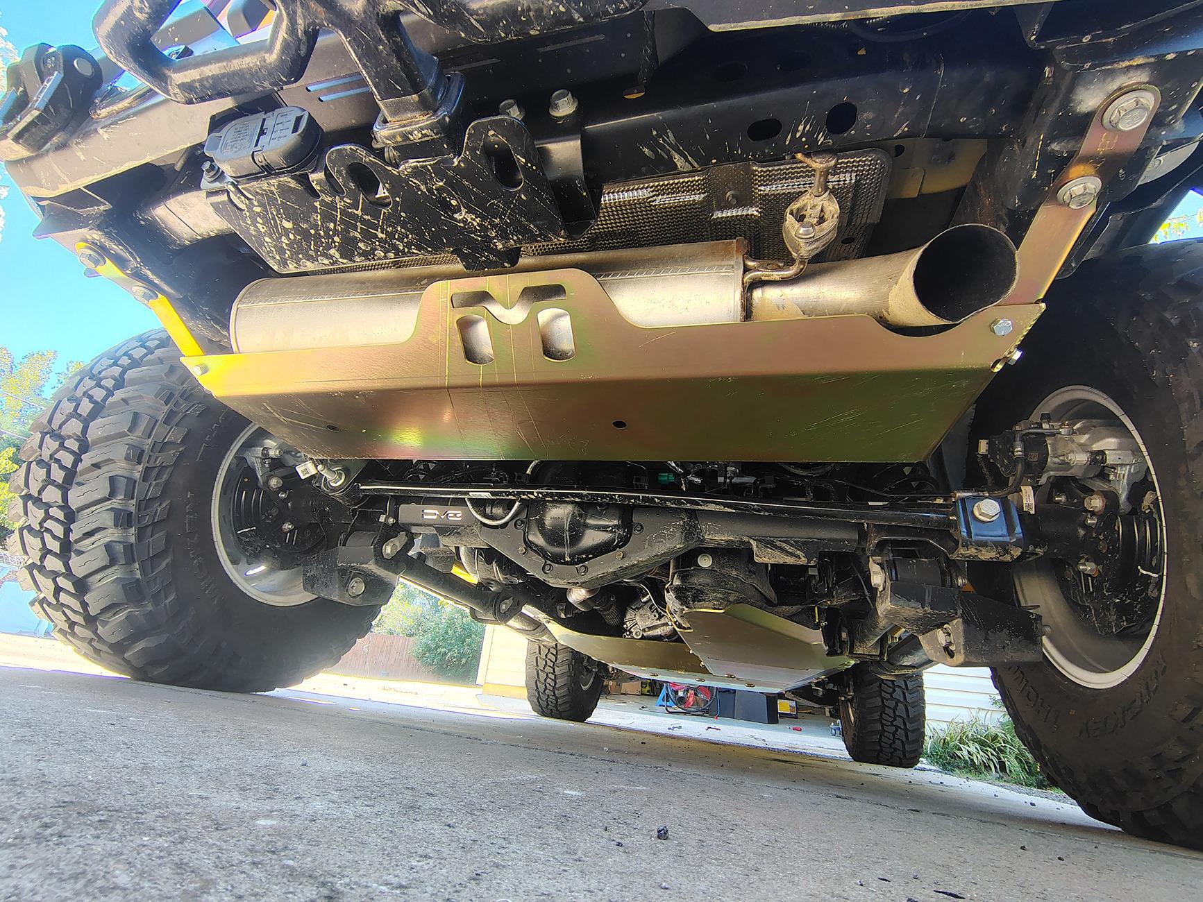

Last Friday, Metalcloak overnighted me the missing bracket, but I didn't have time to install the rest of the skid plates, until today... I also had to go buy all of the locking nuts and one bolt, for the muffler skid plate, since they didn't bother to include those either.... I don't know what's going on with their packaging dept lately, they're really off their A-game! This was what I got in the package...
Ford Bronco Butterscotch, 2dr HEL, Wife's Build IMG_20240831_115424435_HDR
Anyway, I got the fuel and muffler skid plates installed.
Ford Bronco Butterscotch, 2dr HEL, Wife's Build IMG_20240907_153325786_HDR
Ford Bronco Butterscotch, 2dr HEL, Wife's Build IMG_20240907_153336525_HDR

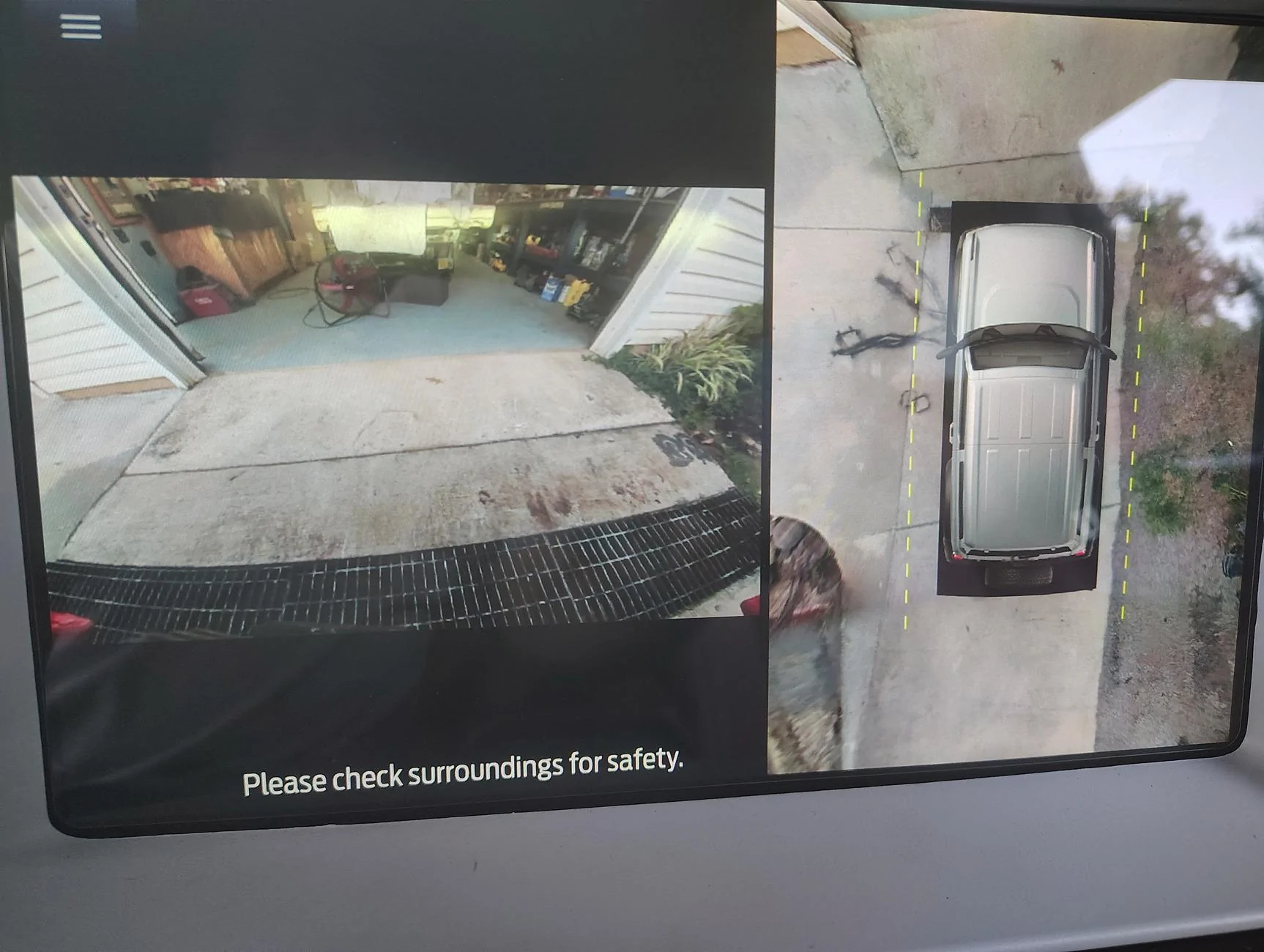

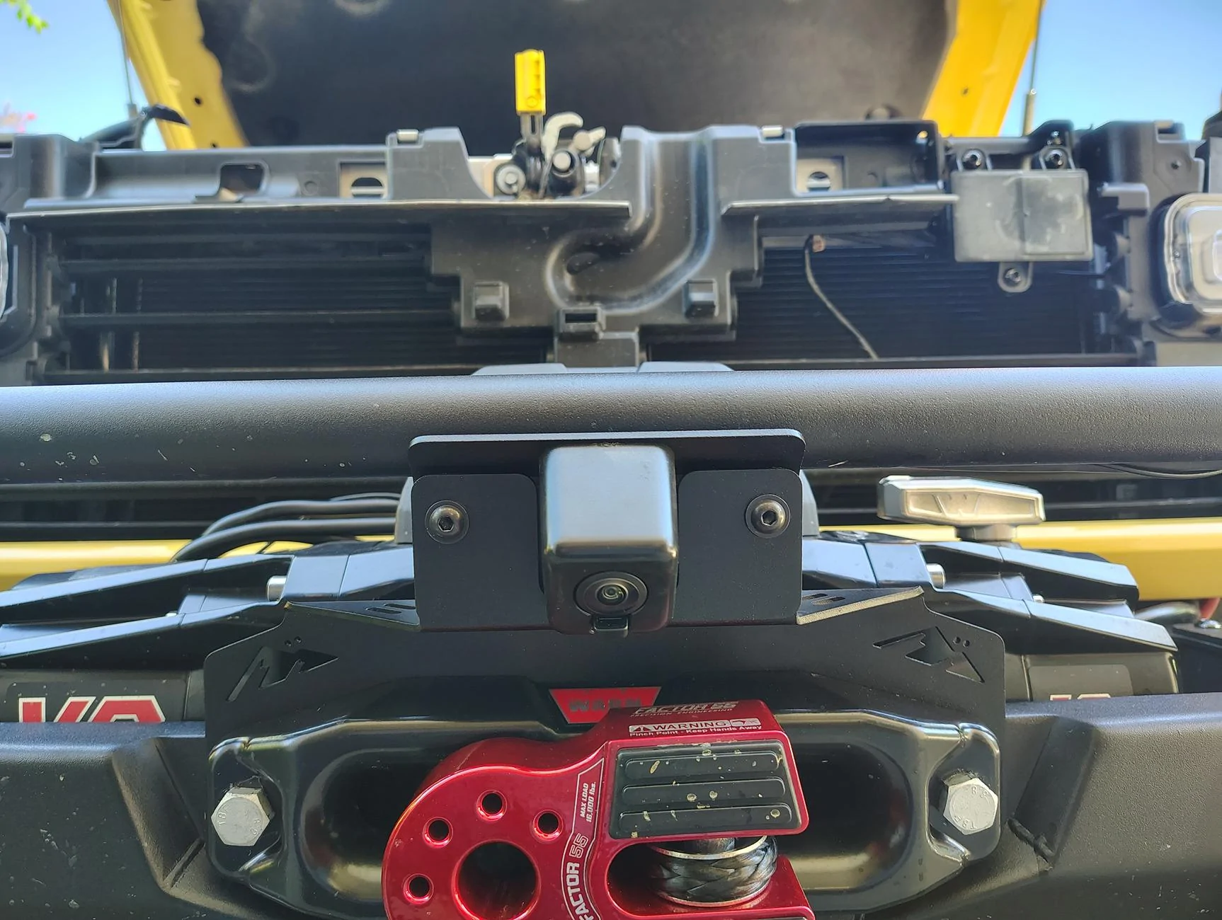

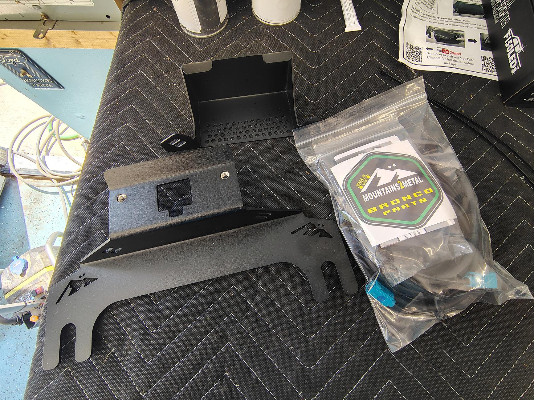

She also said from our last off-roading trip, that the front camera really didn't help her much, because all she saw was the top of the winch...., so I ordered her a Mountains 2 Metal Front Camera Relocater Kit and installed it today.
Ford Bronco Butterscotch, 2dr HEL, Wife's Build IMG_20240827_115628731_HDR
Ford Bronco Butterscotch, 2dr HEL, Wife's Build IMG_20240907_153303245_HDR
That solved her issue! I have one to install on mine as well, but it will be a week or so before I get around to installing it... I wish we could change the color of the 360* camera Bronco color...?

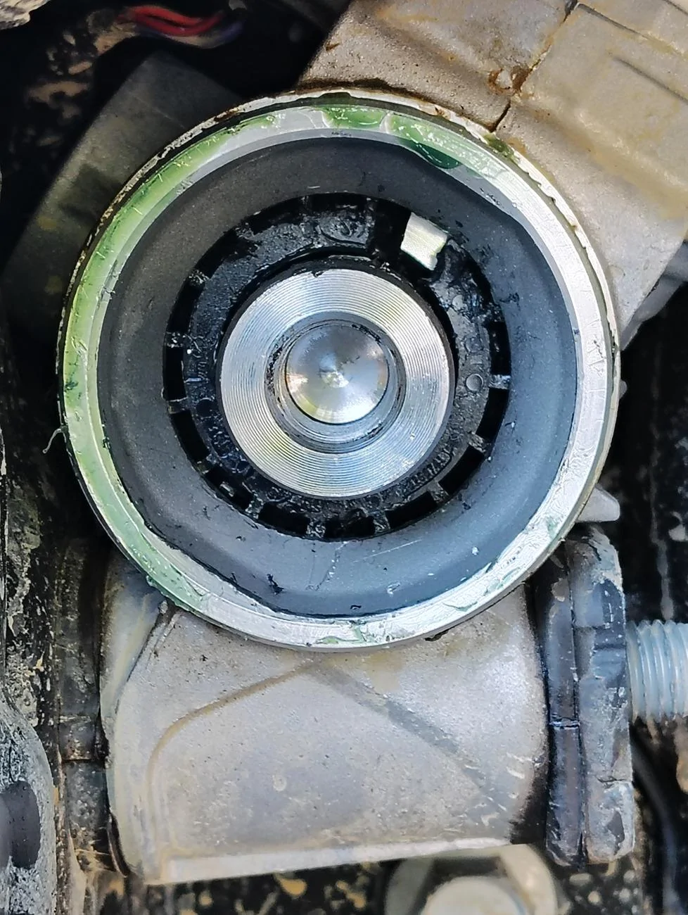

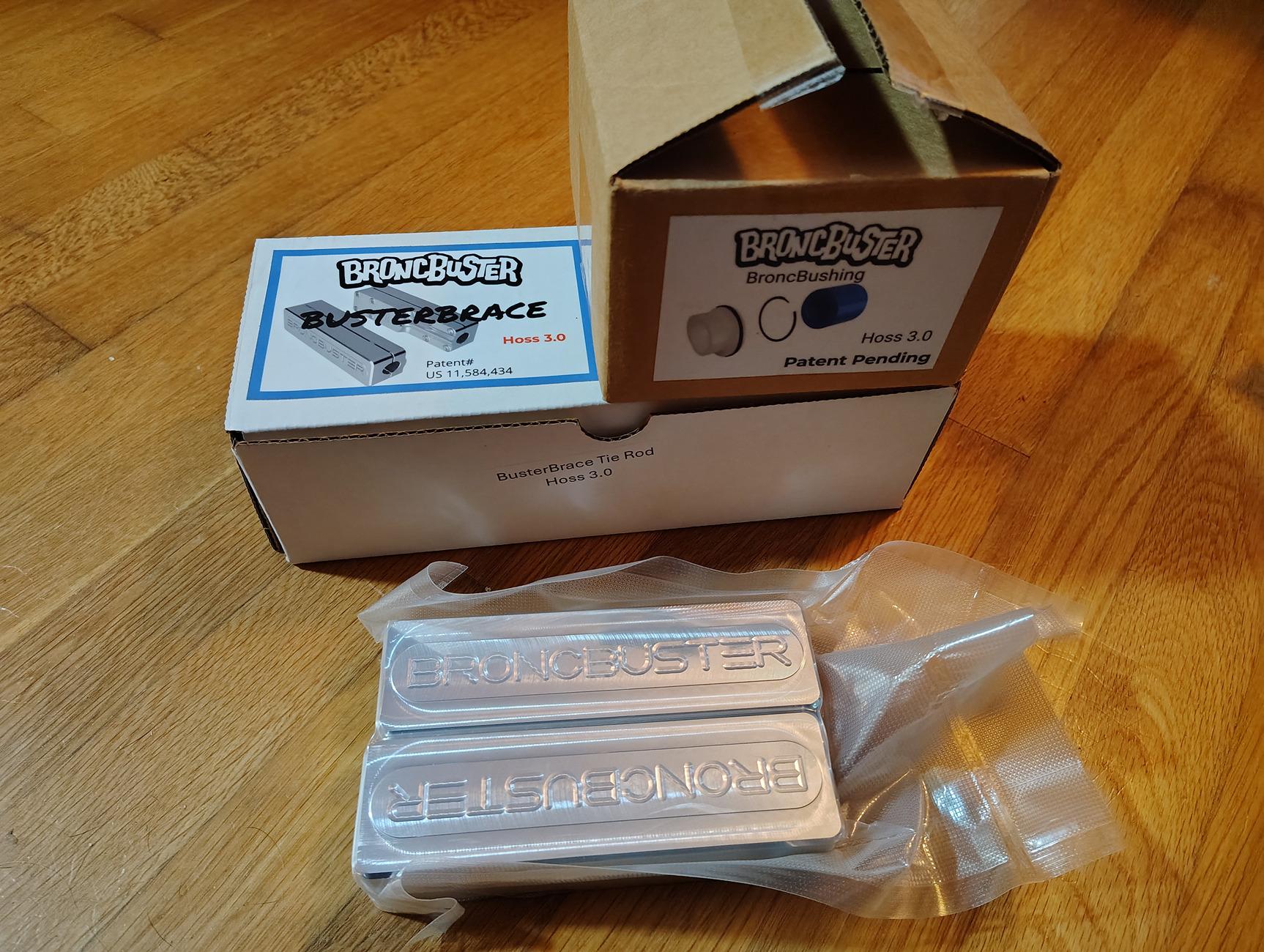

I also ordered the BroncBushing and BroncBracers from BroncBuster for hers too.
Ford Bronco Butterscotch, 2dr HEL, Wife's Build IMG_20240905_183843794_HDR

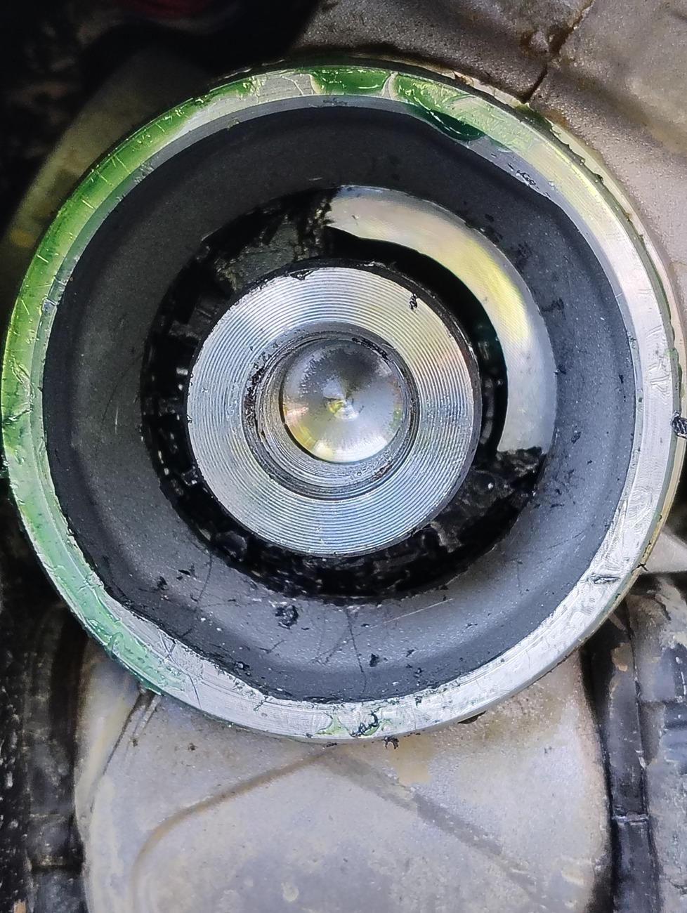

Man, getting the Black OEM plastic bushing thingy out of the 3.0 rack was an awful nightmare! It took way longer than it did on the 2.0 rack!
Ford Bronco Butterscotch, 2dr HEL, Wife's Build IMG_20240907_162940919_HDR

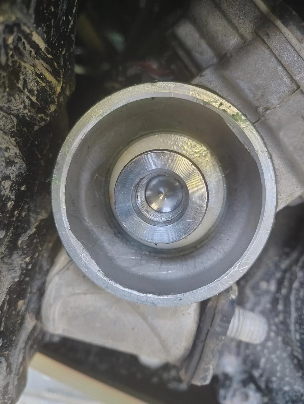

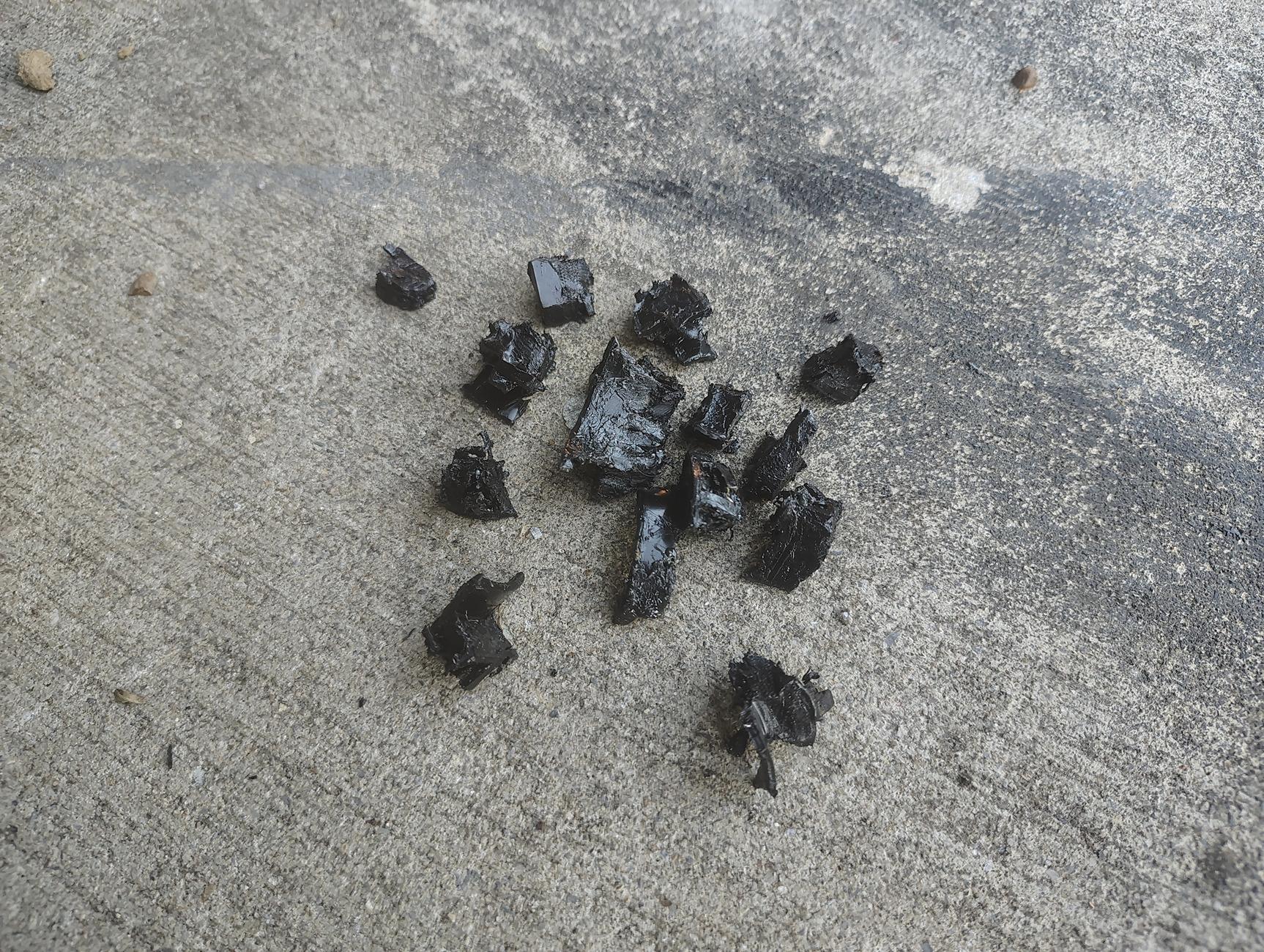

I used a narrow flat head screw driver and smacked it with a hammer, trying to "cut" the bushing into smaller pieces. It worked, but took at least an hour and was time consuming!
Ford Bronco Butterscotch, 2dr HEL, Wife's Build IMG_20240907_165031356_HDR
Finally! All of the OEM bushing has been removed! I blew it out well and made sure it was clean for the new bushing!
Ford Bronco Butterscotch, 2dr HEL, Wife's Build IMG_20240907_171415536_HDR
This is the mess that used to be the OEM Rack Bushing
Ford Bronco Butterscotch, 2dr HEL, Wife's Build IMG_20240907_171406968_HDR

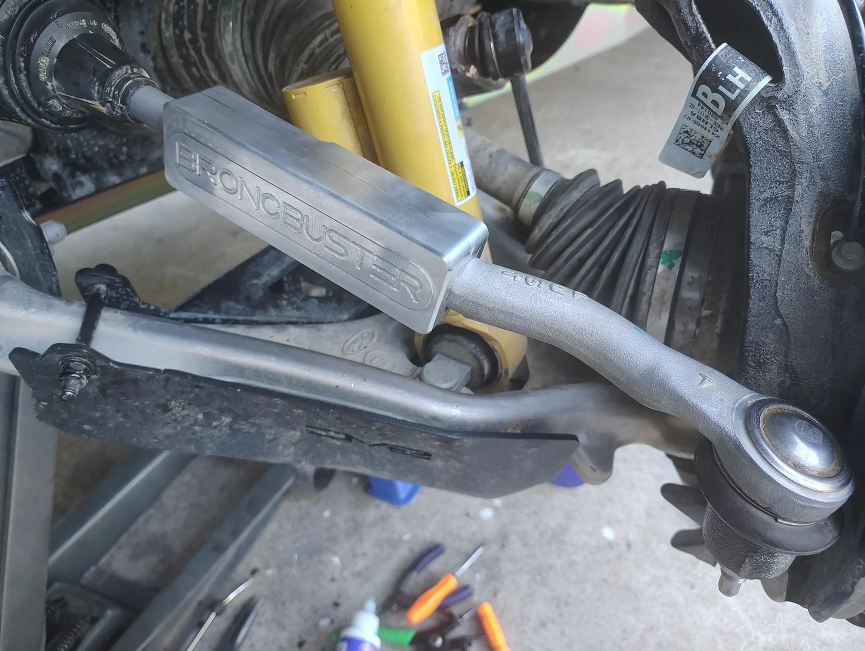

It's difficult to see, but the White piece around the rack piston is installed and the snap ring is in place! I may upgrade the passengers side to the Billet housing next year, but unsure if it'll need that or not?
Ford Bronco Butterscotch, 2dr HEL, Wife's Build IMG_20240907_172729874_HDR
I finished it up with installing the BroncBracers! These were kind of a PITA to tighten....

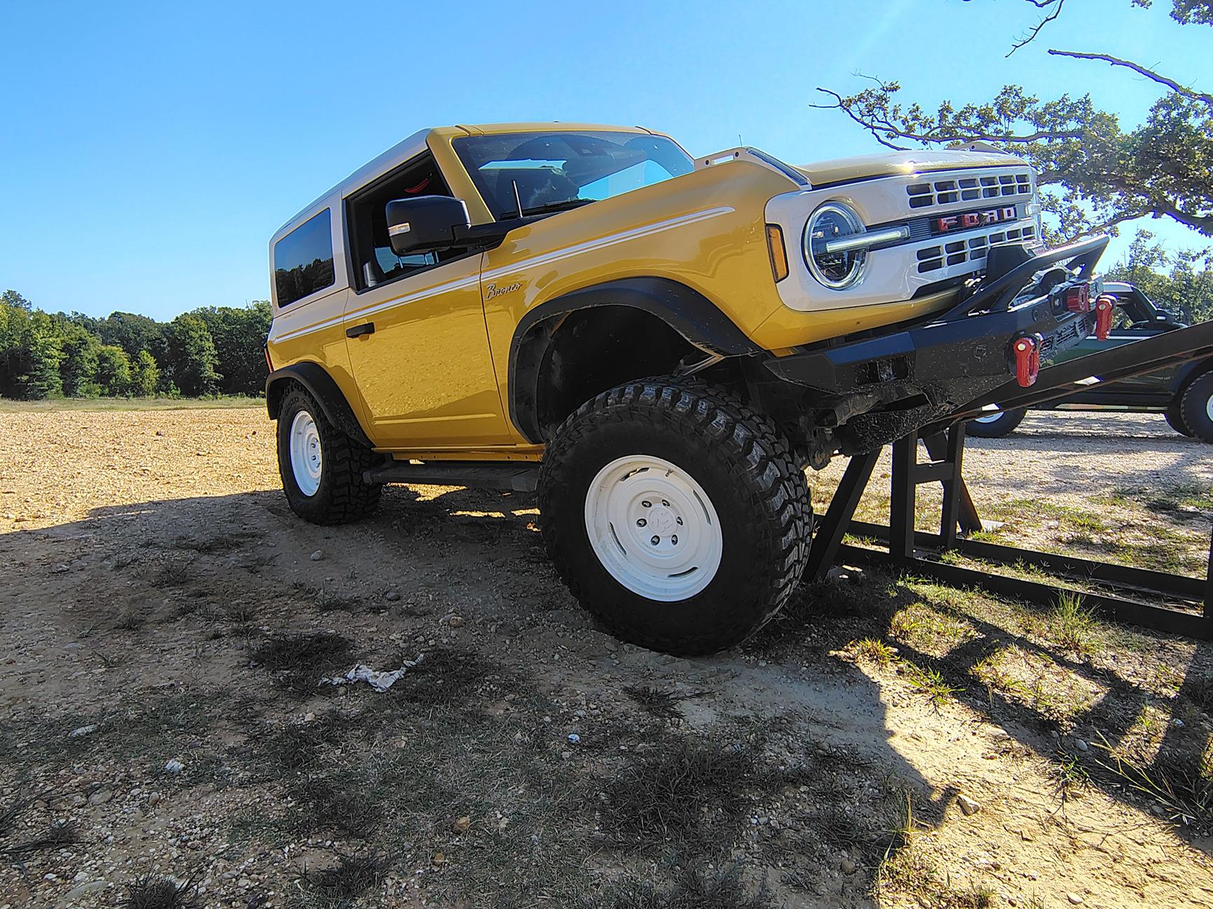

I made this same statement the white wheel look like PVC 100%​
Well, ours are not yours, so you don't have to like what we like ;)
Why do the non-Limited Heritages come with white wheels then?
She didn't like the Black/Silver HEL wheels. Mine had those crappy "beadlock" Bad Land wheels, which I didn't like. The whole point of making them look like a 1966 "Heritage" Bronco was white top, grille and wheels. I remember seeing white wheels on everything stock, when I was a kid.

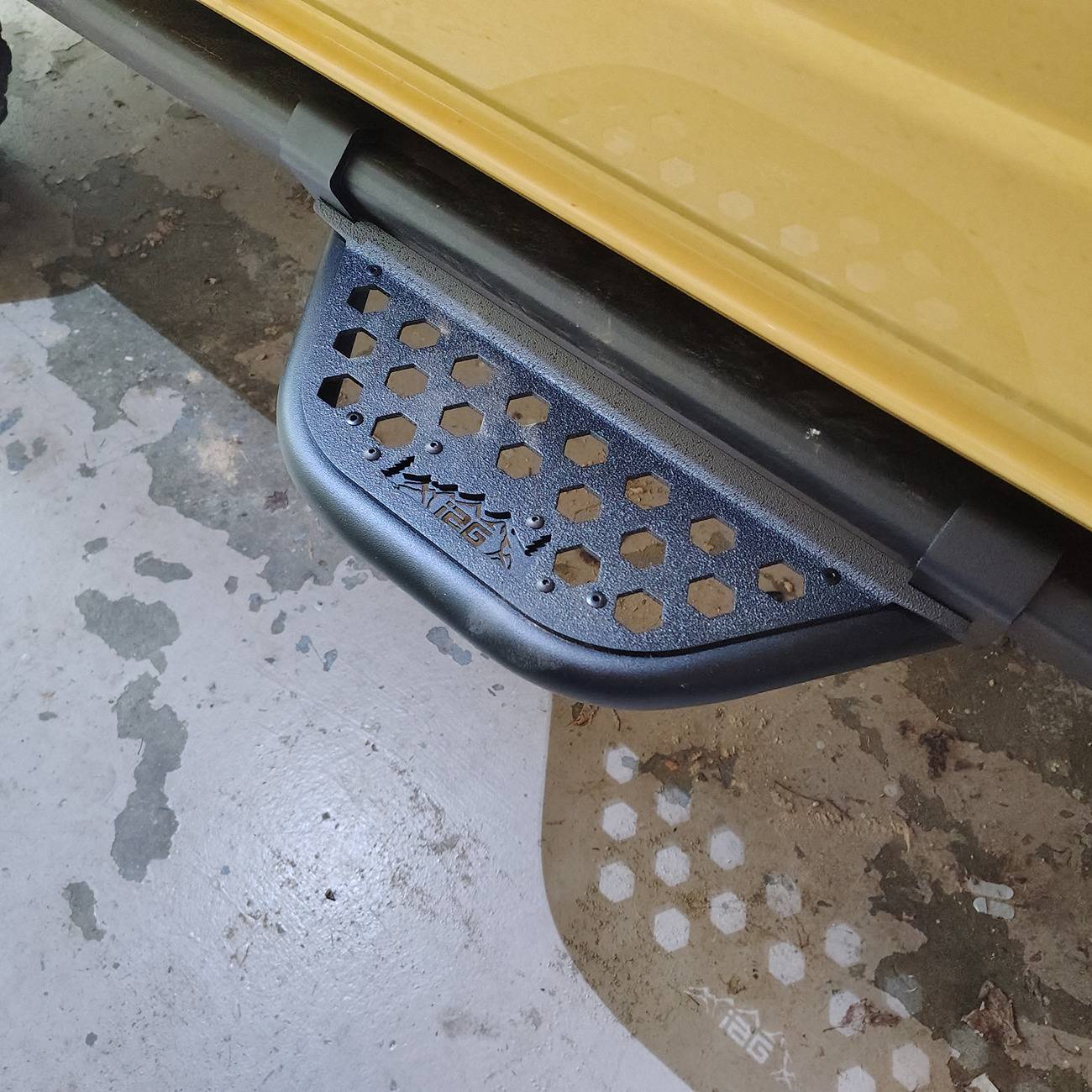

Installed the IAG Steps on the OEM Rails yesterday. These things are ridiculously prices, from $200-$500... She wanted a Yellow IAG badge, but they didn't offer it...
Ford Bronco Butterscotch, 2dr HEL, Wife's Build IMG_20250327_190611772_HDR
