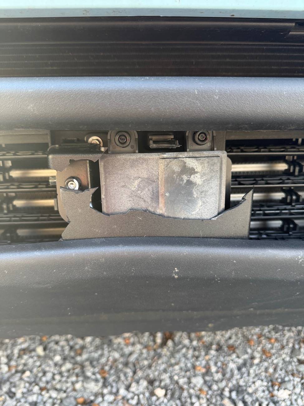

I’ve read that bull bars can sometimes multiply the damage when you hit something like a deer rather than protect the vehicle. What are your thoughts?
Recently we hit a juvenile buck at about 20-25 mph and it hit the capable bumper on our 4Dr Sasquatch No damage to grill because it must have ducked and it was young. It bent the center in and cracked the sensor cover. I was able to pull out most of the bend manually. I wonder if a bull bar would have created more upward and rearward stress.

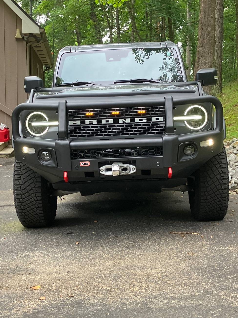

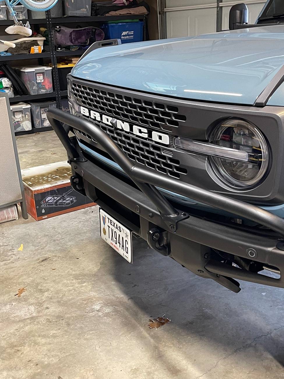

Every hit will be different, a bull bar hopefully protects from most kinds. I have the Turn bull bar is it projects forward away from grill for better protection. The Ford bull bar is up against the grill and looks like it will just squash right back.
I now have the turn baja bar, which is basically the bull bar with added protection for the headlights

Yes, I live in Western NC mountains. So many deer around. It was my wifes Bronco that was hit. I pulled out the dent as much as I could. We had the bumper removed and the central plastic cruise control sensor cover replaced. Unfortunately the guy epoxied the right parking sensor cover back on because one clip was fractured. Now I cannot remove bumper without destroying the $250 parking sensor cover. We will just replace the whole thing. She wants it perfect.

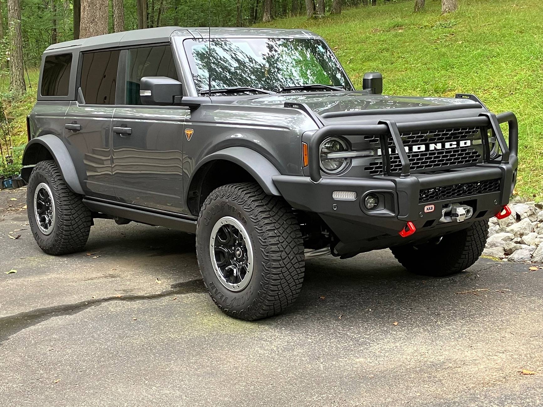

Thats a nice looking winch bumper. Looks very stout and frames everything well. I guess it blocks the camera? Which model and how much?

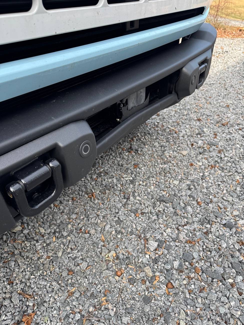

mine may deflect the impact down but like others have said it’s the bumper it’s attached to that will determine the damage.

This is an ARB Summit bumper. Runs about $1850 everywhere unless you catch a sale (which I did). A front camera relocation kit is included and it works great. Also accepts sensors and works with adaptive cruise if you have that. It’s the best thought out bumper/bull bar/winch mount in my humble opinion. It is stout! With the winch, it is heavy. I upgraded my suspension with Eibach 2.0’s with heavy front coilovers.
