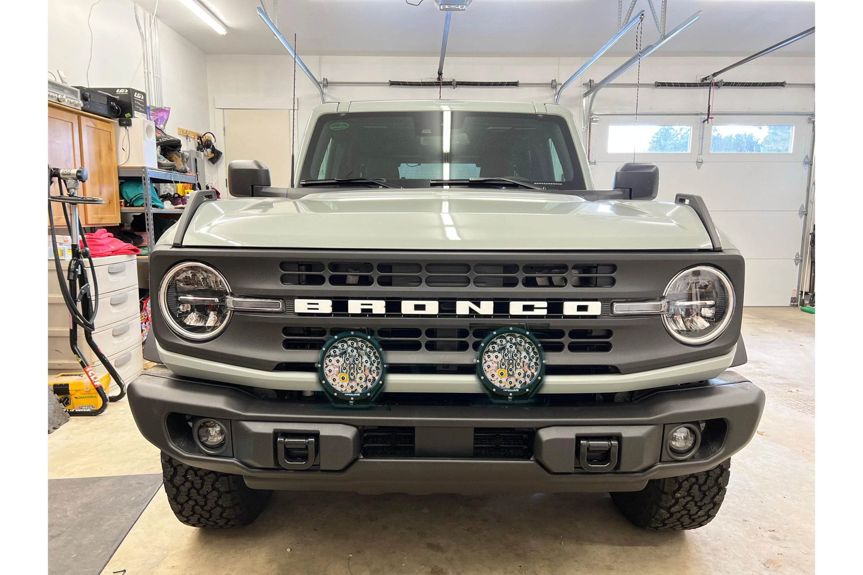

my plan was to mount low profile bull bar on to the fender itself with 3 7” round fog lights.
Ford Bronco Bull bar mounting lights question 87BAF1AD-54C1-4045-A1F4-C30BAC5CAF55

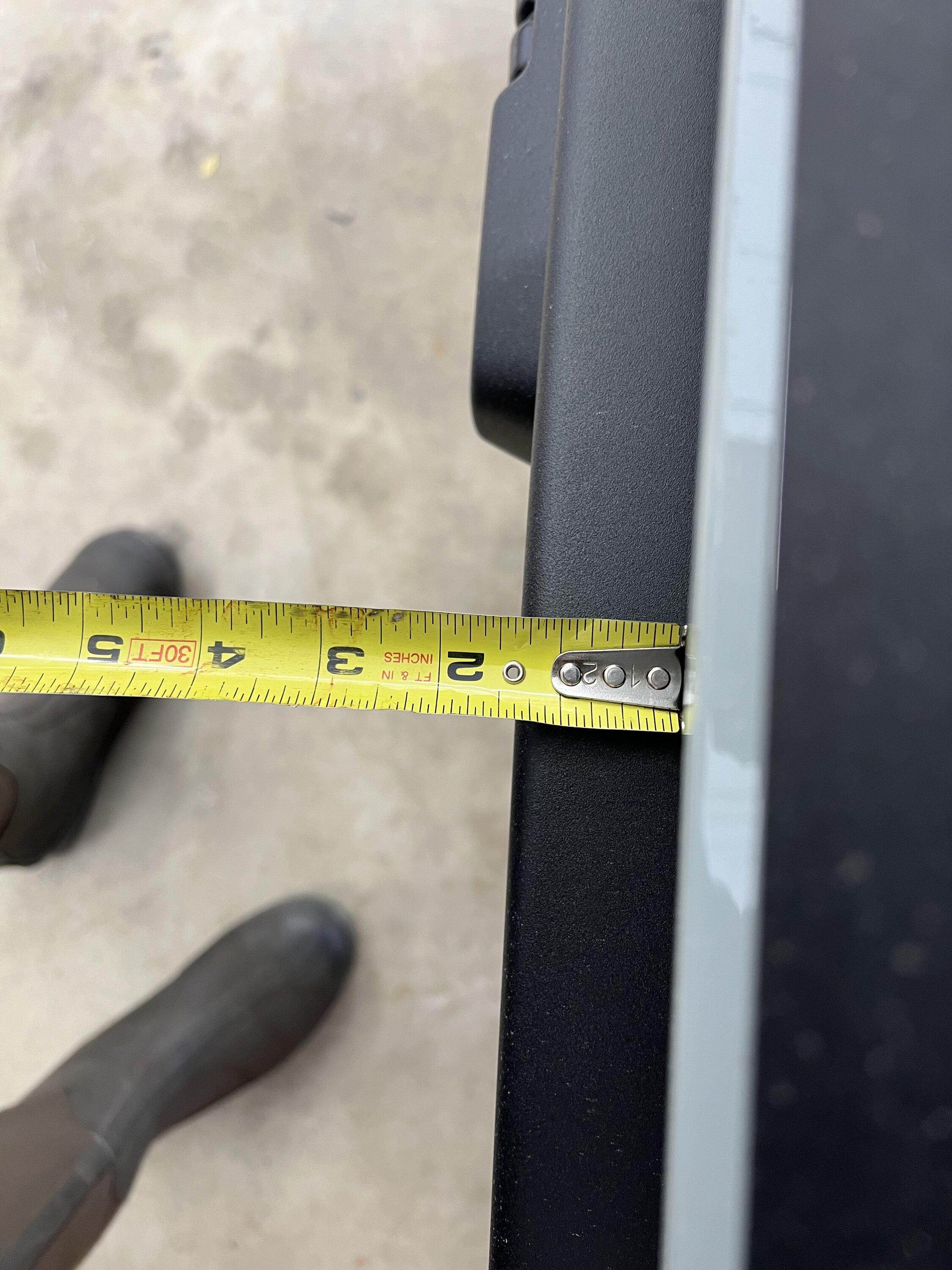

I know from photos the steel bumper ( upgrade ) has 4 threaded holes ready for it , but Capable bumper is very different in shape , actually looks like not much room to mount one since the front trims are come straight out. I know there is one very shallow bull bar where even 6-7” round fog lights will clear the Bronco logo. In the photo I attached how much room there is before the light hits the trim , not much like 1,5” perhaps , I am hoping that bull bar might clear out bit more to live some room to work with lights thickness
one photo with 2 7” Teralume that I photoshopped to my own Bronco for reference what I want to build. The other photo is photoshopped mounting lights directly to the bumper , possibility but having bull bar would also protect the front of the Bronco
any tips and links will be greatly appreciated

Good to know ! I actually have 7” Hella fog lights on full bull bar and they were easy to wire.
Capable bumper is nice but as name says it’s not so capable haha to fit halogens or fog lights , just no room there !
I take my SUV in the Woodson fire roads and more so having decent bar would be plus ! I could easy mounted directly to the bumper but that is not safe for 450 $ lights
I need to poke around and see if there is somth8ng in the city to see in person and see how would fit.
i too love the rally lights they work ! and look clean not fan of long ass bars with zillion lights on them

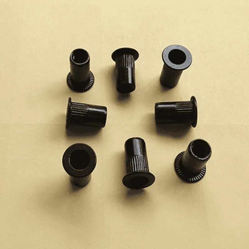

I have the modular bumper, so I added a nutsert and reused an existing Bronco bolt hole on each to mount each light (2 bolts total per light - one existing Bronco bolt hold and 1 new hole with a nutsert).
All of the existing Bronco Bolts are screwed into Nutserts on the bumper, so your new holes will be just as sturdy as the ones you have now.
Ford Bronco Bull bar mounting lights question 1670178503815
You can even find black nutserts to match the bumper. Not truly necessary since the light bracket will cover it, but the option is there.
Make sure to use a straight edge to line up all of your mounts dead straight and then mark the locations to add the nutserts.
You can get entire nutsert kits on Amazon for less than $100 and they are incredibly handy to have. The ability to add threads to thick sheet metal like the bumper is a game changer for DYI mods.
