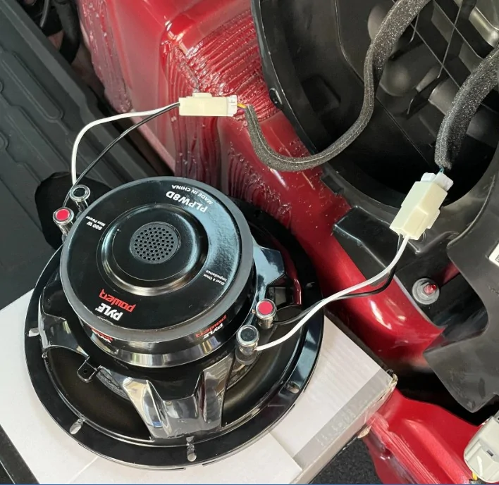

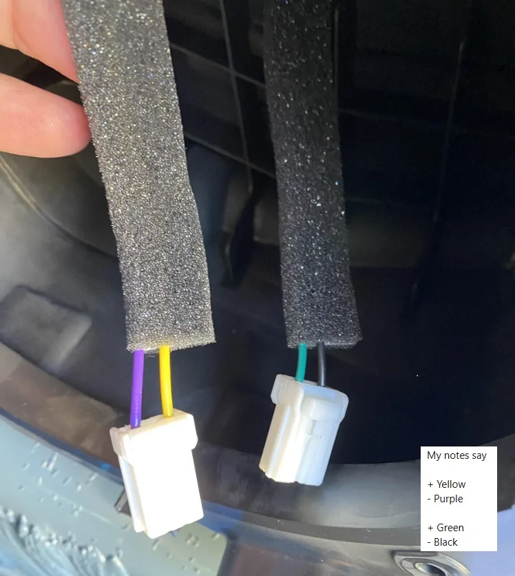

Seems we have a DVC sub.
@B-rad351 connected both positives & negatives together and wired in a DS18 SLC8S sub.

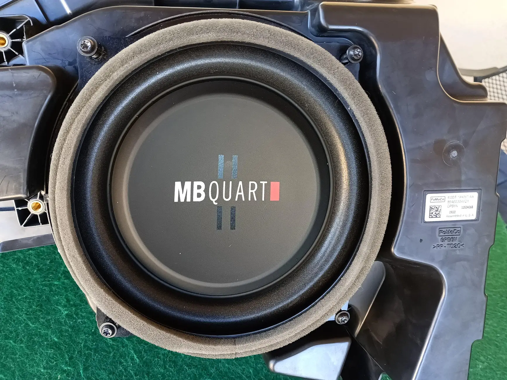

@2022 base fitted in a MB Quart Discuss but powered it off a different amp.

there's a couple of questions here:
What other drop in subs have people powered with the B&O amp? how did it sound?
And, if I decided to go the AMP route, it the simplest way to route the B&O speaker lead to the sub , thru the enclosure to the high level inputs of the amp and then route the amp output back thru the enclosure and back to the sub?

I did that MB Quart sub on my B&O for 4 weeks or so...for the money it's better....then I got a loaded Hertz EBX25.5 NOS enclosure ( similar to a Cento now) and twisted both positives together and the two negatives and was way better.
Then I discovered my Kenwood XR1001.1 summed the B&O output (high level) flattening the signal and eliminating bass roll off so installed that - a massive upgrade with HPF set at 80 and LPF at 30. Transformative....sounds amazing.
I heard the Kenwood 8" loaded enclosure really put out the bass....
Im gonna throw out the MB Quart sub. Glad I did not buy a $400 8" sub to try and make the B&O work.
XR1001.1 is not cheap Im sure there are other 1000W mono that accept high level and sum otherwise a wavtech link 2 will sum high level signal then plug into any 1000W mono amp....what ever is cheaper at the time.
