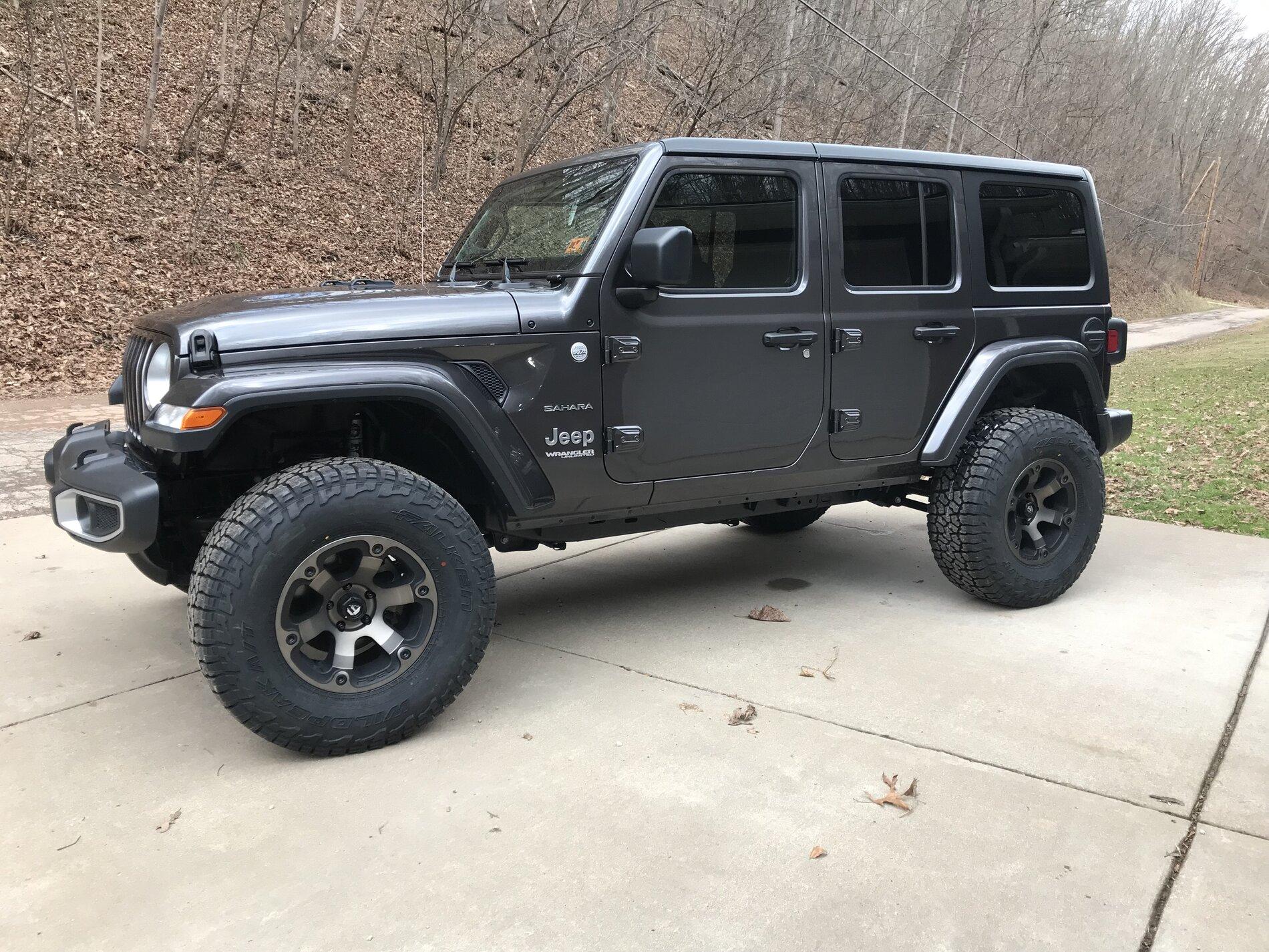

We will be definitely going Sasquatch. This is the wife’s Mopar lifted JLU with 315’s. It looked very much like a street Jeep with the Sahara package. I’m a fan of factory backed lifts. This one rides same as stock and has great ground clearance. For our light off-roading it’s perfect.

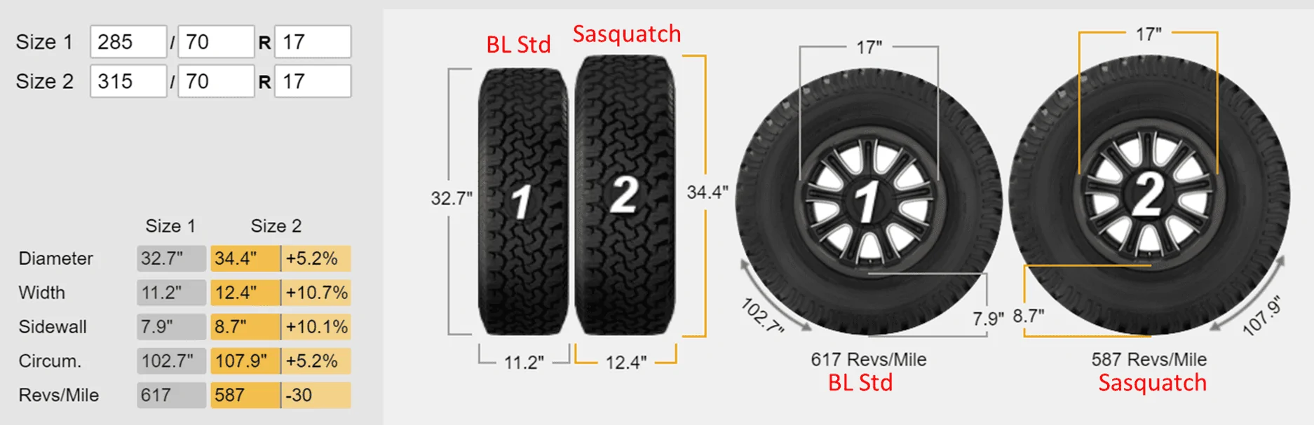

Seems that a lot of discussion is on tires and I had to compare the number to see what's the real difference.
Seems that the 35s get an extra 2 inches on the width, a pretty significant difference.
However, a lesser used size tire can cut that difference in half. Although I have zero knowledge of the tires and how they would sound/drive/handle on the road.
A visual... (EDIT: Corrected for standard tire, not Badlands, thanks @Wyo )
A visual...
Not 2" as the 285/70R17 that come stock on the Badlands are around 32.8" (KO2s) some 285s are 33" like the Wildpeaks. The 315s are usually around 34.4". So maybe 1.6" 285s are a decent size tire that are also around 11.5" wide.
Lab00Rat
Lab00Rat
1,588
4,409
MS
2022 BL 2-Door, 2021 Ford Ranger

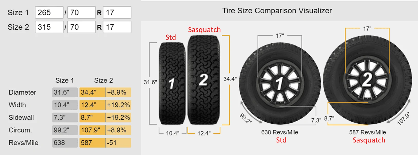

DOH!
Here is the real comparison between standard and Sasquatch. You're right, not much difference.
The original was between 265/70R17 tires.
Ford Bronco Bucking the Sasquatch Fever Tire Comparison - corrected
