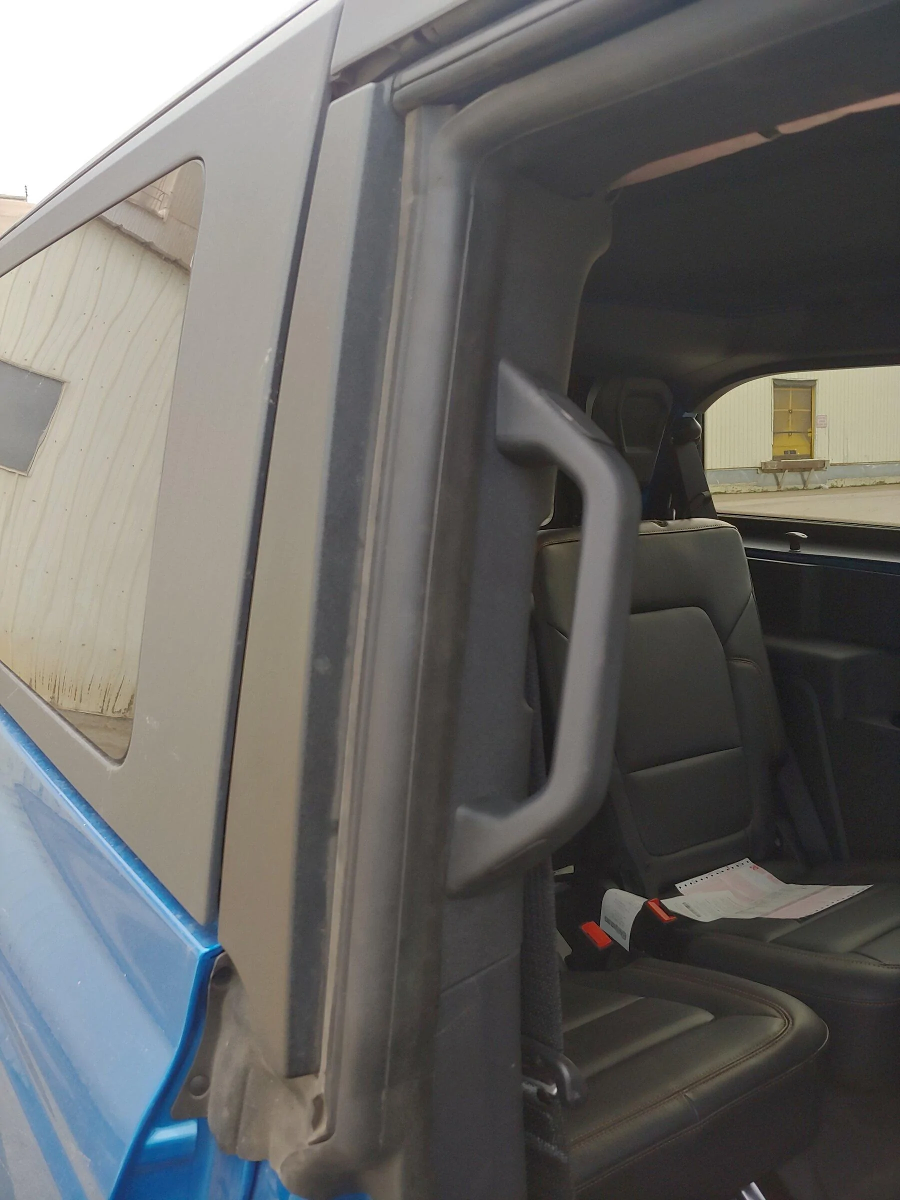

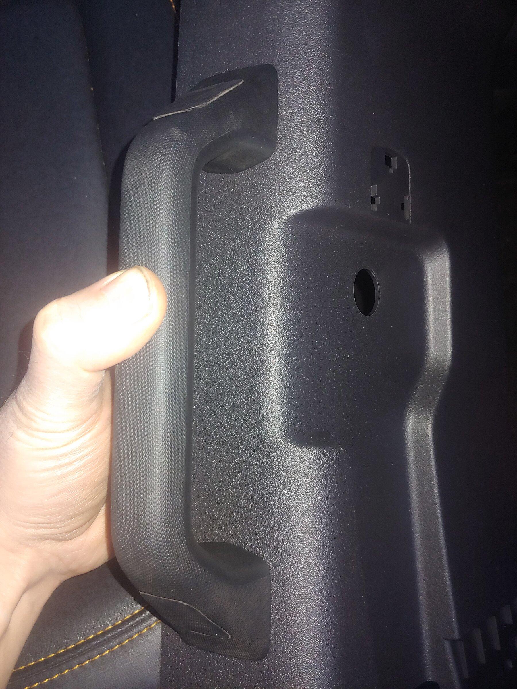

Anybody else get the rear grab handle option on your 2 door?
No, is that aftermarket or on the Ford build page? Guess I missed that if so.
I actually took it from a F150 and put it on.

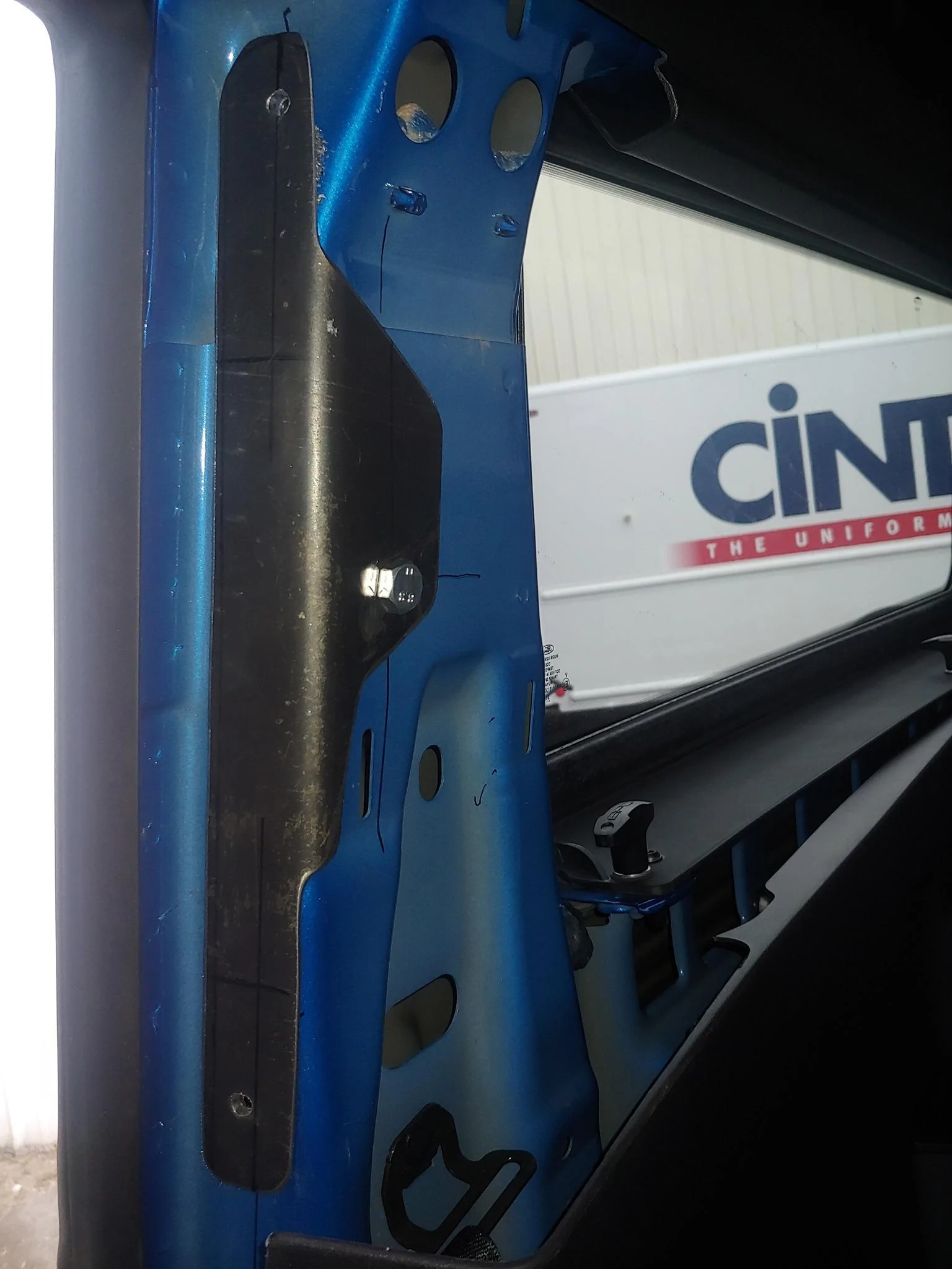

Wow, that looks great! Did you have to use any spacers under the trim?
What year f150 and what does it fasten to? Drill holes in the B pillar?
15-20 crew cab. I had to make a bracket for it to stand off 3/4" from the B pillar steel.
The possibilities! I wonder if the bronco center grab handle would fit in this bracket
The thought crossed my mind but the way it's shaped I didn't see how I could do it cleanly.
Yea your take is really clean too. I guess time to hit the local junkyard!
Just check and recheck everything, drilling through the plastic had me nervous. What I like about the F150 one is the color is perfect and the angular shape fits the interior design. Late model Explorers have a similar handle but it's more rounded.

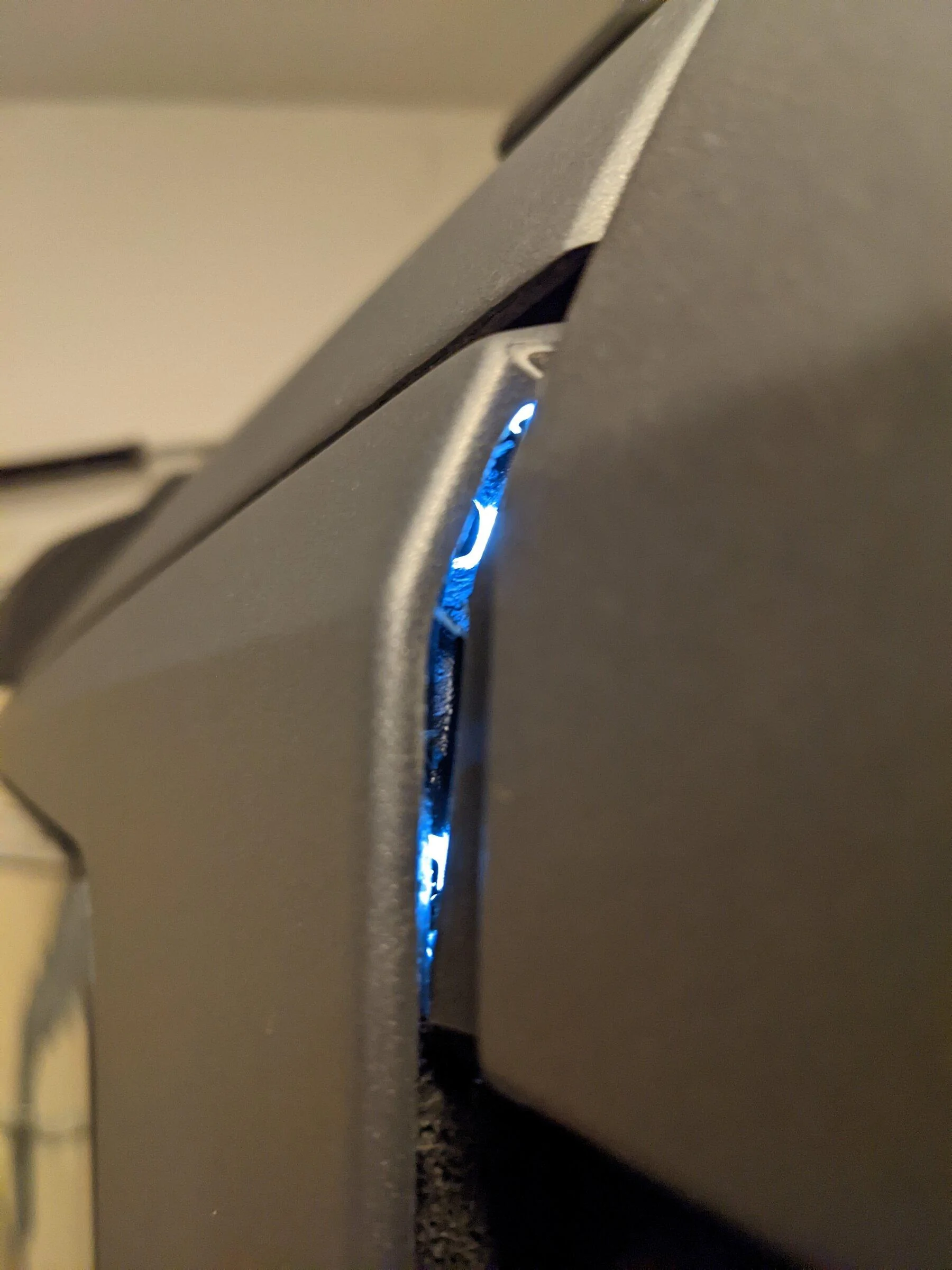

Sorry if this has been brought up but I am trying to figure out if I have an issue or if what I have is normal.
I have what I think is excessive wind noise but wanted to hear what you other 2 door owners are experiencing. I expect it to be noisy but what I have is wind noise that sounds like a cracked window. Starts around 40mph and is located mainly over the passenger side. I can feel some air coming through at times as well. Is this consistent with all of these 2 door hardtops or do I have a bad seal?
Have somebody sit in the back seat and shine a light above the roll bar on the right toward the front where the shell and front top meet. Stand outside and see how much light gets out. My seal is embarrassingly bad there... I can see the actual flashlight lens, not just the light! It needs to go to the dealer at some point but only leaks when pressure washing so it hasn't been a priority.
