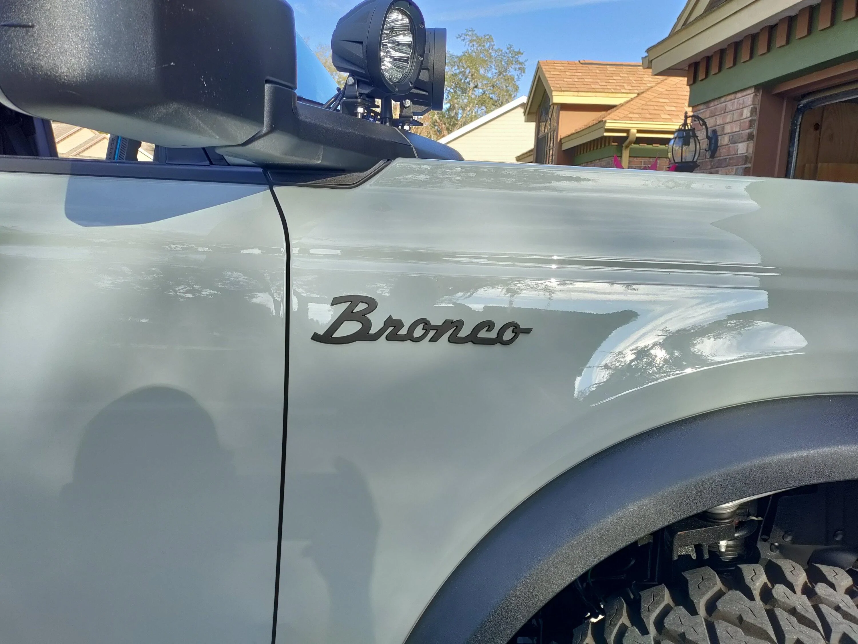

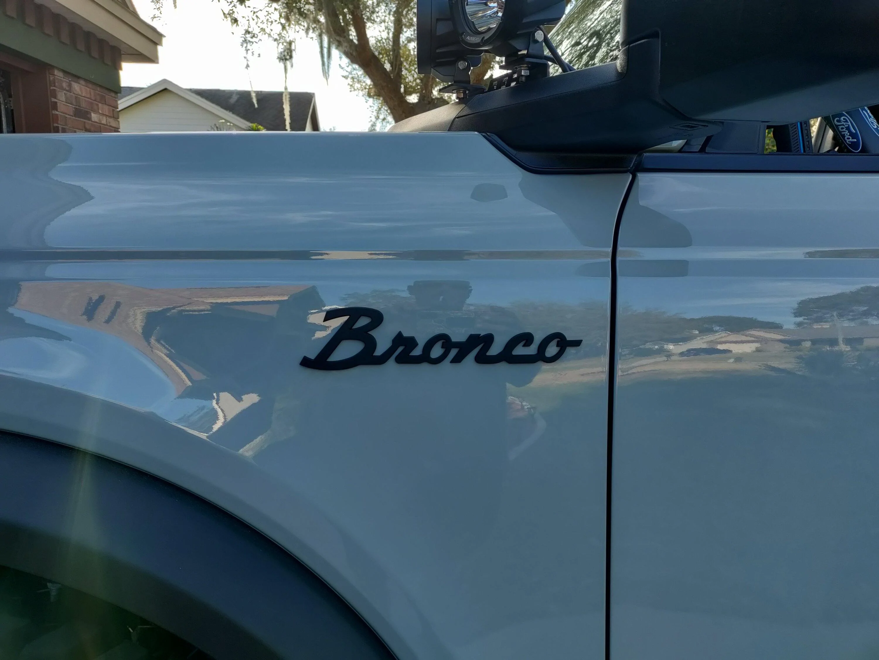

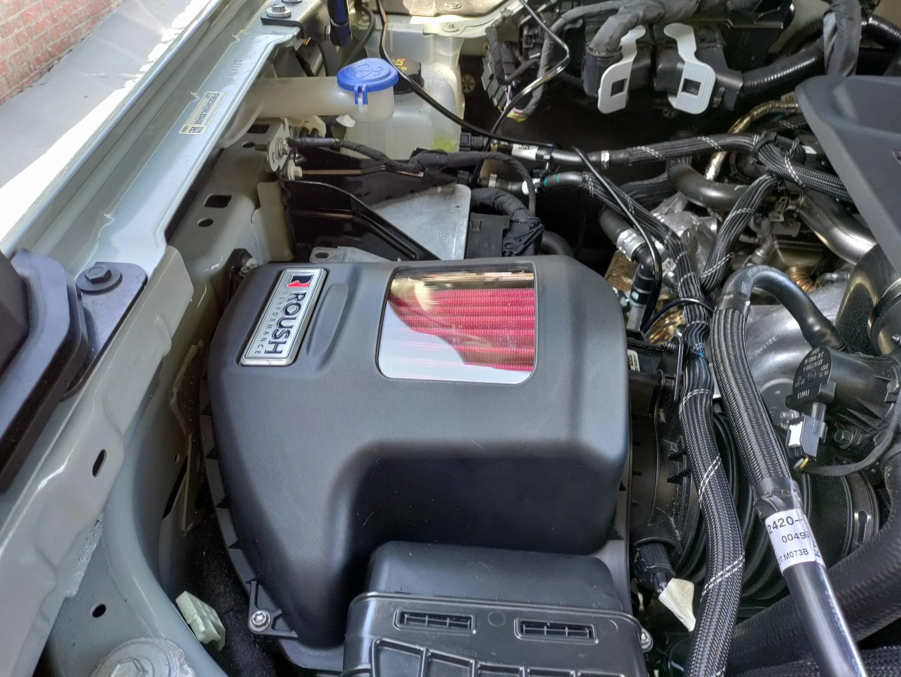

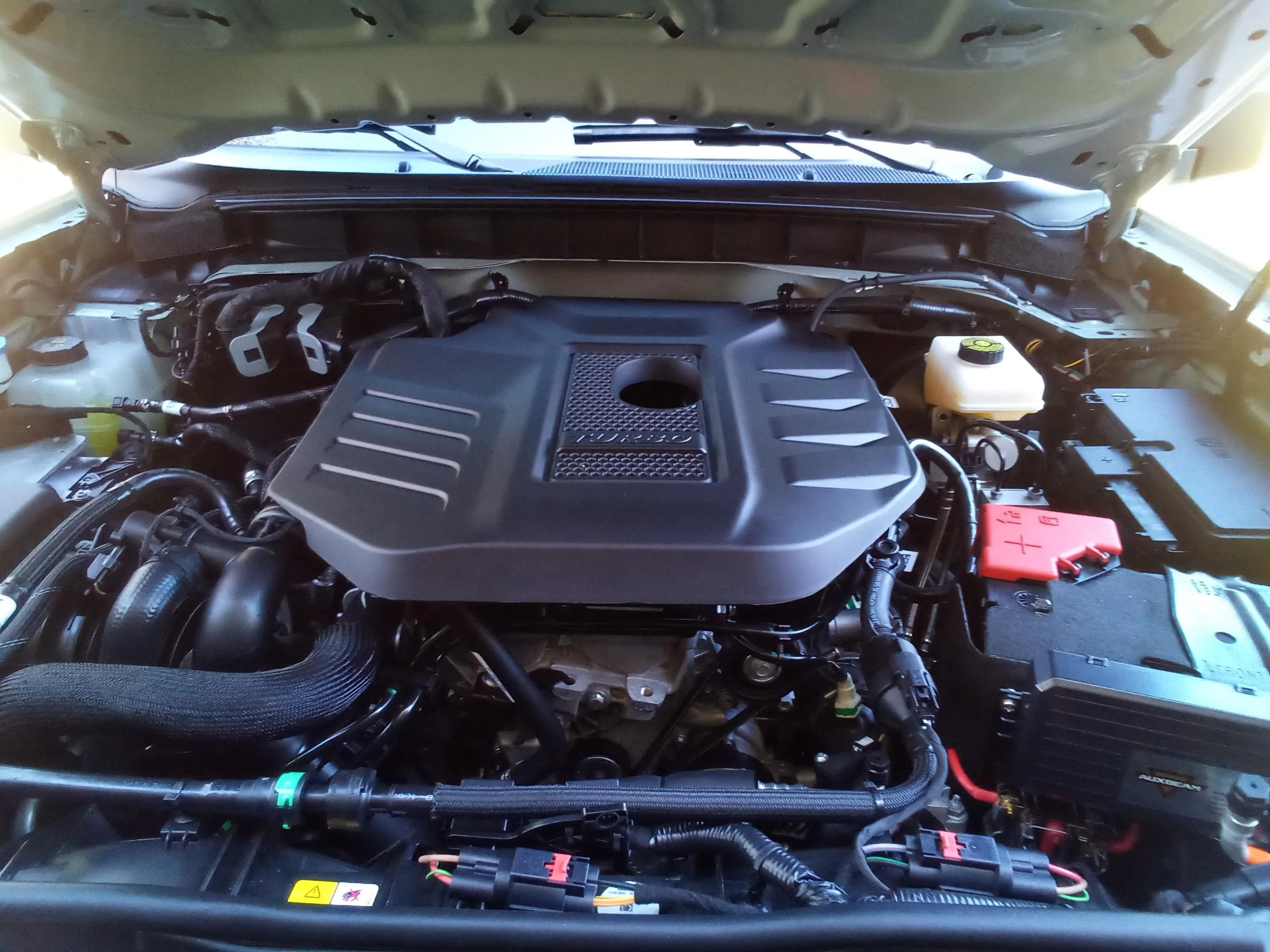

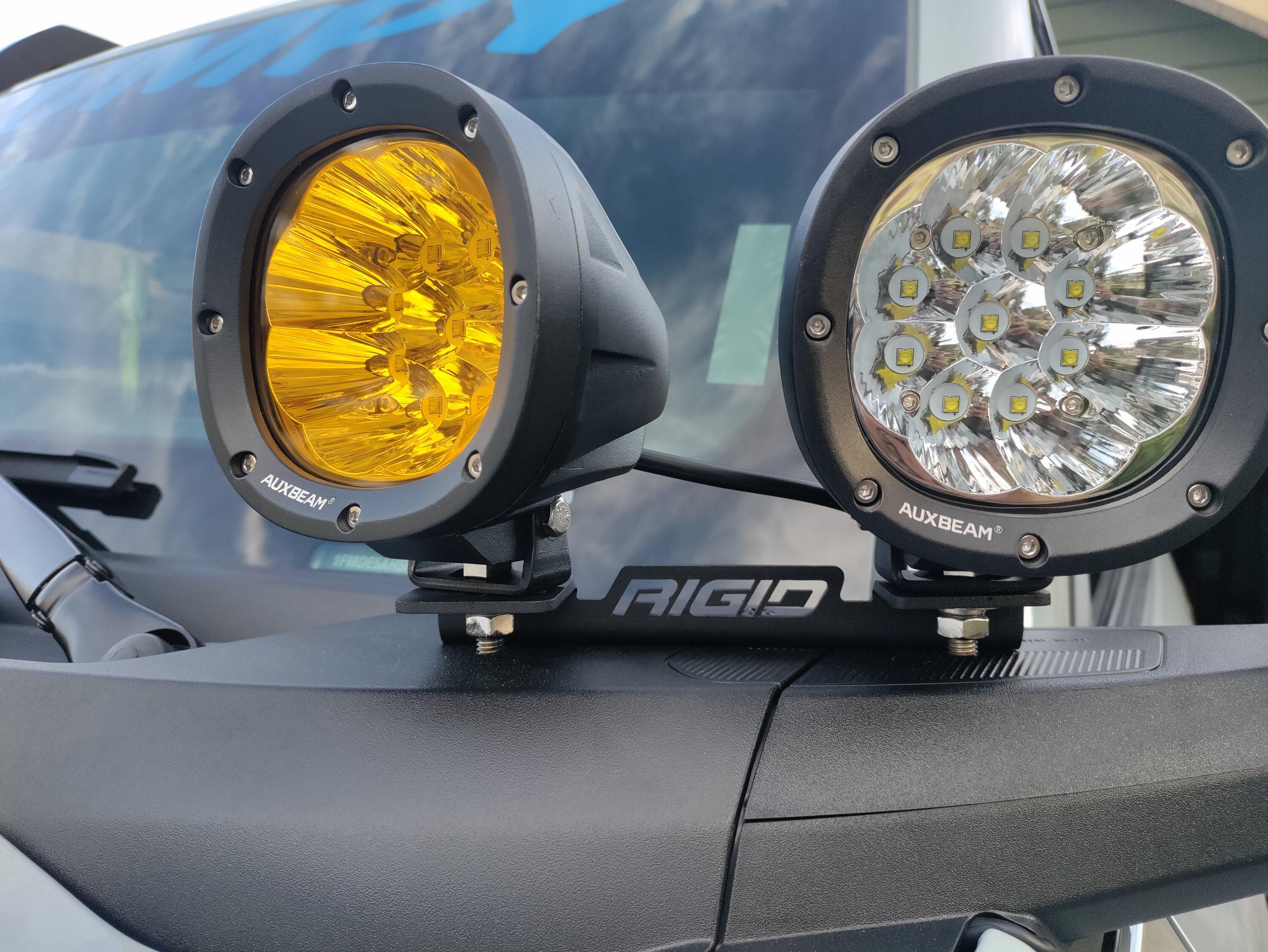

Got the Roush intake on and engine cover this past weekend. Also got rid of the cheap Big Bend decals off the fenders and replaced with Bronco script. And ditch lights with Rigid mounts.

How do you like the intake?

Its nice, you hear the turbo now, but not like some of the other kits. K/N and others make it sound like a honda. But Roush is subtle!

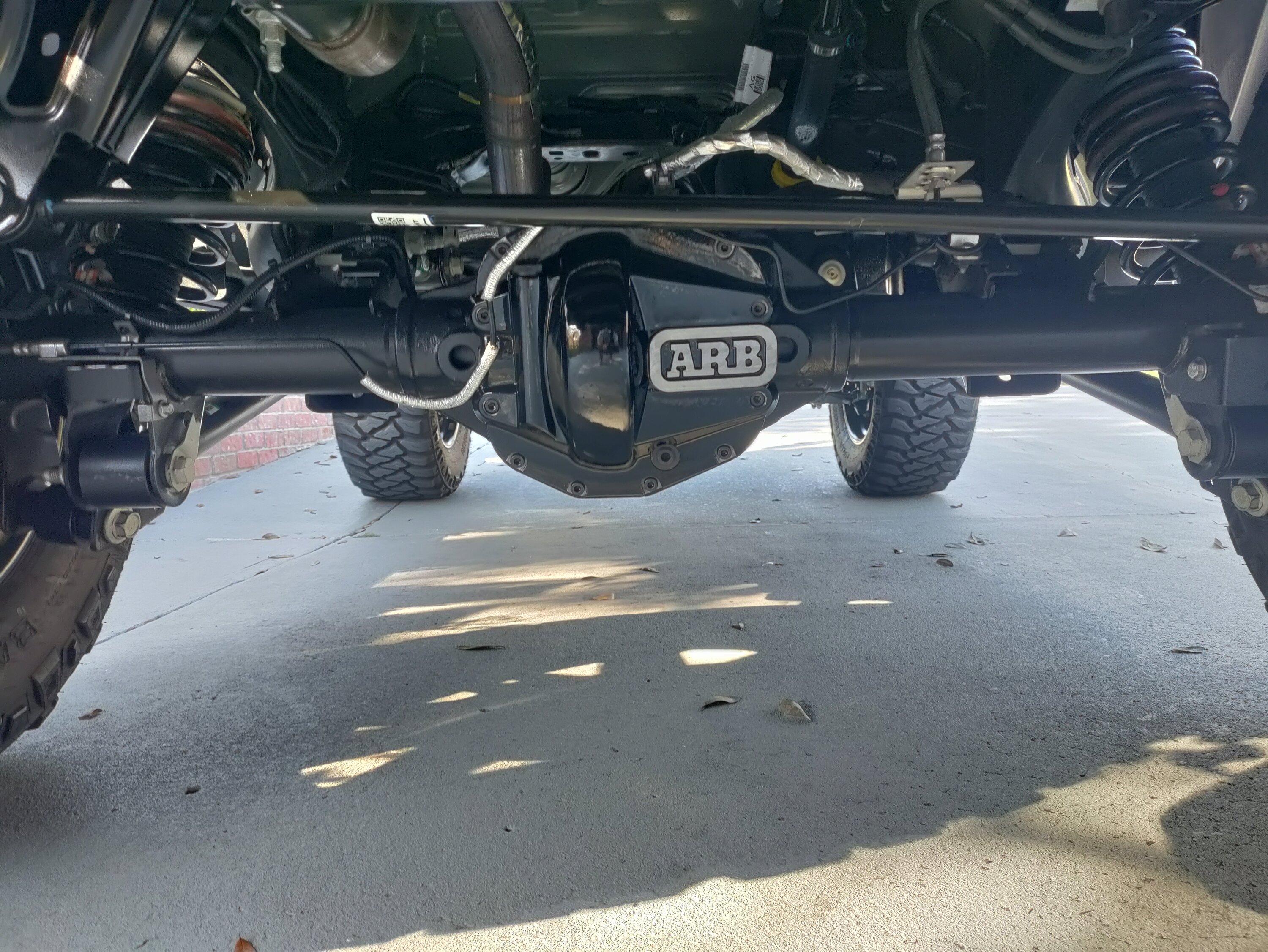

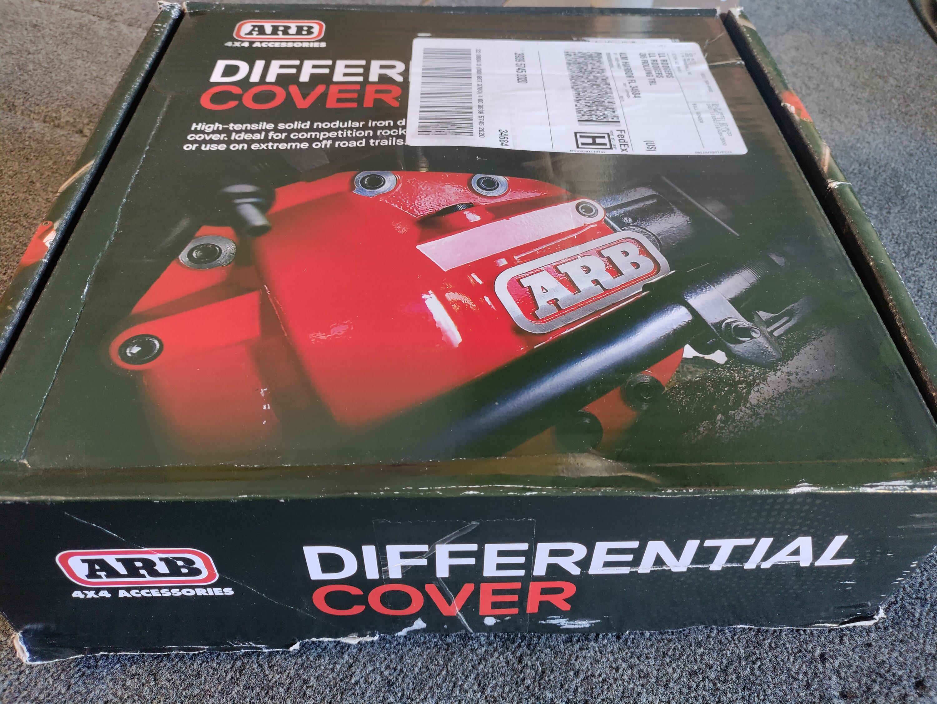

Got the ARB diff cover today and installed. Should give me at least another 15-18hp! LOL

What was the change in fluid volume of the diff with that cover?
No change, still 2qts to fill. Only change was I went from 75/85 to 75/90 Lucas. The only reason I always get a new cover is to be able to change and inspect fluid without having to remove.

Yea, it's a real game changer to actually inspect instead of blindly drain/refill.
By chance did you get any pics of the inside facing of the cover? ARB makes reference to there being additional structural bracketing but without any image of what they're talking about.

There is no difference about the inside other than the dipstick structure. That area is left of the ring gear hump of the cover, so the hump area is a little wider than oem. Clearance and interior shape is the same as oem.

"Computer-optimized, cross-brace design within the differential cover increases the structural rigidity of the axle acting as a truss"
I believe this is what you are referring to.
What they are talking about here is the design element. The outside design has extra material left to right to simulate a continuous support from axle tube to axle tube when bolted on. There is 2 bolts on each side aligned with the axle tubes. You can plainly see the extra structure that is built up across the cover acting like a truss or girdle. That extra material is on the exterior, not on interior of cover.Hopefully you can understand what I'm trying to say bud.
