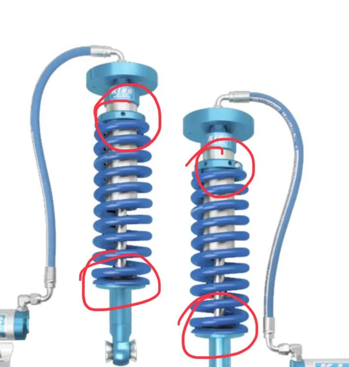

I had this happen after power washing the underbody and suspension following an Offroad trip. Everything dried, then started squeaking and creaking. I hit as many components as I could (including where the springs contact the shock caps) with some silicon spray and it went away instantly. I see you already tried WD40 so maybe just try spraying some spots you didn’t spray before.
Are you able to send a photo of where you sprayed on the shock?
Top and bottom of the springs, where the coil touches the top cap and bottom cap. Those were too dry, I guess, and creaking like crazy. Went away immediately for me. Good luck!
