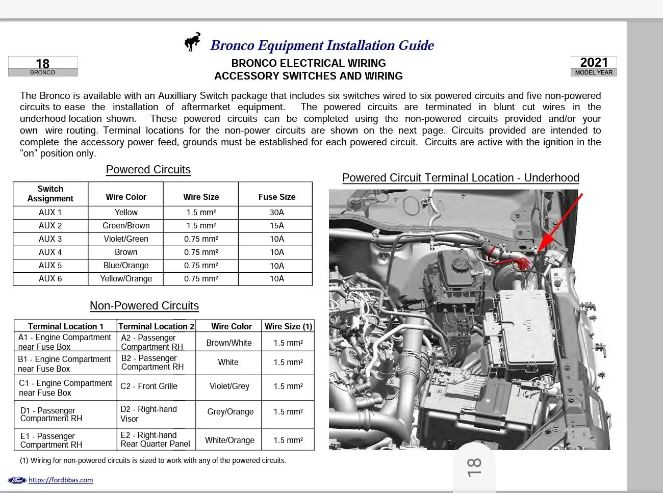

Any, but applicably aux 3, 4, 5 or 6. They are all 10amp circuits. Don't waste your aux 1 and aux 2 on this.

I’m having real difficulty understanding how to connect to the different switches. Dealer installed light bar on AUX 1, mirror mounted lights on AUX 2, and wheel well lights on AUX 3. Id like to wire to any of the others for a decorative light on the grill. I found the wire (sort of lavender with a gray stripe) at the grill area. That goes back to area near the fuse box. It’s not preconnected to power. How do I connect to switch box to power it? Onboard manual is sketchy at best and only YouTube video I found isn’t much help either.

Connect the switch you want running it to the wire going to the grille.

Here's a tutorial to help you.
https://www.bronco6g.com/forum/thre...liary-switches-on-the-2021-ford-bronco.23539/
