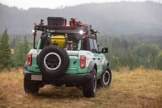

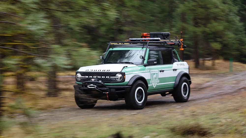

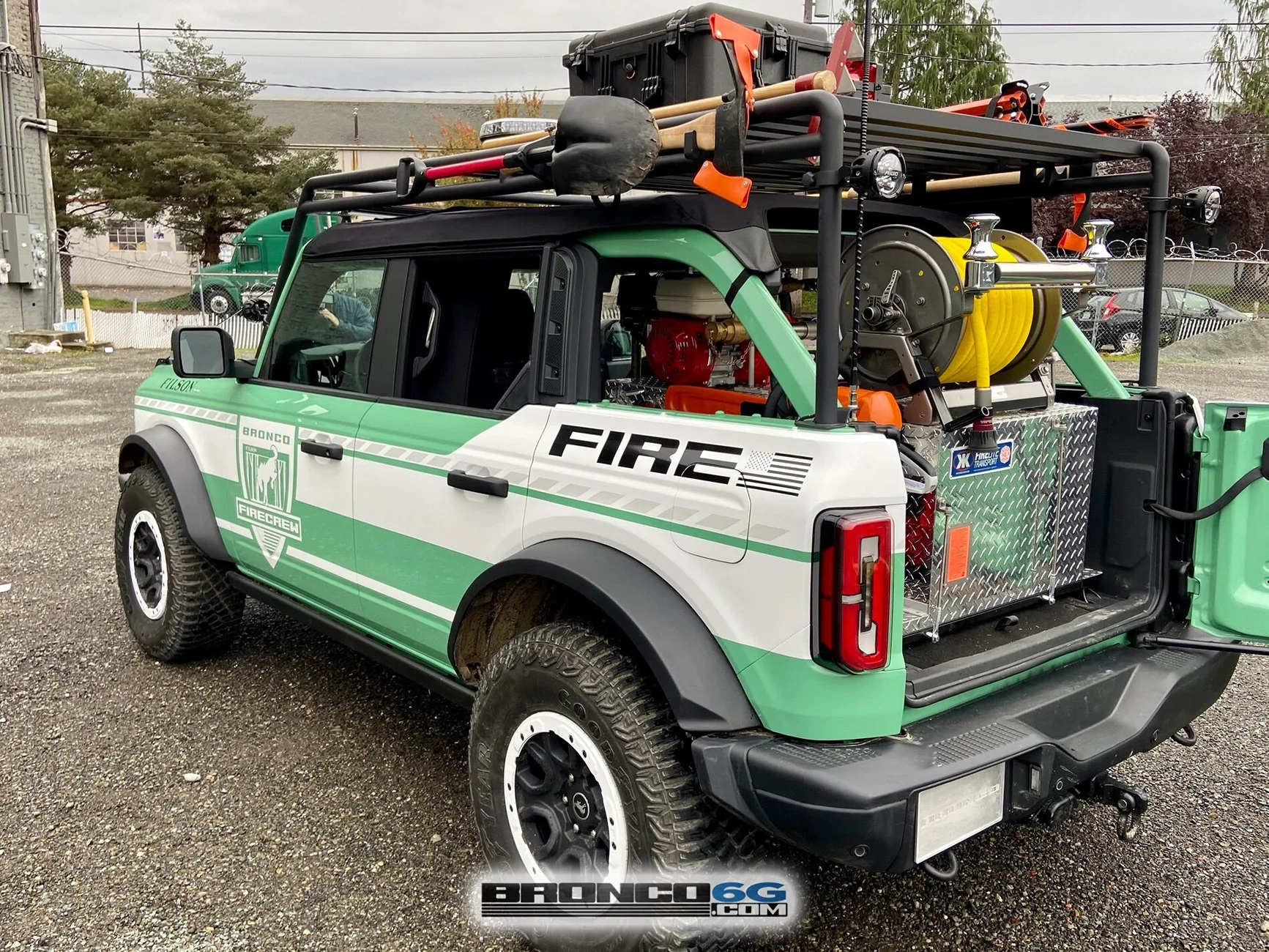

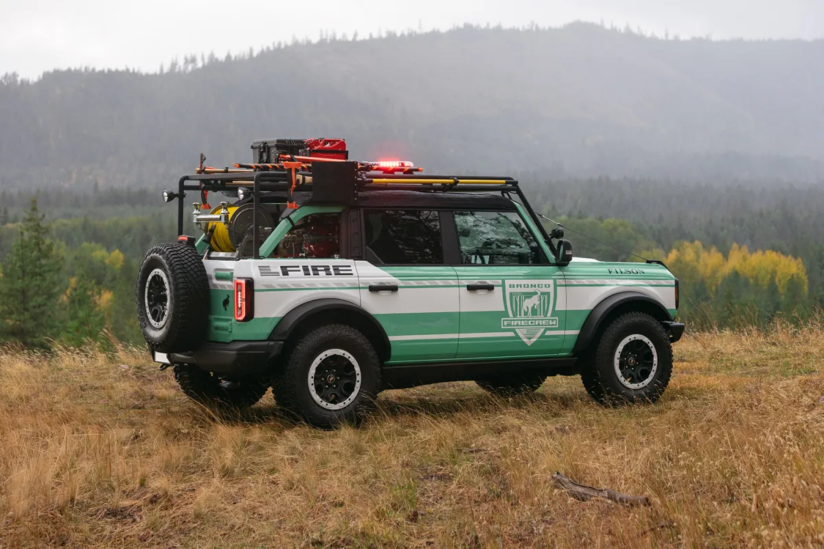

l've taken heavy inspiration from the Wildlands-style Broncos / different fire department uses of Broncos.
What they have created is essentially what I'm trying to create.

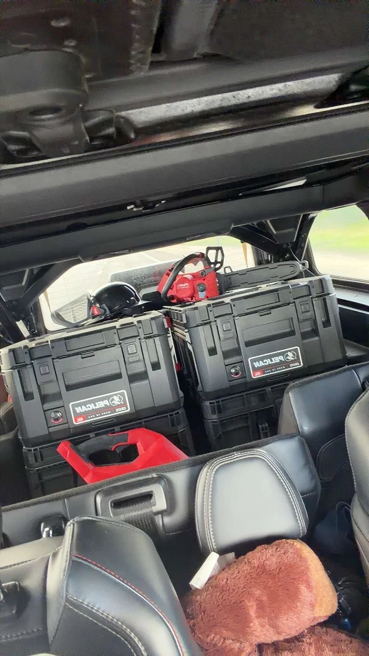

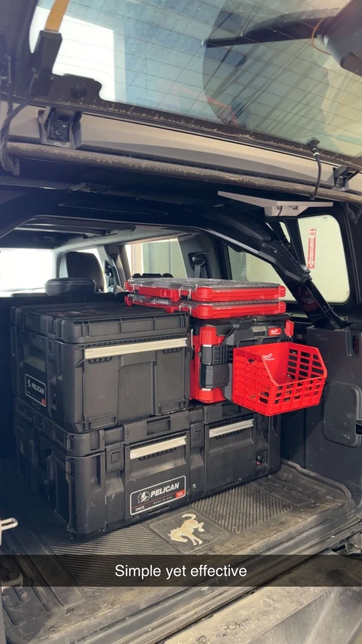

On the regular, 1 carry a handful of large Pelican cases / pack-out cases (see attached image). I currently use a Bronco Raptor for a lot of my day to day, but I'm currently building that out to be a Baja 250/500/1000 pre-runner and can no longer use it for work-related purposes.

The Pelican case stuff is gonna work fine, and you could consider a tray or drawer system to help with loading and unloading the cases.

For what it helps I have a 2025 2 door base that we took the rear seats out of and I put down a heavy rubber mat from Tractor Supply since I'm hauling rounds of firewood and at times trash cans with mulch or compost, it works okay for me but it's not as much stuff as you are hauling but maybe the rubber mat would help you?
