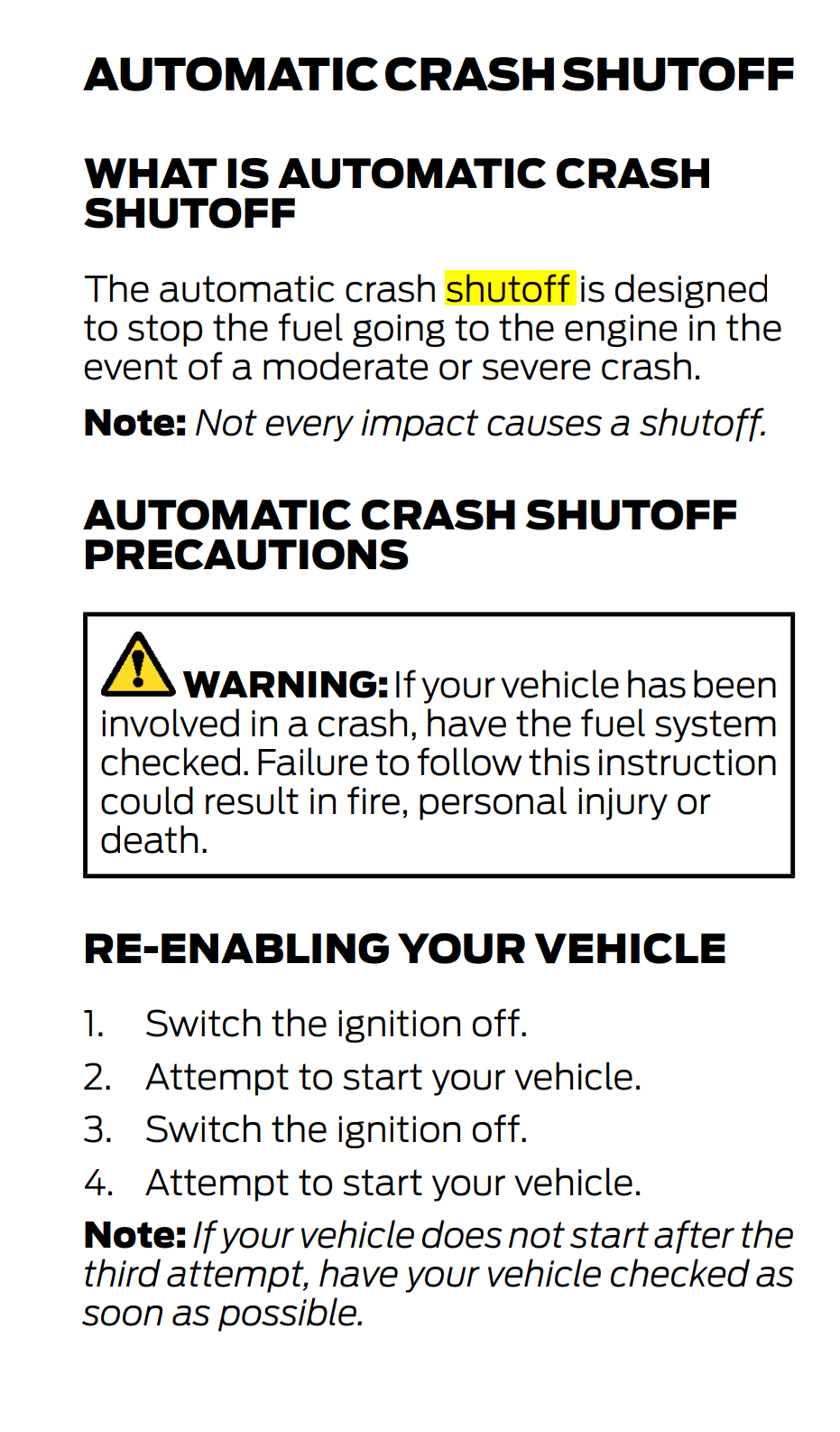

I'm going to guess you may have triggered this?
Ford Bronco BRONCO 2.7 Stalled and left me Stranded!!!! 1652646701109
Supposedly there is some switch that you can reset it - maybe someone who knows can chime in on that....
Yeah, we need to figure out what the easy fix can be, because this is going to happen to most of us that trail these rigs.
