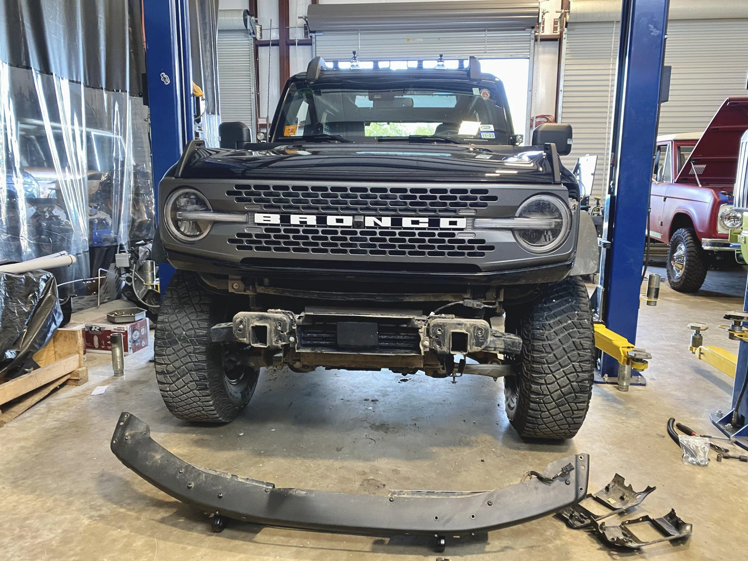

Hey guys yesterday Tyler (@BroncBuster) installed his
3” body lift (to keep proper geometry but fit 37’s)
Stage 3 billet aluminum housing
Bronc bushing
And tie rod “busterbrace”
we also did the bumper relocates front and rear
I can’t wait to get her out on the trail!!!
@4Lo_Lyfe on Instagram for any questions etc

Any after pics so we can see how everything lines up afterwards? Any issues with wiring/hoses/lines not being long enough or stretched to much?

There was a Youtube video on the install but can't find it now. The kit they are developing does have the option for bumper relocates. It appeared that there was only 1 ground wired that needs to be extended, and a wiring harness needs to be rerouted around one of the body mount pucks .

It’s usually just the break lines that you need to watch when doing a body lift normally there’s enough slack though.
I’m all for keeping the stock suspension geometry and fitting 37s but with a body lift you won’t be able to add any aftermarket bumpers without a big ole gap showing also stuck with body mounted rock sliders no frame mounted unless you like the gap.
