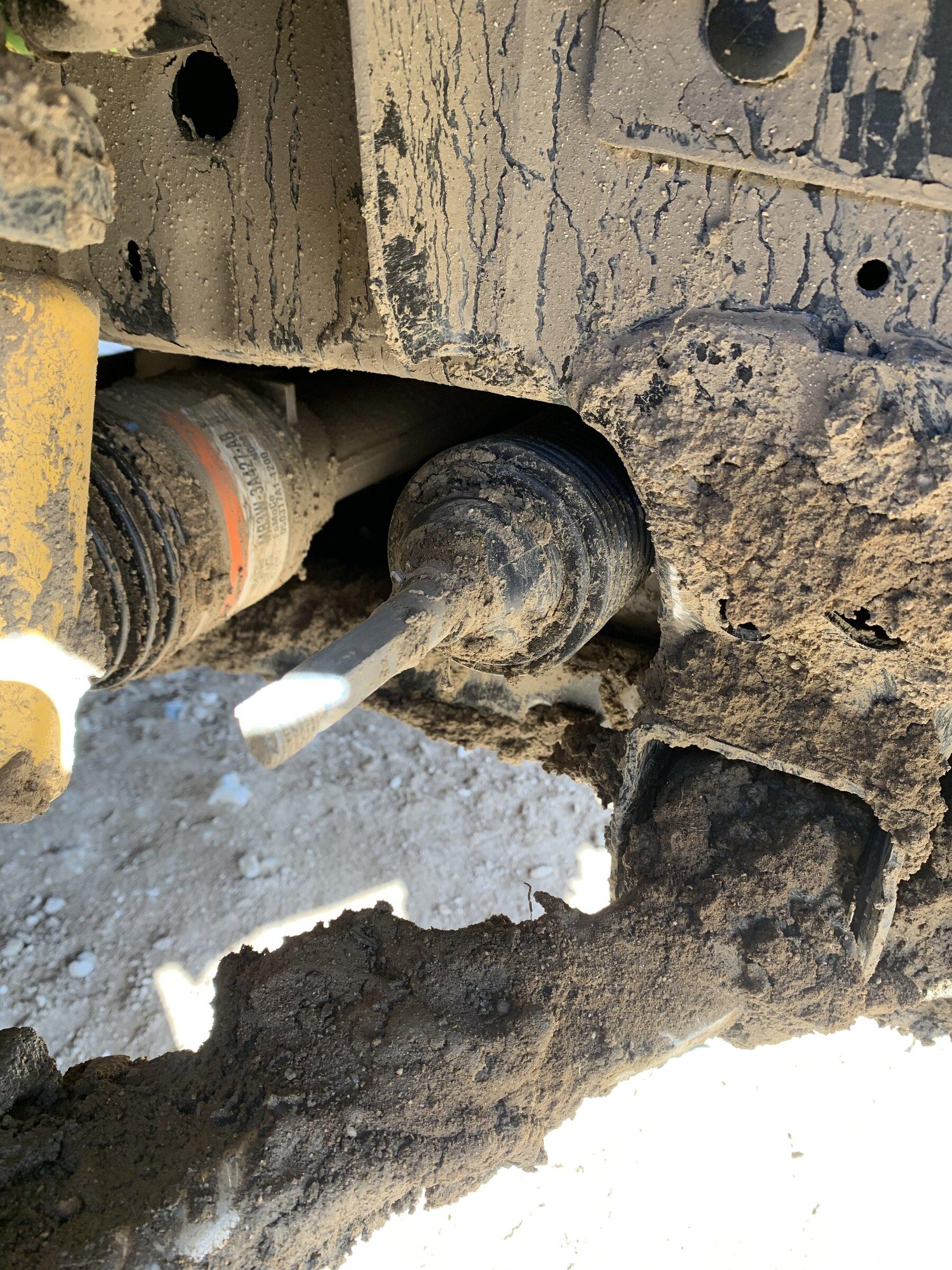

The Driver side was jammed up against a rut. I was turning and felt it snap. I didn’t see any boulders.
Seems strange then that it’s the passenger side that broke. Was it the mud pit in the jeep park/obstacle course area kinda by the teeter totter? That thing has a big rock or something in the middle. I climbed out the side of the pit to avoid it.

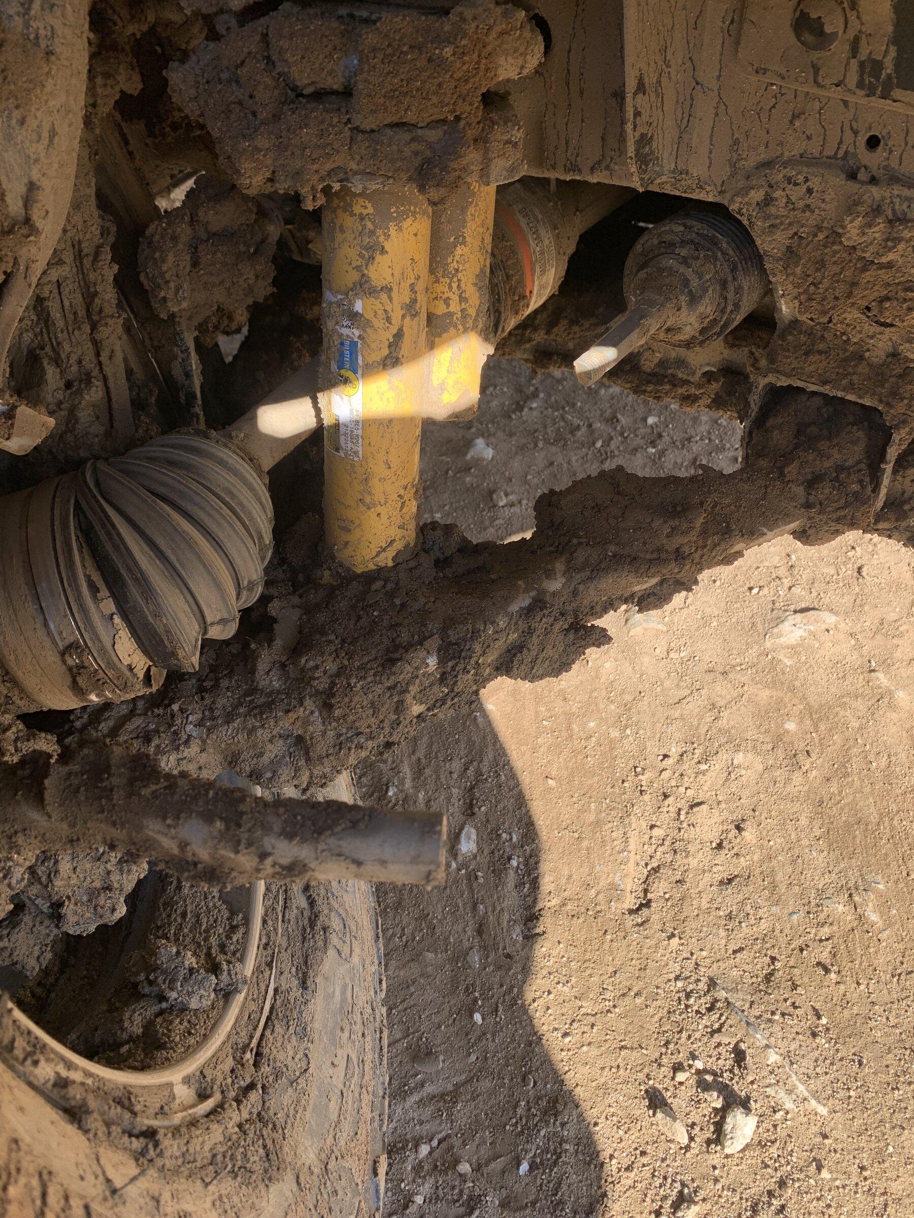

Well everybody I broke the Bronco. Tie rod broke on my first big adventure. Went to Hollister California OHV park. I went through some mud and turned the wheels then it broke. It feels good and horrible at the same time. Any advice? I got out safe but it was a journey. Bronco is at a shop in Hollister now. Hopefully they can get it done. Any upgrades out there anyone recommends?

Will it be covered under warranty? just curious….

Please keep us posted. I want to carry a spare for sure. I hope the repair goes well.
