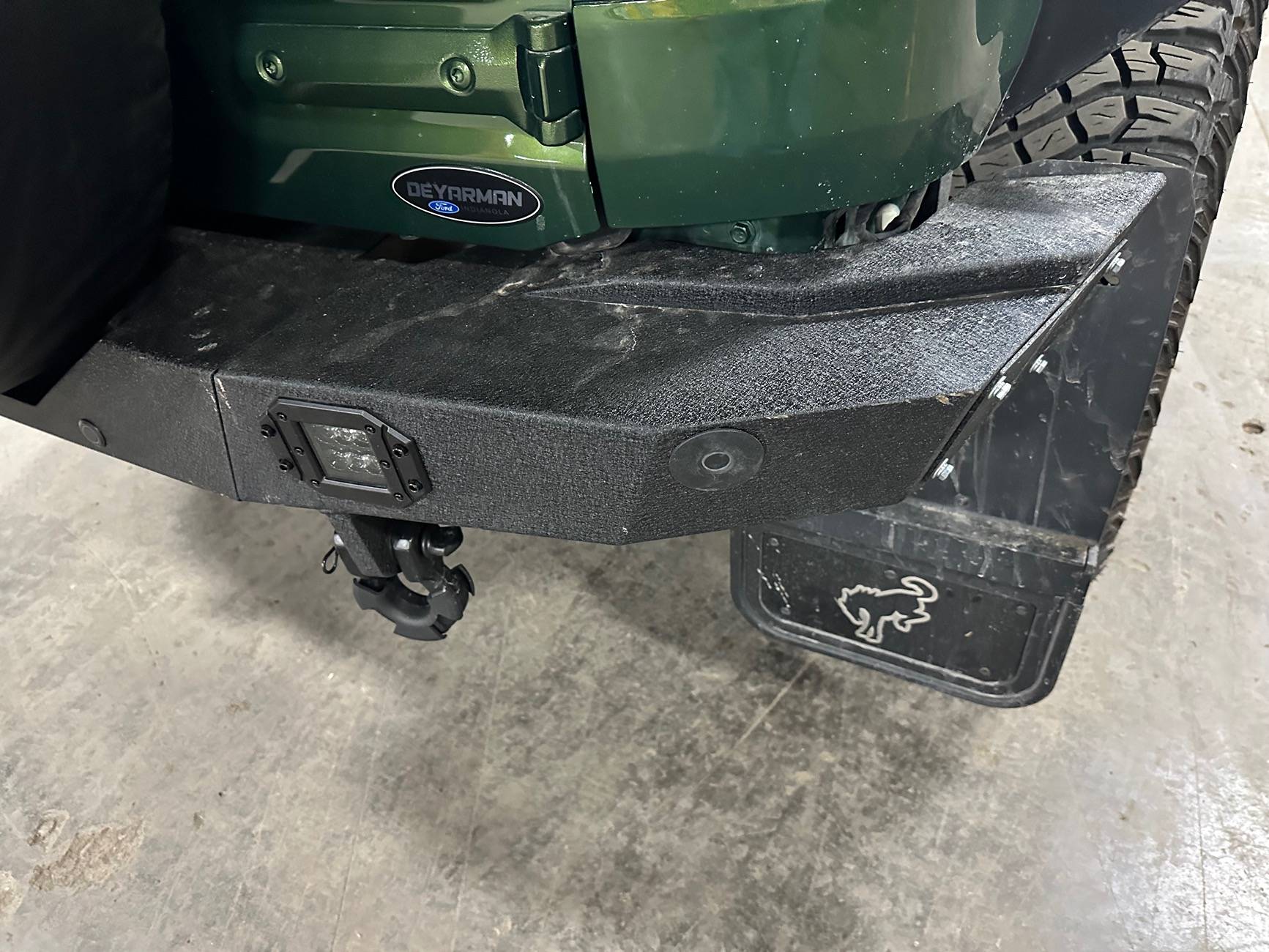

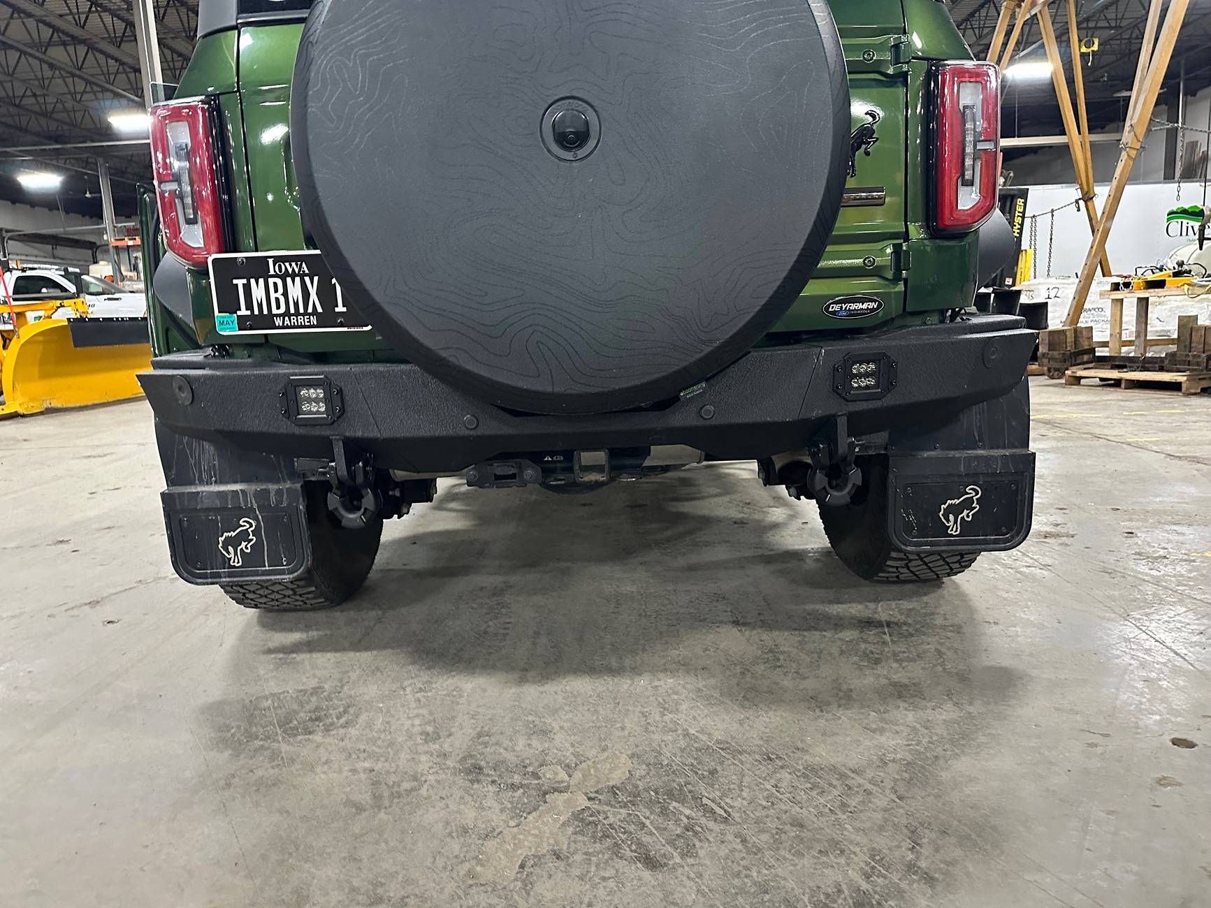

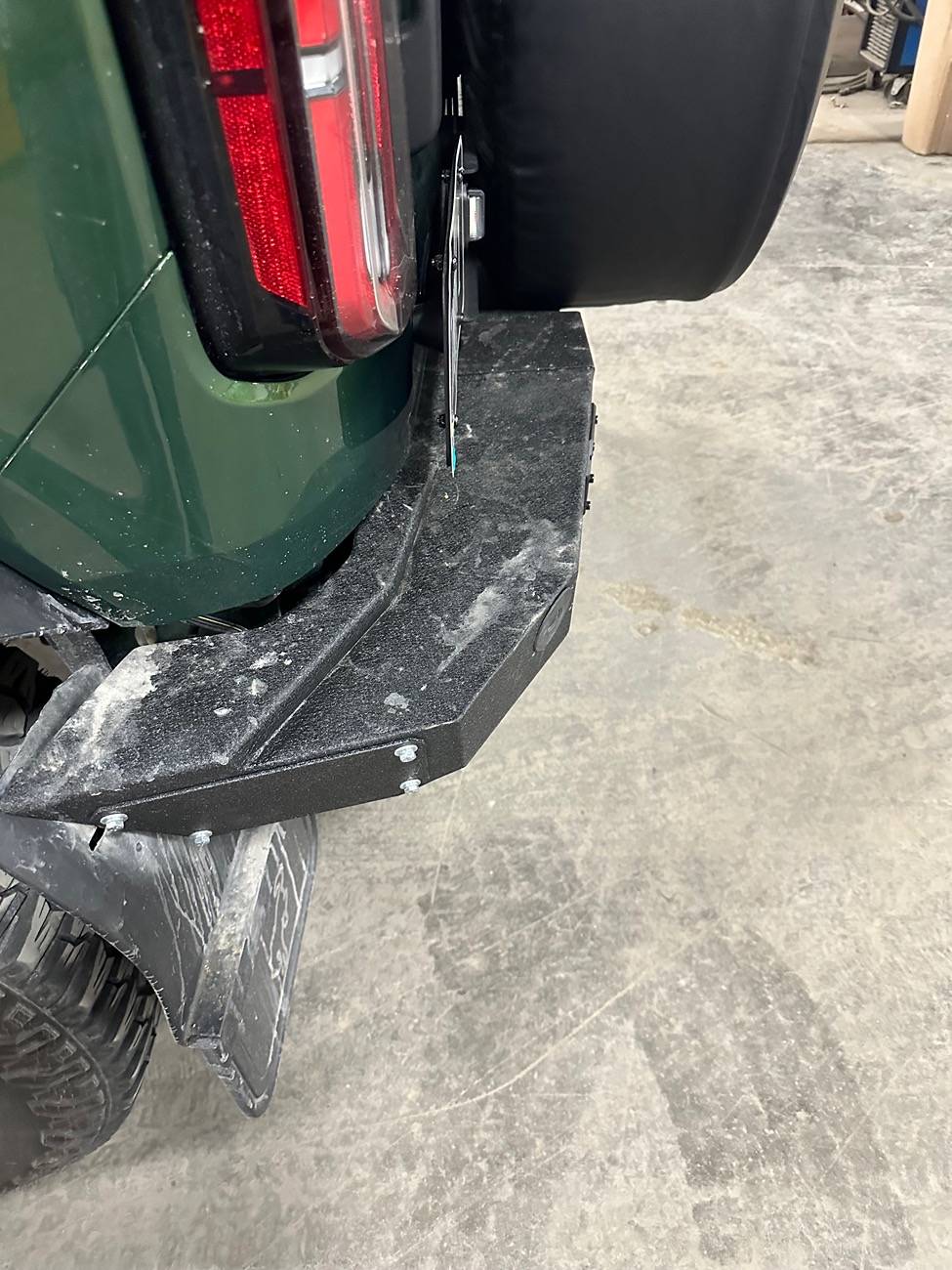

Finally had time over the Holidays to get my rear bumper and plate relocation done.
DV8 plate relocation. A quick install note from my experience. I ran the plate wiring in the loom with the video cable. It was very easy to thread though the rear door into the cabin area.
Broaddick rear bumper. Install of bumper unit straight forward and easy. Only issue were the sensors punch outs. Two worked and two required light grinding of paint and a bit of metal and then MetalCloak sensor retainers. I only used two but will be replacing all of them as they work great. The ones for the JT Gladiator worked perfect on this bumper.
Auxiliary lighting was tie into my reverse lights. Straight forward direct wire intoPods switched out from supplied chrome reflexive backing to black And looks great.
