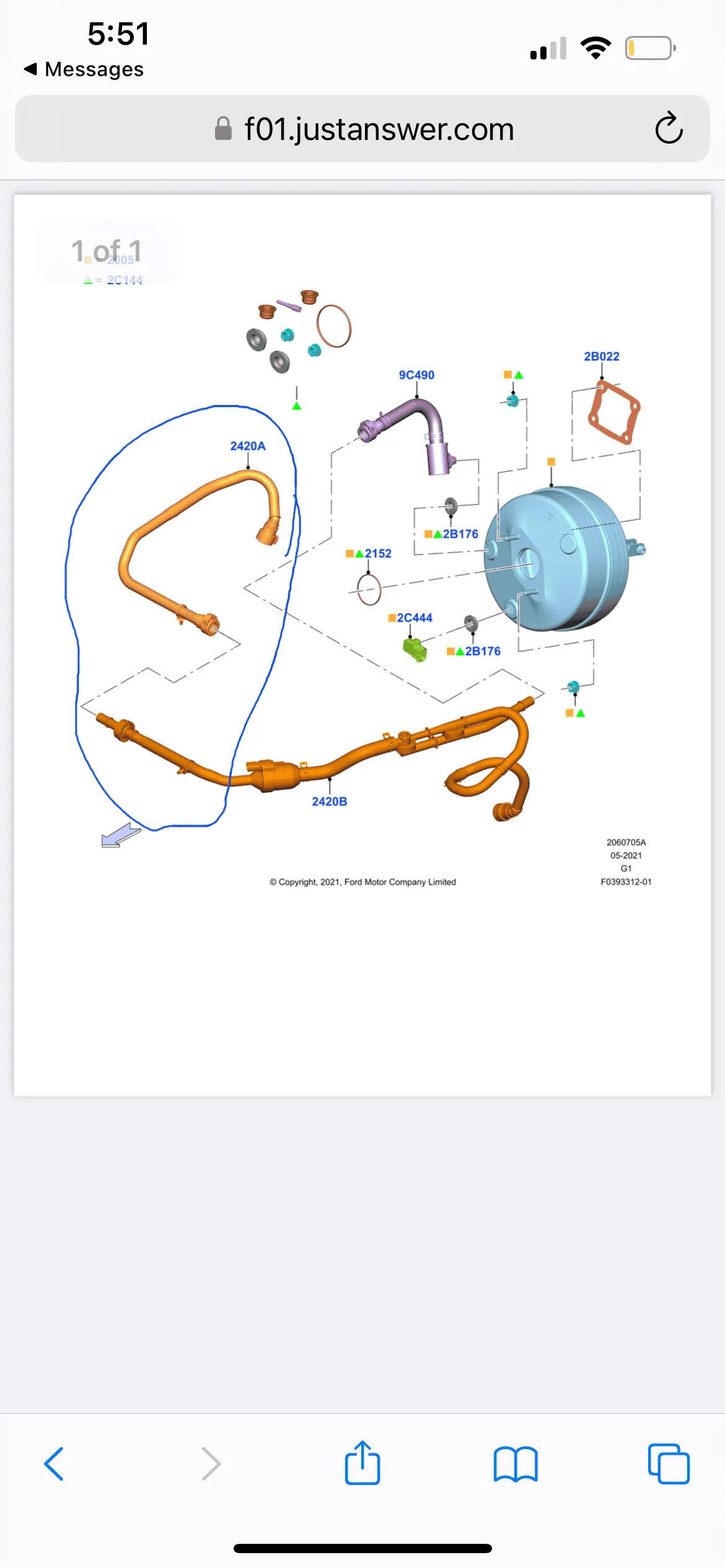

Hi, I have almost 10k miles and have been running my bronco on every mod I can find. I’m currently trying to go for my goal aesthetic and add a physical boost gauge but cannot find the “turbo vacuum/intake manifold vacuum” line to be able to measure the boost. Any chance anyone here knows the location or a way I could add a physical boost gauge? Thanks

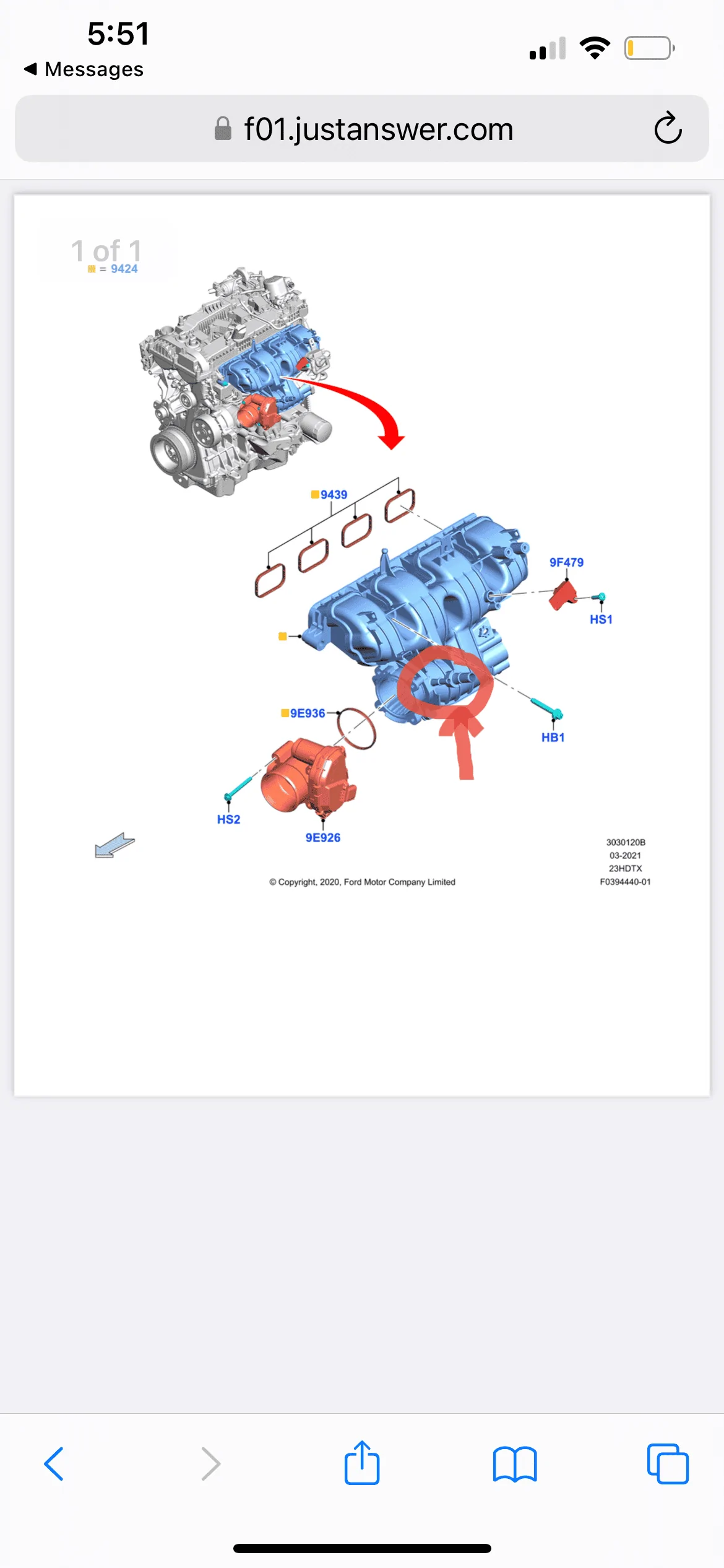

I talked to a ford advisor and he pulled up 2 schematics of the bronco engine bay where you could pull vacuum pressure. I’ve looked online and if you were to replace the part 2420B (bc you have to cut it open) it’s like $50 on eBay. I’ll post pics below
Ford Bronco Boost gauge 645DF606-6F73-4679-9B99-CBE7A8565D11
Ford Bronco Boost gauge 9B8CFDD8-E96F-4FB0-9055-C2D84E04C0CF

You can put a T Fitting in the line to you BOV and run a hose to the guage.
